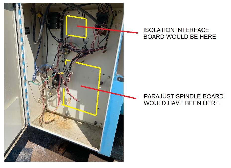

Leith,
Ok, I went back and looked at the left cabinet where you thought the VFD was located.
Ok my opinion is this.... after going back and looking, what I think is that the machine was totally working and still had the parajust board. I believe the parajust went out and they pulled it to get repaired and that did not pan out because of cost when they got the price from whoever that they sent it to. The reason I say this is from what the wiring looks like in it's present condition. It literally looks like they unwired and then unbolted the 2 boards. The parajust board is pretty big, and the other board above it is smaller and I can see where it was located originally. The smaller board is just a interface/isolation board, and the parajust is the spindle speed board.
It does not appear that there ever was a VFD installed. If there was, then someone sucked at their wiring and left a lot of hot wires siting open.
I fully believe the parajust went out, they pulled both boards thinking it was either of the two as the spindle control was giving them problems and the rest of the machine is fully operational. I would isolate the wiring in that left cabinet, check the step down transformer input to see if wired 220 or 440, and put power to the cabinet and see if it fires up. i really am starting to believe the everything else is fine. This would make sense as what would happen is some shop was tight on money. They pulled the board, or a service guy pulled it and they had the intention to fix the board. When they got the price, they balked at fixing it as it would probably have cost a couple of thousand for the total repair. And they had no clue how to wire in and implement a traditional VFD as the parajust wiring would have stumped them, so the final outcome was it sat until they got rid of it. In other words from a business standpoint, in their eyes the machine was not worth fixing as it was good money thrown after bad in a old machine when they could invest that money in a new or newer machine. I think it has been sitting in that condition for awhile, but if you isolate the parajust board wiring that you could possibly get it fired up pretty easy to check the servos.
Here is your picture where the boards would have been. Will find some pics of real thing.
I will be back in a bit, wanted to get that on to you so you could be thinking about it. Still have a lot to get done in order to send you more pics and info, but working on it.
Robert

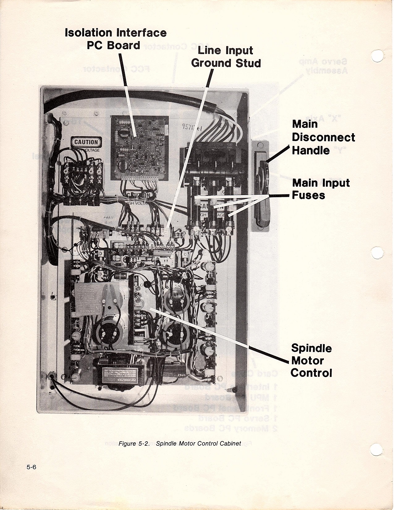

Leith,
Ok this is not the best picture and I will try to get a better one. This is my cabinet with the VFD, Isolation Board, and Brake Resistors.
You should not need the isolation board, so don't freak out not having it. I still have mine, but that was because I still had the OEM computer. When the computer was replaced, I bypassed the isolation board and wired my analog output terminal (EtherCAT EL4132) to the VFD direct. The isolation board would have been there still for the OEM computer is why mine was still there. Now it is abandoned, but I am going to remove it sometime soon to get it out of the cabinet.

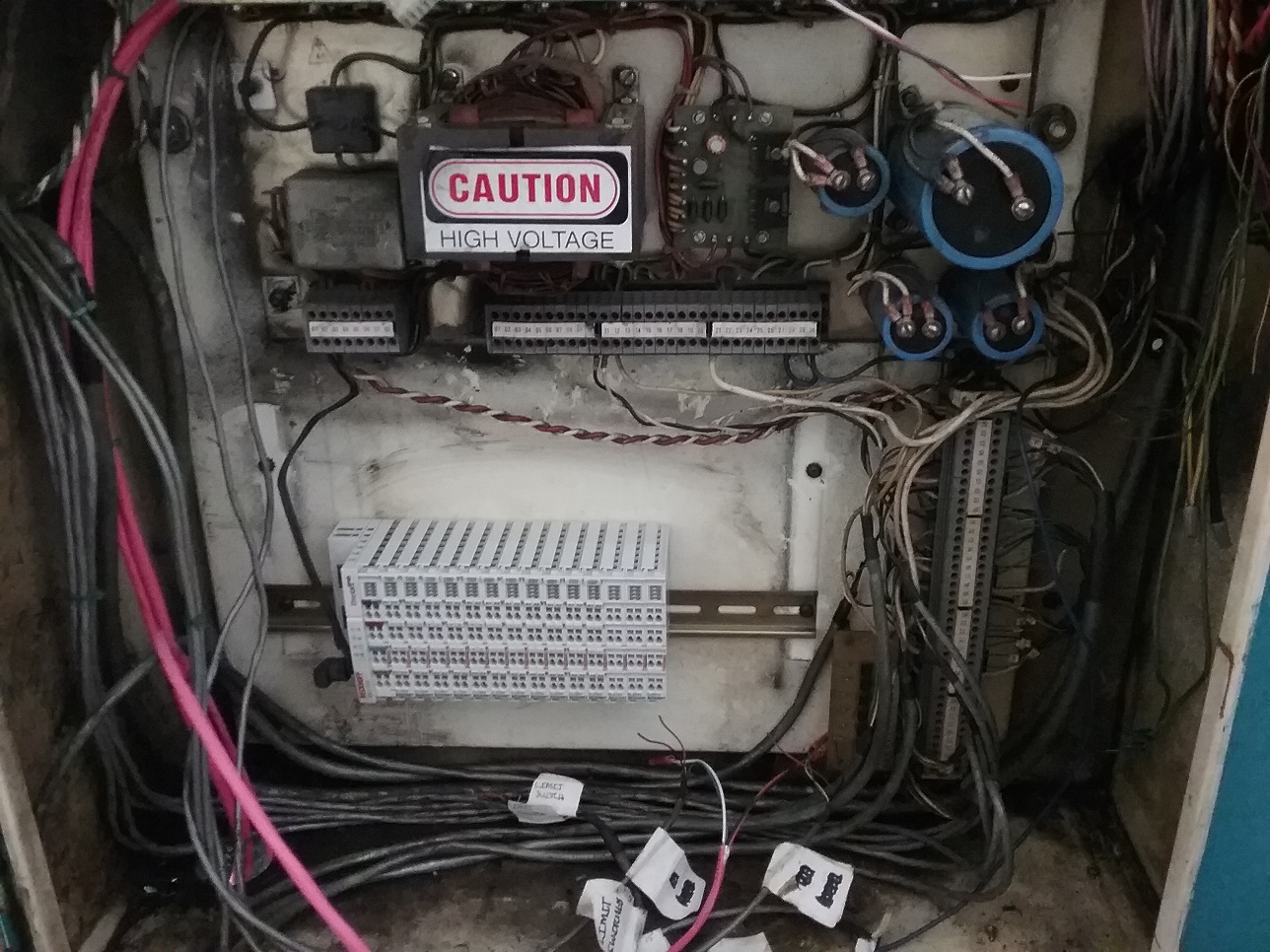

Just a throw back pic of my cabinet when first started retrofitting. My cabinet was ultra dirty. They had left the door open for years apparently as it took a ton of cleaning to get it halfway better.
The computer is removed and the EtherCAT terminals are mounted where it was originally. I did not keep them at this location, ended up realizing this was a bad location, and laid out everything I needed to mount so that everything would fit

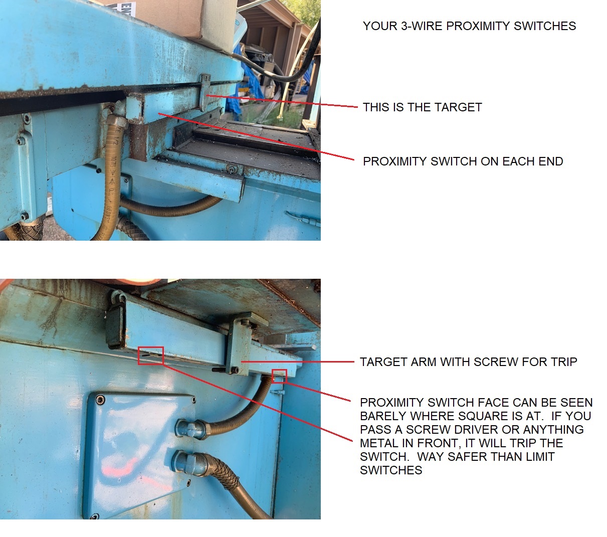

Leith,
One thing I forgot to mention. In the pics of the proximity switches, I saw where your table is already centered on both axis, or it appears to be. If so, then you don't have to even move it. That is good for when you fire up the servos the first time.
Got to get sleep, up too late LOL. Will be back tomorrow.
Robert
