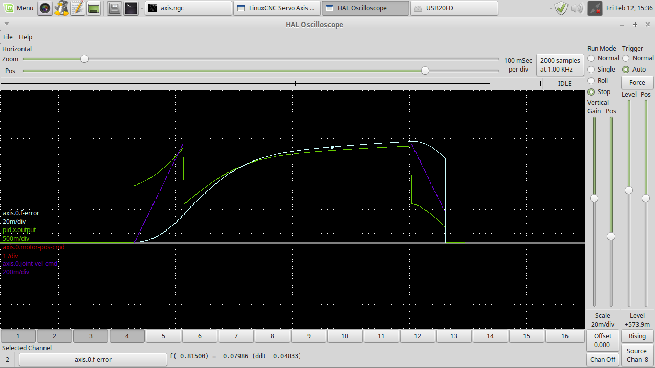

Replied by PCW on topic A-M-C A12A100 Servo Drive with SouthWestern Ind ProtoTrak Plus

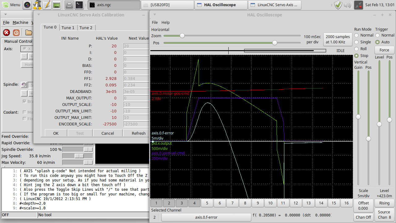

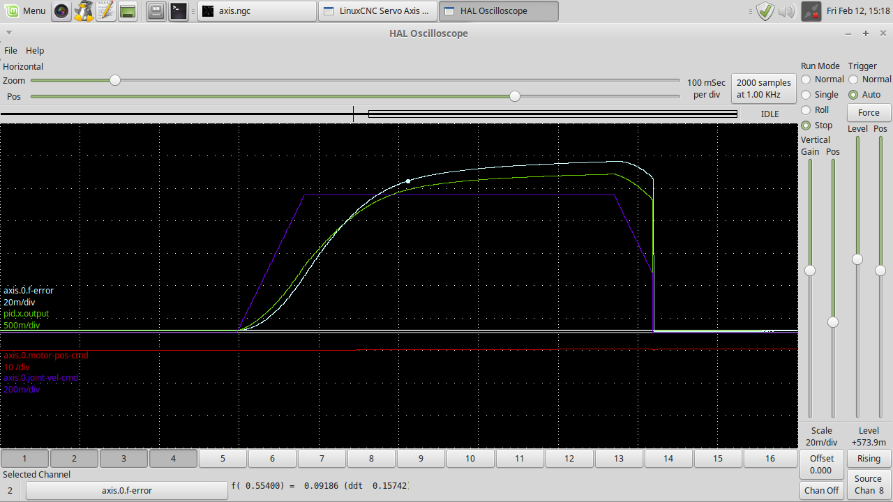

Unfortunately those traces are not of much use.
You need a trace like the previous one:
forum.linuxcnc.org/media/kunena/attachme...45f2-.1236feed20.png
with a jog showing acceleration and a constant speed region (the regions Todd circled)
You tune FF1 first to minimize the following error during constant speed motion
Then you tune FF2 to minimize the error during acceleration and deceleration

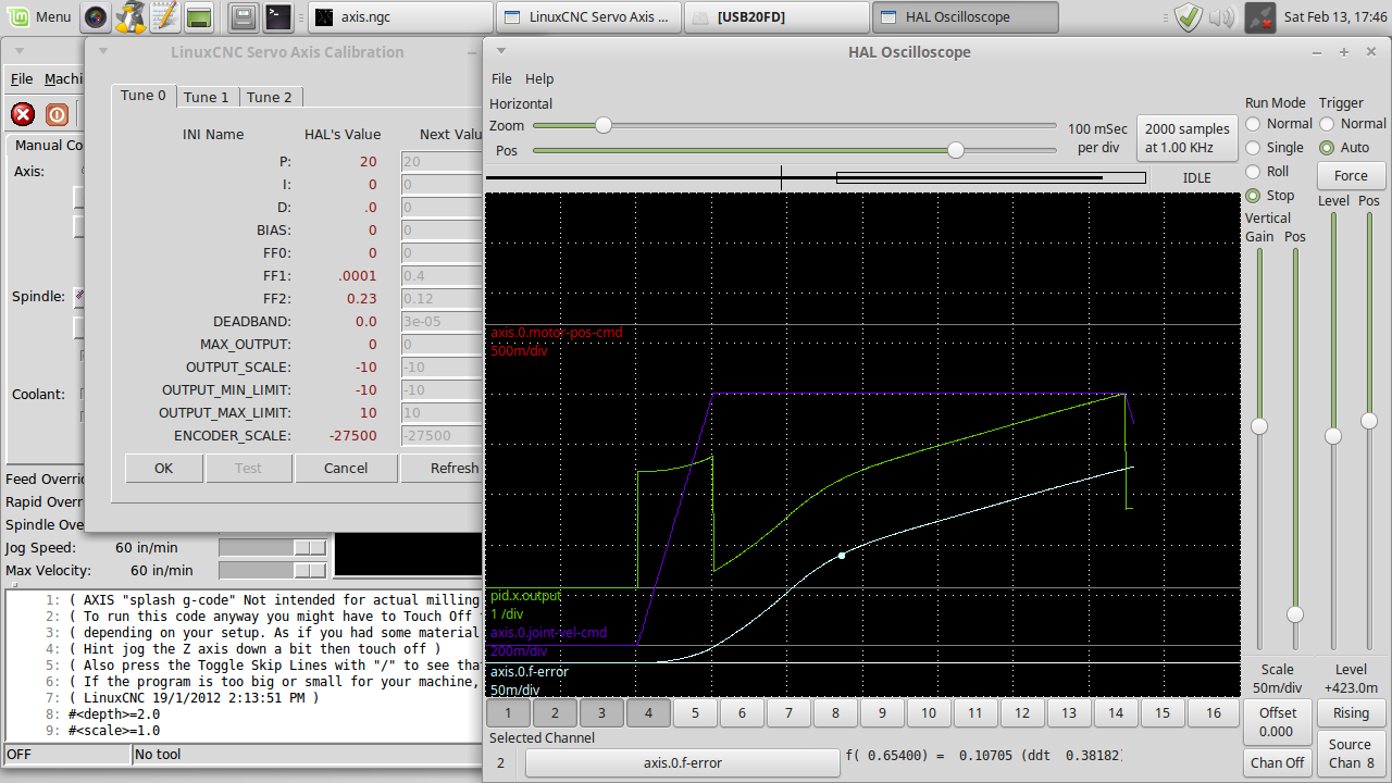

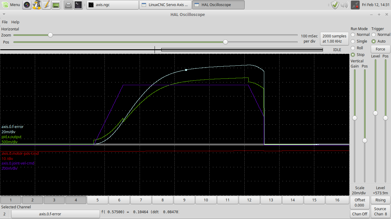

12 Feb 2021 19:22 - 12 Feb 2021 20:33 #198563
by new2linux
Replied by new2linux on topic A-M-C A12A100 Servo Drive with SouthWestern Ind ProtoTrak Plus

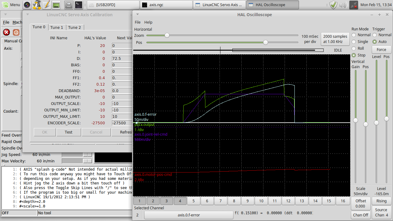

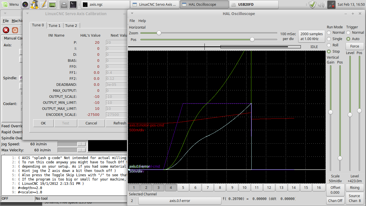

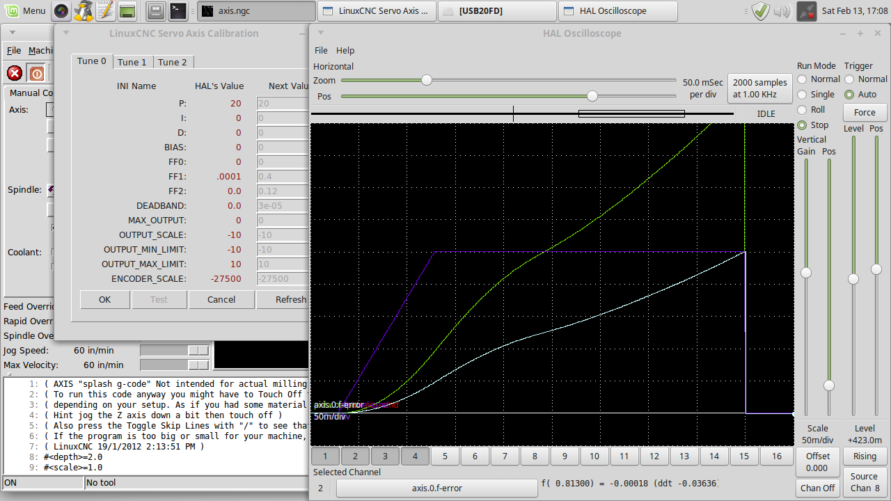

PCW, Thanks for your help!! Attached is a pic of low P as you have suggested. Feed rate 50.9"/min!! Many thanks!
Edit: New pics, better f-error? 1 trace with FF2, 1 w/o FF2. Tried to be in center of the zone. I will work this over the weekend, please point out any suggestions or I will work with the guidance provided. many thanks!! Take notice the units are not uniform!
So you still have a FF2 value set, it should be 0 at this point
Next step is to dial in FF1

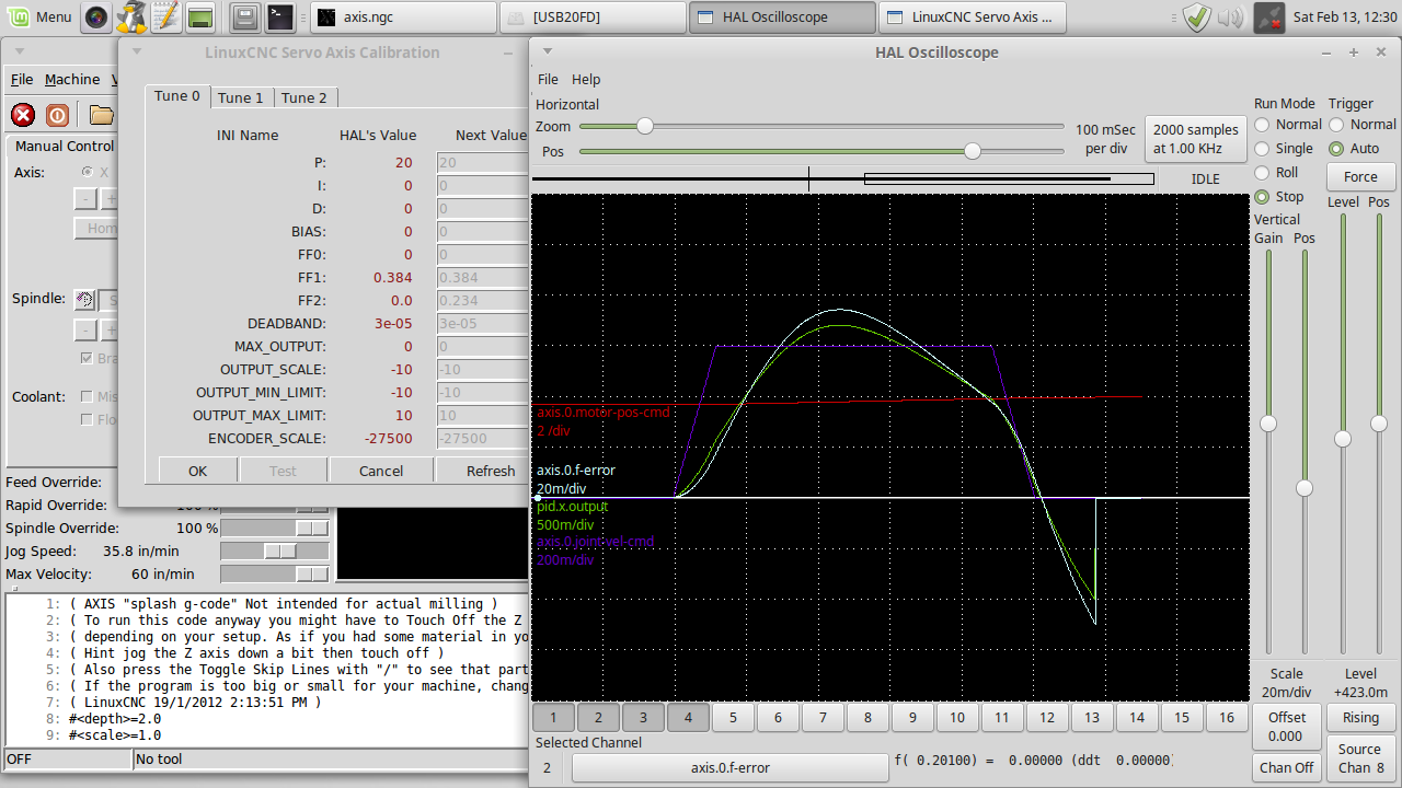

13 Feb 2021 18:51 - 13 Feb 2021 19:17 #198701
by new2linux

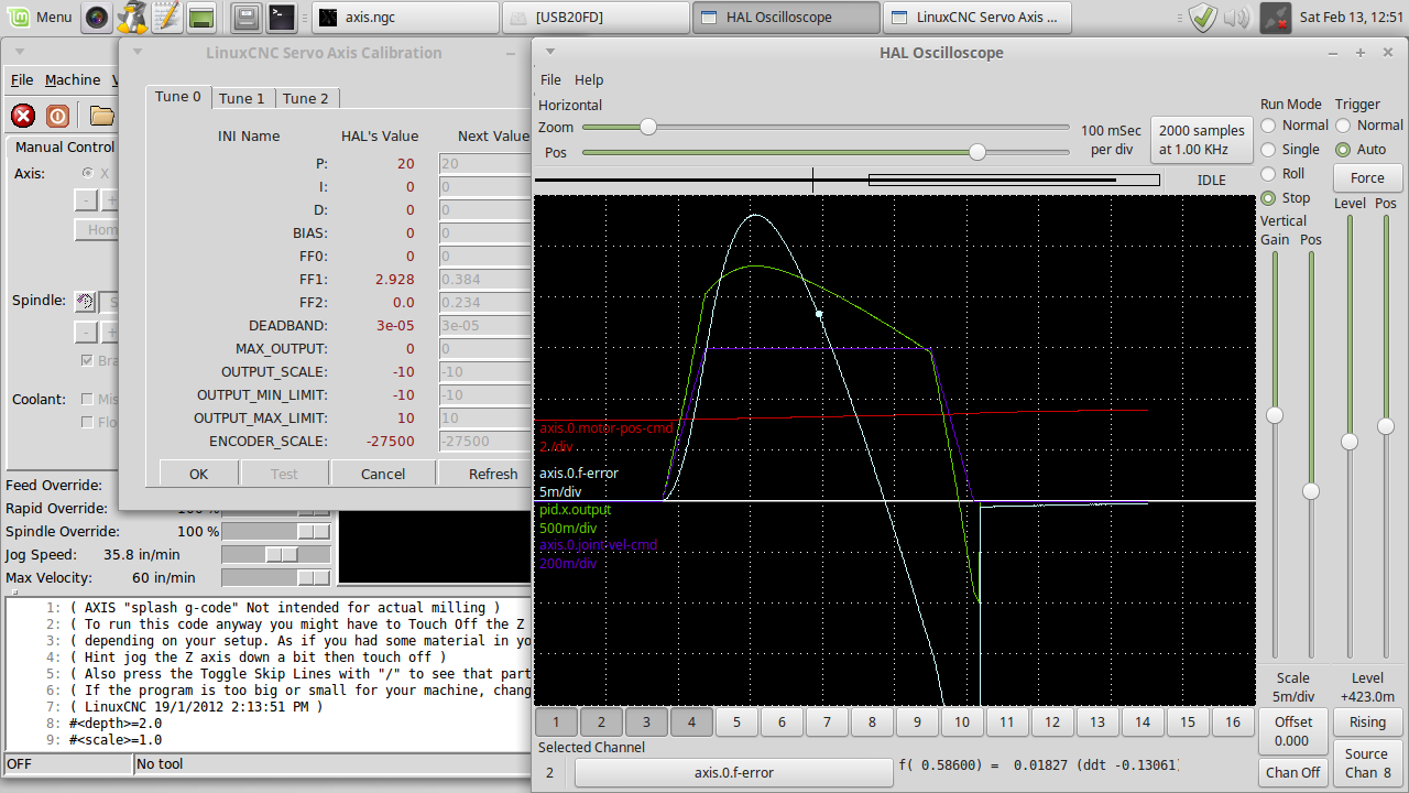

PCW many thanks, for your help!! I have worked on this a great deal, but only saved the pics you see. Only 1 of the 3 has any FF2, the units for the scale are not the same in all pics. The best error looks to be under 3 units (in the higher scale, even though the trace looks like no improvement) around 2.8 in 5m/unit scale. When adjusting the settings, I was tiring to flatten out the f error trace.
Many thanks!
What mode are you running the drive in? It does not appear to be running in velocity mode

13 Feb 2021 22:58 - 13 Feb 2021 23:09 #198743
by new2linux
PCW, Current mode. I will edit my 1st post.
many thanks
This is new traces with very low FF1 & FF2, feed rate 60"/min!! The file name has settings or read from the pic. ALL prior tuning had DeadBand set to a value, this is not the case now. The units are not uniform, see the screen shot.
many thanks!
many thanks
many thanks!
Last edit: 13 Feb 2021 23:09 by new2linux. Reason: add pic

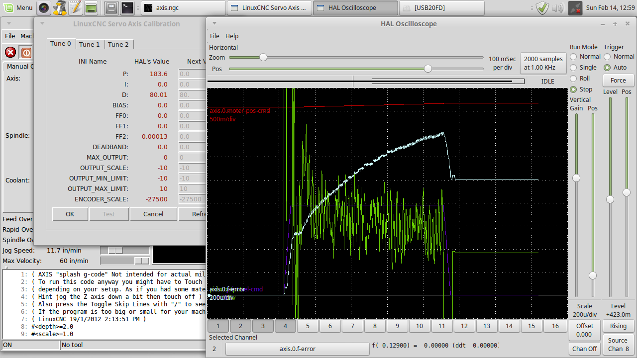

14 Feb 2021 13:50 - 14 Feb 2021 19:00 #198806
by new2linux

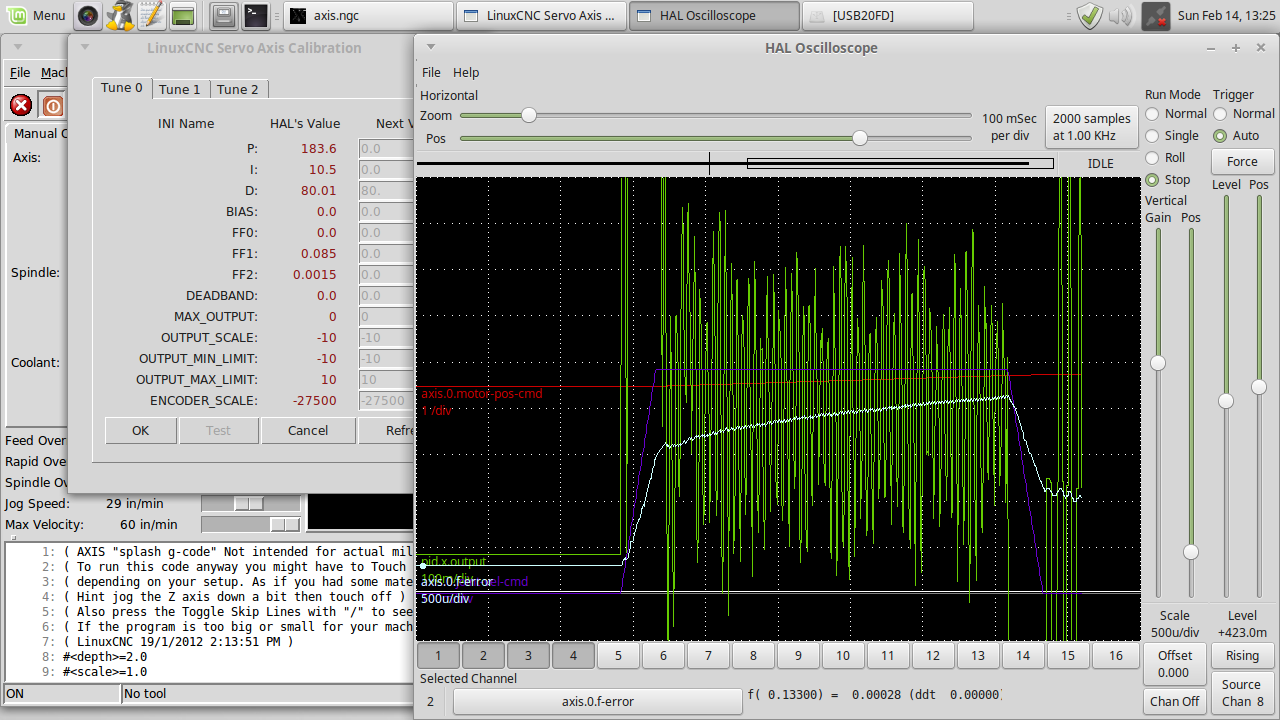

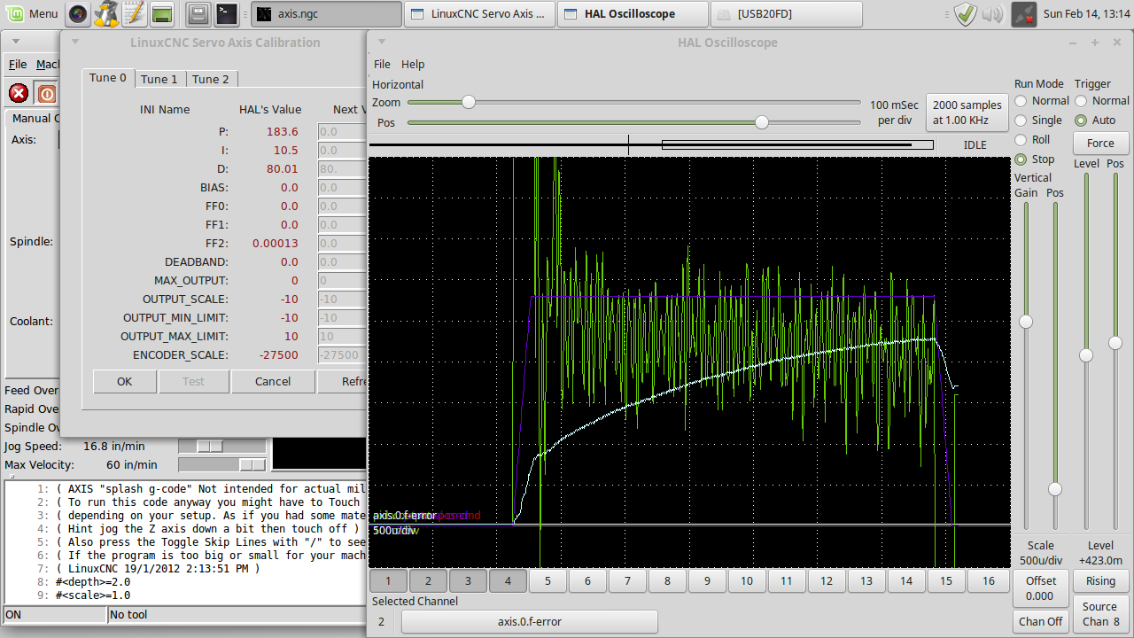

PCW, Many, many thanks!! As be clear is:
"1. Set D as high as possible with buzzing/oscillation"
or is that "with" or "without"?
many thanks!
Attached are the latest halscope trace. The file name has the settings, units are not sorted.
Many thanks
many thanks!
Many thanks

14 Feb 2021 14:57 #198810
without

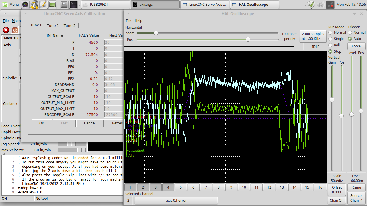

15 Feb 2021 19:07 - 15 Feb 2021 19:10 #198960
by new2linux

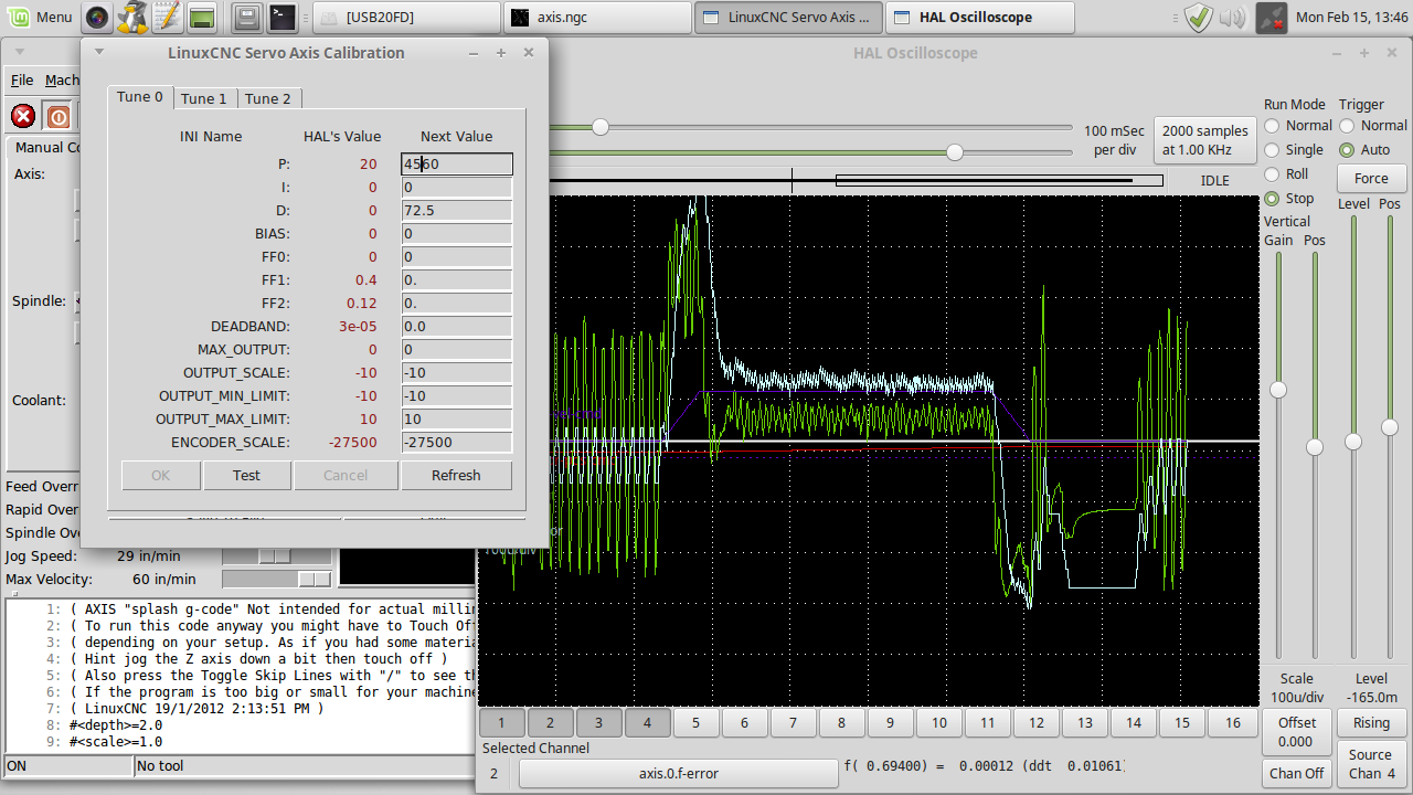

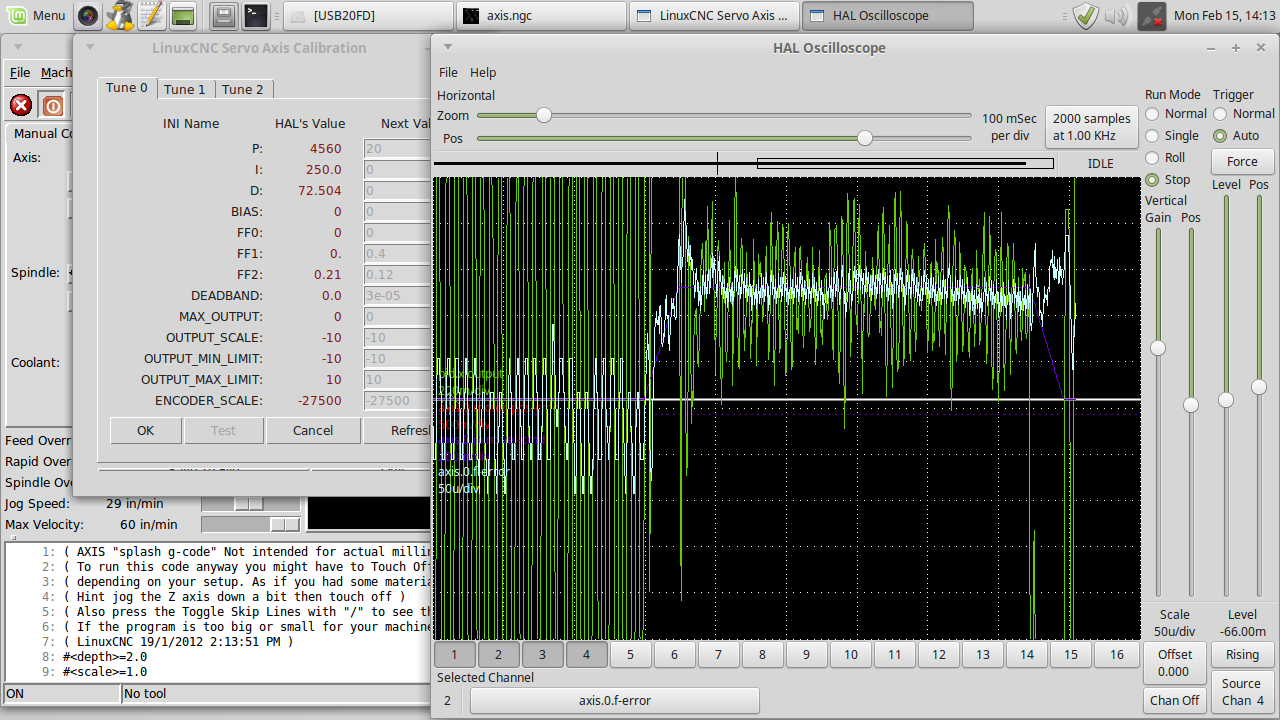

PCW, Many thanks! Attached are several pic of the hal trace. There is an order the gain values are not uniform, please see pic for settings. The feed rate was only 29"/min. Did not see the big oscillation, as though with the "I".
many thanks!
