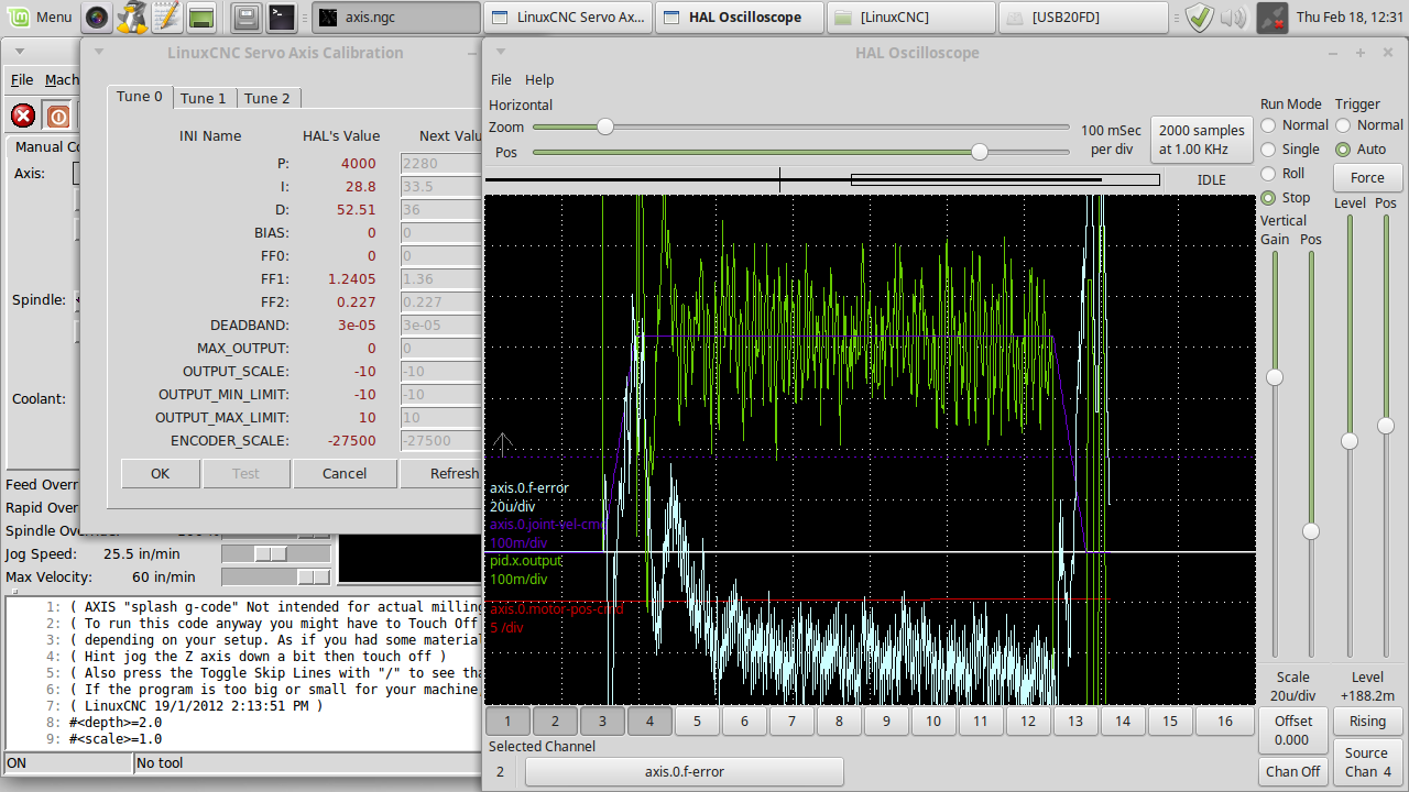

What are your following error limits?
Can you plot at higher speeds (by widening your following error limits)

The one with FF1=1.36 looks about the best for that setting. What happens at various speeds, both slower and faster up to your expected max feed rate?
Once you have your feed forwards set, try increasing your P term back up to about 4000, (May need to adjust the D to limit oscillations.)

PCW, Many thanks! The "following error limits" are in the .ini file, correct. This is a copy and paste of that section. Currently set at .05, you are suggesting to go to how much? many thanks

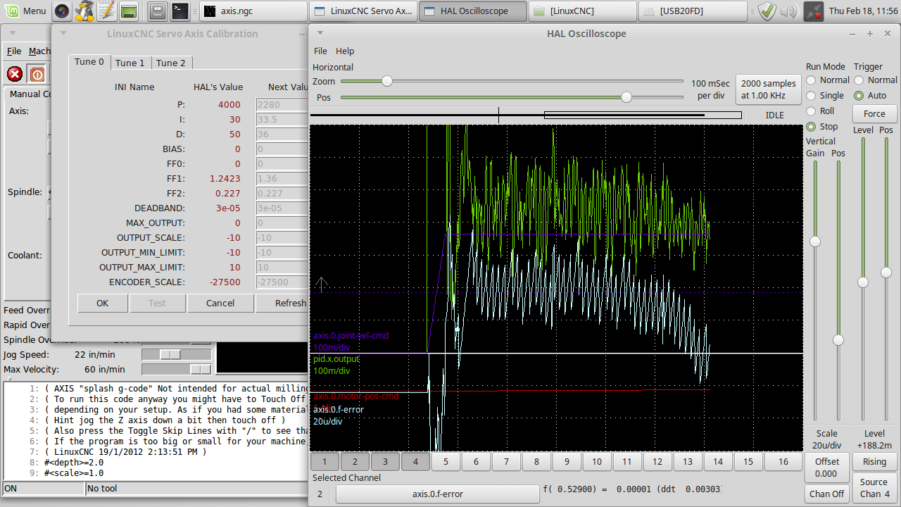

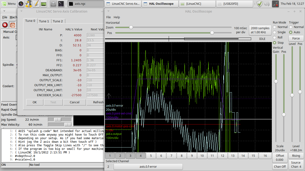

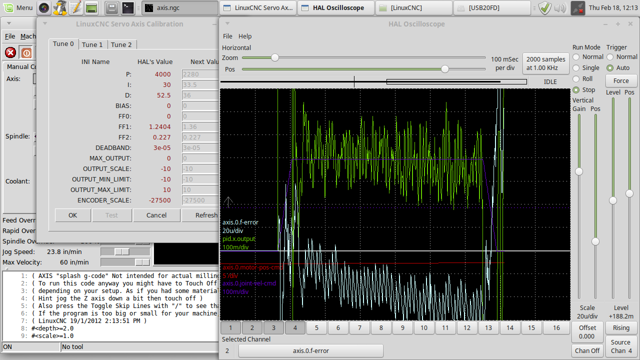

Todd and PCW Many thanks for hanging in there with me! Attached are several pics of the tuning process. As I changed the values I would revisit the other settings with very small changes, so no real logic. Quickest feed is 25.5", the last pic.
Many thanks!!

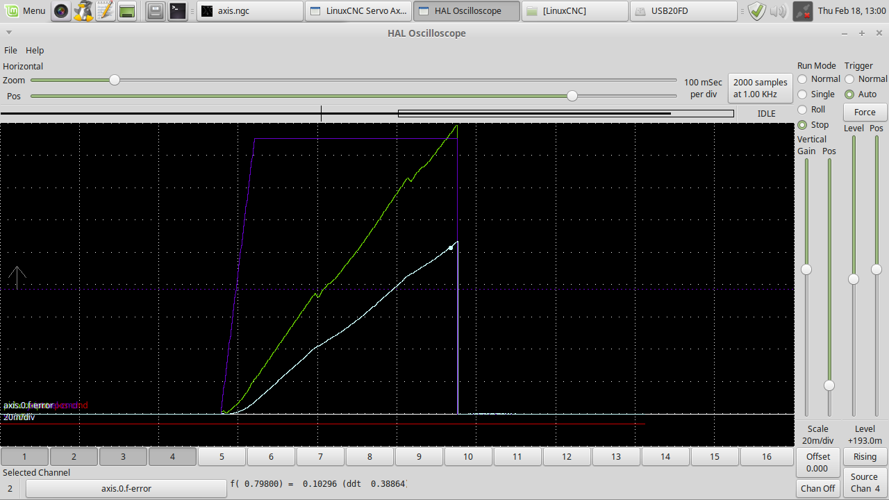

Can you do a plot when you trip the following error?
(and scale the ferror so it does not go off screen)

PCW, many thanks!! Attached is pic of error at 25.5" feed. many thanks!
Edit: I see the units are on top of each other, they read as, motor pos cmd 20/div; f error 20m/div; pid x output 50/div and the last is 50m/div.

Replied by PCW on topic A-M-C A12A100 Servo Drive with SouthWestern Ind ProtoTrak Plus
if the PID output is 50 per division then the output was
saturated (at 10) at the very beginning of motion so its likely
you have a drive or drive wiring error
