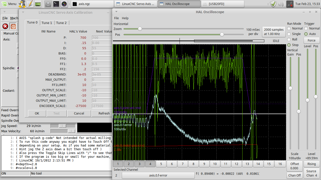

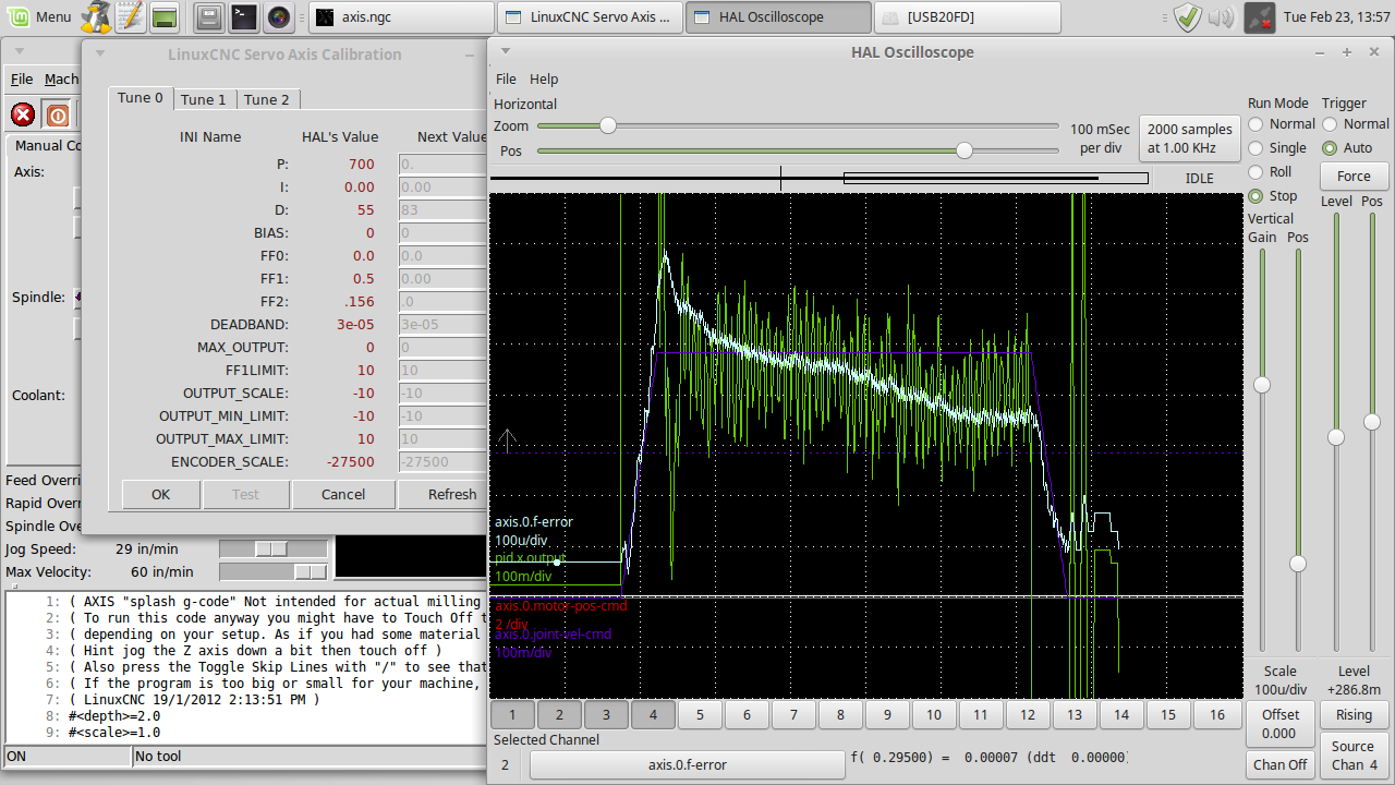

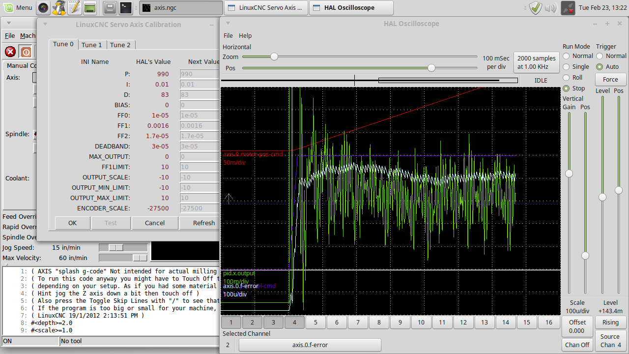

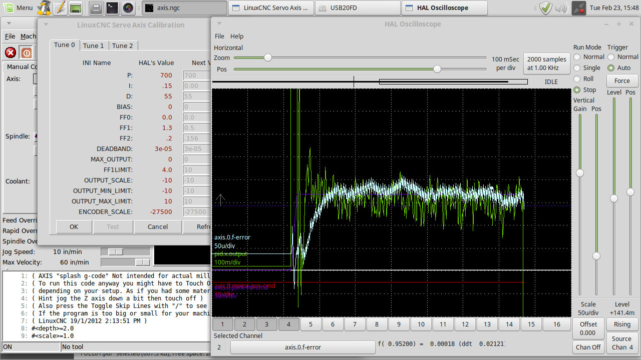

23 Feb 2021 16:49 - 23 Feb 2021 18:14 #199855
by new2linux
Replied by new2linux on topic A-M-C A12A100 Servo Drive with SouthWestern Ind ProtoTrak Plus
Todd, Thanks, Made changes as per your suggestion. looks good, see pic.
Last edit: 23 Feb 2021 18:14 by new2linux. Reason: add pic

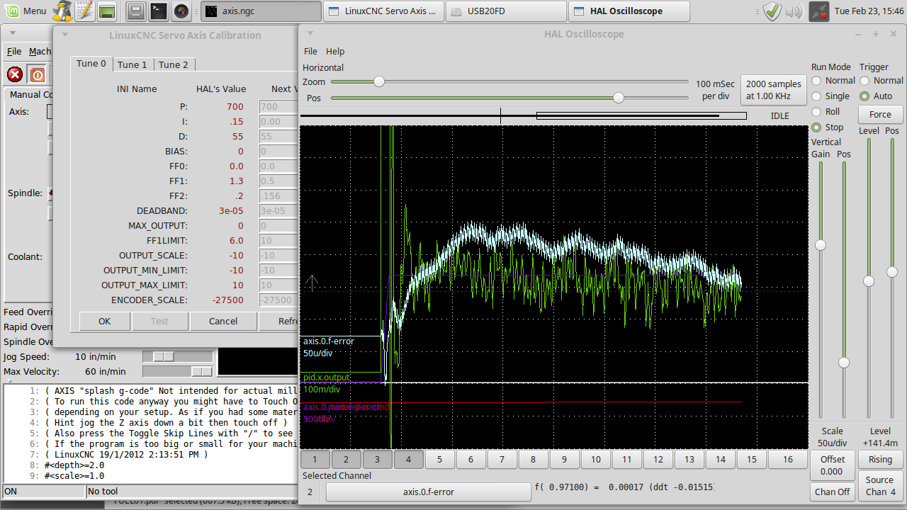

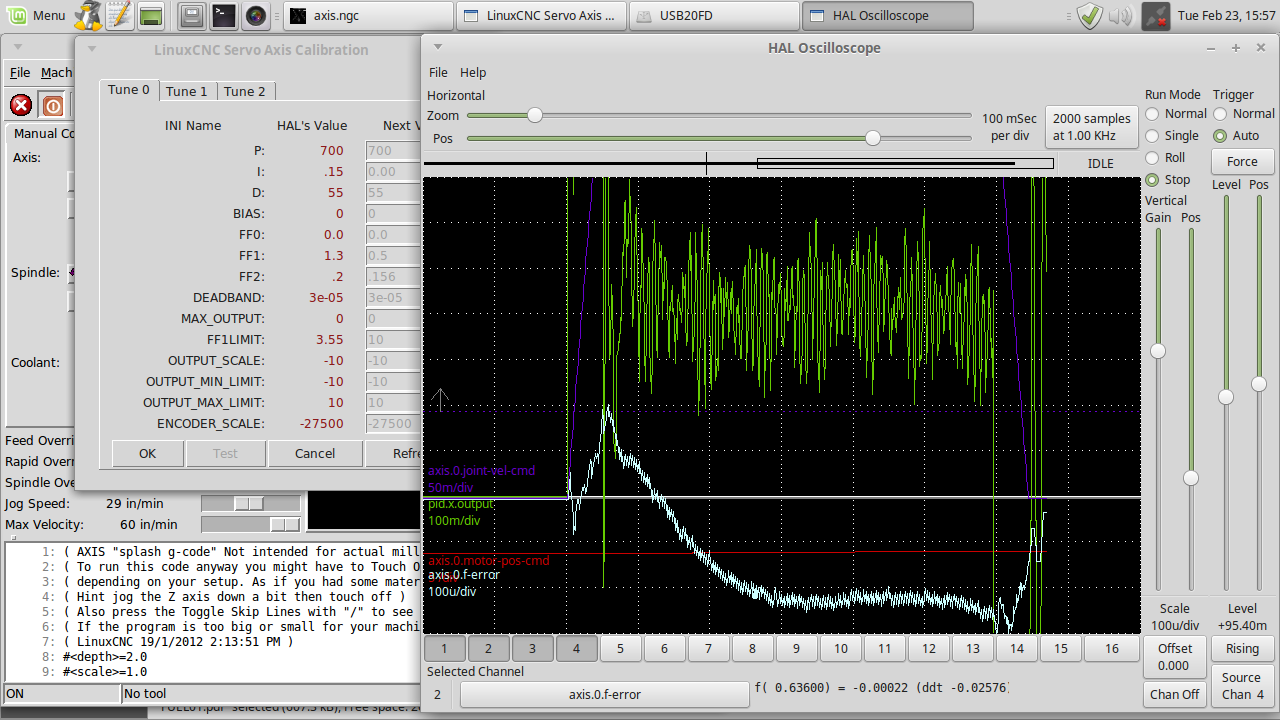

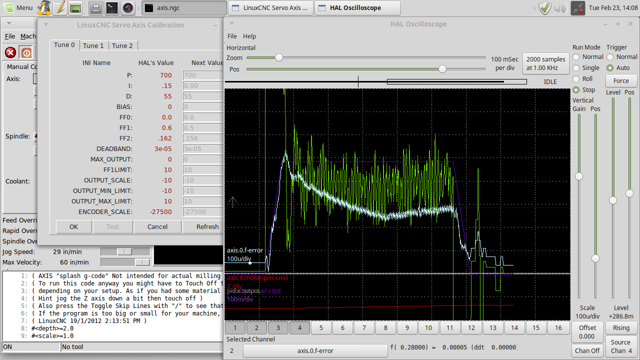

23 Feb 2021 19:01 - 23 Feb 2021 19:07 #199877
by new2linux
Todd, Many, many thanks! Attached are some pic of the most current changes, look good 29"/min, The file name has settings, if pic is not clear. Only most recent pic are attached. many thanks!!
Edit: Todd: This is from prior post: "FF1 working well at a low speed lower the ff1limit incrementally until you start to see some effect from it."
The effect I am looking for, is the making the "axis 0 f erreo" trace, horizontal, strait and as small as possible, correct? many thanks.
Last edit: 23 Feb 2021 19:07 by new2linux. Reason: Ask question

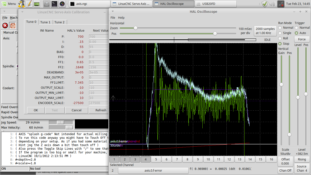

- new2linux
- Posts: 711
- Thank you received: 9
23 Feb 2021 19:41 #199884
by new2linux
Todd, many thanks. This is with "ff1 limit" from 10 reduced to around 7. Just looking for 2nd opinion. many thanks!!
- Todd Zuercher
- Posts: 4786
- Thank you received: 1476

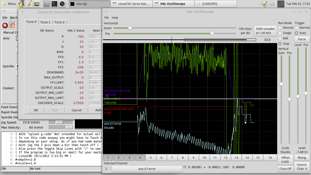

23 Feb 2021 19:59 #199888
Replied by Todd Zuercher on topic A-M-C A12A100 Servo Drive with SouthWestern Ind ProtoTrak Plus
You still don't have enough FF1 or FF2. Try setting the FF1=1.3, FF2=0.2 and leave the FF1limit =10. Then record traces of moves at 10ipm, 20ipm and 30ipm. So we can see how the different speeds are effecting the f-error for a base line.
Then testing at 10ipm, lower the FF1limit until you start to see the f-error increasing. Reset the FF1limit to approximately the smallest value that doesn't increase the f-error. Then record traces at each speed, 10, 20, 30ipm (with all the settings the same as the last one.)

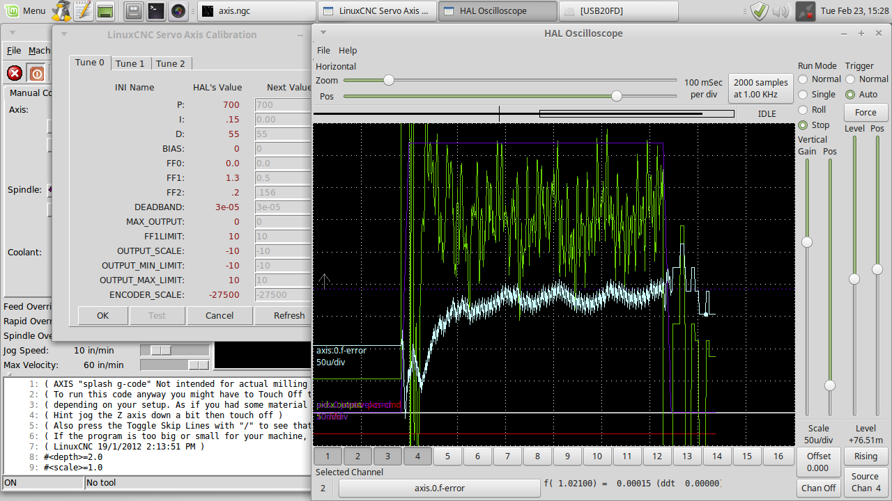

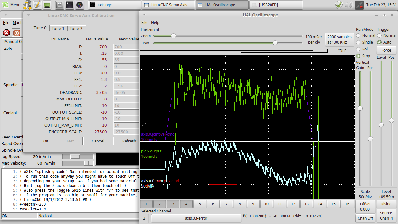

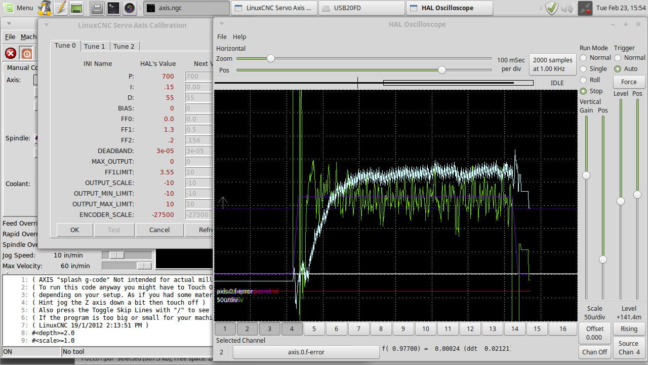

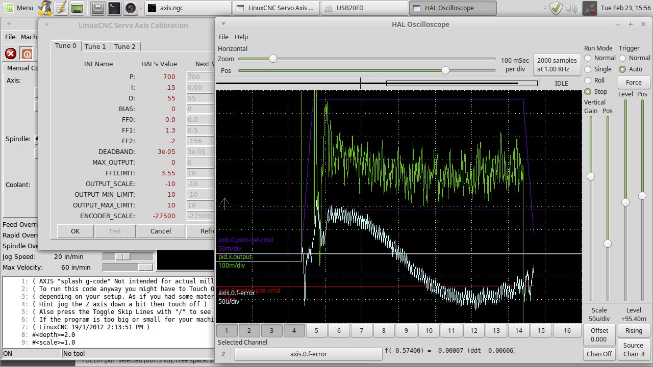

- new2linux
- Posts: 711
23 Feb 2021 20:49 - 23 Feb 2021 20:56 #199889
by new2linux
Todd, Many thanks!! This ia a selection of traces as per your suggestions: They are in ruff order as to follow your directions. File name may not be complete.

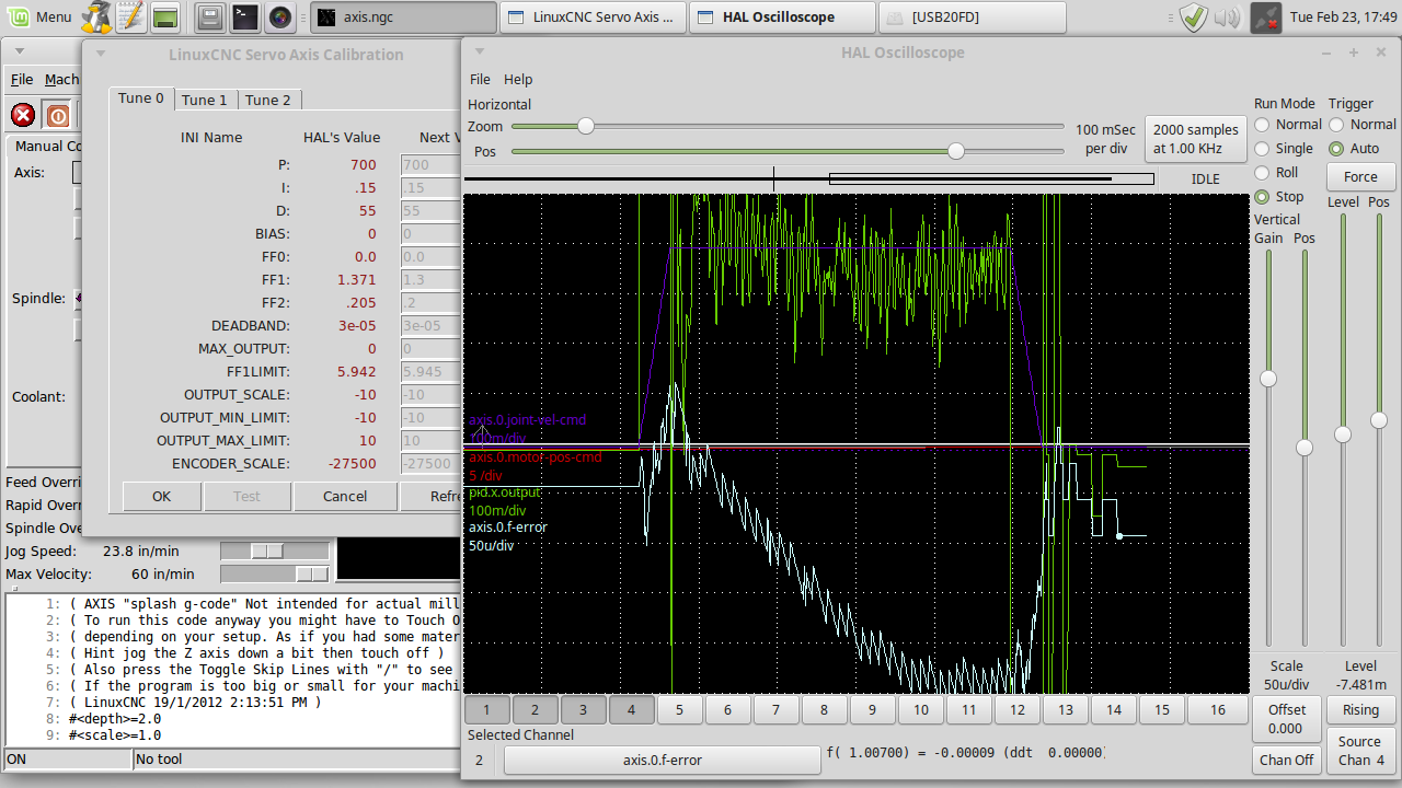

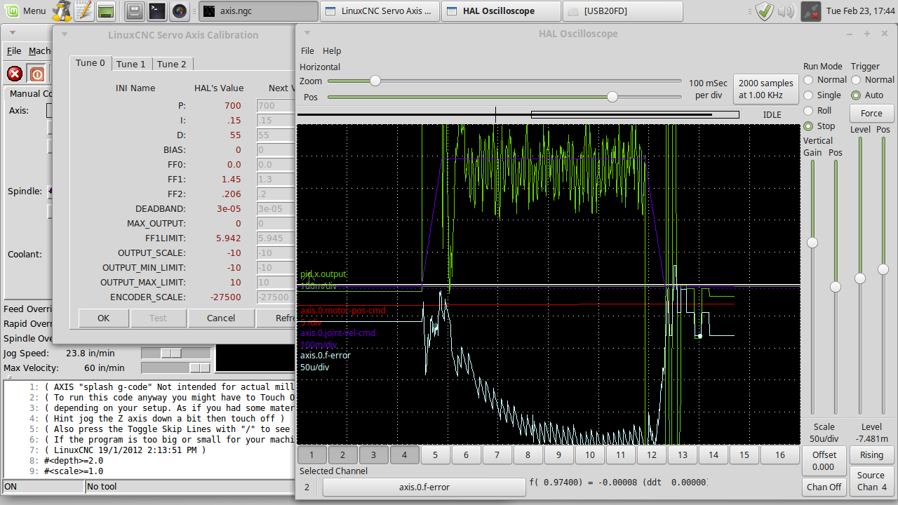

- new2linux
- Posts: 711
23 Feb 2021 22:50 #199898
by new2linux
Todd, Many, many thanks for your help!! The attached files are the latest and look the best so far, feed at 23.8"/in, watch the units! I have other pics, these show small change in FF1 that will move the f error below "as to invert". I plan to work this tomorrow, any suggestions are warmly welcomed. Many thanks!
