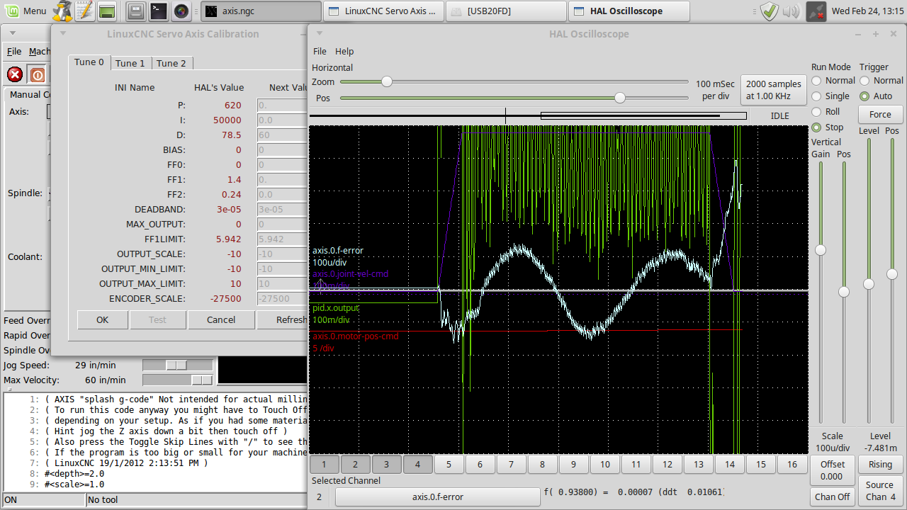

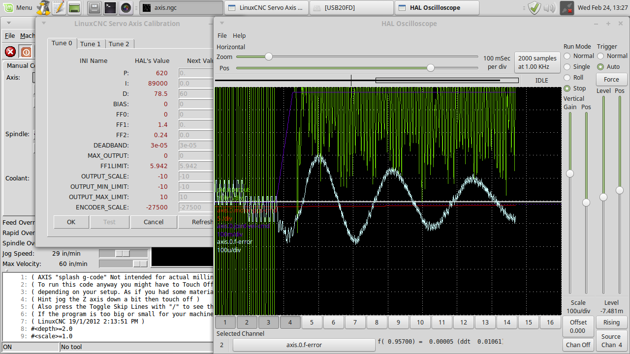

It does not look like your I term is doing anything, have you tried
large values (say 1000 to 50000)?
To get an idea of the scale for I, with a 50 uinch error for 100 millisecs
(1 division in your plots), a I value of 1 would only result in a 5 uV change
in the PID output. An I value of 10000 would still only result in a 50 mV
change over the same 100 ms.

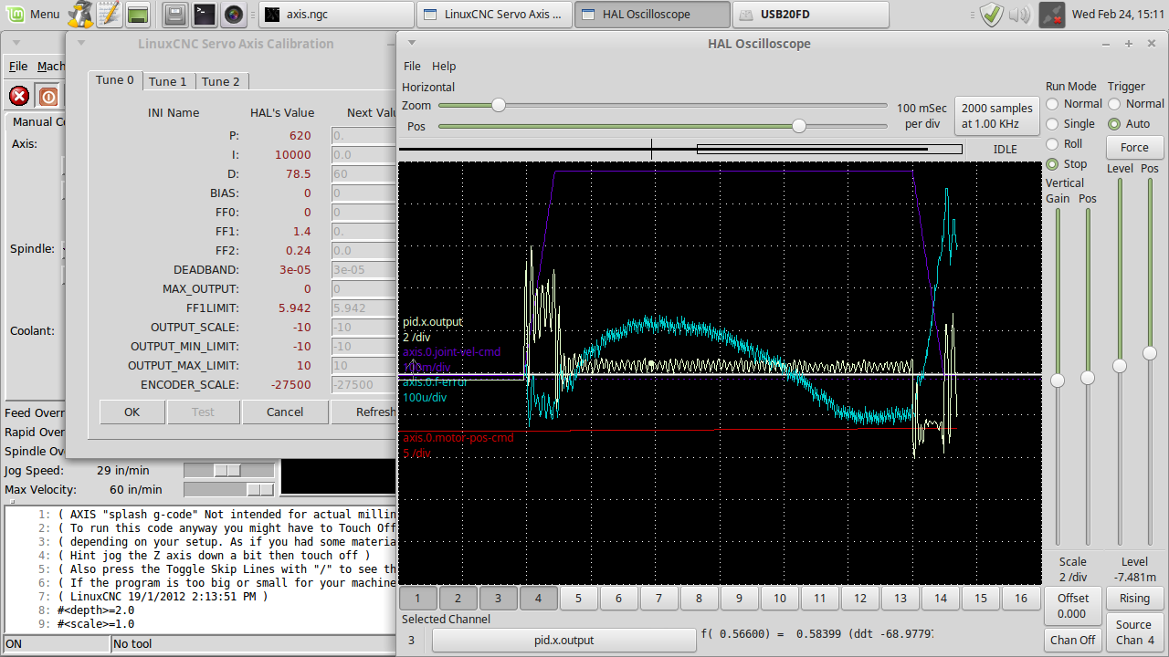

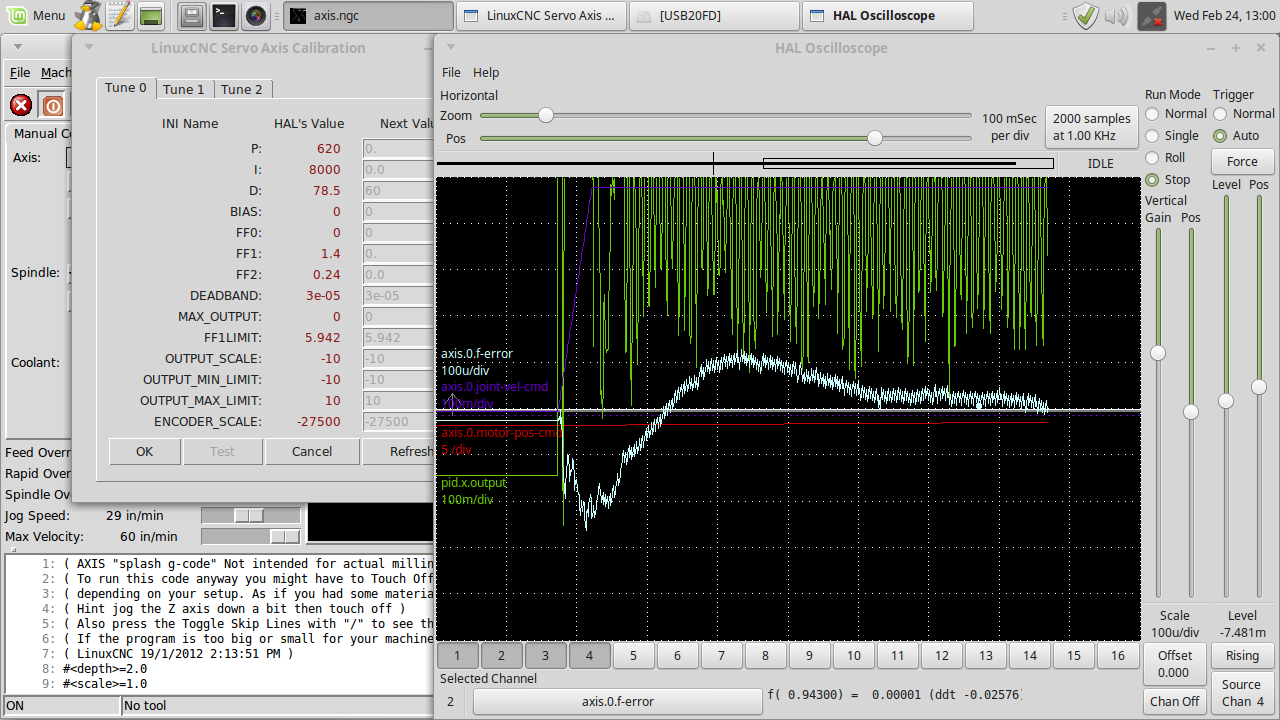

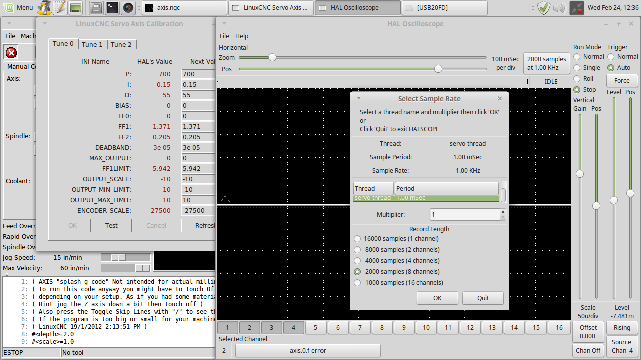

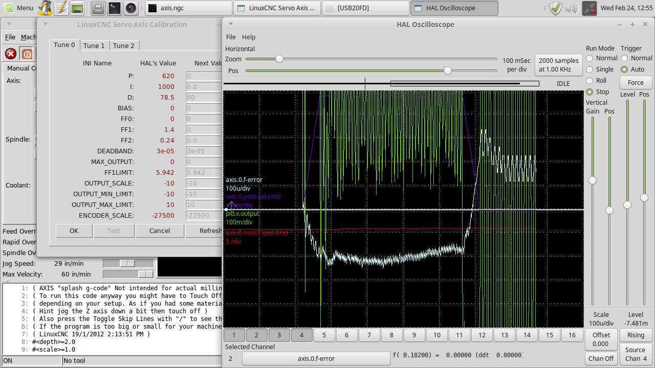

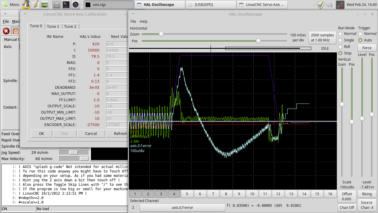

Todd and PCW, Many thanks. The servo thread rate question, the computer is a Intel Pentium 4 HT, there is a pic for this question. I have a better feel for the "I" values and included several pic of the traces (many other to pick from) attached below. As per suggestion feed rate & unit scale is the same in all pics. Some of the "I" goes as high as 89000. many thanks

Can you change the scale in halscope for the pid.x.output pin, so that we can see what it's peaks are. Change it to something more like 2 instead of 100m. That way we can see if it ever tries to go beyond +/-10.

Todd Thanks for your help!! Attached is the trace you asked for, I = 10000, in the white trace. many thanks

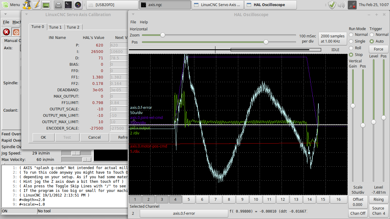

I think you have too much FF2, and try decreasing the FF1limit to 3 or 2. Still might be able to use more I.

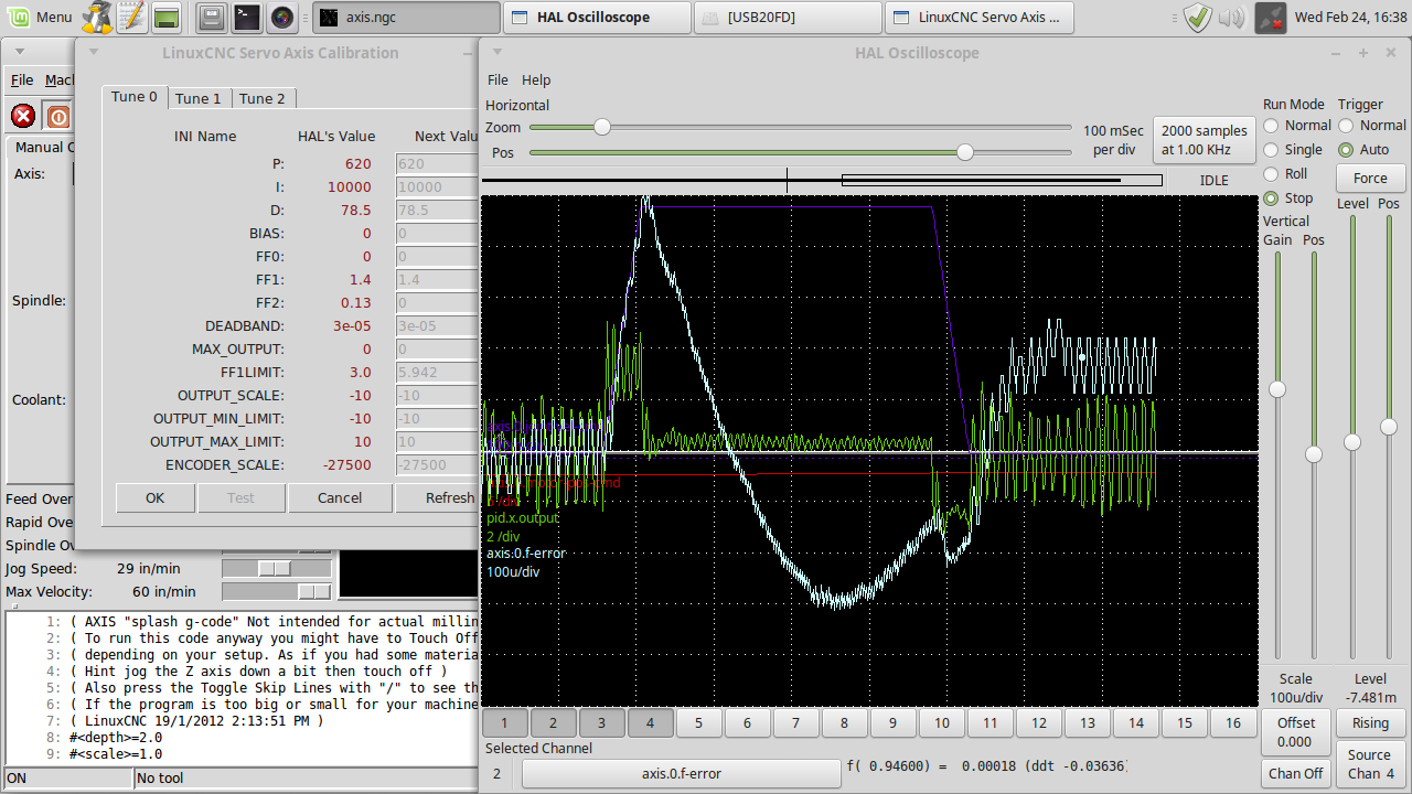

24 Feb 2021 22:23 #200042
by new2linux
Replied by new2linux on topic A-M-C A12A100 Servo Drive with SouthWestern Ind ProtoTrak Plus

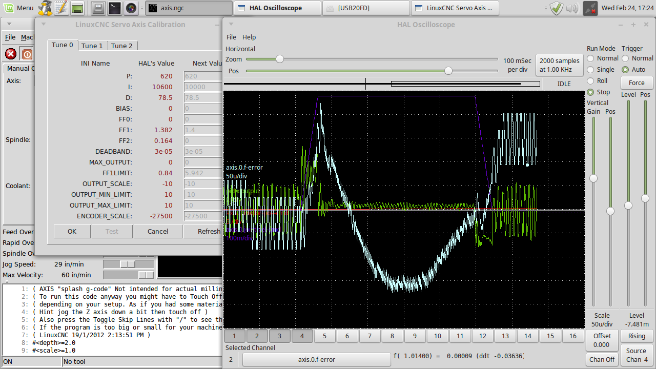

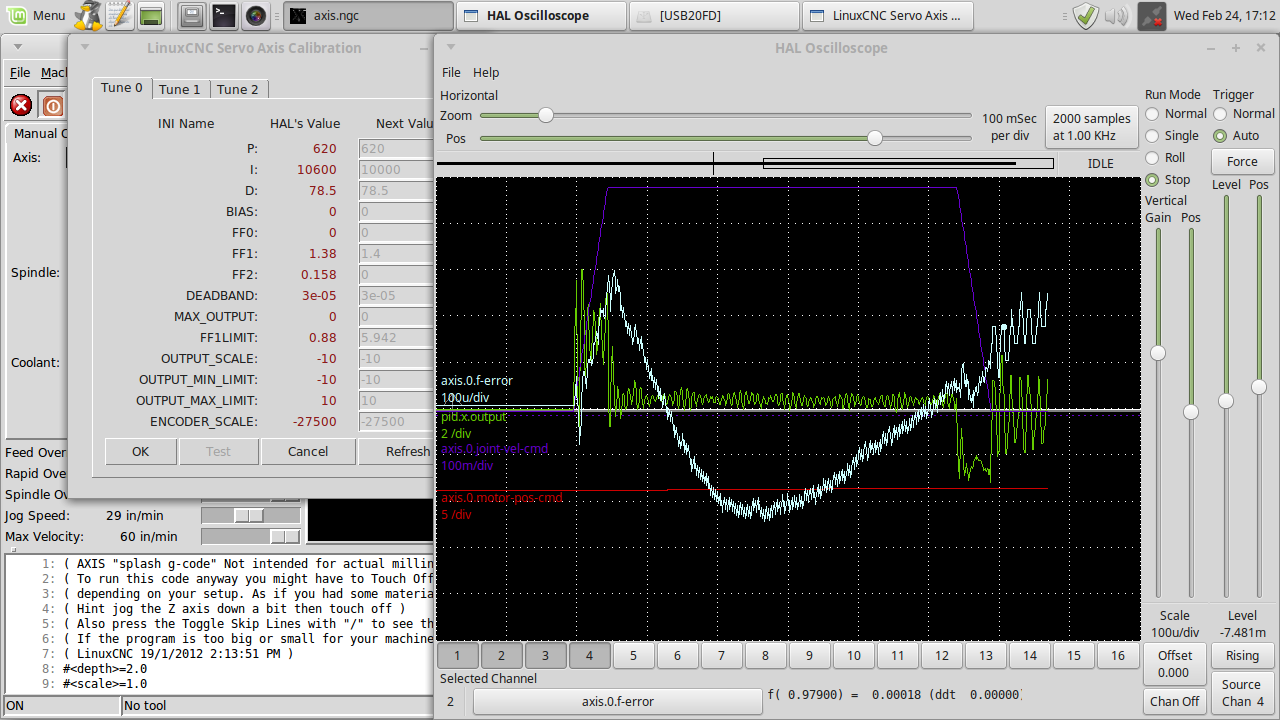

Todd, Many thanks for the help!! Attached are some of many pics of the trace. I will only post a few of the best (from my limited knowledge) trace with low error, check the units, they move around!!! The very 1st pic and very last pic are almost identical settings, all are the same feed 29"/min. many thanks!

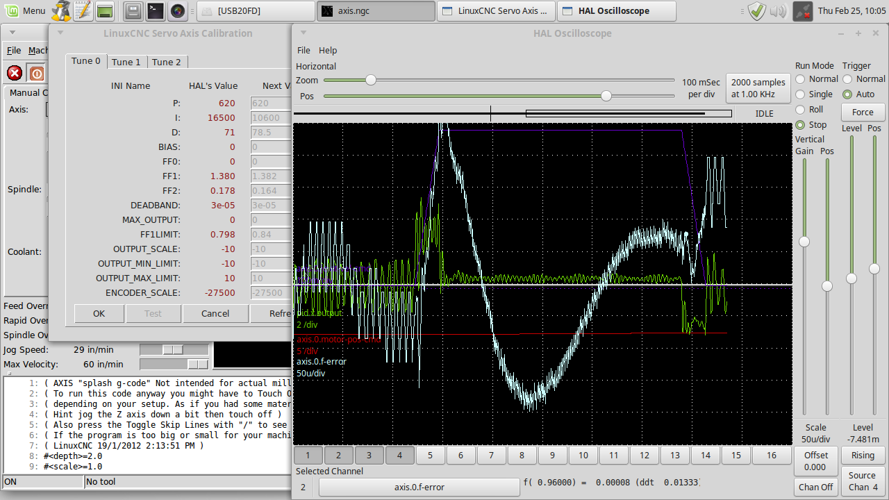

Todd and PCW, Many thanks for your help as per Todd's earlier post that reads: (10 Feb 2021 19:56 #198318)
"You need more FF2 to improve the f-error in the area circled red, and more FF1 to improve the area circled yellow"
The yellow circled area is controlled by FF1, more FF1 is to make the pid x output, get closer to the horizontal line as gain goes up?
In the following pic (at Todd's post) has circled in orange, the area of interest is the 1st area that crossed the horizontal line (between the numbers 4 & 5 at bottom of that screen pic), that shows too much FF2. It should go just up to line, but not cross over?
My plan is to revisit I, FF1, FF2 & FF1 LIMIT. Small up and down at each setting and I want to have clear vision of what success looks like.
In my prior post of pics there is only 1 with the FF1 LIMIT of.84 has gain set at 50/div.
many thanks!!
many thanks!!

25 Feb 2021 15:26 #200098
by new2linux

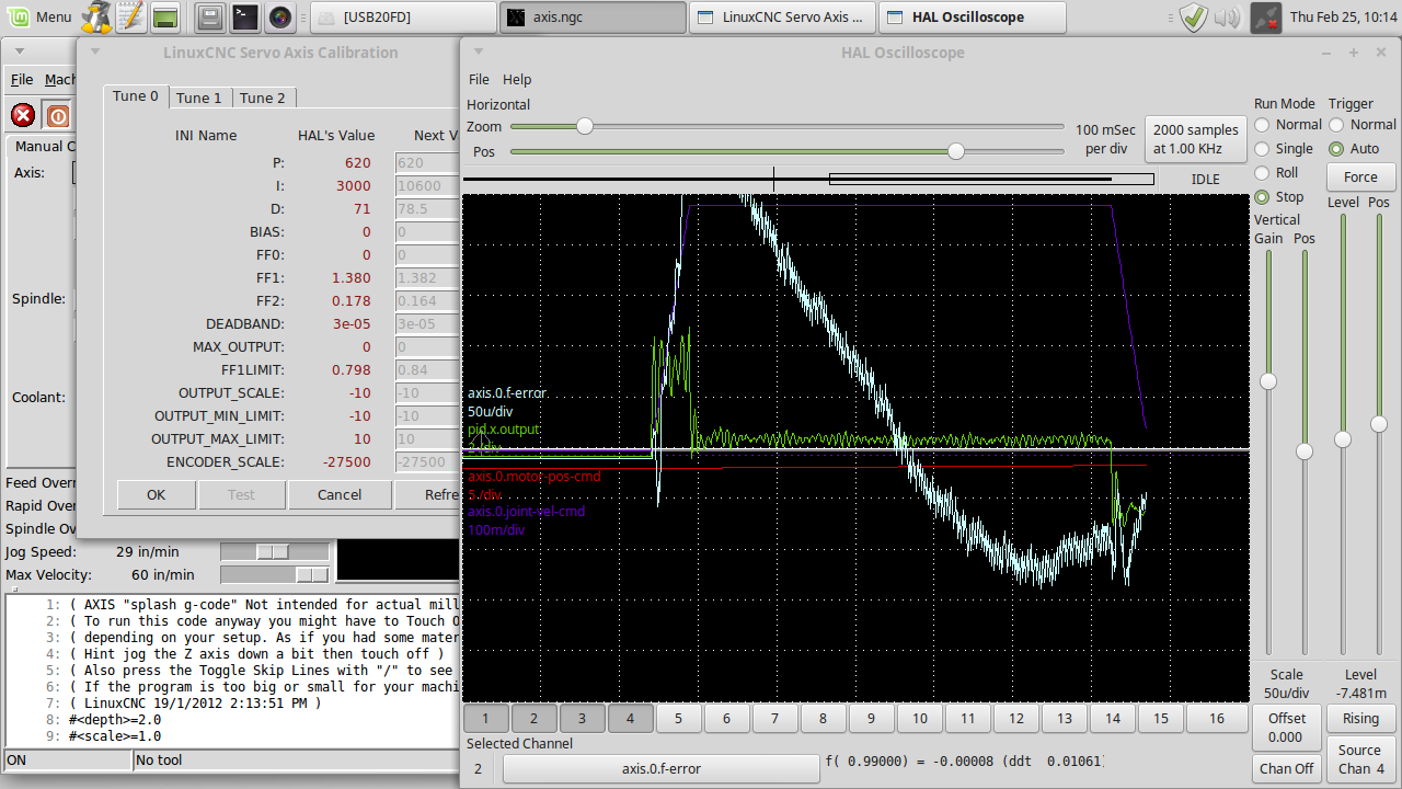

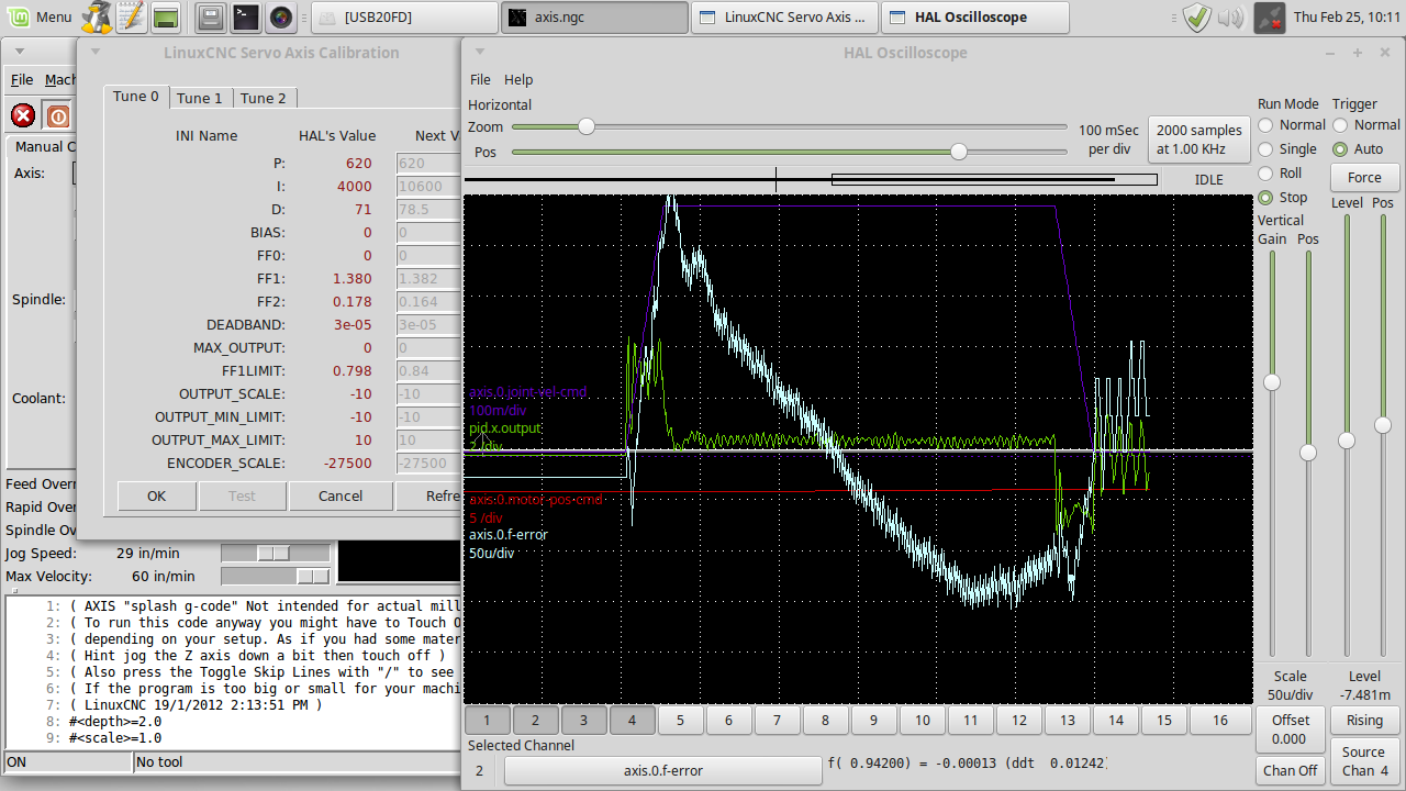

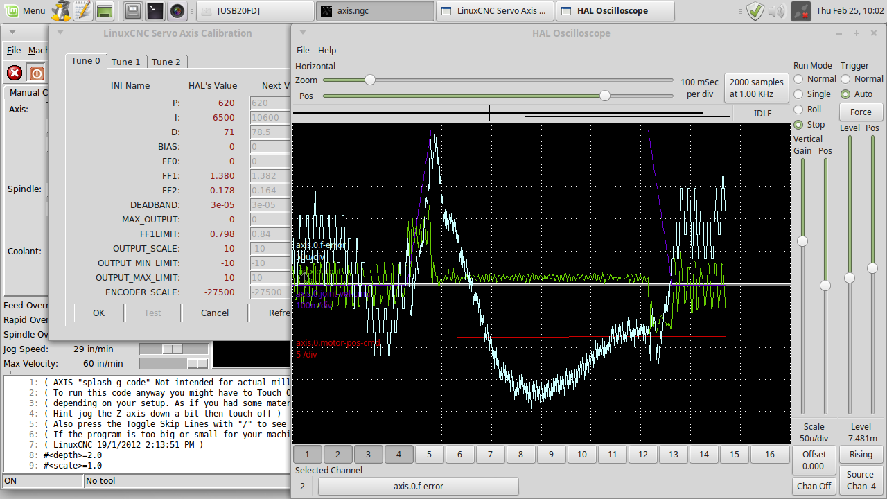

Todd and PCW, Many thanks! Attached are pics of how the I effect and the FF1 limit. All same gain units. I think the lower "I" has lower f error. many thanks!

I don't think ff1limit is going to work. May I suggest trying out a dual PID loop? But it is fairly complicated hal code to set up.
If you post copies of your current hal and ini files I could try to modify them for you to do that. But I am a bit busy today, might not be able to get to it till tomorrow.
