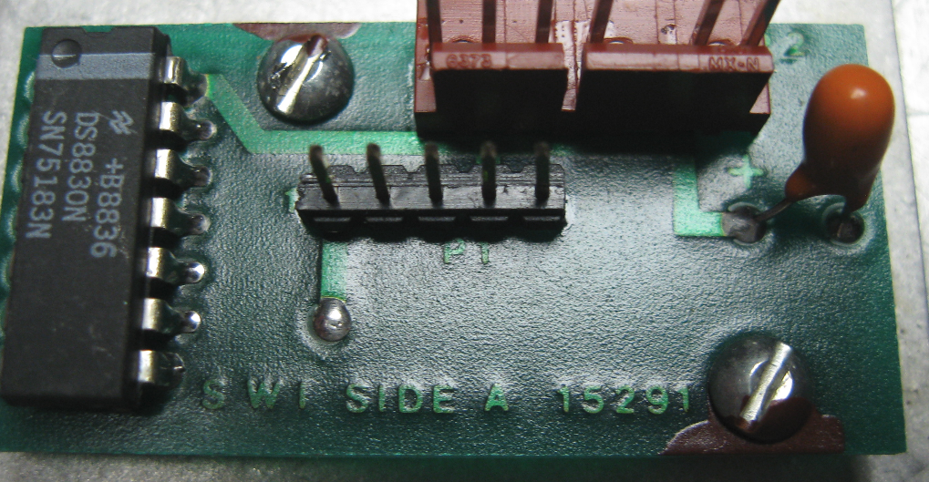

Todd & PCW, Many thanks for the help. This component in the pic (the file is too large to attach) is the 1 part that has not been accounted for, during the encoder replacement. It is located inside with the encoder wheel on end of motor. This quote is what was said at the time. I have email asking the question, if this could cause the problems & if stocked item. Described the problem as: Why is the drive so sluggish with a full current command?
This is the quote:
"All that to say, I think you could use a single-ended encoder
directly, and bypass the circuit board with the DS8830N chip on it, it
doesn't sound like you need it at all. We do have a similar device,
that converts single-ended to differential, but it looks like it may
be unnecessary. I can provide a list of part numbers to do this either
way, completely single-ended, or with the differential line driver
added, it's up to you."
If there is any possibility this will fix and is a stocked item, I will buy them. I will try to get a picture attached. Many, many thanks for the help.
This is the quote:

Unless you are having physical position errors, that is , the machine accumulates
position errors after many moves as measured by a dial gauge. there is no reason
to be concerned about the encoder connections.
