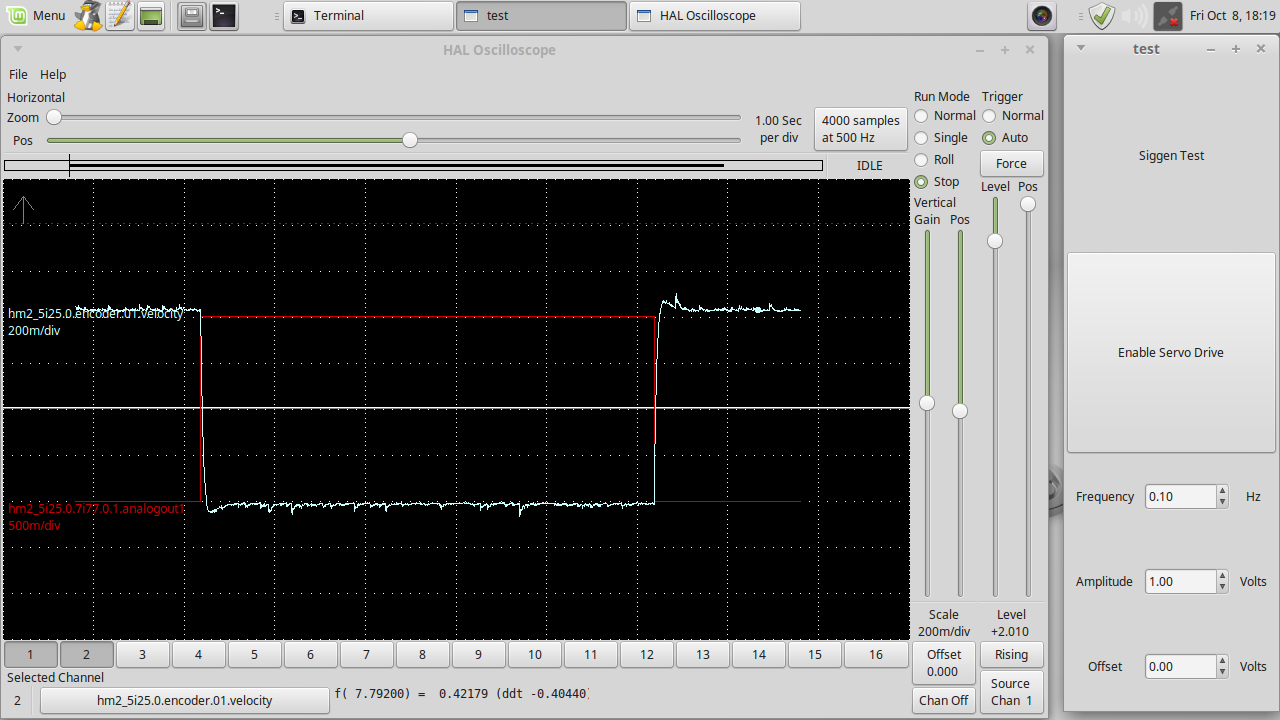

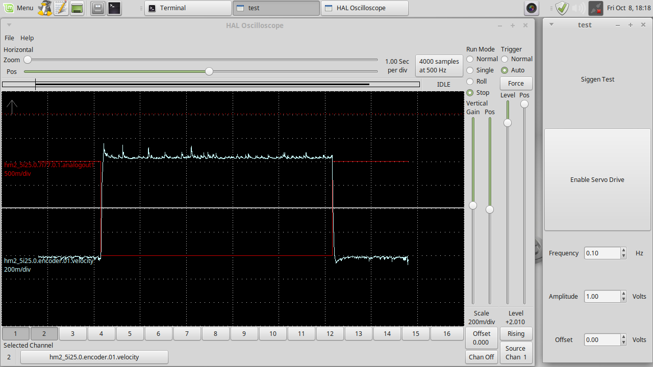

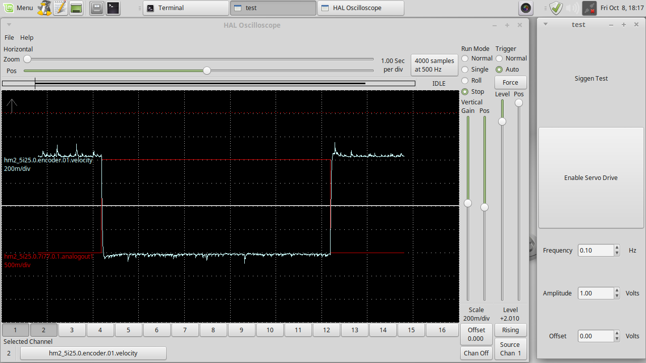

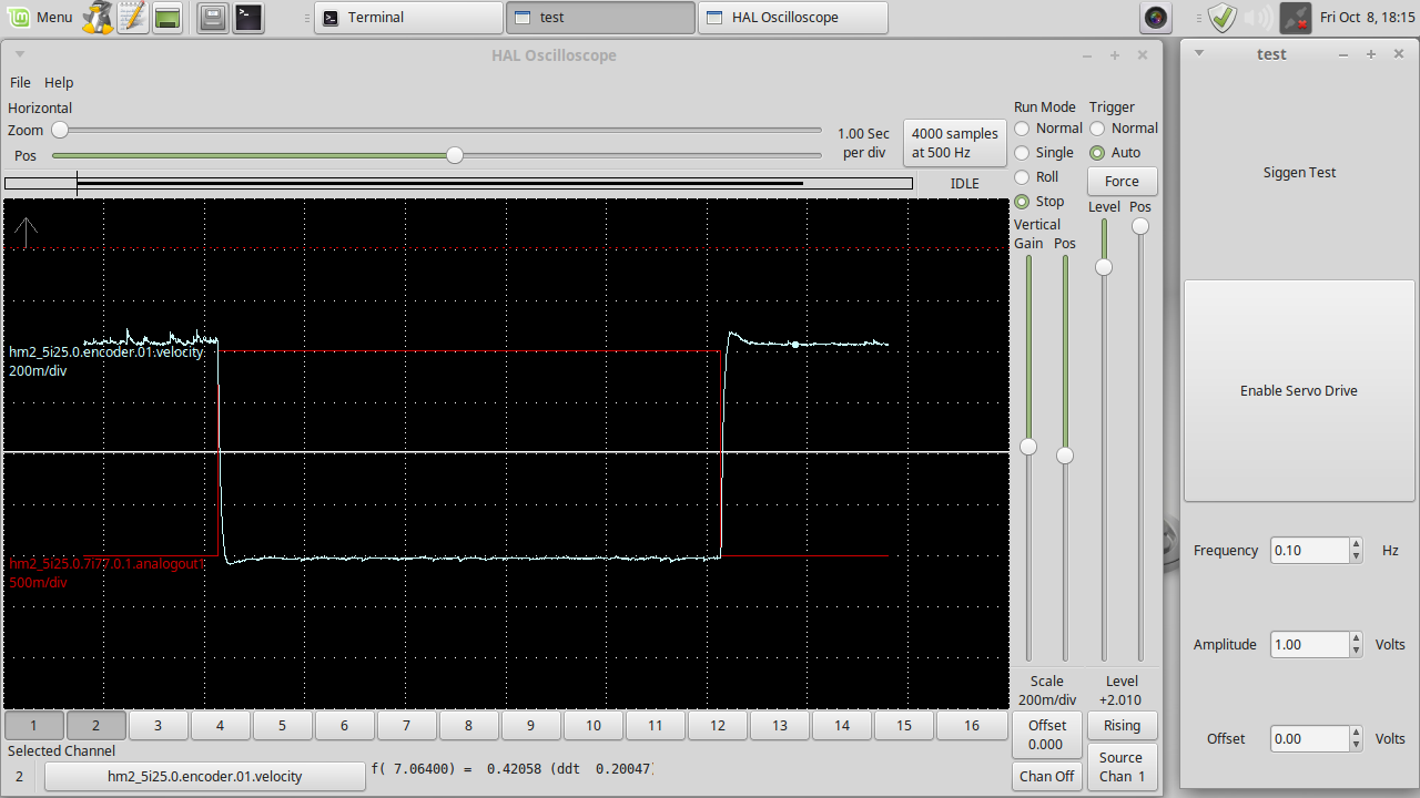

Todd, Many thanks!! I see what you were saying, the attached pics (there are 2 of the same, Pot1=12.0), the 11.75 trace (not attached) has a larger over-shoot, and you will see that the traces get jagged as the turns increase (I believe my file settings are recorded correct), but compare 12.125 to 12.25 & it makes me wonder, if you notice the pics are of the "y" axes going 2 different directions, + vs. -.
This 12.0 looks good to me, what do you think?? I can set SW2 to next setting & try Pot1 again, if there is a belief, that much overlap of settings.
Many thanks
Many thanks
- Todd Zuercher
- Posts: 4774
- Thank you received: 1467
31 Aug 2022 18:35 #250877
Replied by Todd Zuercher on topic Set up using AMC AB15A100 drives, brushed DC motor Prototrak Plus with Encoders
Yes, much, much better. I think reducing that last little bit of overshoot could be a good thing, but if it isn't possible I think you may be good enough now to start tuning the position loop.

31 Aug 2022 18:58 #250879
by new2linux
Replied by new2linux on topic Set up using AMC AB15A100 drives, brushed DC motor Prototrak Plus with Encoders
Todd, Thanks!! I will try the next SW2 setting with Pot 1 to see for myself, later today.
Will this setting (1.147mF; Pot1=12.0 CW) be ok for the "x" axes as well, or should I set up for x, this involves edit the .hal file, from "y" to "x" & from 1 to 0?
The position loop, this is tuning (P;I;D;FF1;FF2 & DEADBAND) or something else.
Many thanks!
Many thanks!

31 Aug 2022 19:19 #250880
It would be best to at least test the settings for the X and you may find it needs slightly different settings.
Yes, tuning the position loop is tuning the P, I, D, FF1, and FF2 in Linuxcnc.
The way the drive is set up now, I don't think FF1=1 will be correct. I suspect the right setting will probably be a little less than 0.5 for FF1 for the Y axis.

31 Aug 2022 19:27 #250881
by new2linux

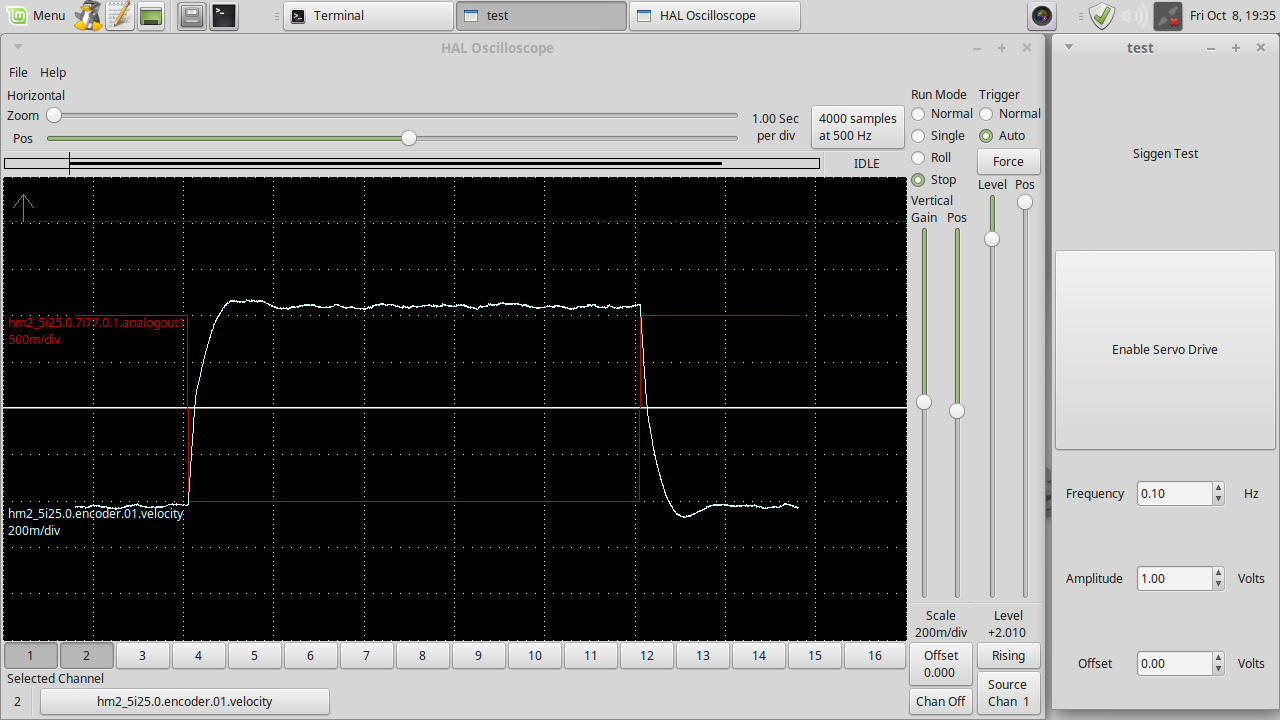

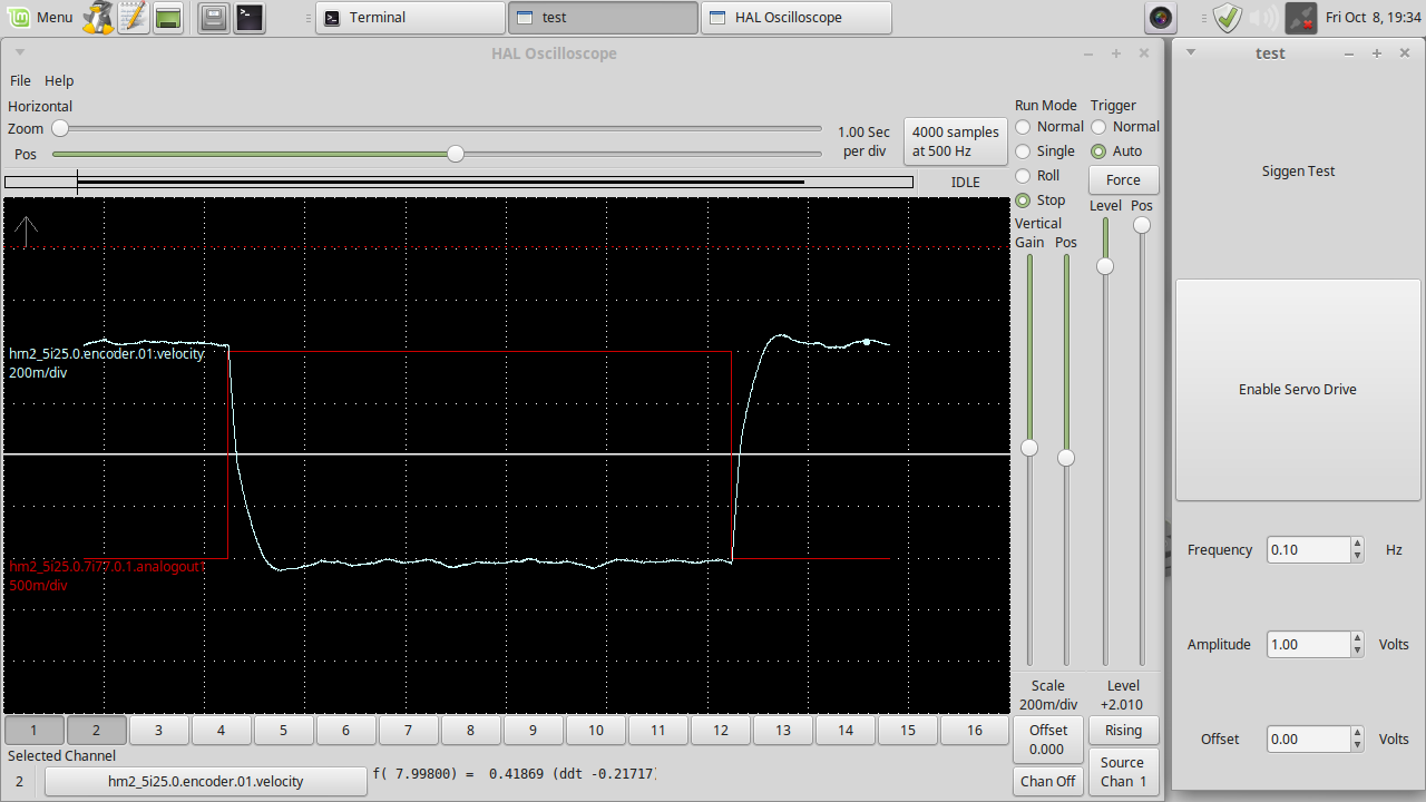

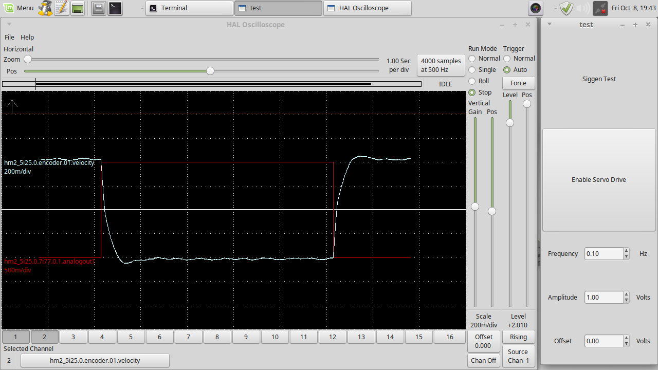

Todd, Thanks! Attached are pics of the SW2=1.267(next setting as per table) with Pot1 adjusted from 6.0 to 8.0, the best are 6.75 & 7.0, but nor as good as 1.147 with 12.0 CW. What do you think?
Many thanks!
Many thanks!

31 Aug 2022 19:55 #250884
by new2linux

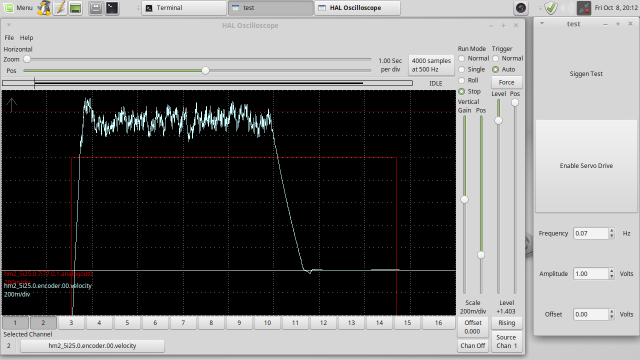

Todd, Thanks. I have set up (edited, .hal file) for "x" axes, by "#" so x axes will work proper. If you see the attached pic & setting for the frequency is at .07, lower than y axes. It appeared to "run away" with frequency at .1, now with setting at .07 (still real fast) the trace still looks like still too high. The SW2 setting is 1.147 with Pot1 at 9 turns. Have I set the Hal-Scope proper? I will work the settings more, need confidence that scope is set proper.
Many thanks.
Many thanks.
- Todd Zuercher
- Posts: 4774
31 Aug 2022 20:11 #250885
Turn down pot3 some, that should reduce how fast the drive thinks a 1v command is.
- Todd Zuercher
- Posts: 4774
31 Aug 2022 20:14 #250887
Also the Frequency setting in the Siggen test is how long the pusles last before changing direction, the Amplitude (volts) determines how fast the move is.

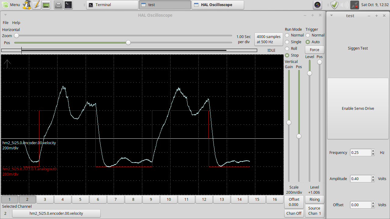

01 Sep 2022 12:23 #250919
by new2linux
Todd, thank you! I need a 2nd opinion about the settings for the "x" axes, in the "test" screen, specifically Frequency (the "Y" axes, was .1Hz & 1.0V to "X" axes .25 Hz & .4 V) & Amplitude values.
Will the settings shown work, or what does it need, before I take more pics?
Prior to taking the pic the "x" axes was a great deal quicker at moving to the left, using Pot4 trying to balance, if not the table ends up at 1 end of travel after several tests.
Pot 3 in the pic is set to 6.5, only 1/2 turn different from "y" axes, all else is the same.
Many thanks
Many thanks
- Todd Zuercher
- Posts: 4774
01 Sep 2022 13:59 #250924
It looks as if there is a great deal more friction to moving the X in one direction than the other. (This is more likely why it was moving faster one way than the other.) This implies that there is a mechanical issue that needs addressed. Are all the ways properly lubricated? Are the gibs properly adjusted? What are the condition of the ways? If it uses a lead screw, is the nut worn or lacking lube? Often if a horizontal axis is more difficult to move one way than the other, this is because of a gib adjustment issue, if one is too loose what can happen is that the table can rack moving in one direction putting the ways and screw in a bind making it a lot harder to move one way than the other. A worn out lead-screw nut can also often bind up one way more than the other.
The plot also looks like a lot more Pot1 resistance and more SW2 ohms are needed. Mostly because the X axis is harder to move than the Y was.
