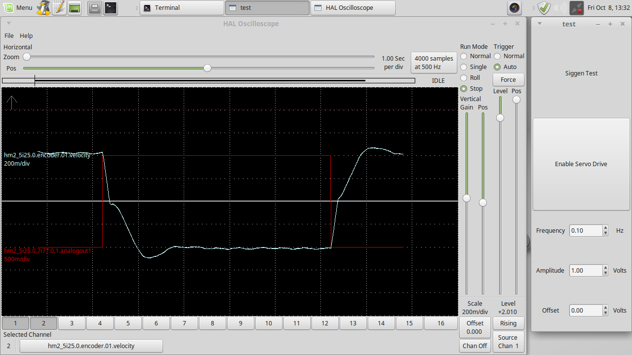

So what effect does adjusting Pot1 have on the plot? It would be useful to see a series of plots, with one or two turns of pot1 clockwise and one or two counter clockwise, all with the same SW2 settings. To try to get a feel for what is going on.

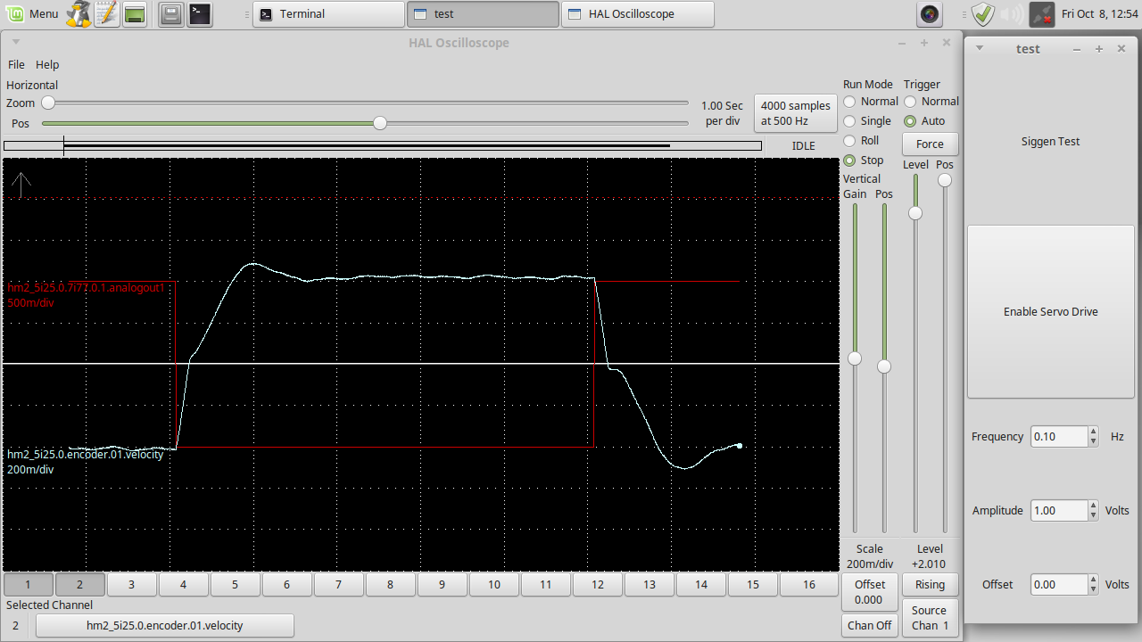

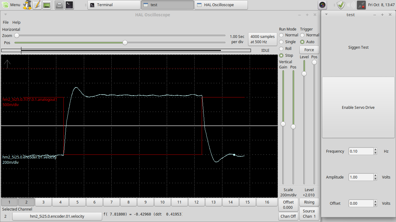

Todd, Many thanks! Pot 1 setting does not do as much as I was hoping for, attached are many traces (in .zip folder: too large to attach) with SW2 setting as per file name in reference to chart mF. Attached are 3 (1 of each SW2 setting) pics that show very little trace improvement from the traces all ready posted. The slope of the trace (I need experienced eyes to understand) does not improve and the sharp corner does not seem to appear. I found that it was helpful to set both drives to same (SW2 settings) settings, the "x" axes (I am working the "y" axes) was traveling (I had already try Pot4) but after keeping the SW2 the same on both drive seemed to help with this. If you compare these attached files to the ones already posted there is still a spike/hump that is over travel.

That looks like moving in the wrong direction. What happens with a greater number of turns of pot1 (rather than lower)? (Assuming the numbers in the image names represent CW turns from the CCW stop.)

The image "sw1.147pot1 7.0" is certainly the best of that lot.
Is seven turns as far as pot1 will go? If it will go further, you may find that increasing the ohms with SW2 is needed to tame the overshoot caused by a more aggressive setting with pot1.
