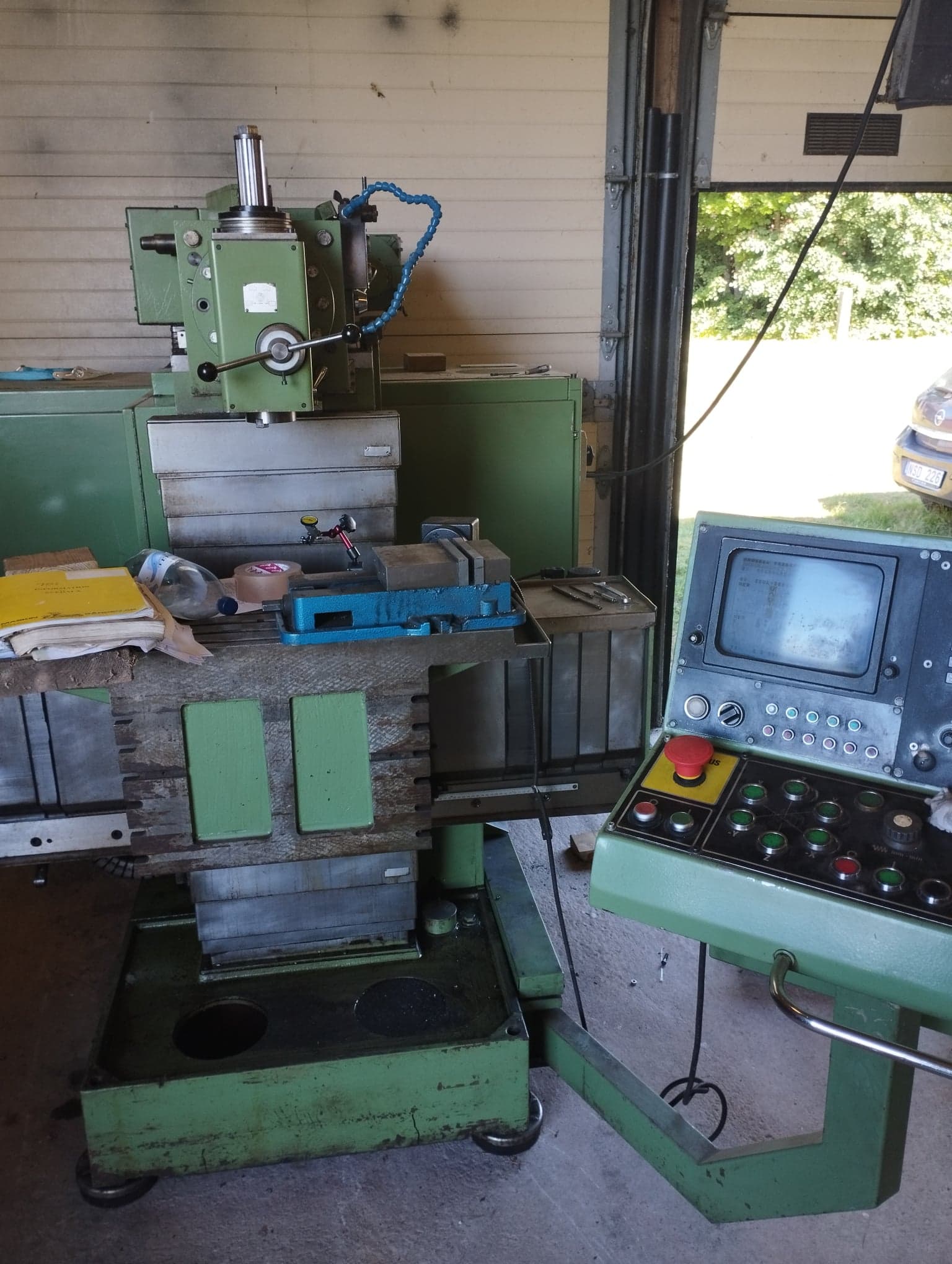

Hello
I recently started my own company here in Sweden to manufacture bottle filling machines. To do that I would need a milling machine and I bought a TOS FNG 32 NC with a Heidenhain TNC 150. The plan was to use to the existing control system which was fully working when i bought the machine, unfortunately it seems like something in the old electronics broke during transport. I cant find anyone to come here and repair my machine either, not many people that can repair TNC 150 are around.
Plan B is to change the control system to LinuxCNC. I really hope I can use as much as possible of the old electronics. Servo drives and spindle driver especially.I dont know today how to control the servos and spindle drive. Is 0-10V the most common?It uses a Siemens 6RA 2620-6DV 57 for the spindle.I believe its a DC motor. The servos is controlled by 6RB 2025-3EA01.
I still have some reading to do before I order any parts. I will probably use some Mesa board. I dont know how the positioning works, it seems like my machine has both linear scales and an encoder on the servo. Should I use both also?Best regards

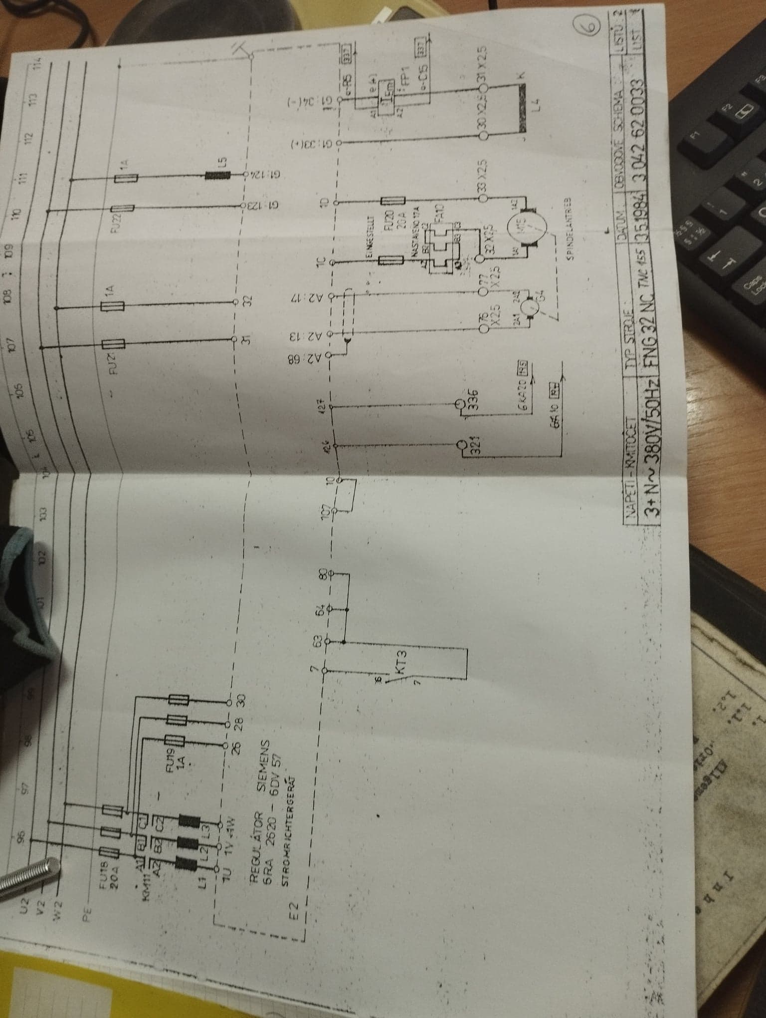

Do you have all the schematics for it?
If yes, first thing is to scan them and make a copy for yourself so you can write what you are wiring where and what is changing, makes maintenance later very comfortable.
Then upload those here or on you google drive and make them public so we can have a look at them, we can figure out pretty much everything from them, granted checks have to be done all the time during retrofitting to make sure the schematics reflect whats on the machine, there are almost always some minor errors there.
Also take a lot of pictures now, connectors, wiring, switches, everything, it makes it easier to find where that dangling connector came out off.

Yes I have all of the schematics.
Upload them on Drive and make them public is a goof idea, I will do that.
And lots of pictures
I think I will remove almost everything in the electrical cabinets except for the drives and only keep what I need on the machine.
The plan is to make completely new schematics.

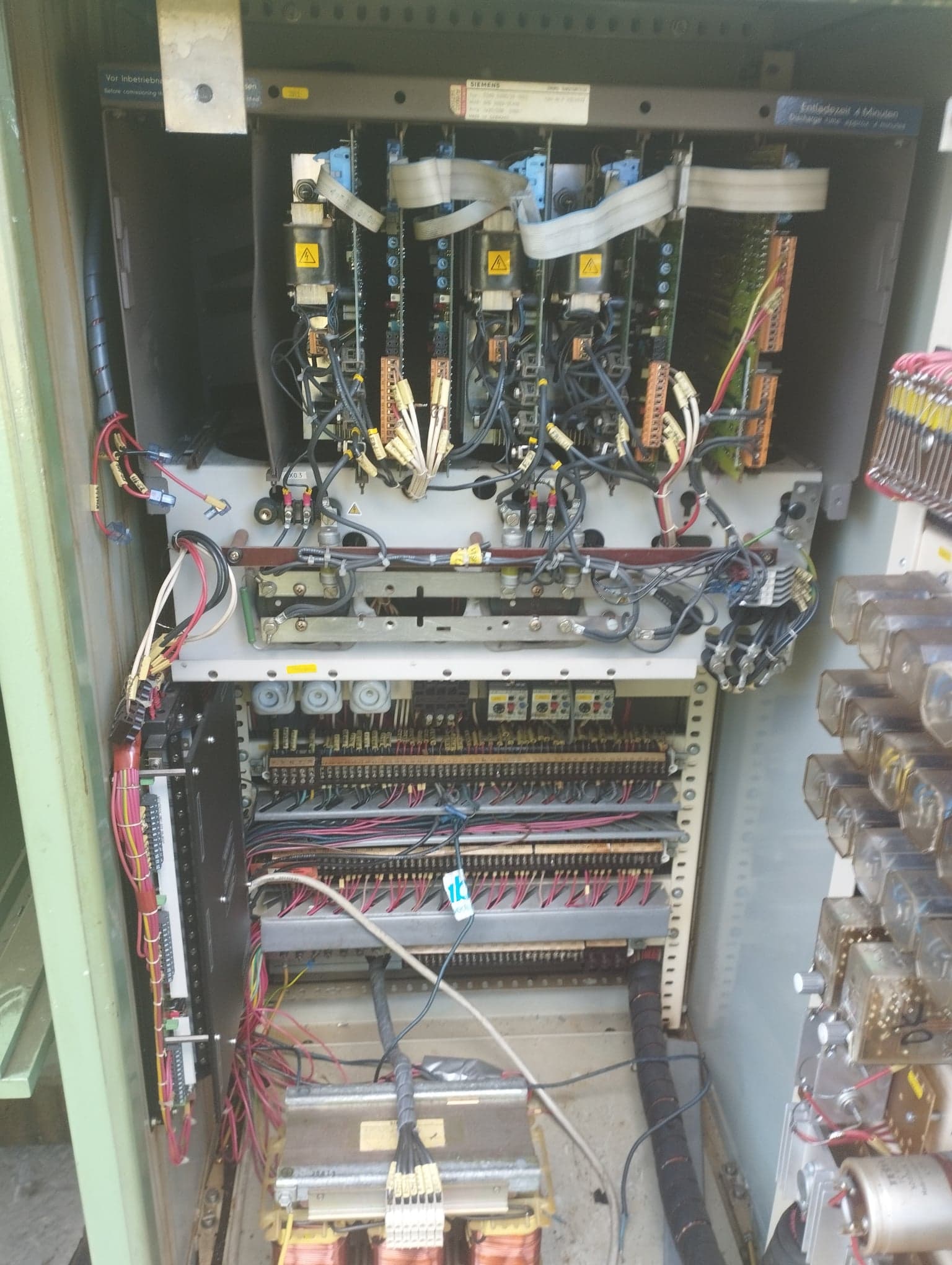

Hold that off for a while, something might prove very useful later.I think I will remove almost everything in the electrical cabinets except for the drives and only keep what I need on the machine.

I agree with Tommy, dont remove anything yet untill you decide how you want to do the retrofit.
I have used those same siemens drives for a recent retrofit of a 5 axis K+T machine.
Yes, they are DC, and Yes, they are +/- 10v analog control. Perfectly useable with a Mesa 7i77.
in my opinion, there are two ways to go about this retrofit.
Henk
- Remove only the old controller, screen and some parts of the old control, like the keypad for example. the control will have cables plugged into it for the digital input and output signals, encoder feedback and so on. you need to make sure you can identify these cables and their pinout. Then remove the control, and install the Mesa kit, and wire these cables to that. the rest can most probably stay the same.
- if you decide to replace everything electrical besides the drives, then a complete strip down of the panel is the best way, but if you have not retrofitted or designed/wired a panel like this i would not reccomend it
Henk

After thinking about it, I think your nr 1 is the best way forward.
I have some experience from my previous job where I did build electrical stuff for industrial robots, but I believe this will be a difficult project for me.
I have all the schematics so I should be able to identify every cable coming out from the control system and put on a new lable. The original labeling was written by hand with a sharpie and has faded so its difficult to read.
