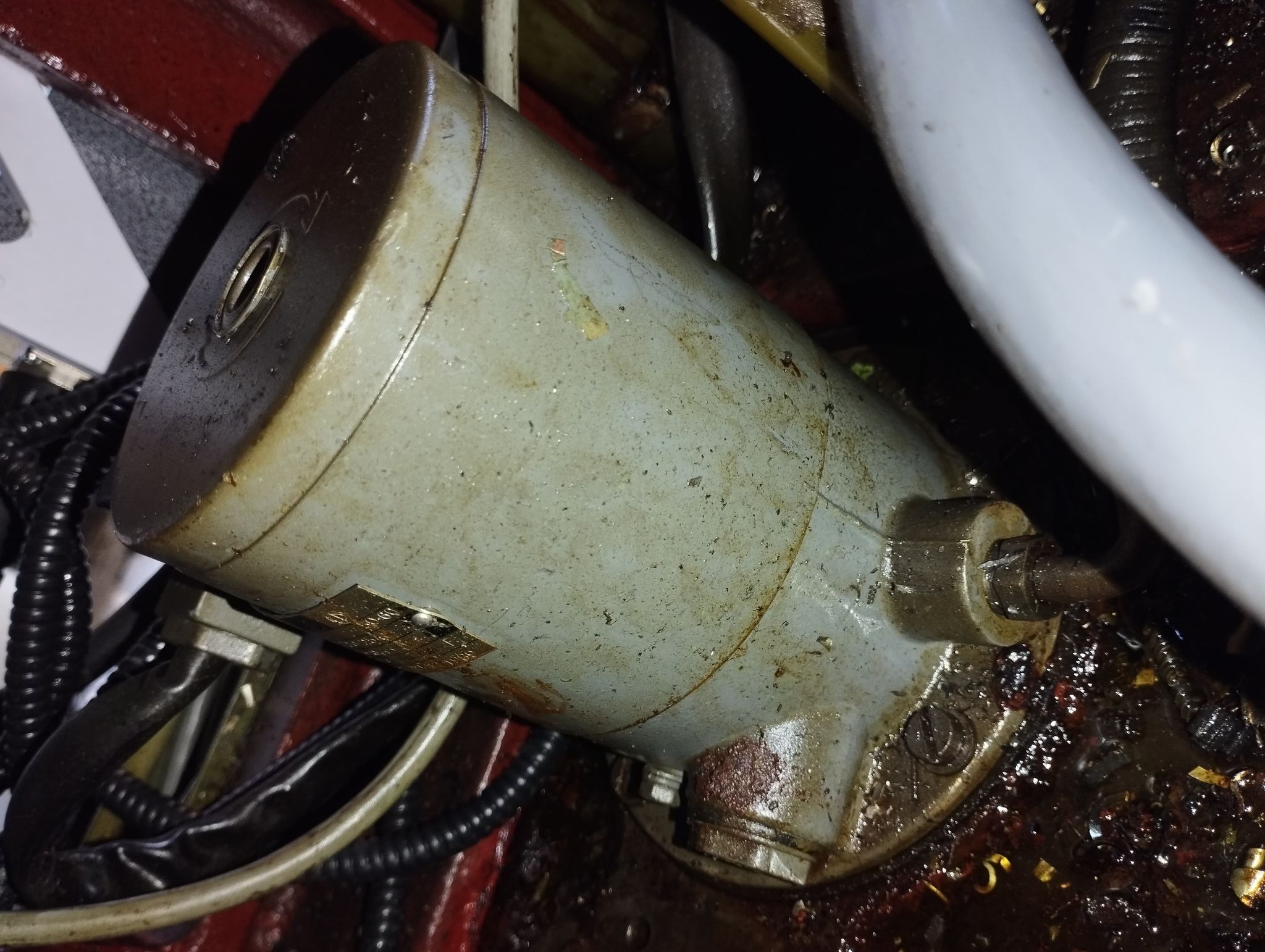

Thank you, this is my first milling machine.
I suspect that to. I also have two more motors i'm not sure about, the first one is mounted on the bottom base of the machine. I think this one could be the build-in pump for flood cooling. The previous owner used an external cooling pump that stood beside the machine and I will use the same pump.
Then there is a third motor that I don't have located yet. I can hear it starting when engage the contactor but i'm not sure where its coming from. This would be easier tomorrow when I'm not alone in the workshop

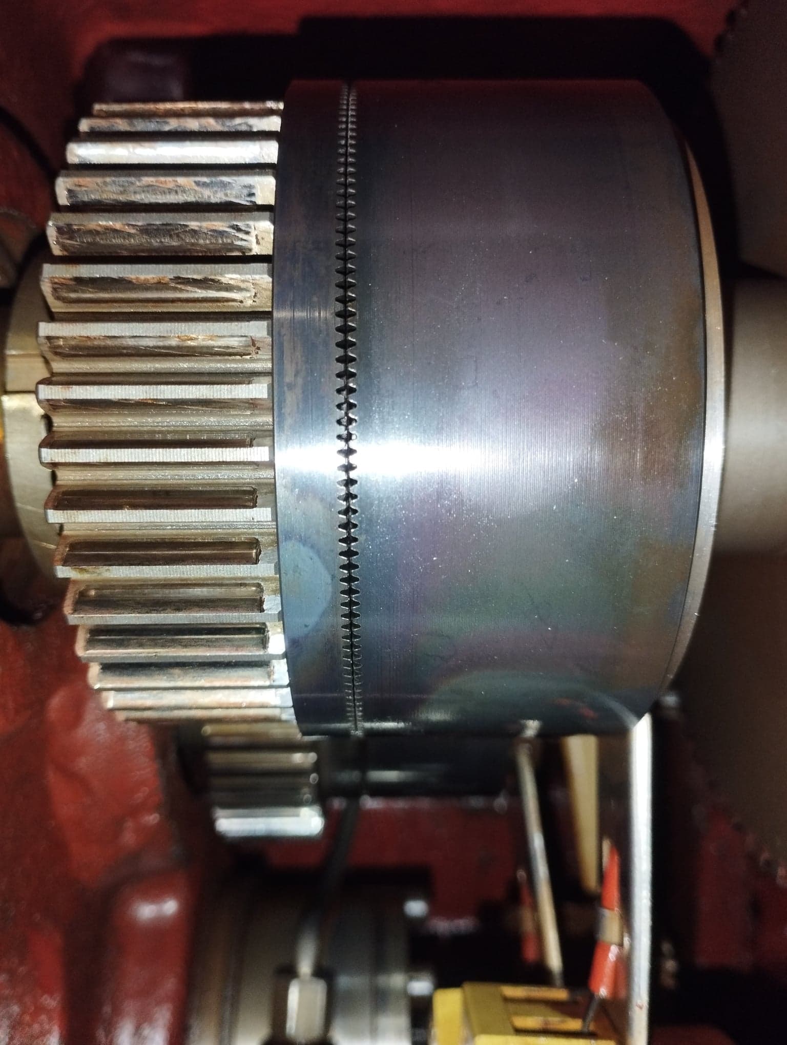

Ok, turns out that I had misunderstood how the gears work. They are not hydraulic at all, instead they are controlled by an electromagnetic tooth clutch, one for each gear so it makes it easy to control. I just give them 24V and they engage.
The hydraulics is used to automaticly release the tool but that function has been removed. It is also used to counter balance the table.

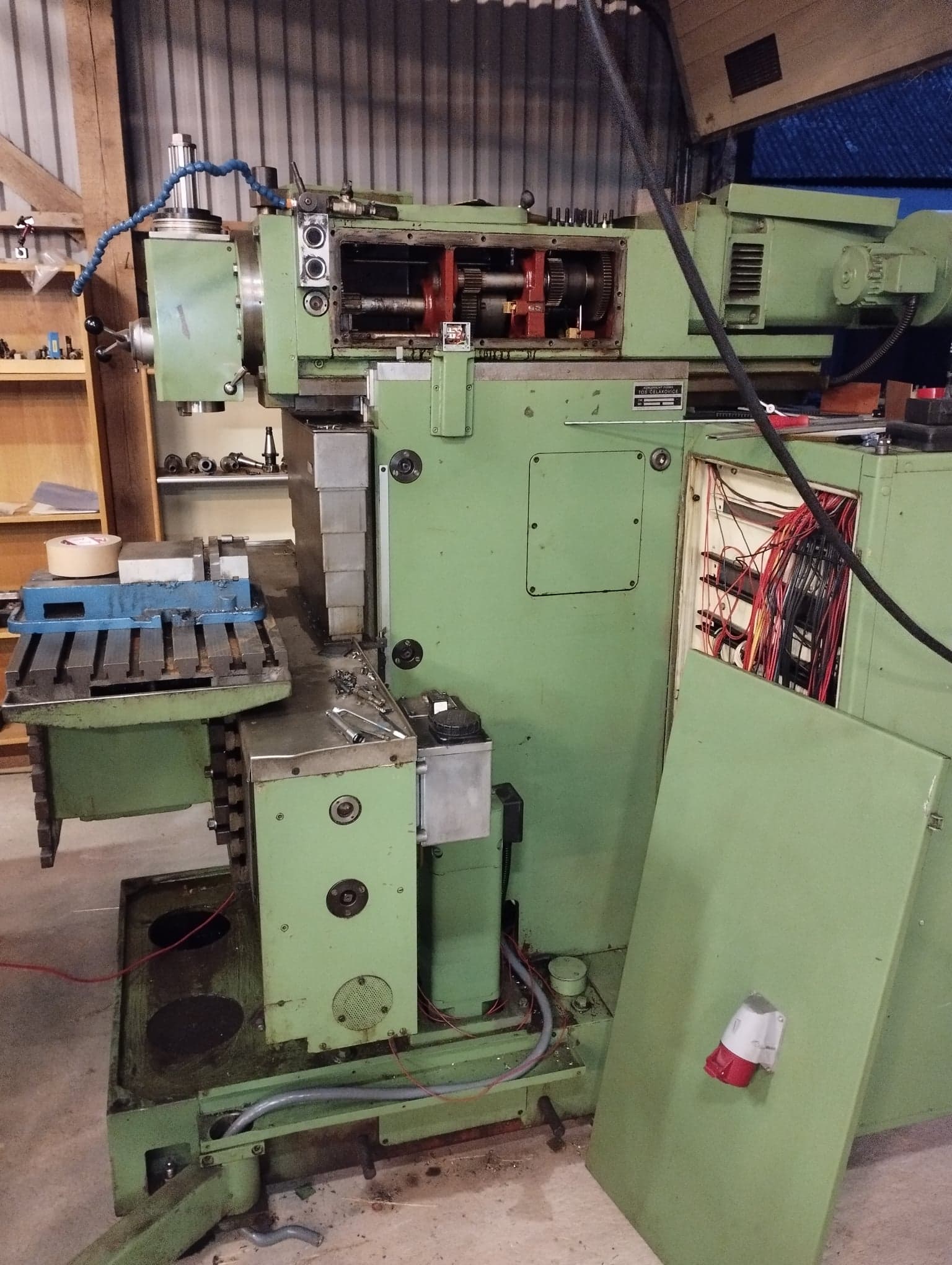

I tried to run XYZ today but I have some problems.
When I press F2 in Axis, the machine immediately start to move down and to the right. Only about 10mm until I get joint following error.
I have checked the wiring 3 times. One time I unplugged X & Z and the same thing happend to Y after a couple of seconds. It makes a "jump" and I get joint error.

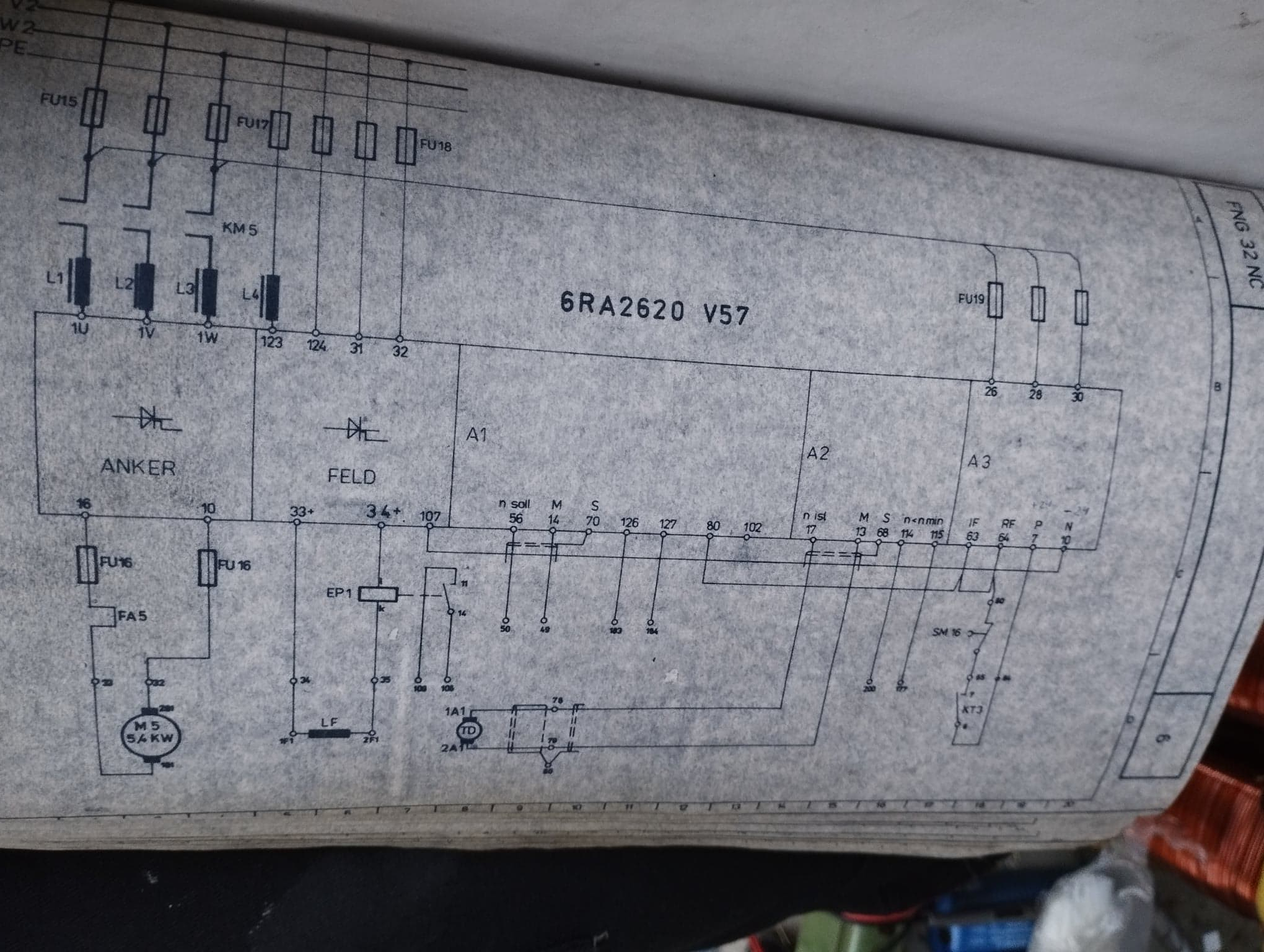

I've been trying to get the spindle running. I see that there is some values you can change inside LinuxCNC calibration, similar to the XYZ. Don't know how to set those up correctly. I dont get the spindle to run at all. Is there something more then to press F9/F10 in Axis?
I have wired from pin 7 -> Enable on Mesa -> 63,64 & 80. My +-10V is beteween 56 & 14.

After F9/F10, F11 and F12 will raise or lower the speed.
