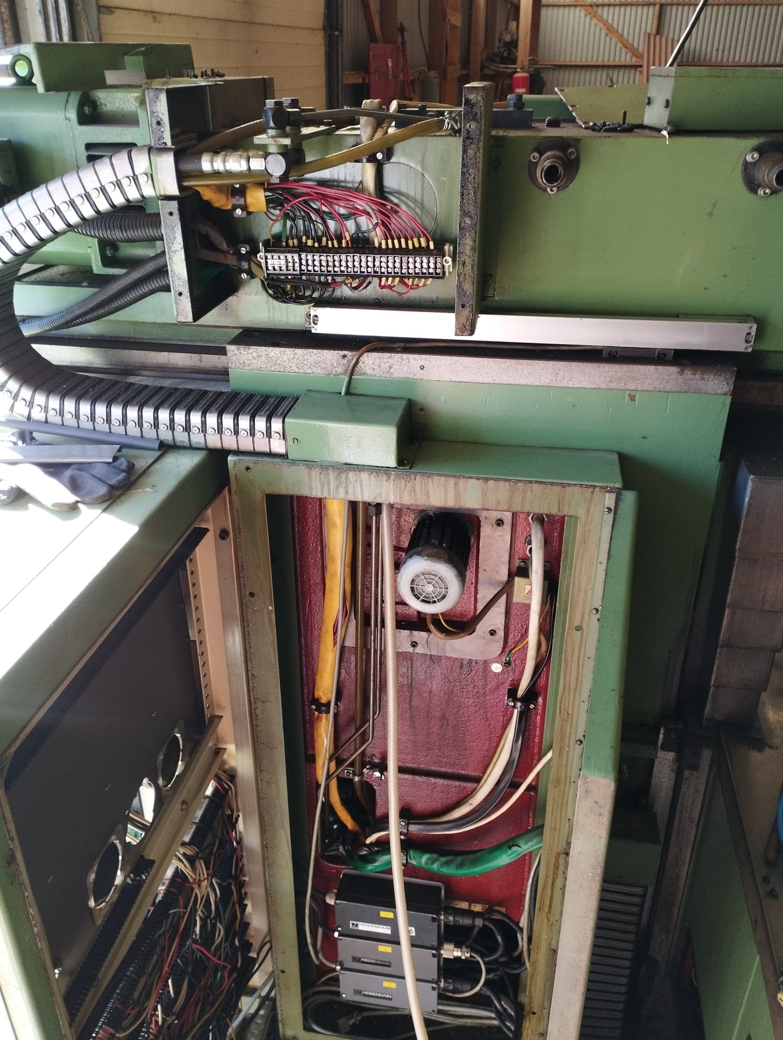

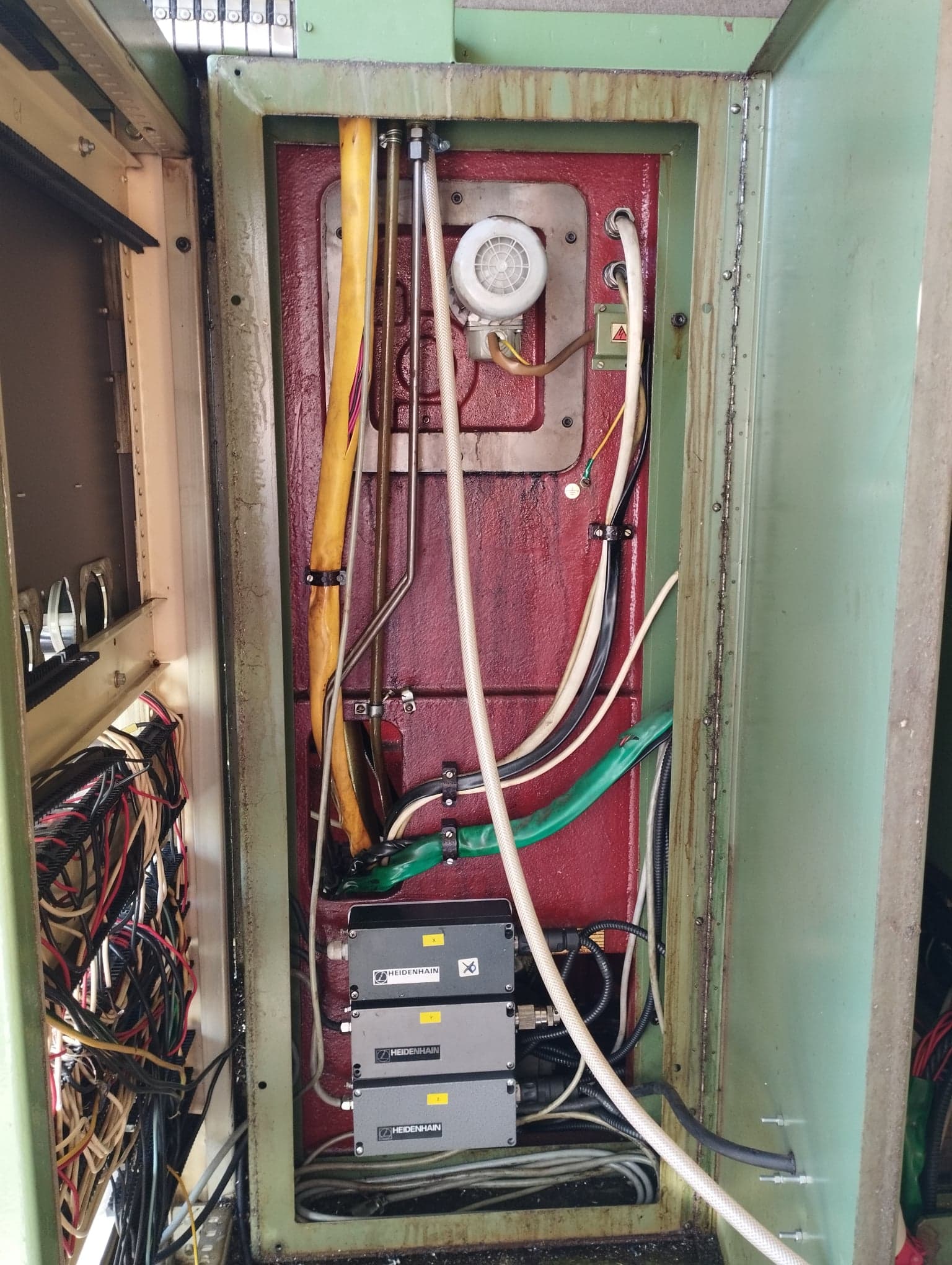

28 Jul 2022 07:21 #248511
by Kevin_Pawlus
Replied by Kevin_Pawlus on topic Retrofitting a TOS FNG 32 NC
I'm working on connecting the remaining things to the Mesa board.
My 3 gears gearbox is controlled by 2 valves. So i'm assuming that:
00 = no gear
01 = first gear
10 = second gear
11 = third gear
I will have to test this and see if I have understand it correctly. I also believe you would always go to 00 every time you shift gear.
On one side of the machine I have this small electric motor. I'm not sure what function it has, does any of you have a clue? Drawings didn't help me much.
Best regards Kevin
00 = no gear
01 = first gear
10 = second gear
11 = third gear
Best regards Kevin
- RotarySMP
- Posts: 1635
- Thank you received: 595
28 Jul 2022 10:58 #248522
by RotarySMP
Replied by RotarySMP on topic Retrofitting a TOS FNG 32 NC
Nice machine.
Could that motor run the central lube system pump?
