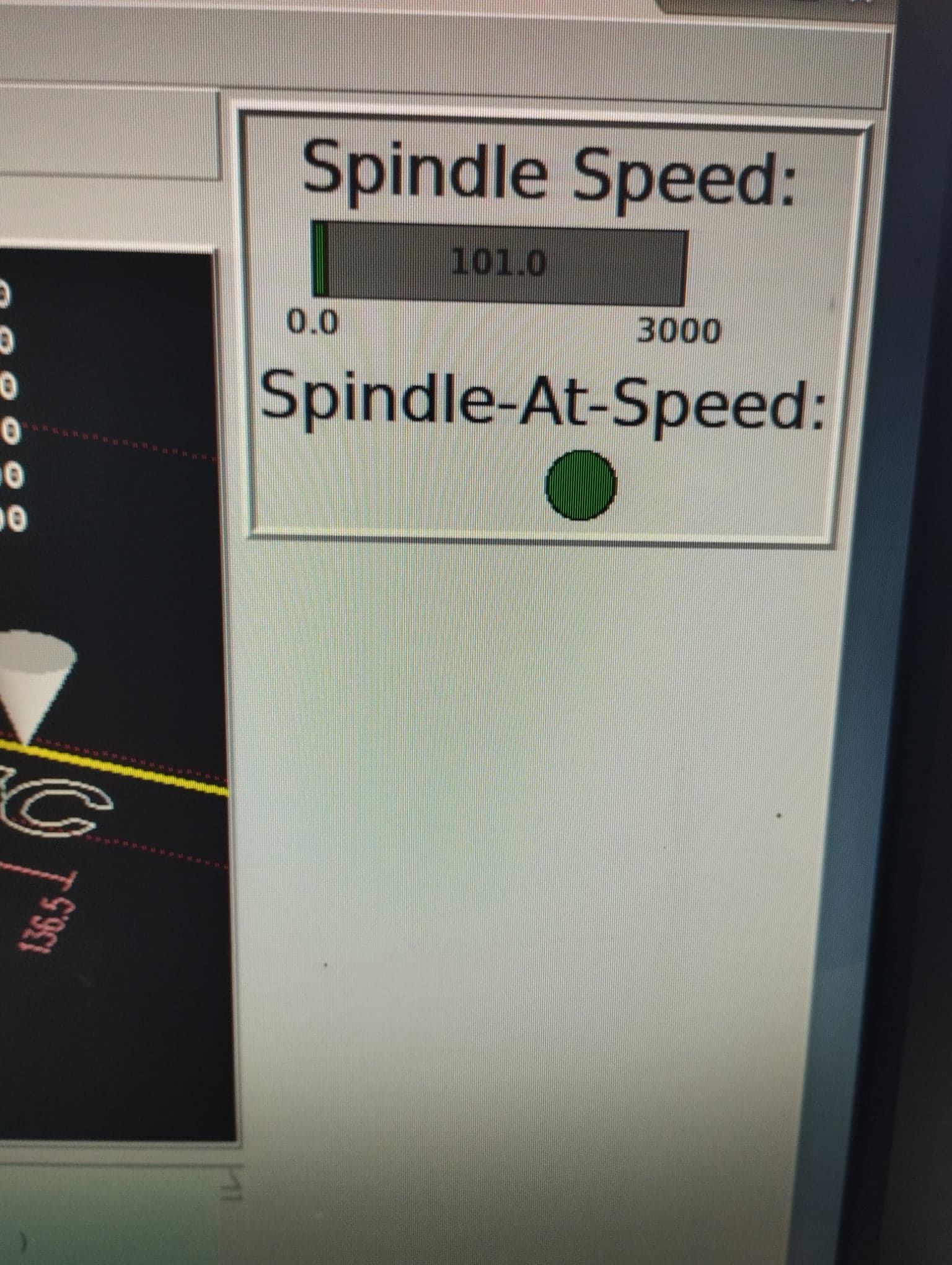

Yes.
It seems like if I run the spindle at the lowest speed it will slowly ramp up and run very fast in about 10 seconds. I think some setting is making my Mesaboard output 10v.

In your .ini file, make the spindle P zero. I doubt that you have a spindle encoder set up at this moment, so it will be zero and the PID will increase the output to try and reach the speed setpoint. With P=0 and FF1=1, the PID does nothing, just passes the input to the output, which is what you want if there is no feedback set up.
Then play with the OUPUT_SCALE value to calibrate the actual speed if you have something at hand to measure the actual speed. Otherwise measure the tacho feedback voltage from the motor. It should be 20V/1000RPM but could be something else.
When LCNC is running, switch on the spindle, then open a terminal and type "setp [HMOT](CARD0).7i77.0.1.analogout5-scalemax xxxx"
where xxxx is the new value you want to test. you may have to replace the "[HMOT](CARD0)" with the actual card description as it appears in hal configuration.

Right, there is no encoder feedback.
It's working now. With P=0 and FF0=1
Thanks.

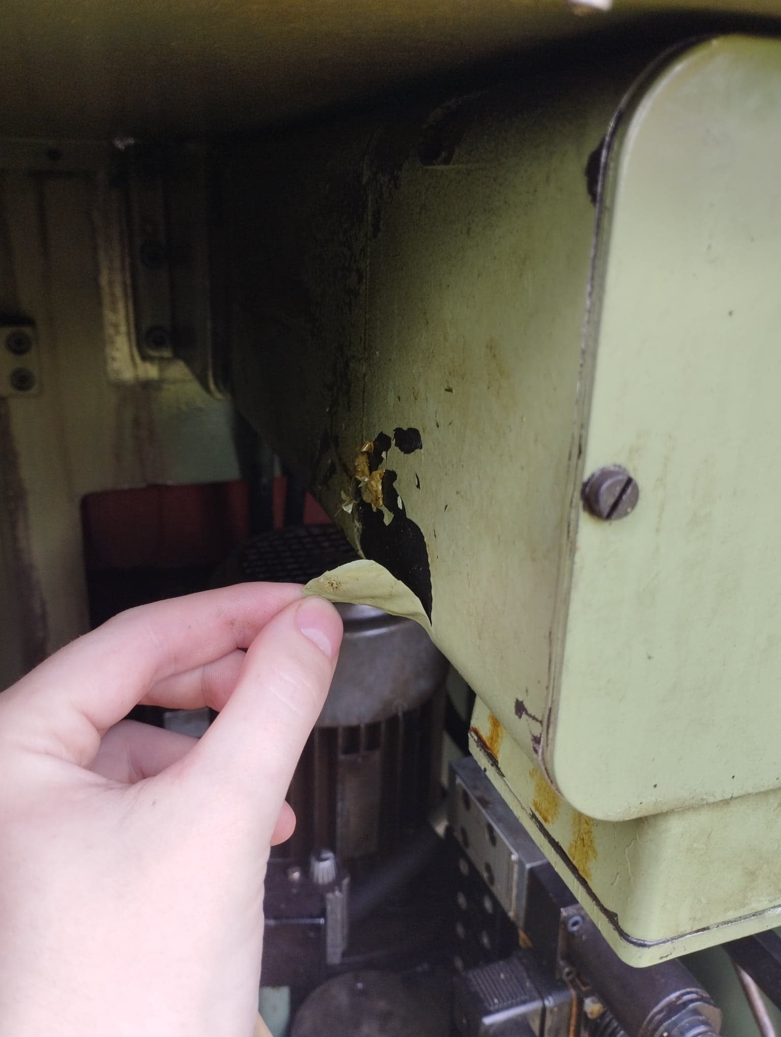

Replied by Kevin_Pawlus on topic Retrofitting a TOS FNG 32 NC
I tried to cut some chips today. It works really good.
Still some things to do of course like programing the buttons. Everything is plugged in and I can see that I get the signal when I push the button.
I did about 2 hours of milling and noticed that Y-motor is getting really hot. So hot that the paint is melting so that's something that needs to be fixed. There is some backlash in Y so you can hear the motor always going back and forth all the time, I don't know if this is the reason. X motor is also quite hot, I don't think its too hot though. Z is only a bit warm.
- Posts: 19899
05 Aug 2022 22:03 #249164
Replied by andypugh on topic Retrofitting a TOS FNG 32 NC
If it was dithering inside the backlash it would be under no load, so probably wouldn't make much heat.
Can you move the axis with the motor unpowered? Try to feel if something is unusually stiff (thrust bearings are a likely culprit)
