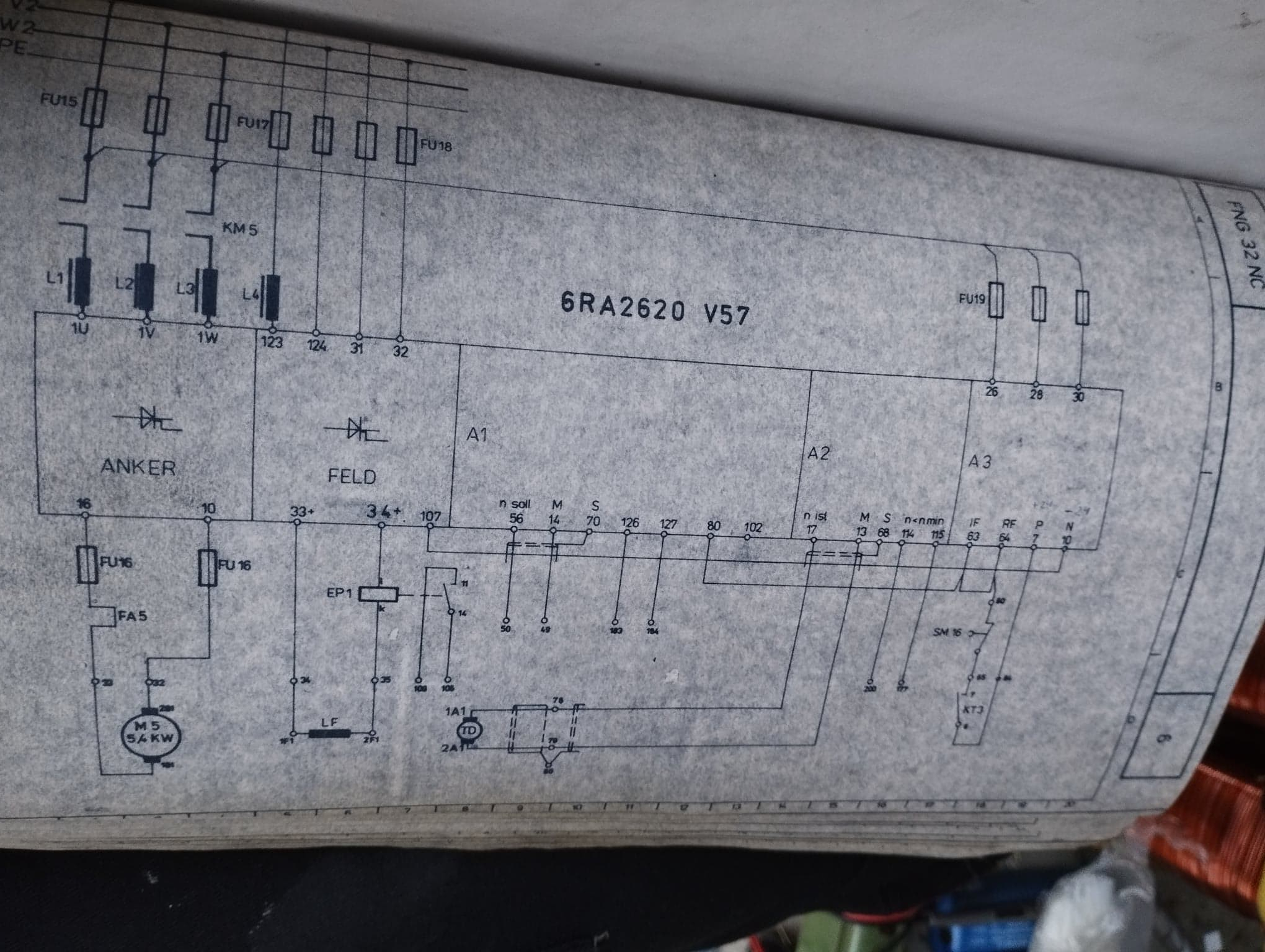

Thank you for your files, I really appreciate the help. How many gears did your maho have?
I have 3 controlled by hydraulic. Do I make some ladder program that controls the gears? Like if the rpm is set to 800rpm the machine atomatically changes to the right gear before the program start.
Today I connected the signals to X-Y-Z servos, I believe I can start the machine tomorrow and see if I get some movement. I have 1 EXE box to connect tomorrow and 2 more are coming soon.
I started to take a look at the spindle driver. Does it work the same as the servo drivers, +-10V for speed control and how does the feedback for rpm work? I think enable is controlled by KT3 and +-10v is between 56 and 14, dont know which is 0V and which is +-10V.
Manual is here support.industry.siemens.com/forum/ww/en...dv57-0/43014/?page=0

The Maho had 18 gear selections and a direst on line start 3 phase motor.
I normally use classicladder to control the spindle gearboxes if there isnt too many gear selections. 3 seems quite reasonable.
All my machines select the correct gear automatically based on the spindle speed commanded.
there are a couple of things to keep in mind though....
Linuxcnc has a "spindle-at-speed" input, that will stop the feed if the spindle is not running at the correct speed. It will only stop the next move though, if there is a current feed move in motion, it will not stop when the spindle at speed signal goes false....catastrophic when you fiddle the spindle override and initiate a gear change during cutting...
For this reason, i usually interlock the gear change and spindle at speed signals with "motion.feed-inhibit" look at the docs or type "man motion" in a terminal on your linuxcnc pc.
I doubt your machine is fitted with a spindle encoder. if it is, use this to generate the spindle at speed signal.
pin 56 on your spindle drive is + and 14 is the ref. It doesnt really matter what polarity you use, it will just change the direction since it is -10 to +10v differential input.
the tacho on the spindle motor gives speed feedback to the drive only. dont change the polarity of either the tacho or the armature connections.

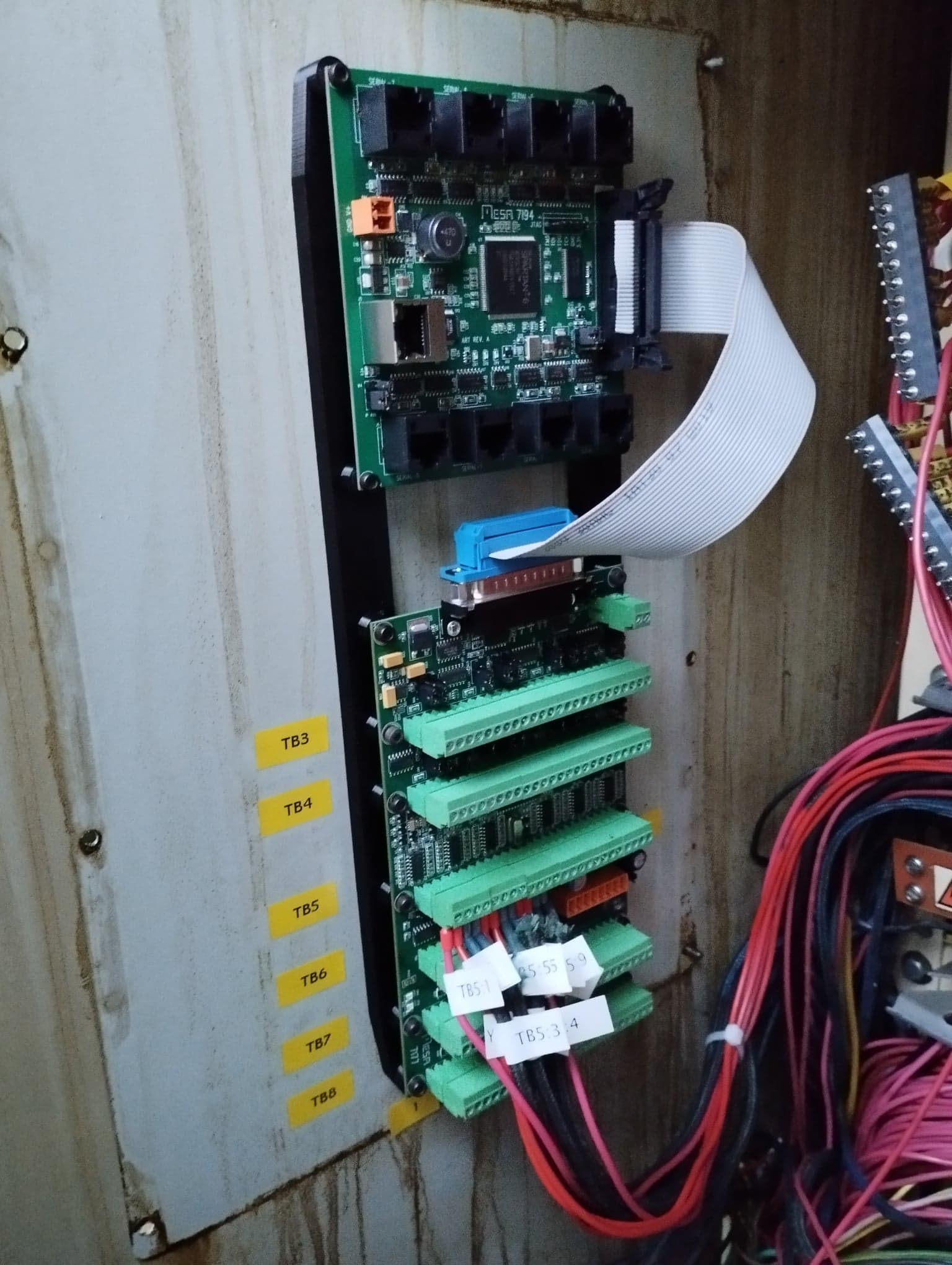

Today I installed the psu and powerd up the Mesa boards inside the cabinet. I used a computer psu, so I also have 5v for the EXE-boxes.
Todays plan was to get at least one axis to move, but I had some issues with 7i77. The led CR16 is red and that is intication for "Field I/O fault". In the manual it says
"At power-up, CR15
should be off and CR16 on. The red LED CR16 indicates a watchdog fault, which is
expected before host communications are established. Once running, CR16 should be off."
The ethernet connection to 7i94 is working, but im not sure how to check the connections between the 2 Mesa cards. I have doubled checked that all the jumpers is in the right place.
"At power-up, CR15

CR16 is red until LinuxCNC is started and communicating with it.

Assuming you have established the ethernet connection with the 7i94, you have to check that the FPGA is loaded with the correct bit file.
first, verify that you have a connection: in a terminal, type "ping 10.10.10.10". If it is jumpered for this IP address you should see the response timnes reported. if Ok, proceed
now, in a new terminal, type "sudo mesaflash --device 7i94 --addr 10.10.10.10 --readhmid"
you should see the following pin file details printed. for the P2 connector
IO Connections for P2
Pin# I/O Pri. func Sec. func Chan Pin func Pin Dir
1 0 IOPort SSerial 0 TXEn2 (Out)
14 1 IOPort SSerial 0 TXData2 (Out)
2 2 IOPort SSerial 0 RXData2 (In)
15 3 IOPort SSerial 0 TXData1 (Out)
3 4 IOPort SSerial 0 RXData1 (In)
16 5 IOPort SSerial 0 TXData0 (Out)
4 6 IOPort SSerial 0 RXData0 (In)
17 7 IOPort MuxedQCountSel 0 MuxSel0 (Out)
5 8 IOPort MuxedQCount 0 MuxQ-A (In)
6 9 IOPort MuxedQCount 0 MuxQ-B (In)
7 10 IOPort MuxedQCount 0 MuxQ-IDX (In)
8 11 IOPort MuxedQCount 1 MuxQ-A (In)
9 12 IOPort MuxedQCount 1 MuxQ-B (In)
10 13 IOPort MuxedQCount 1 MuxQ-IDX (In)
11 14 IOPort MuxedQCount 2 MuxQ-A (In)
12 15 IOPort MuxedQCount 2 MuxQ-B (In)
13 16 IOPort MuxedQCount 2 MuxQ-IDX (In)
there will be more printed but these are for the other SSerial connectiors and they should all show SSerial.....
If this is not the case, you have to load a new bit file on the 7i94. Download the software bit file from mesa's website for the 7i94, find this file "7i94ss_7i77d.bit" and copy it to your home folder on the linuxcnc pc.
now open a terminal and type "ls"
check that the bit file is shown in the list printed.
now write the fimrware to the 7i94
"sudo mesaflash --device 7i94 --addr 10.10.10.10 --write 7i94ss_7i77d.bit"
if this is succesfull, power cycle the 7i94 preferably by switching off the power supply input and not unplugging the 5v connector...
you should now be able to launch linuxcnc if your config is correct.

I'm trying to launch LinuxCNC and move one axis. I use Pncconf and made the simpelst config possible using 7i92 and Firmware "7i77x2 with one 7i77". I have modified inside the .ini file to use 7i94. I cant launch the program.
It seems to me that I have configured the network properly. I can ping 10.10.10.10 and get response and if I write
I get:
Configuration Name: HOSTMOT2
BoardName : MESA7I94
FPGA Size: 9 KGates
FPGA Pins: 144
Number of IO Ports: 2
Width of one I/O port: 21
Clock Low frequency: 100.0000 MHz
Clock High frequency: 200.0000 MHz
IDROM Type: 3
Instance Stride 0: 4
Instance Stride 1: 64
Register Stride 0: 256
Register Stride 1: 256
And so on.
Then I tried download 7i94ss_7i77d.bit. I write "ls" and I can see the file in the right place and the install was sucessful and I have restarted the board but I still cant launch. So I think I have some error in my config maybe.
I also tried using your .ini and .hal file Henk but no luck there either.
