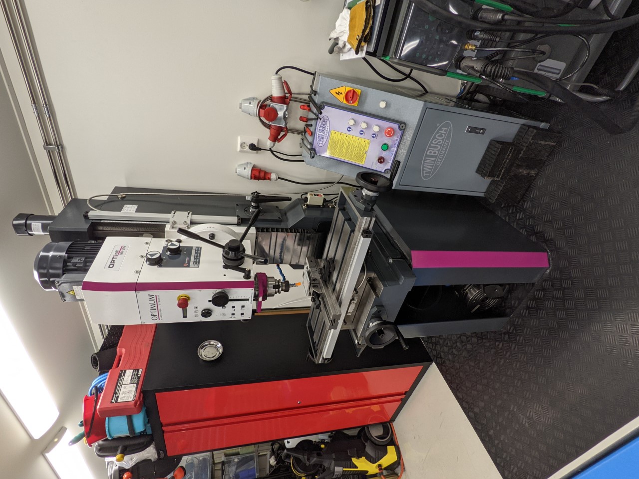

The machine I'm converting is a larger type of Chinese mill branded and sold by Optimum as the MH50V model.
I originally purchased the smaller MH35V model but I had to wait forever for it to be delivered and when it arrived it had lots of defects so in the end the local Optimum reseller compensated me by exchanging it for the larger MH50V model. This was my first mill so it's been a learning experience and I'm really glad I started with manual milling to get a feel for how it should be done.
As with many Chinese made manual mills the machine left a bit to desired so over the past two years I've trammed and shimmed the machine, extended the table, added polycarbonate chip guards, flood and mist coolant along with a Android based TouchDRO with glass scales (more on these mods are available in my thread at The Hobby Machinist ).

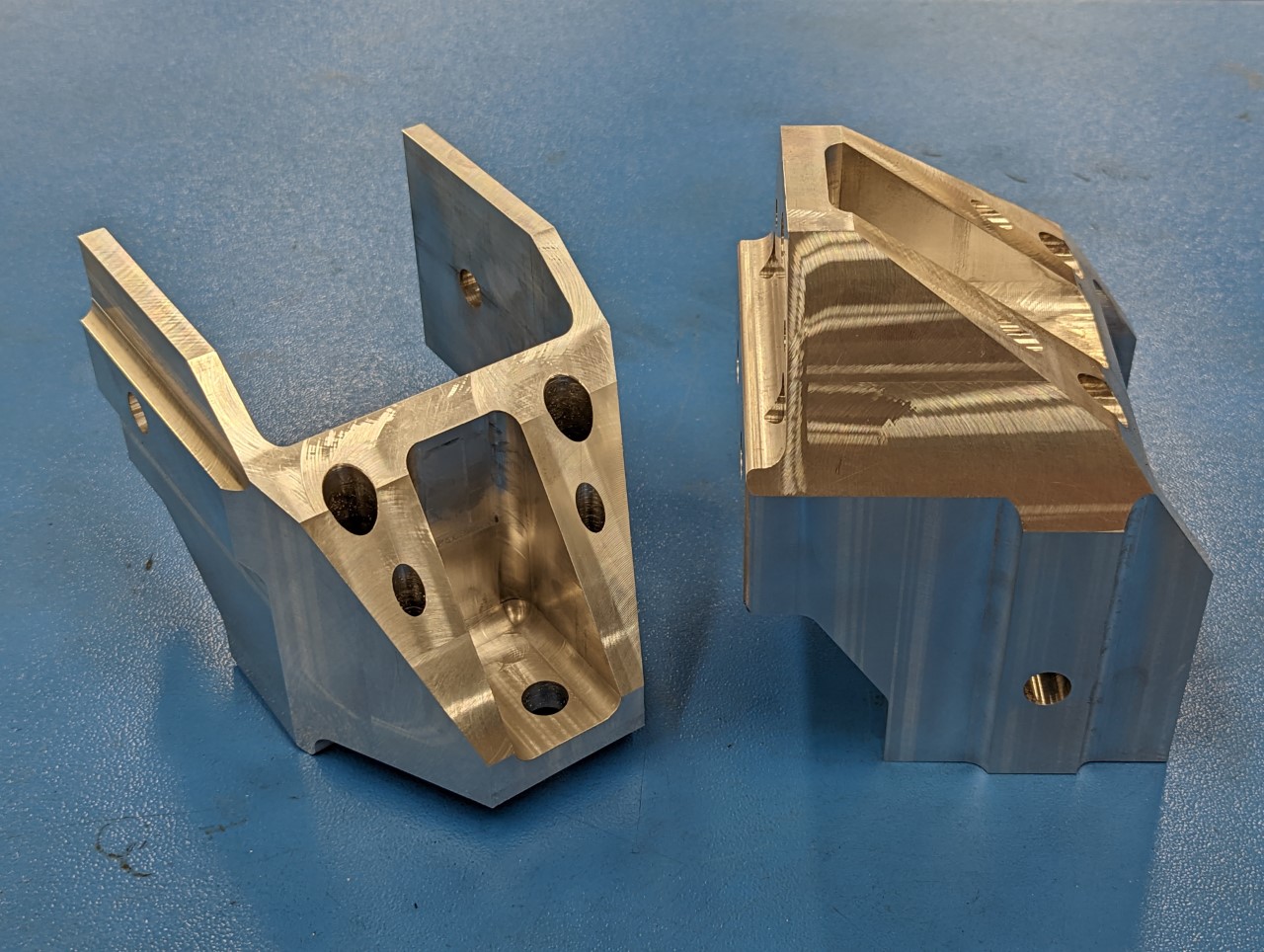

For manual milling this worked really well and I've done quite few billet parts for my motorsports related hobbies, even some larger parts.
However after getting the hang of manual milling I realized that it was time to move on to more advanced parts and that CNC was the way to go. Initially I looked at purchasing a brand new CNC mill but I realized there was very few if any options that met the size requirements I had.

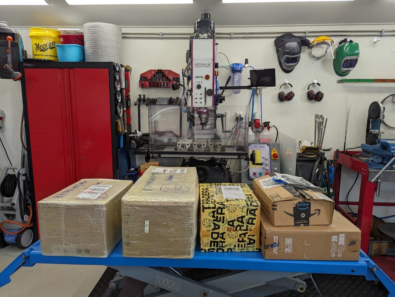

After planing this for several months I finally started ordering parts at the end of this summer and shortly afterwards the packages started arriving.
The recipe of parts I settled on was essentially the following:
  • Mesa 7i96S + Mesa 7i84 (I would have preferred a 7i76E but they were not available)
  • Delta B3 servos 750W for X/Y and 1000W for Z
  • Bosch Rexroth C5 ballscrews with preloaded nuts
  • ABB SSR10 e-stop relay
  • Schneider Electric LP4K0910BW3 low power/low noise contactors
  • Eaton M22 buttons for e-stop/reset, jog, pause, resume
  • TDK-Lamda RSEN2030L and RTEN-5040 EMC filters
  • HP Elitedesk 800 G2 (avoid this computer)
  • A vintage Intel DQ45EK motherboard and Q9550S CPU
  • ASUS VT229H touch screen monitor
  • Eldon MAS0608030R5 enclosure

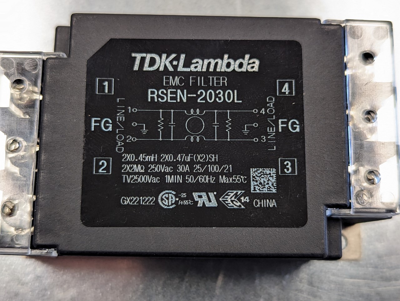

I opted for the Mesa cards based on their excellent documentation and Linux support. I really understand that many of their models are in short supply as they have done a very good impression on me so far.
Servo selection was a tricky topic and for a long time a leaned towards Teknic ClearPath servos however in the end the wide range of available models, price, functionality and extensive documentation of the Delta B3 servos won me over. I would never have considered these if it wasn't for the helpful posts from people on this forum who already had these servos up and running ( link , link ).
Delta seems to be continually updating the manual for the B3 series because the manual has grown with over 200 pages since I first downloaded it and started reading up on all the configuration options they allow for. The manual is now over a 1000 pages and freely available on their website without any login required.
The manual specifies that EMF023A21A EMI filters should be used with these servos and drives but I was unable to find anyone selling them and when I contacted Delta they had a 12 week lead time so instead I opted for the TDK-Lamda 2030L filters which I saw where recommended in a post over at CNCZone.

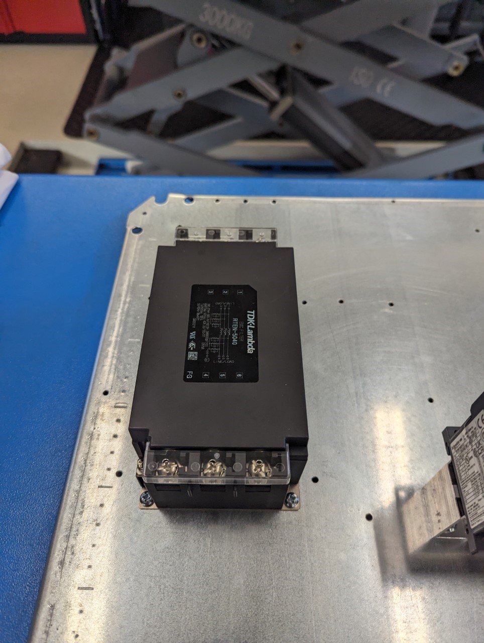

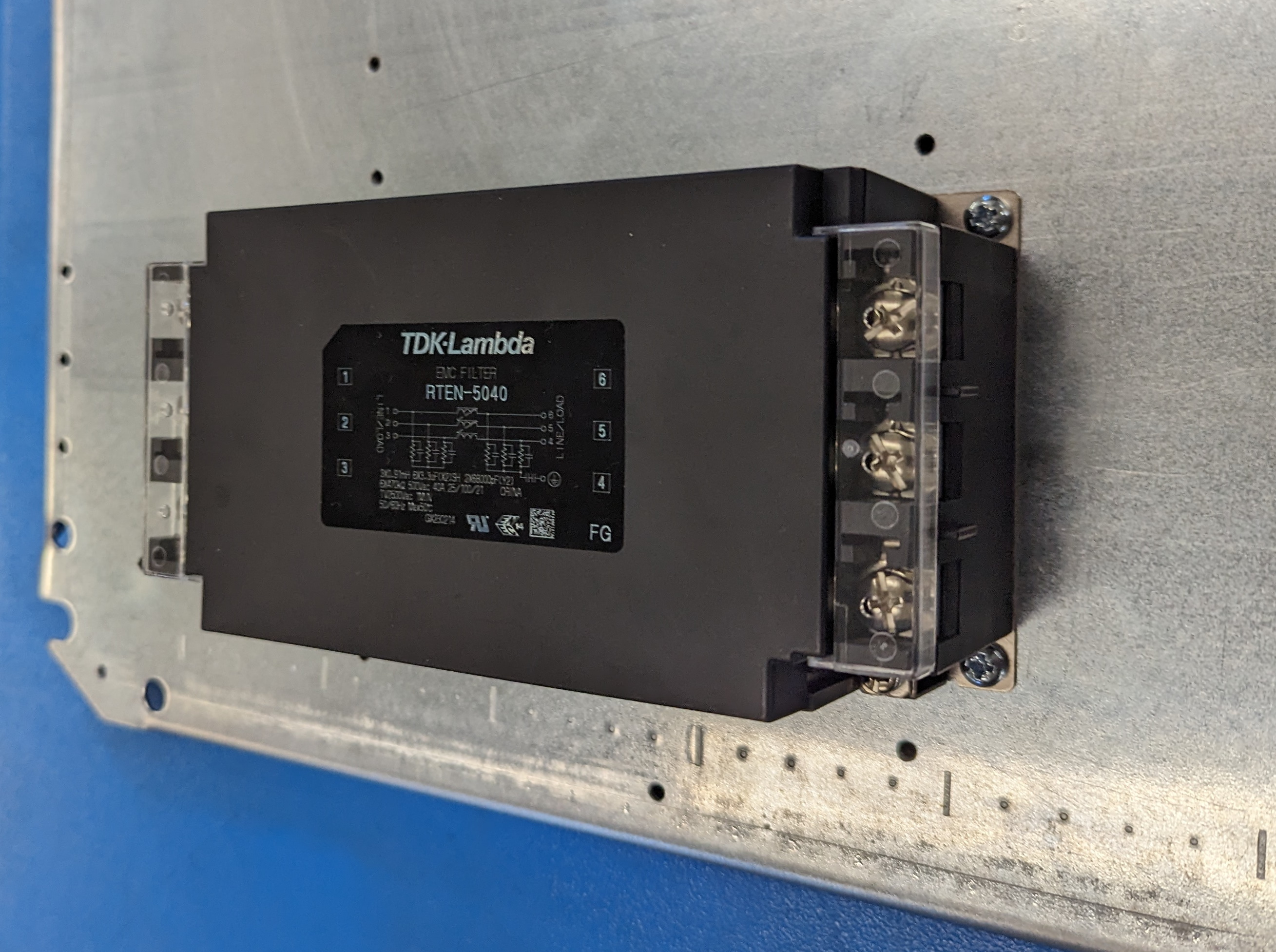

The VFD for the spindle also needed a EMI filter but all the smaller 3-phase TDK-Lamda models were out of stock so I had to opt for the rather large RTEN-5040 model.

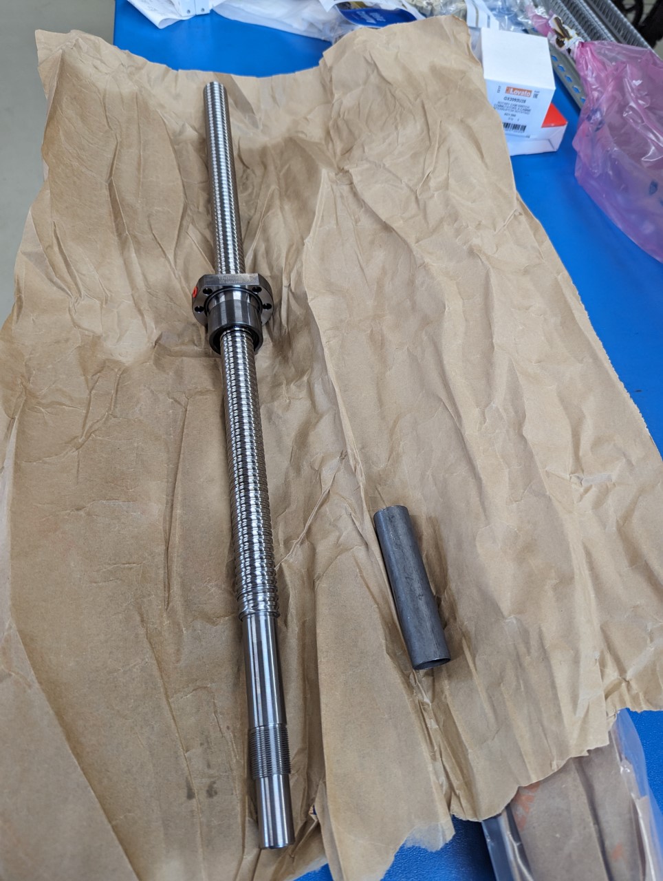

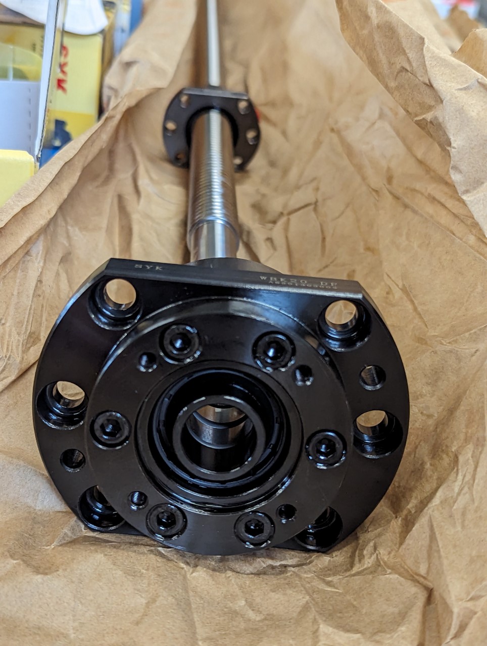

The ball screws and bearing blocks arrived with a shorter than expected 3 weeks lead time. They were the last major parts I was waiting for so with them on hand I began the actual work on converting the machine.

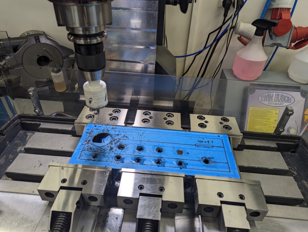

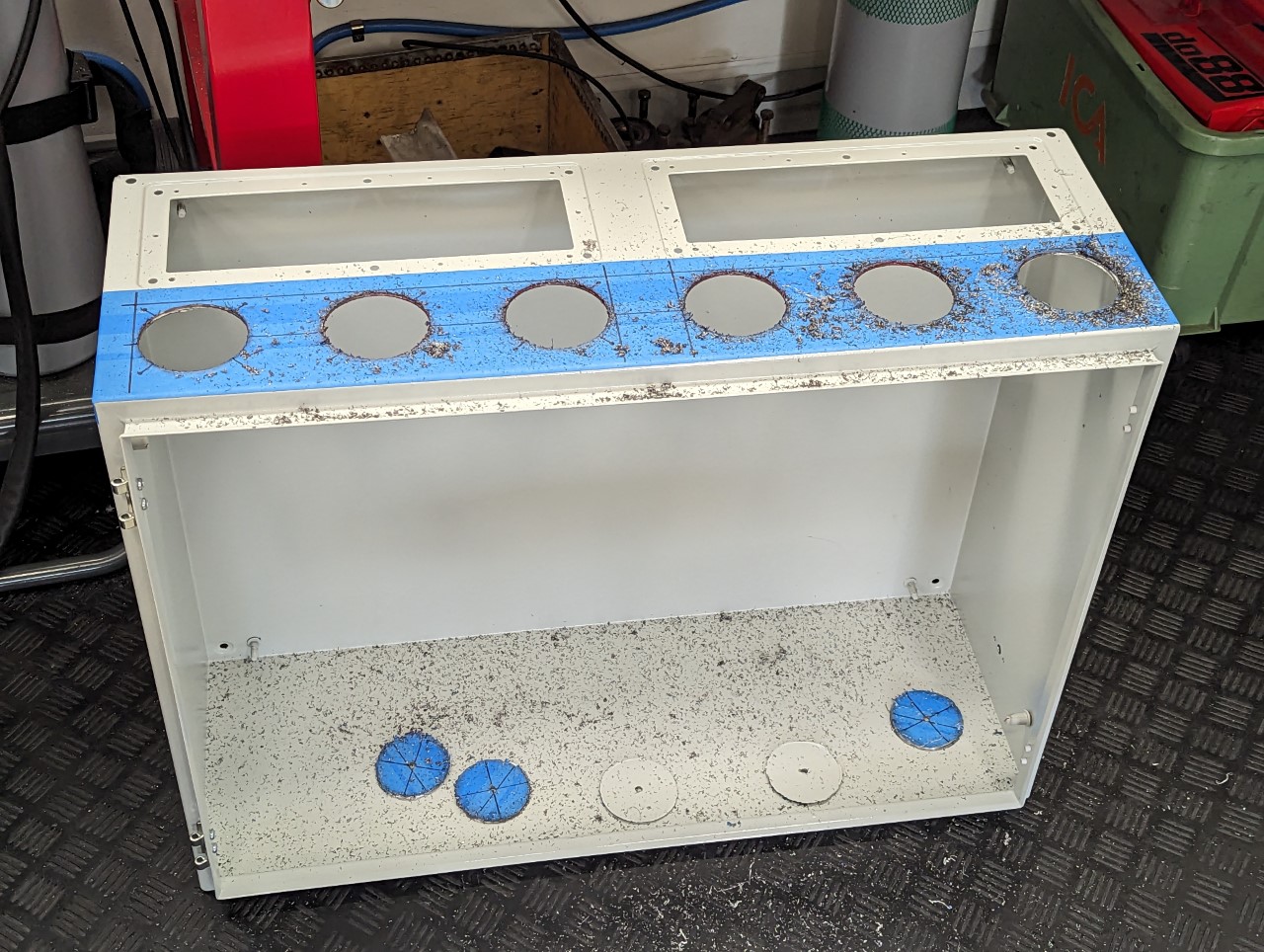

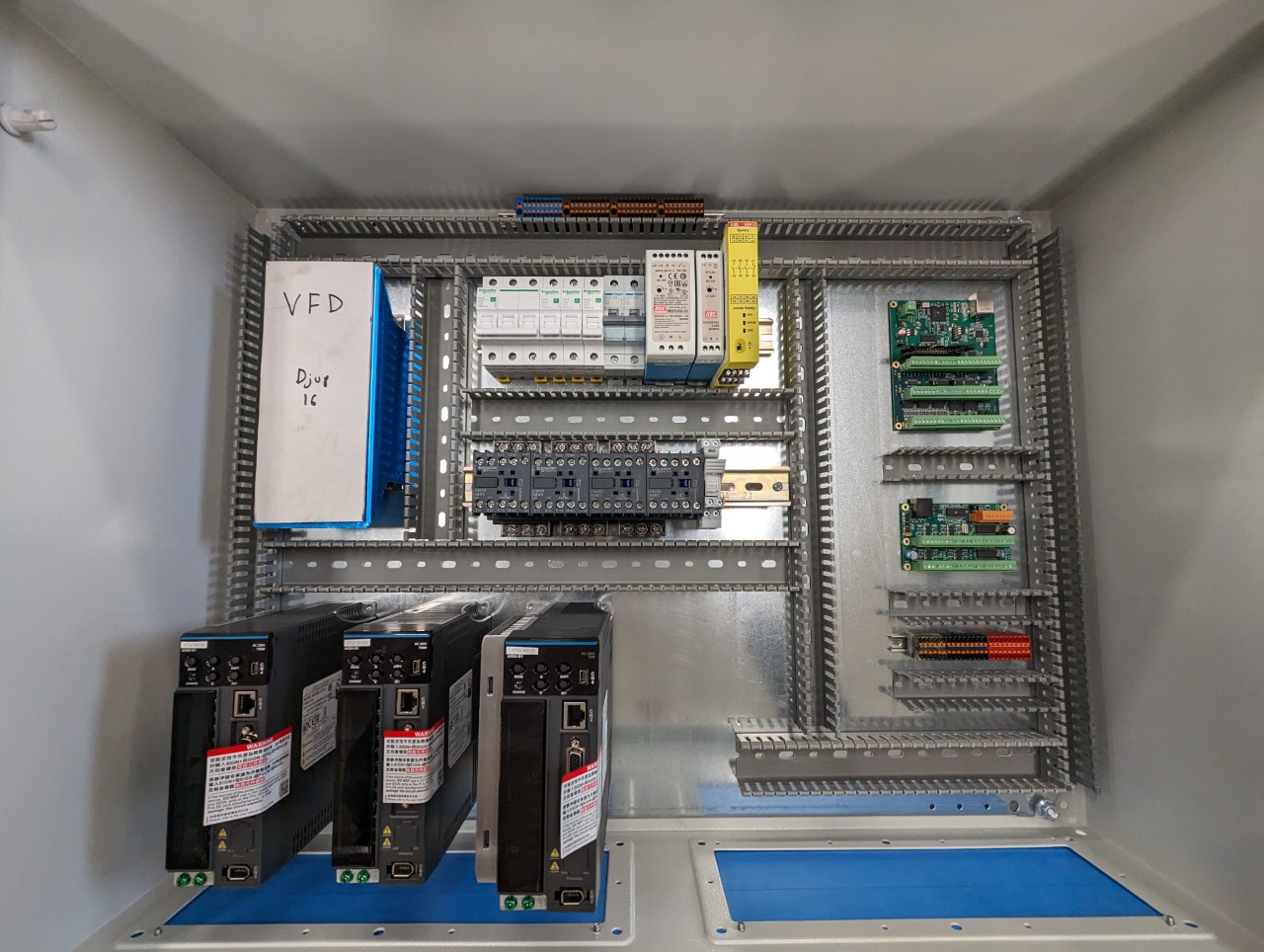

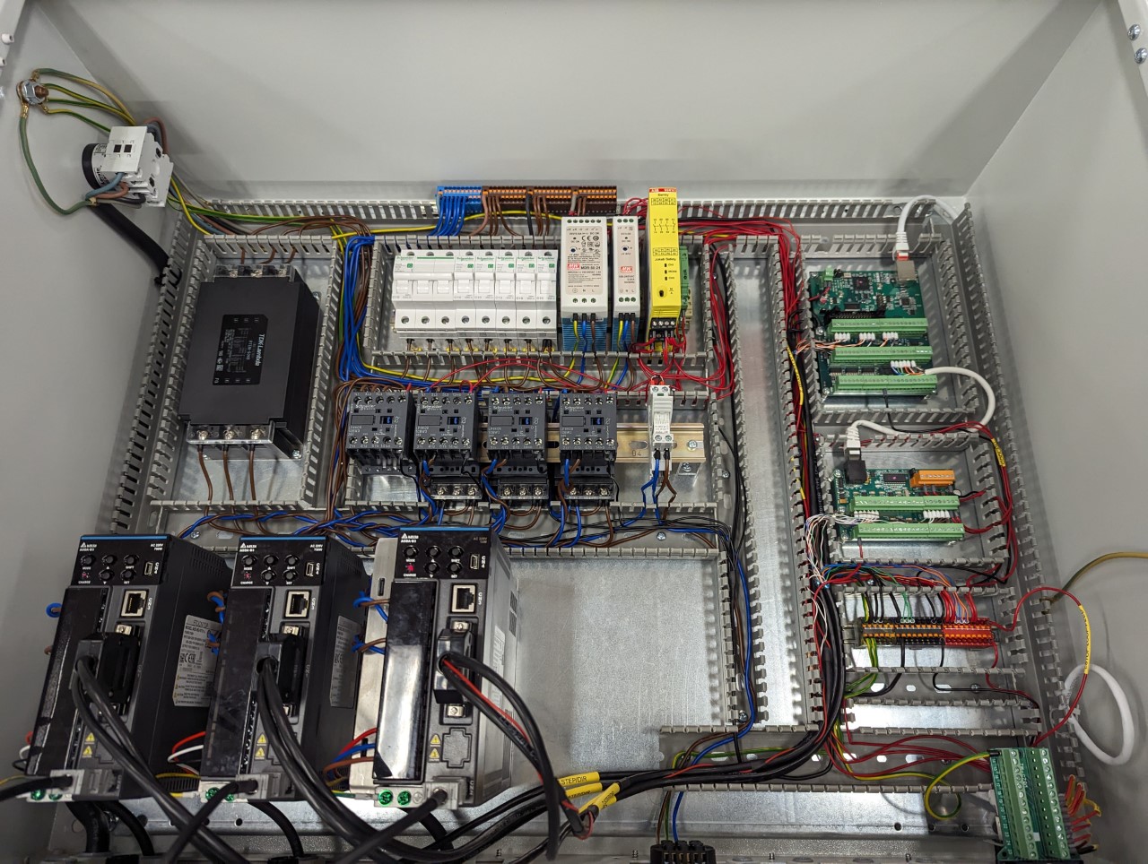

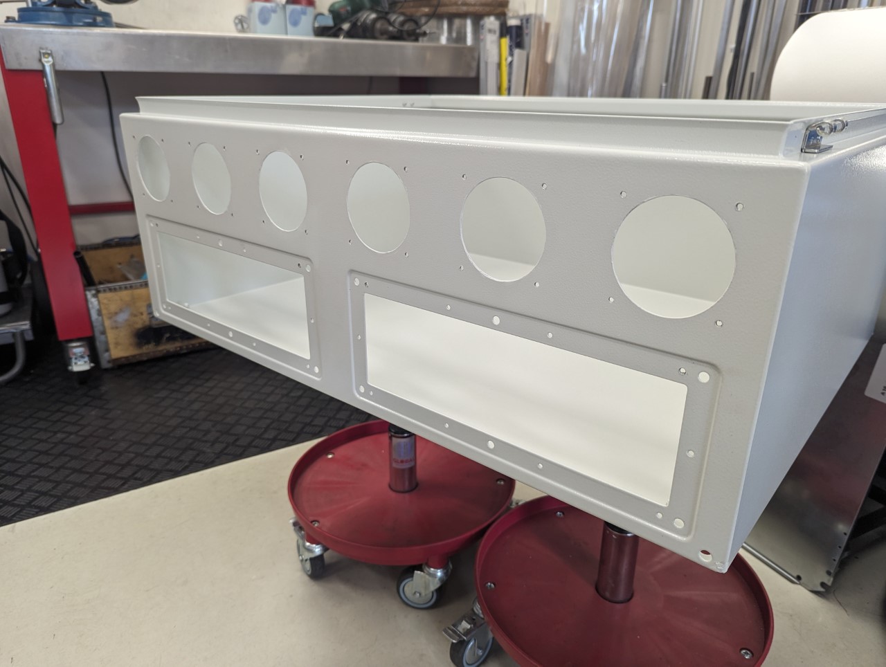

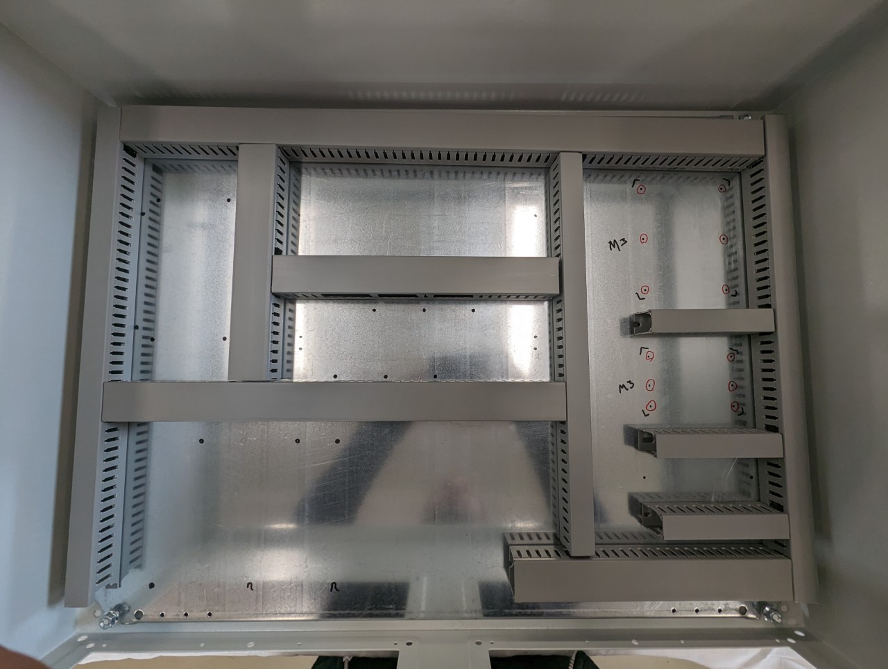

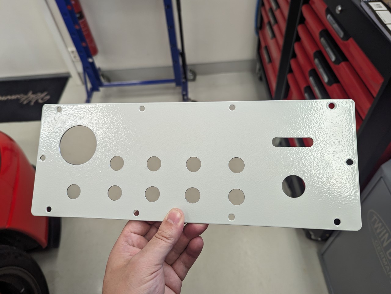

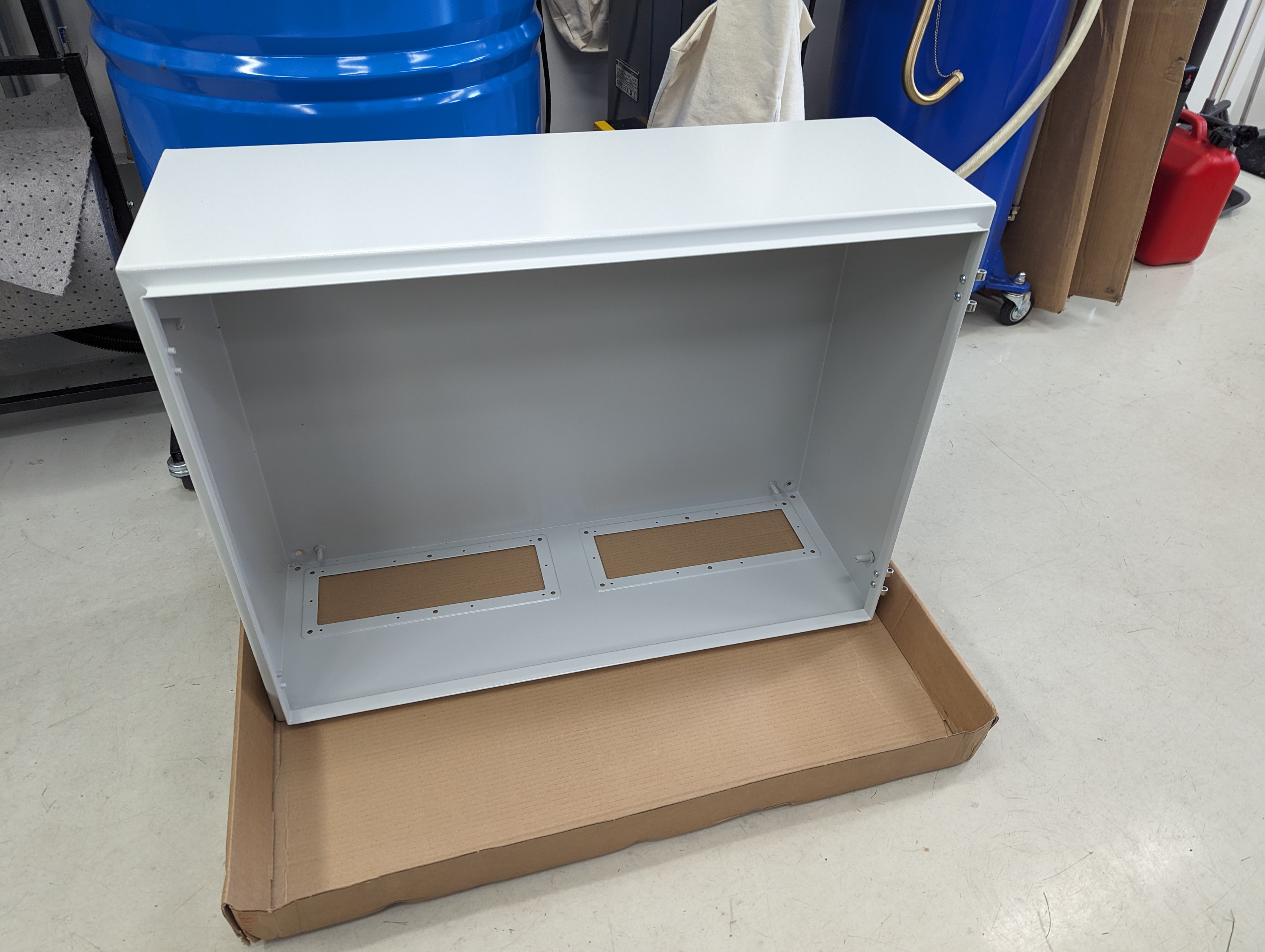

When the enclosure for all the electronics arrived it felt gigantic but as I started laying out all the parts inside of it there wasn't much space left in the end.

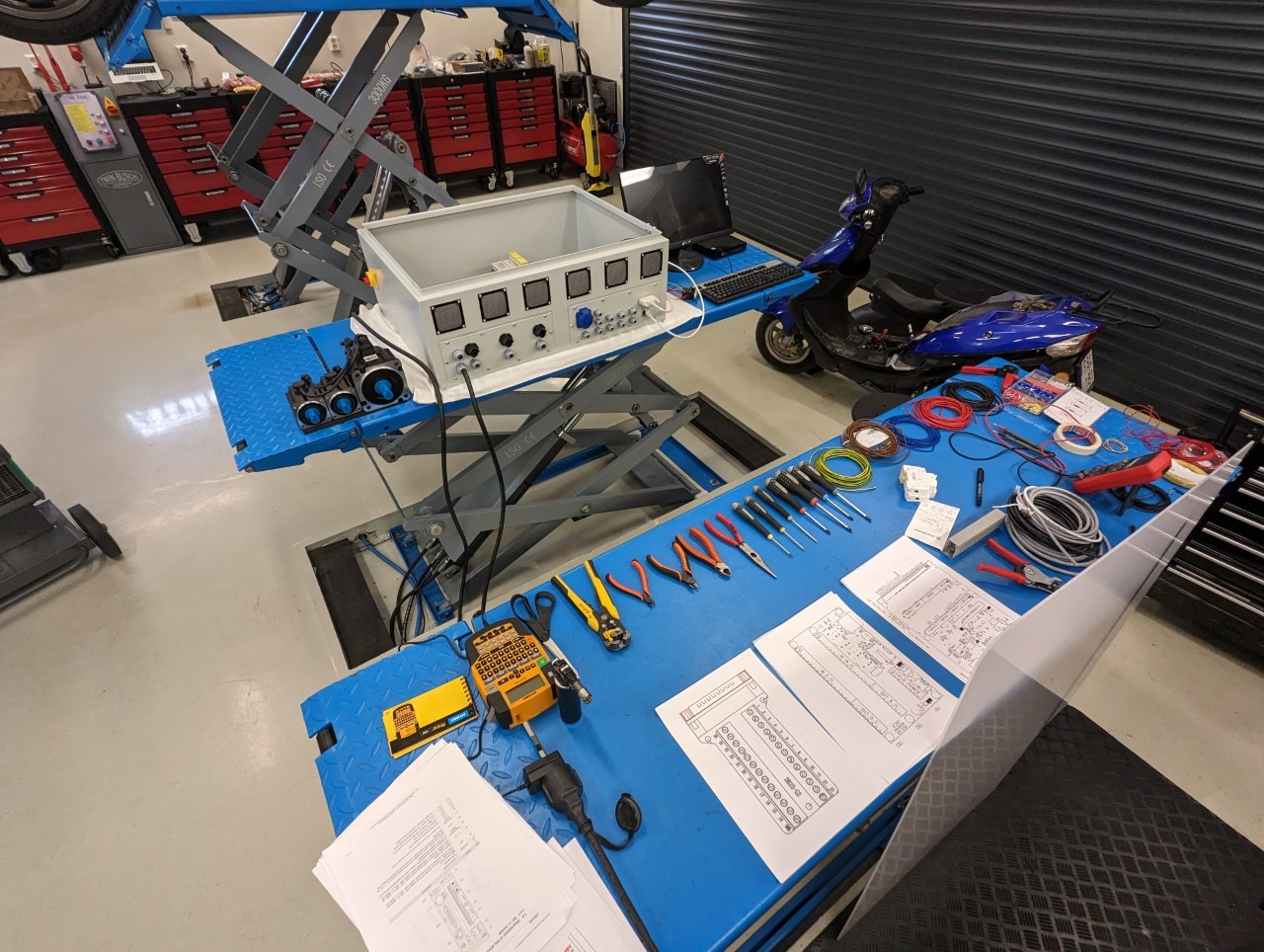

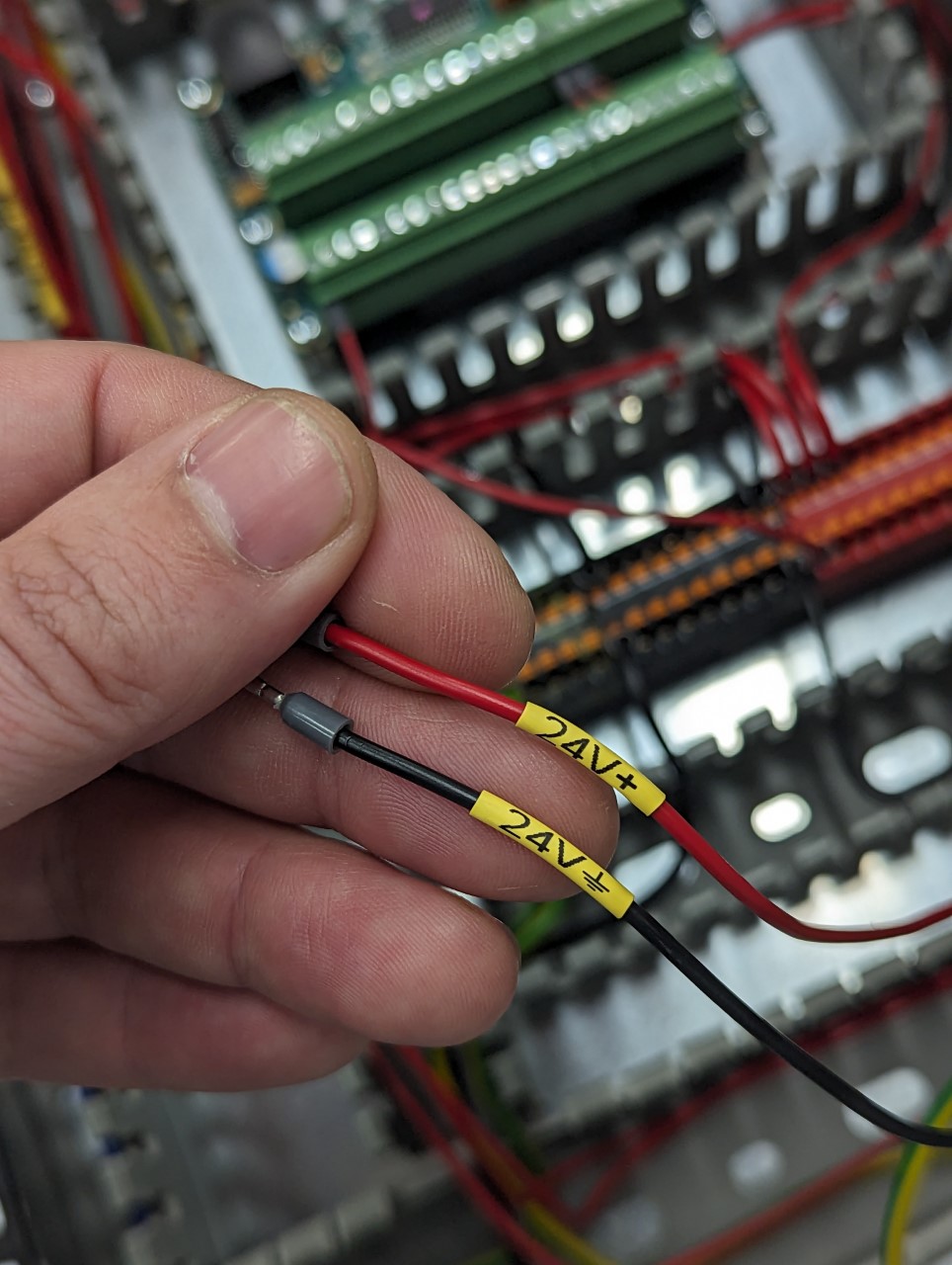

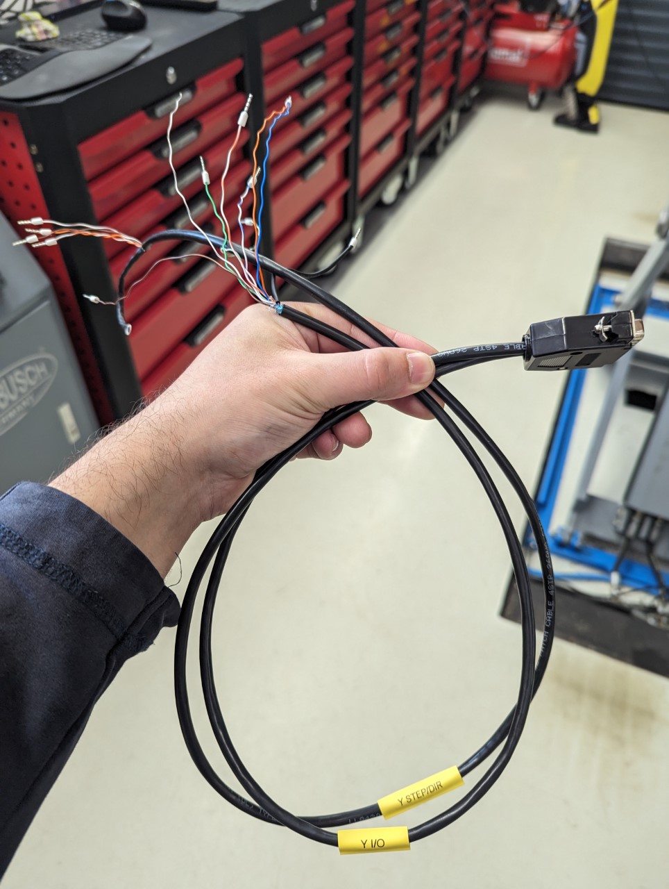

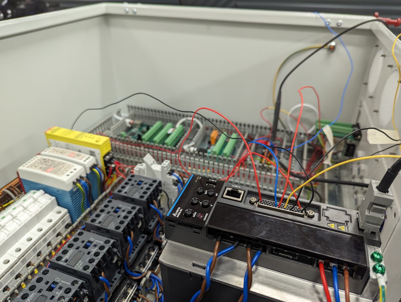

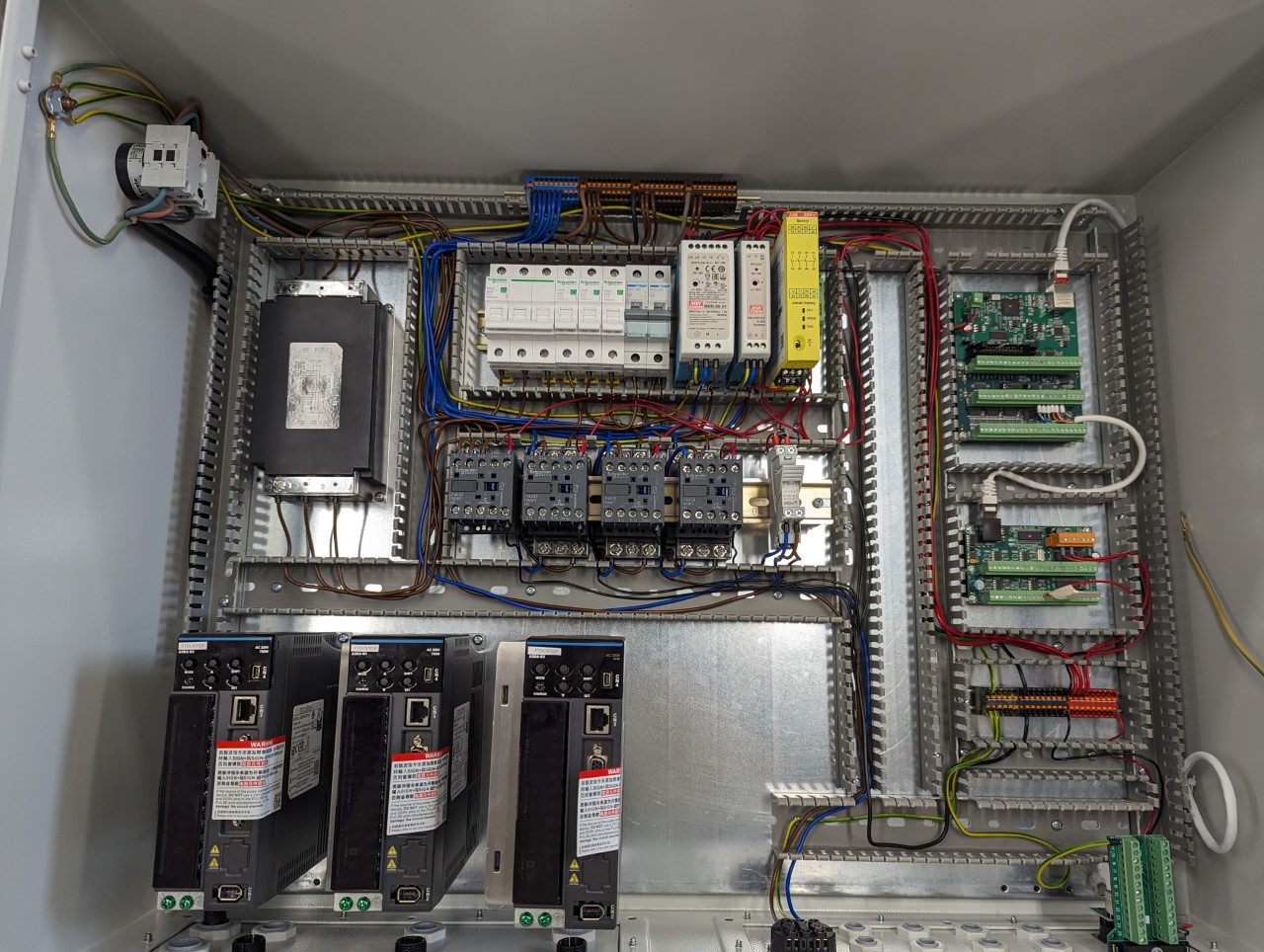

Next up was the wiring which took a couple of days to get in place and I did it in stages. First the power related wiring, then the control wires for the servos. Wiring for the limit switches and job buttons still remains to be done.
I had never used printable heat shrink before but it turned out to be really useful and realize why so many people use it. The Dymo branded cartridges are crazy expensive but luckily there are non Dymo branded ones available these days for 25% of the price of the genuine ones.

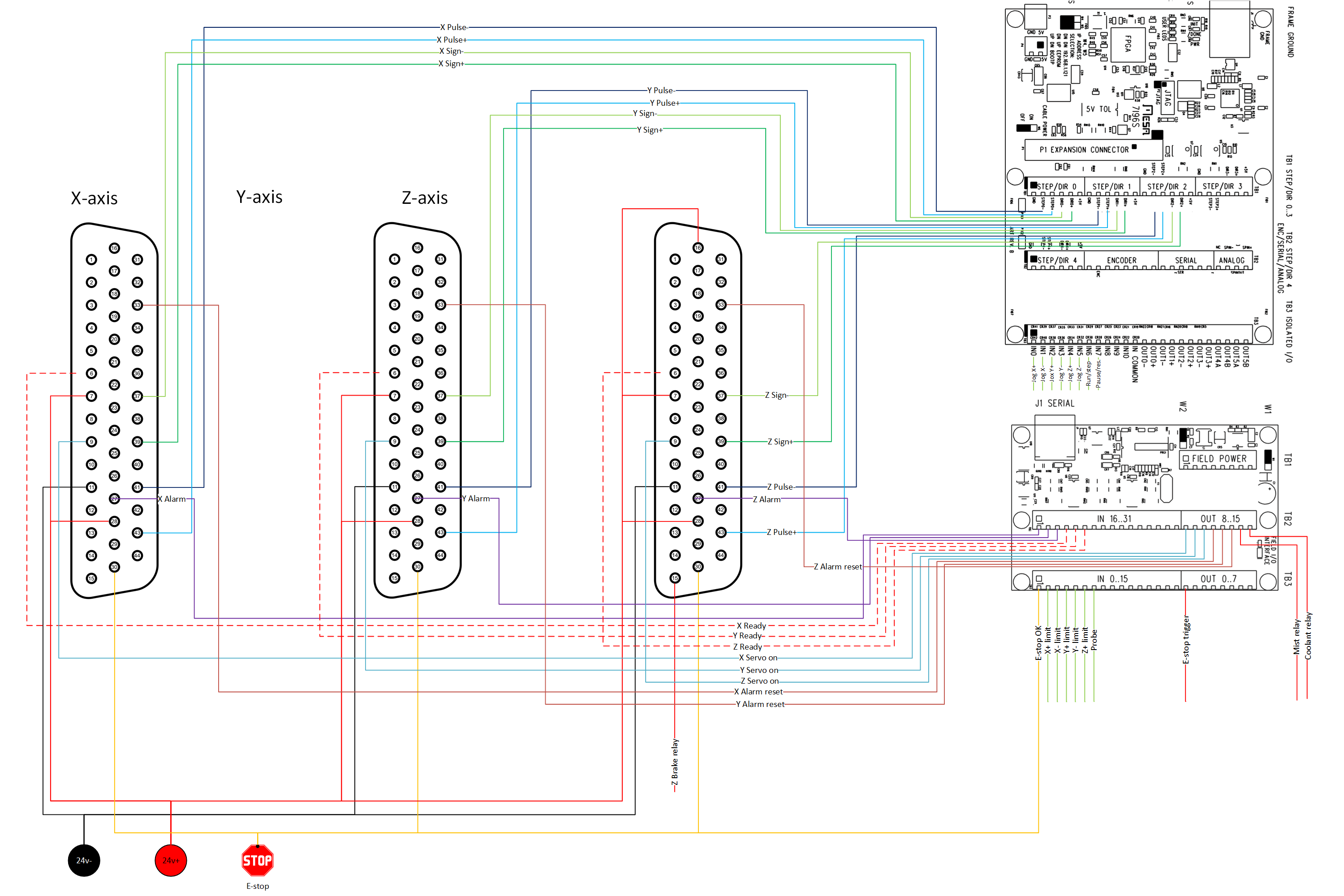

The Delta servo drives provide a plethora of functions which can be mapped to the various input and output pins on the DB44 connector. Before I soldered the cables for the DB44 connectors I decided to do some testing just so see that I had everything in the right place.
When I had identified all the pins I needed and configured their functions on the drives I made this wiring diagram so I didn't have too keep everything in my head
As you can see on the wiring diagram I avoided using the outputs on the Mesa 7i76S card for now as they have no short circuit protection. Instead I opted to use the outputs on the 7i84 instead as they have short circuit protection, overvoltage clamps and per driver chip thermal shutdown which felt safer in case I'd do some wiring mishap.

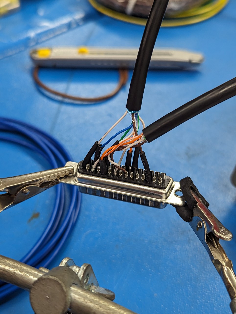

I ended up needing a lot of conductors for the DB44 connector on the servo drives and the step/dir signals should be done using twisted pair cables as they are differential signals. I spent a considerable amount of time trying to find a suitable cable but in the end I used ordinary shielded CAT6 cable with multi strand cables (not solid core). In order to get enough conductors I used two CAT6 cables for each servo.
One cable where I only used two pairs of wires for the step/dir signals, both the shield and the two unused pairs in this cable where grounded as close as possible to the Mesa 7i76S card as possible (on of the mounting screws).
Then another cable for all the I/O pins from the drive to the 7i84 card. Here I used all the pairs but still grounded the shield. For the Z-axis drive I had to add a separate cable for the brake release relay which is controlled by the servo drive itself.

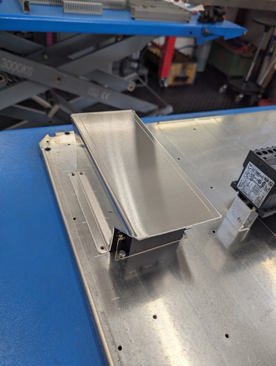

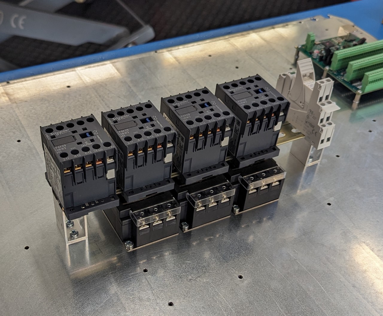

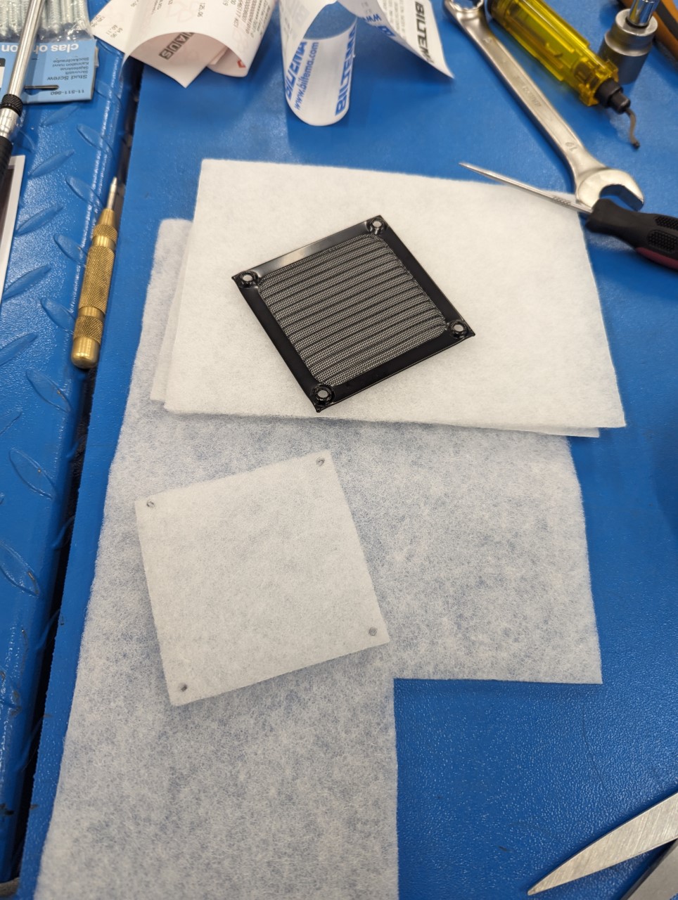

05 Nov 2023 12:29 #284615 by Unlogic
Replied by Unlogic on topic Optimum Optimill MH50V CNC conversion
Thanks for the kind words, I think the trick is careful planning and trying to cut as few corners as possible.

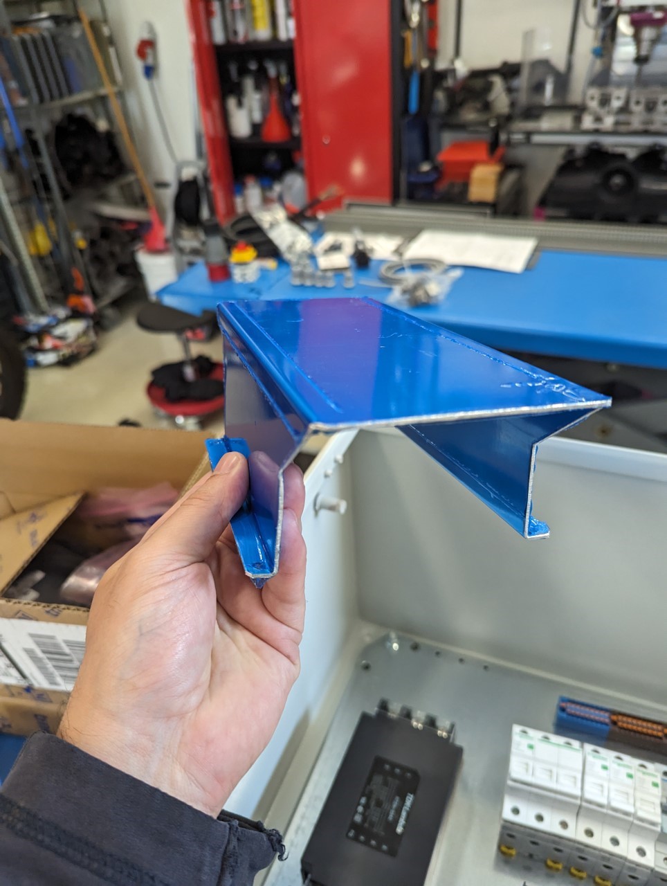

Still I had to do some unorthodox solutions in order to fit everything in the enclosure and still have space left for an eventual 4th axis servo drive. I had forgotten to take the size of the EMI filters into consideration when first planing the layout.
I solved this by raising one of the DIN rails on standoffs milled from a piece of extruded aluminum. This allowed me to "hide" the smaller EMI filters under neath the DIN rail. This also simplified the wiring a bit since the servo drives needs two power feeds. One permanent and one going through the e-stop controlled contactors but both of them needs to go through the EMI filter.
The gigantic EMI filter for the VFD was a bit trickier to hide so I made a shelf out of aluminum so that I can mount the VFD on top of the filter.
The VFD isn't installed yet as I'm planing to reuse the one that came with the mill and I'm still using the mill in manual mode so it will have to wait until the conversion is done before it can be moved over.
