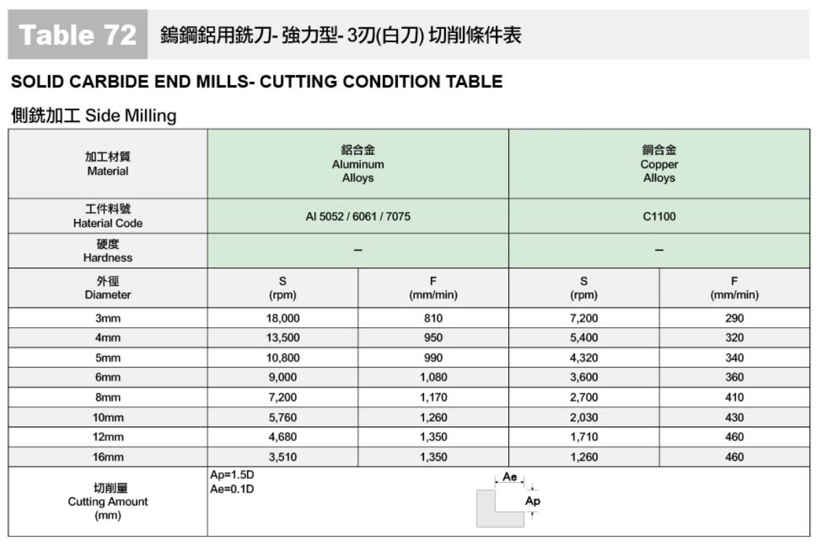

The machine looks very good. Does more than one vise add a lot to a hobby machine?
I change setups a lot and sometimes clamp direct on the table or use a 3-jaw chuck.
How rigid is that optimum mill? I would have thought you can push it a little more:-). Chips will fly everywhere.... next up! "Full enclosure"
Table is from a carbide endmill catalougue.
Greetings

As I don't have an automatic tool changer so adding more vices helps a lot when doing larges batches of parts as it reduces the amount of tool changes I have to do.
You simple setup the program to do the same operation with one tool on all of vices and then change tool and make the next operation on all vices and so on.
With three vices and I can usually hold 3 or 6 parts at the same time depending on the size of the parts.
The mill is fairly rigid and can take pretty heavy cuts as can be seen here:
However the limiting factor when milling the v-band chill/purge block is the long skinny tools I used and the slow spindle speed of this machine.
The long tool stickout leads to tool deflection which greatly reduces the width of cut that can be used.
Small tools require higher RPM and the spindle of this machine is only designed for a max rpm of 3000 which leads to very slow feed rates when using small tools. As you see in the image you attached it doesn't even have a feed rate listed for a spindle speed as low as 3000 rpm when milling aluminum.

3000 rpm is not all that high for Al, but still better than no torque
( don*t ask! ; 1000 W, no gearbox and max. 6000 rpm )
Makes an 8mm cutter a good choice for my old benchtop machine.
The 16 mm endmill would be "happy" at approx. 3000 rpm
, but some machines are not happy with a 16 mm endmill.
