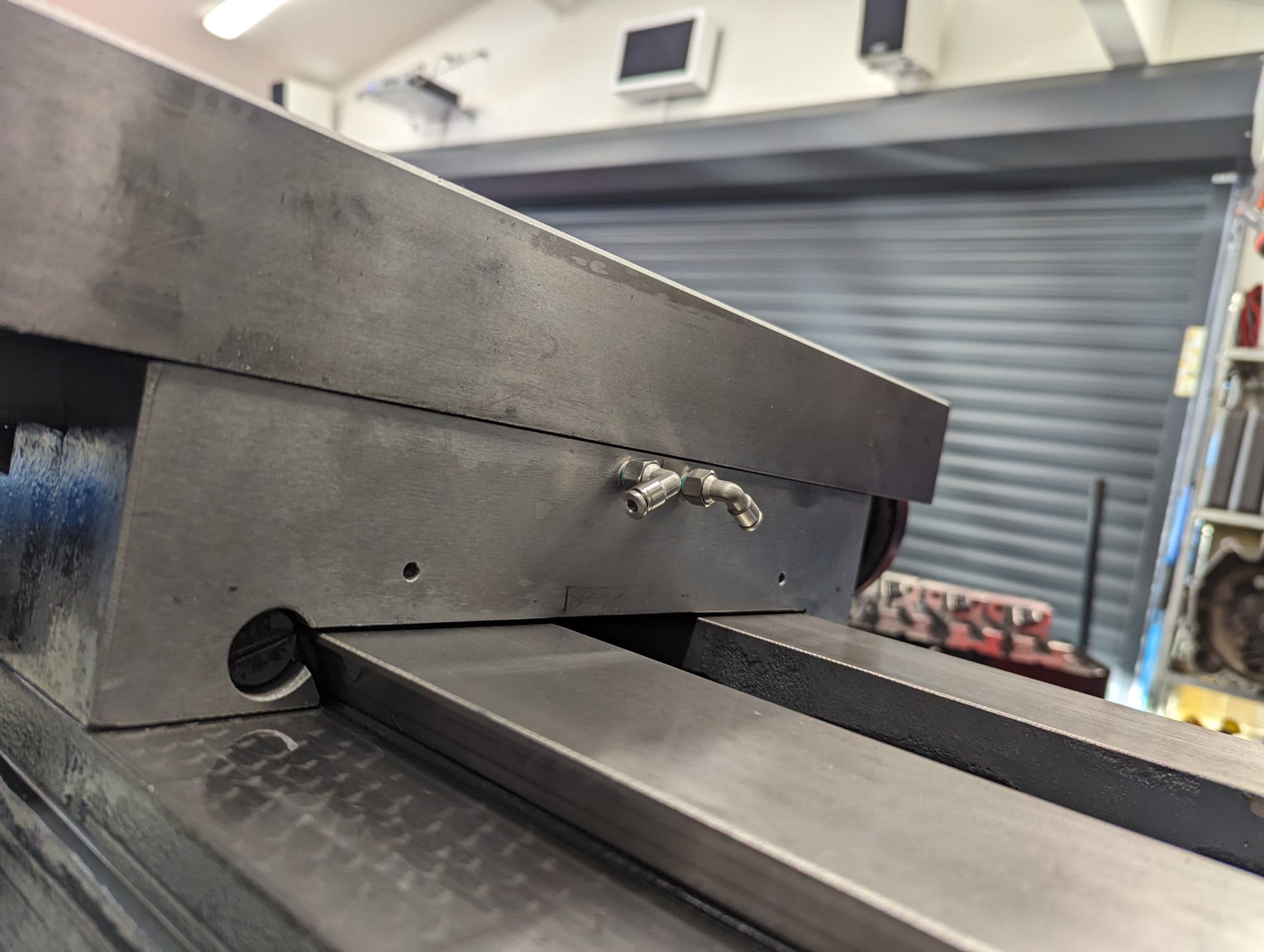

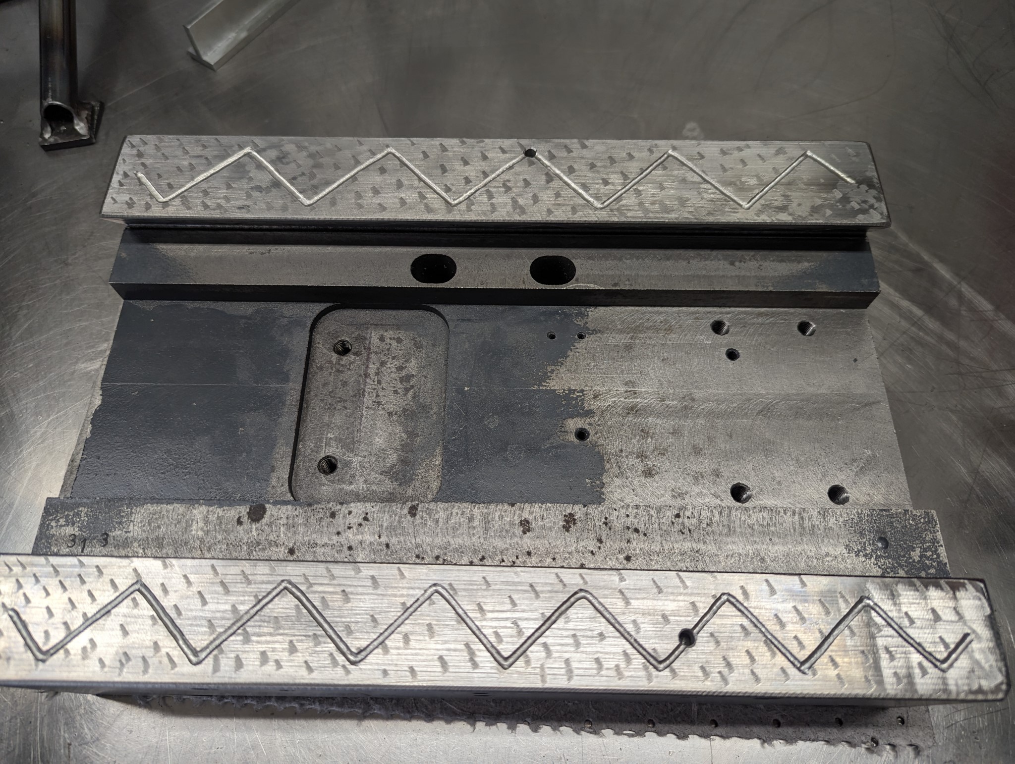

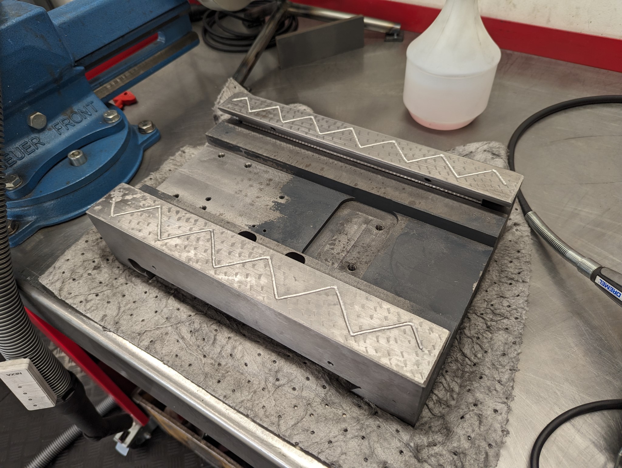

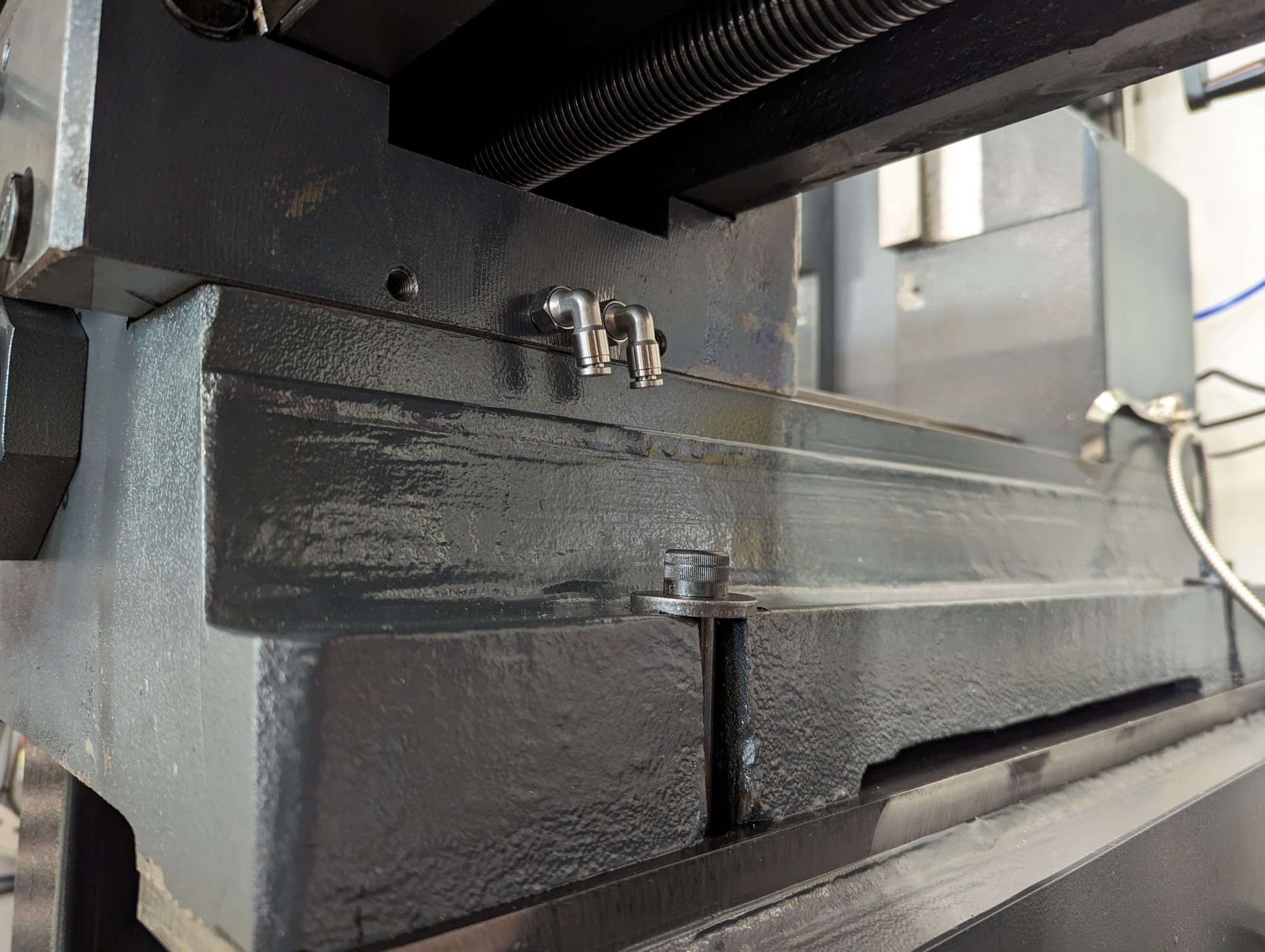

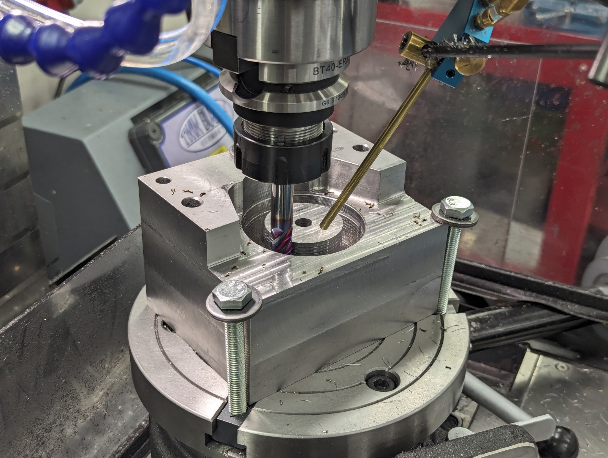

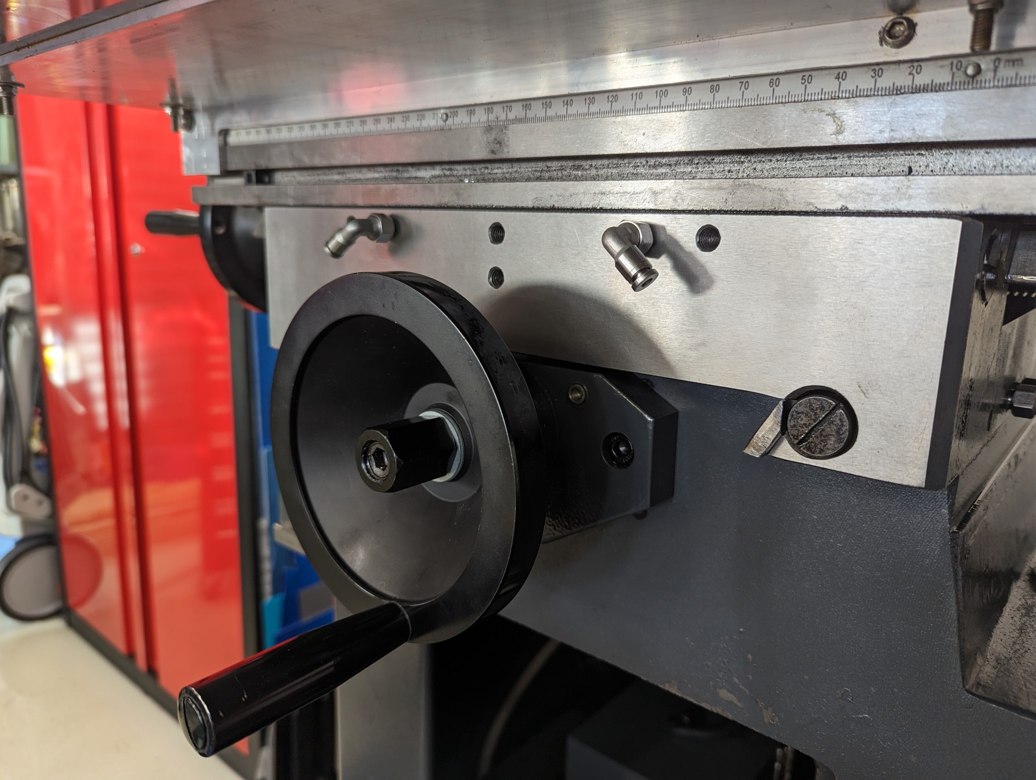

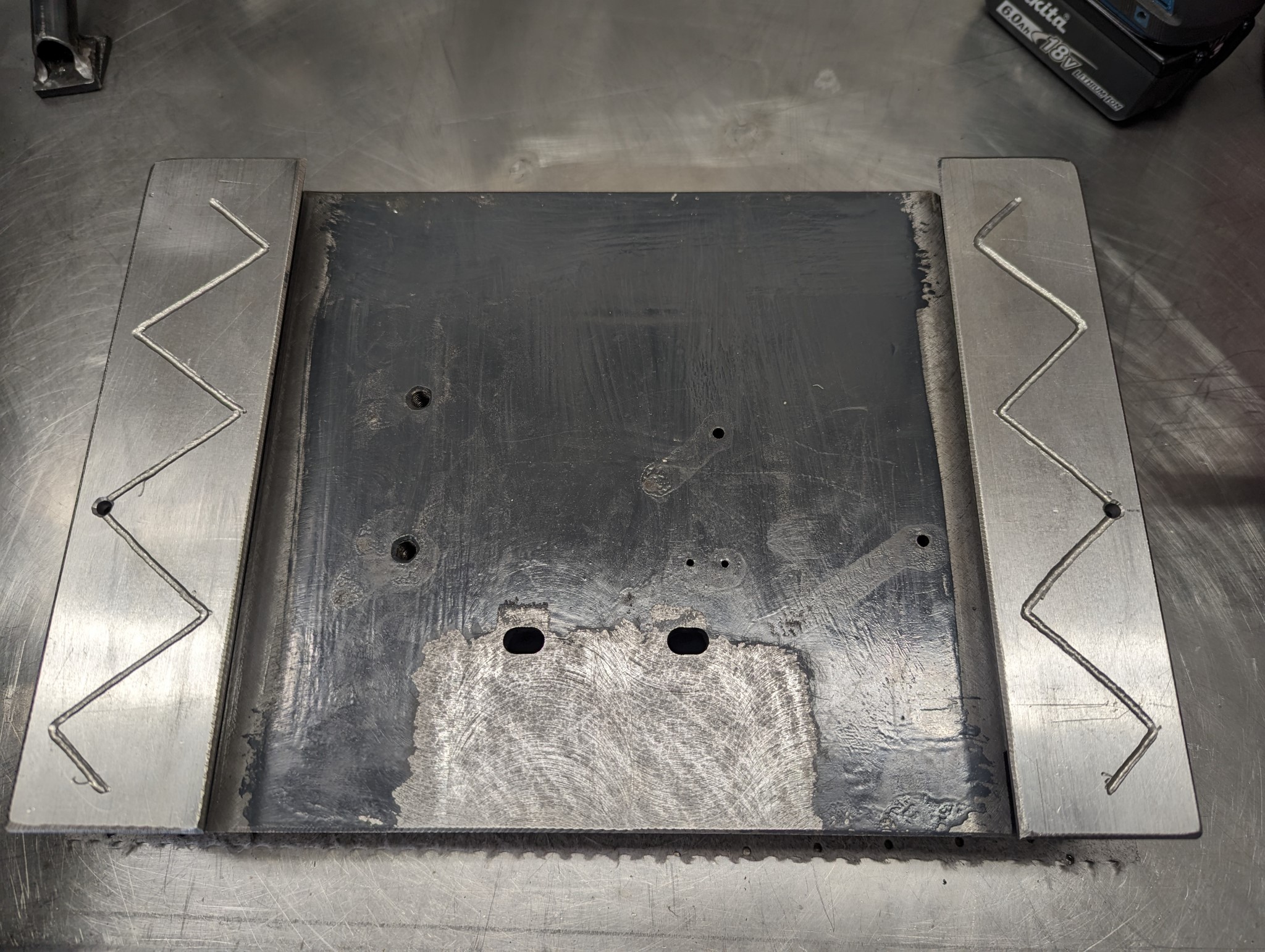

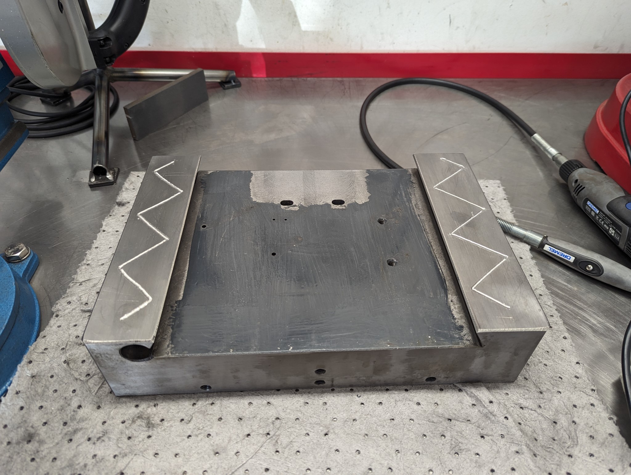

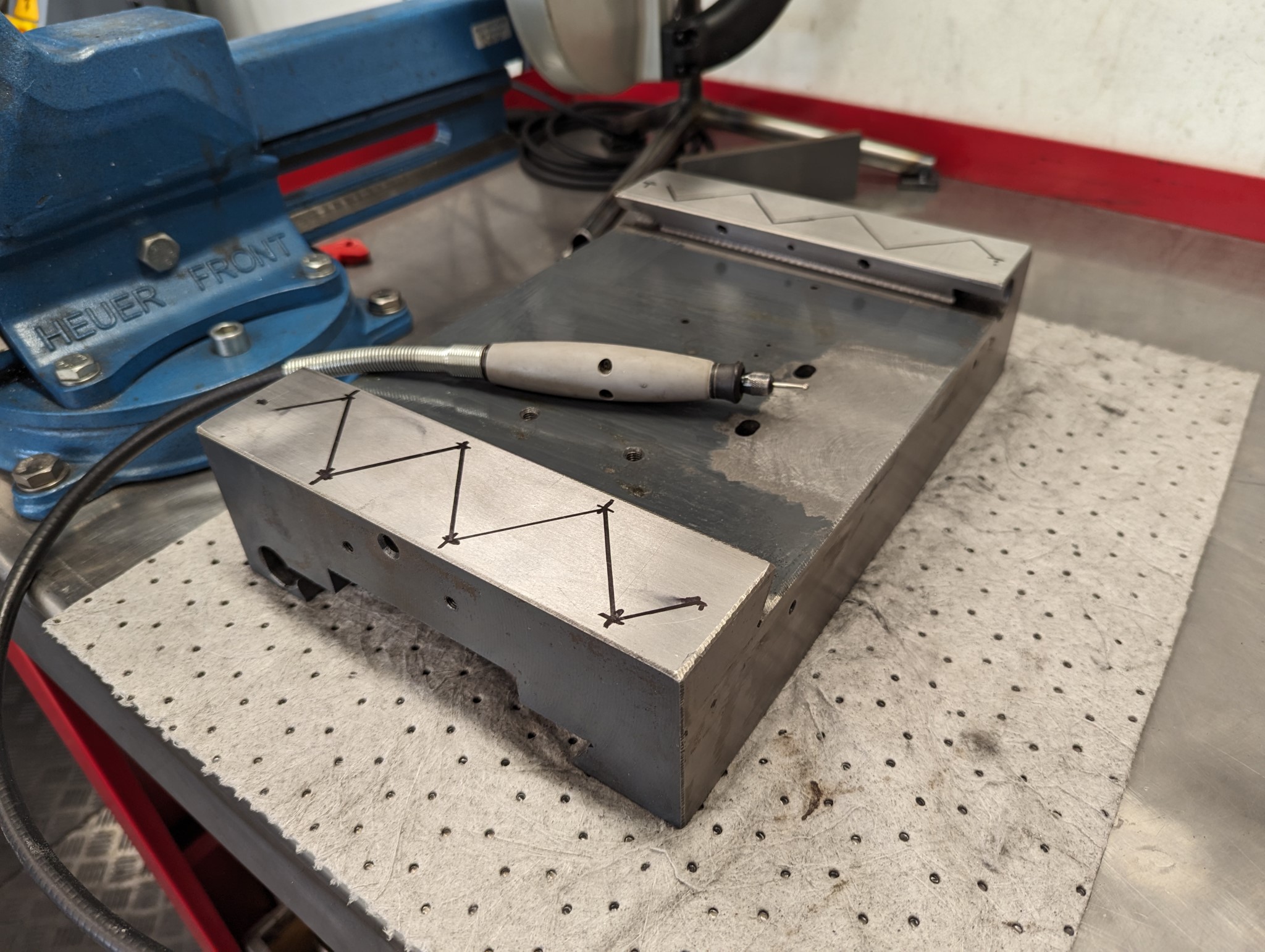

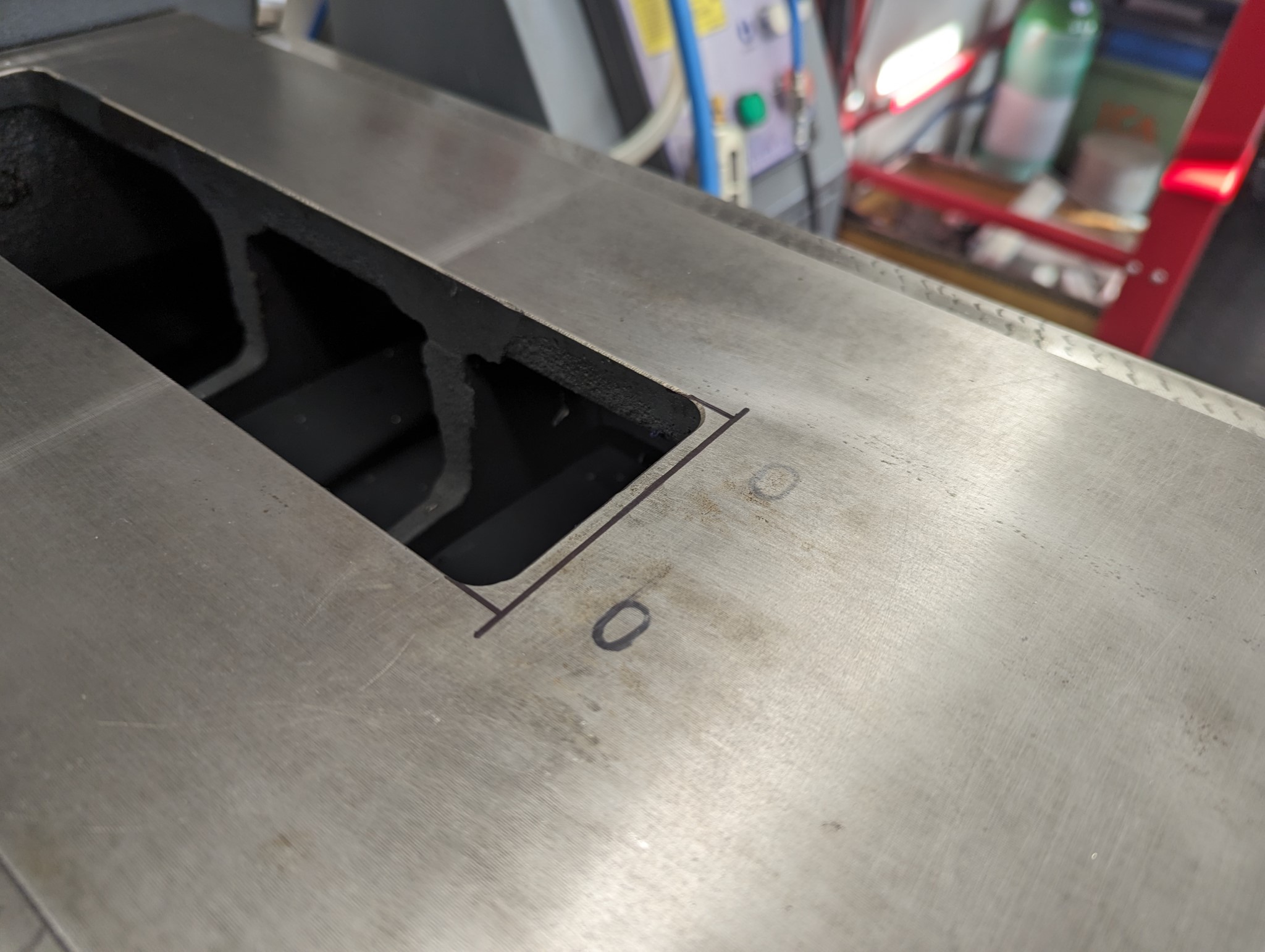

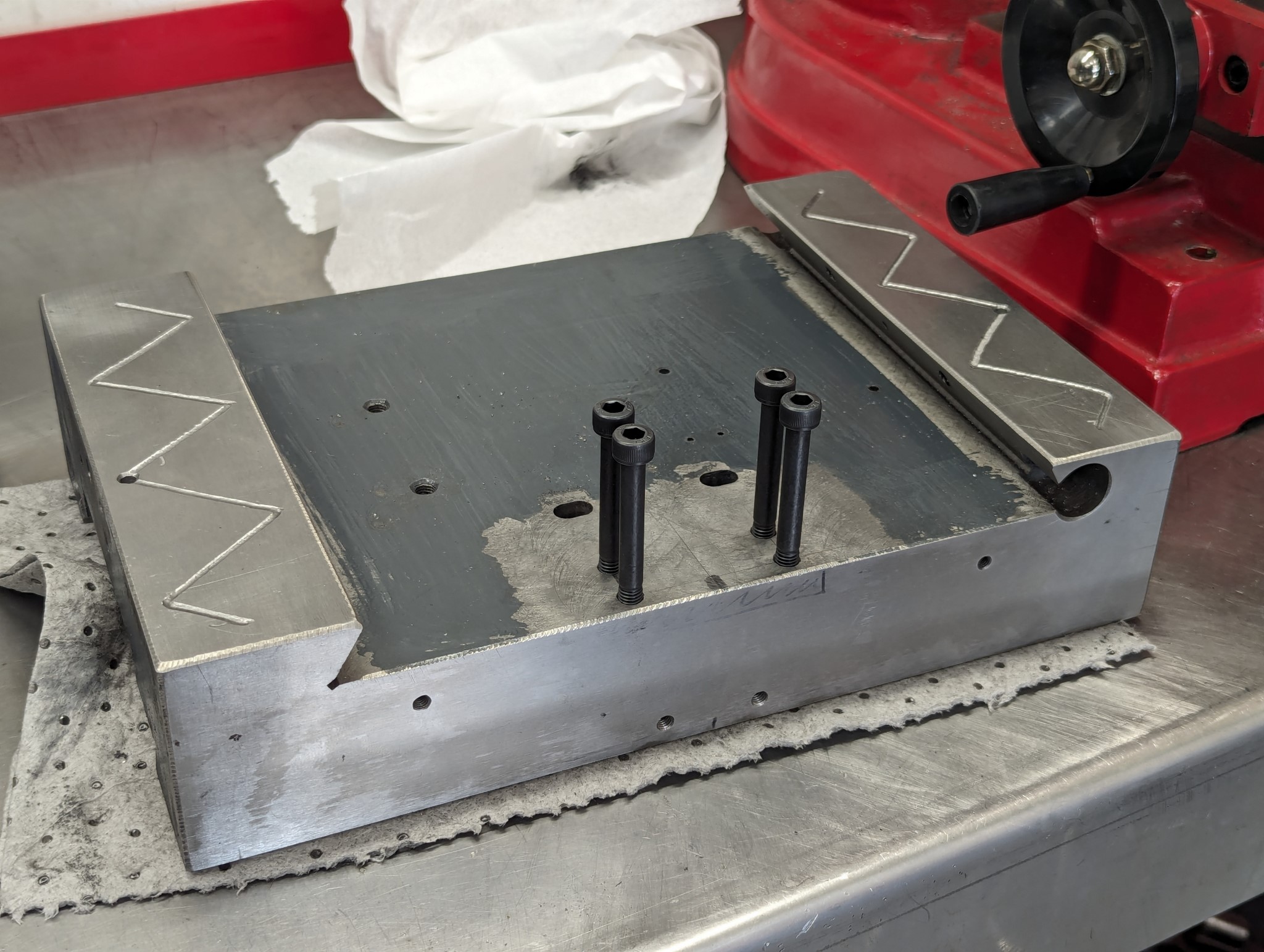

Since I have only one milling machine I had to make the grooves for the oil in the saddle using a Dremel which took a while but gave an acceptable result in the end.
I used this very flimsy Chinese drill press to drill the new holes for the central lubrication oil fittings.

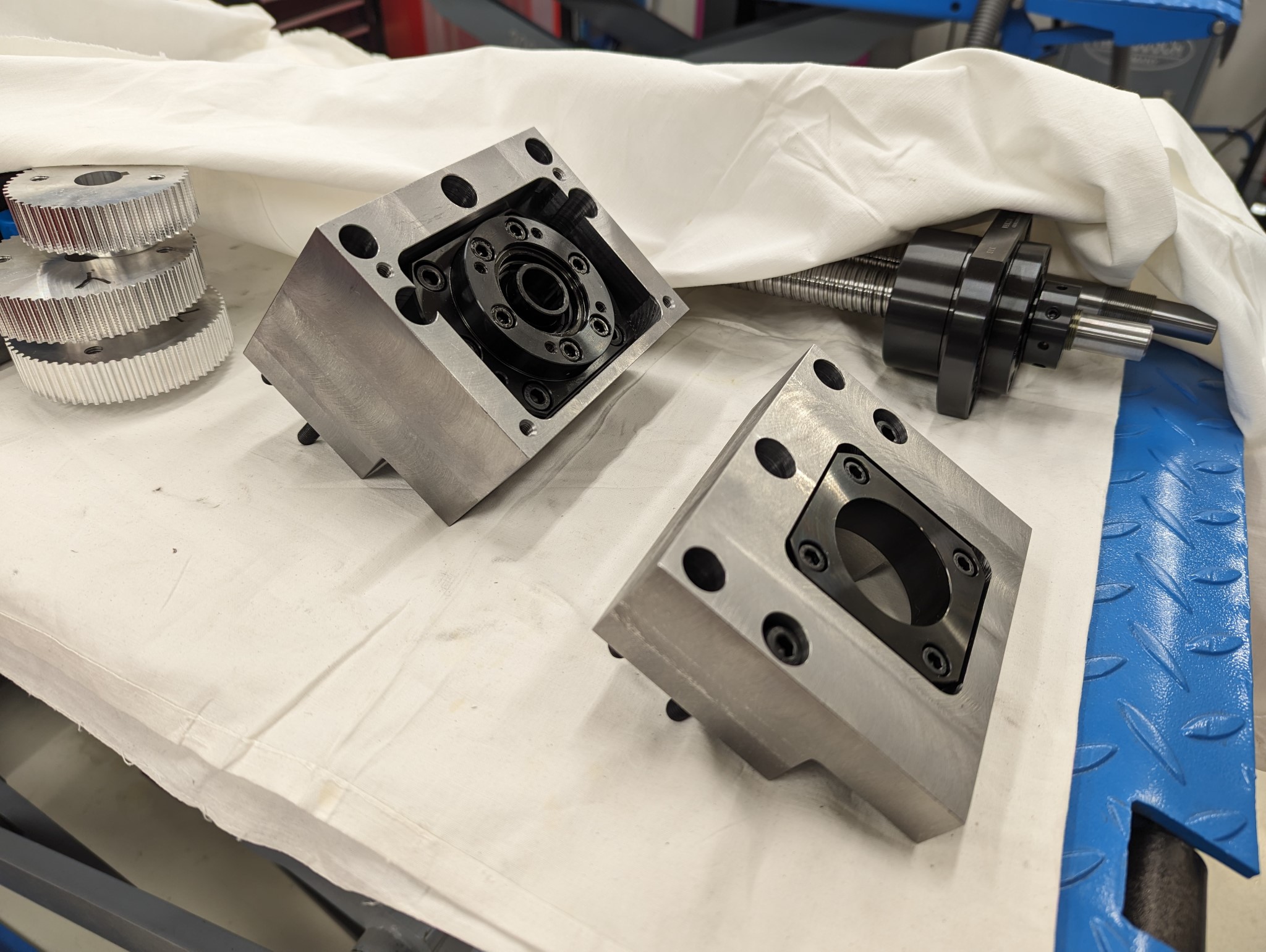

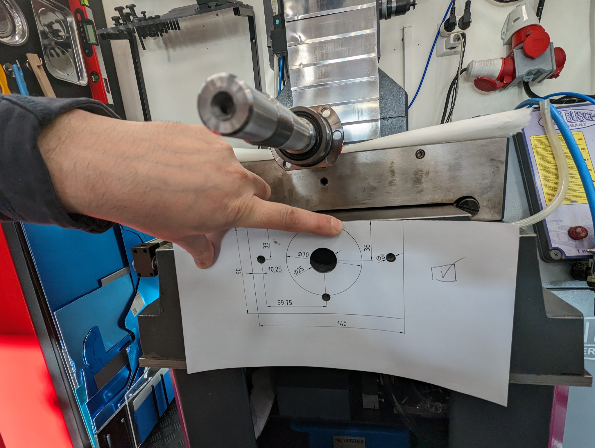

While I was at it I also drilled the holes for the bolts that will hold the mount for the Y axis ball screw nut.

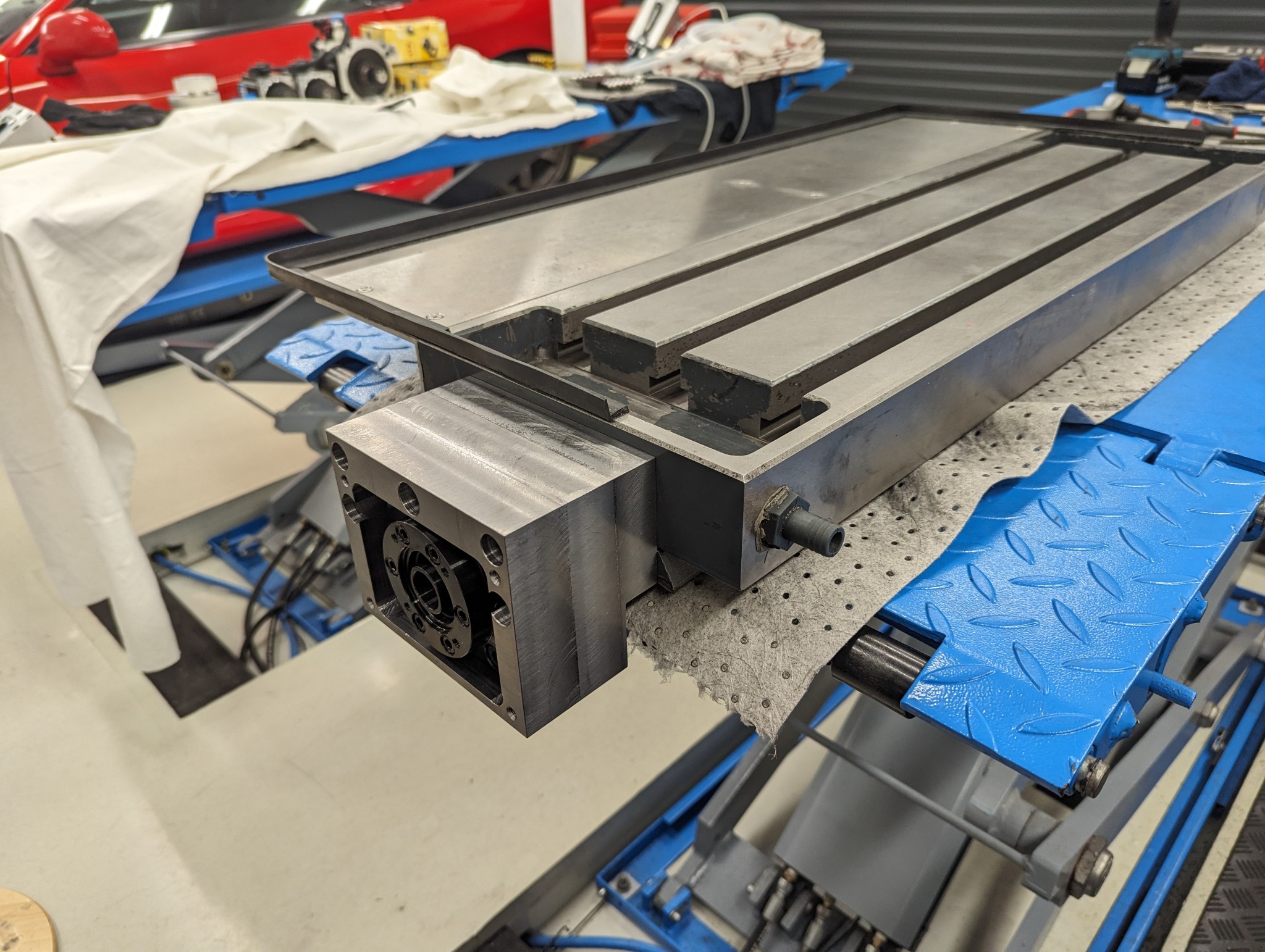

I also removed a tiny bit of material from the saddle in order to extend the travel of the table a bit. The travel will actually be extended a few centimeters because the new ball screw nut mount will sit closer to the column compared to the stock mount for the trapezoidal screw.

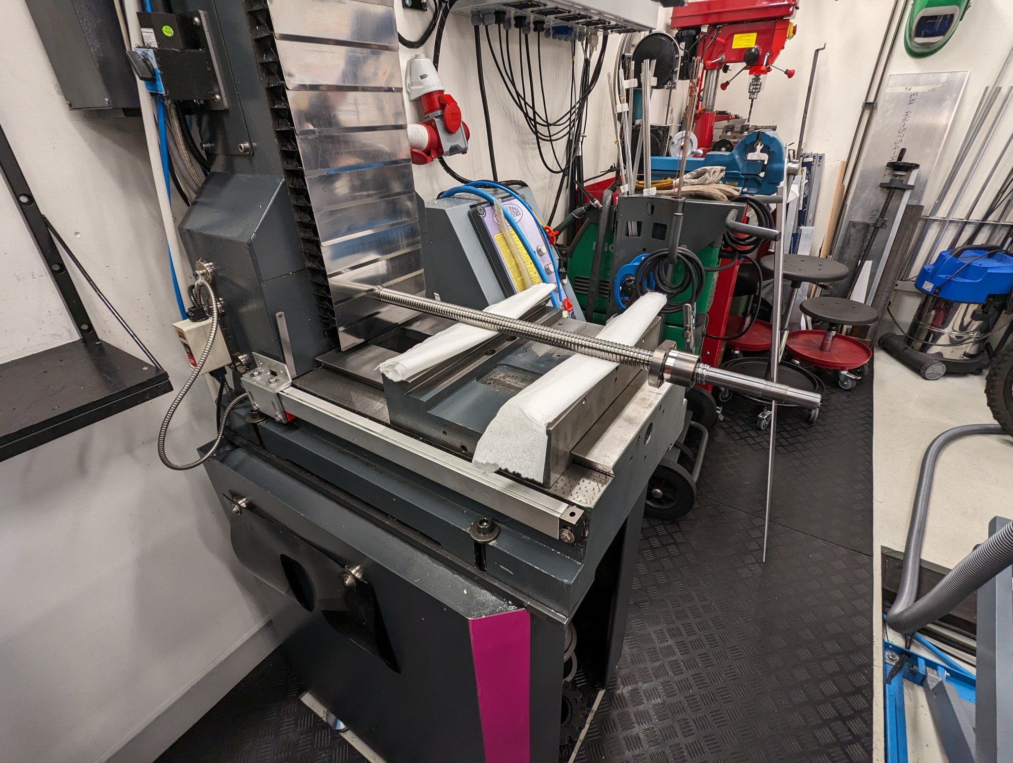

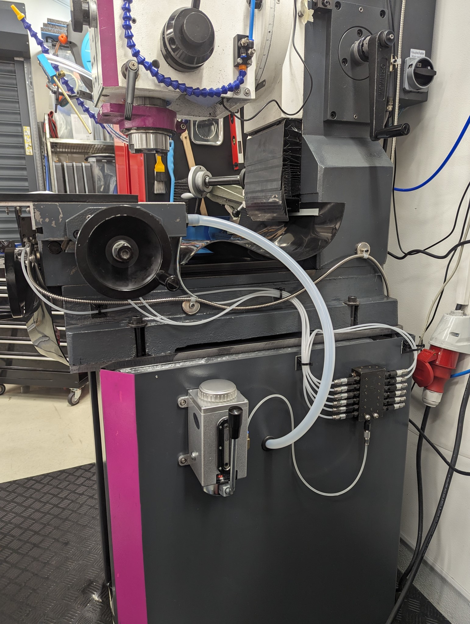

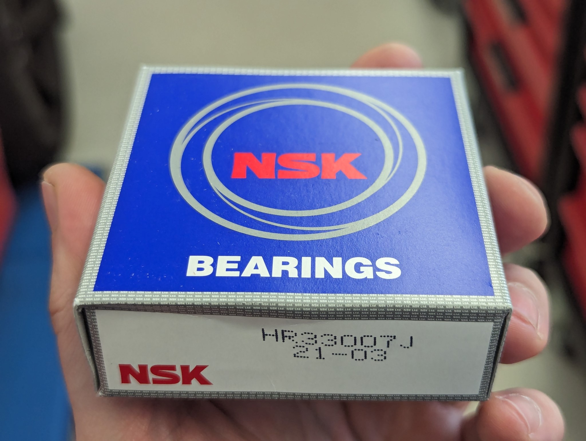

With that done I stoned the gibs a bit and then assembled everything along with the central lubrication system.
The central lubrication and the work on the gibs did wounder for how a smooth the machine travels. This machine really should have come with central lubrication from the factory.
My spindle bearings have been making a slight noise for some time and all the milling in steel haven't exactly improved things. So when the CNC conversion is done and I've regained some bench space in the garage then my plan is the remove the spindle and replace the bearings.
SKF doesn't make the type of roller bearing used for the upper bearing in the spindle so I'm gonna use a mix of SKF and NSK bearings along with Klüber Isoflex NBU 15 grease.

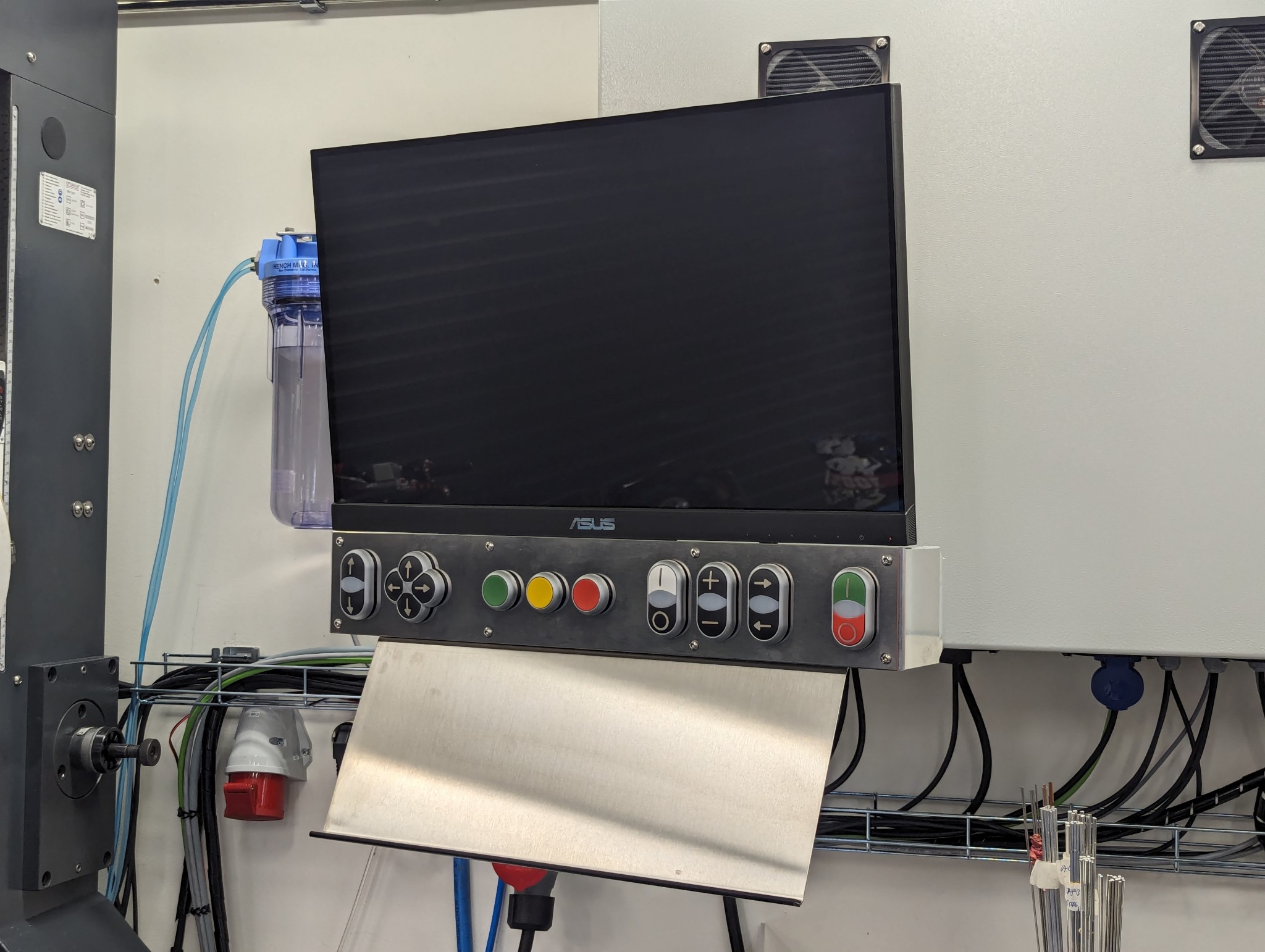

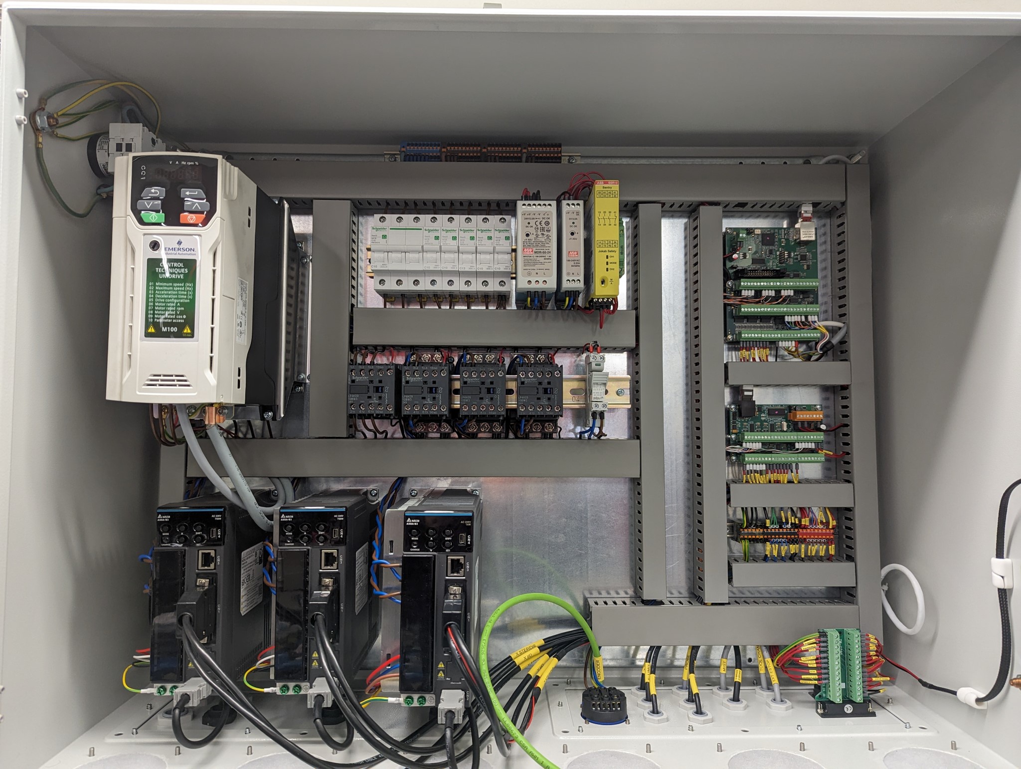

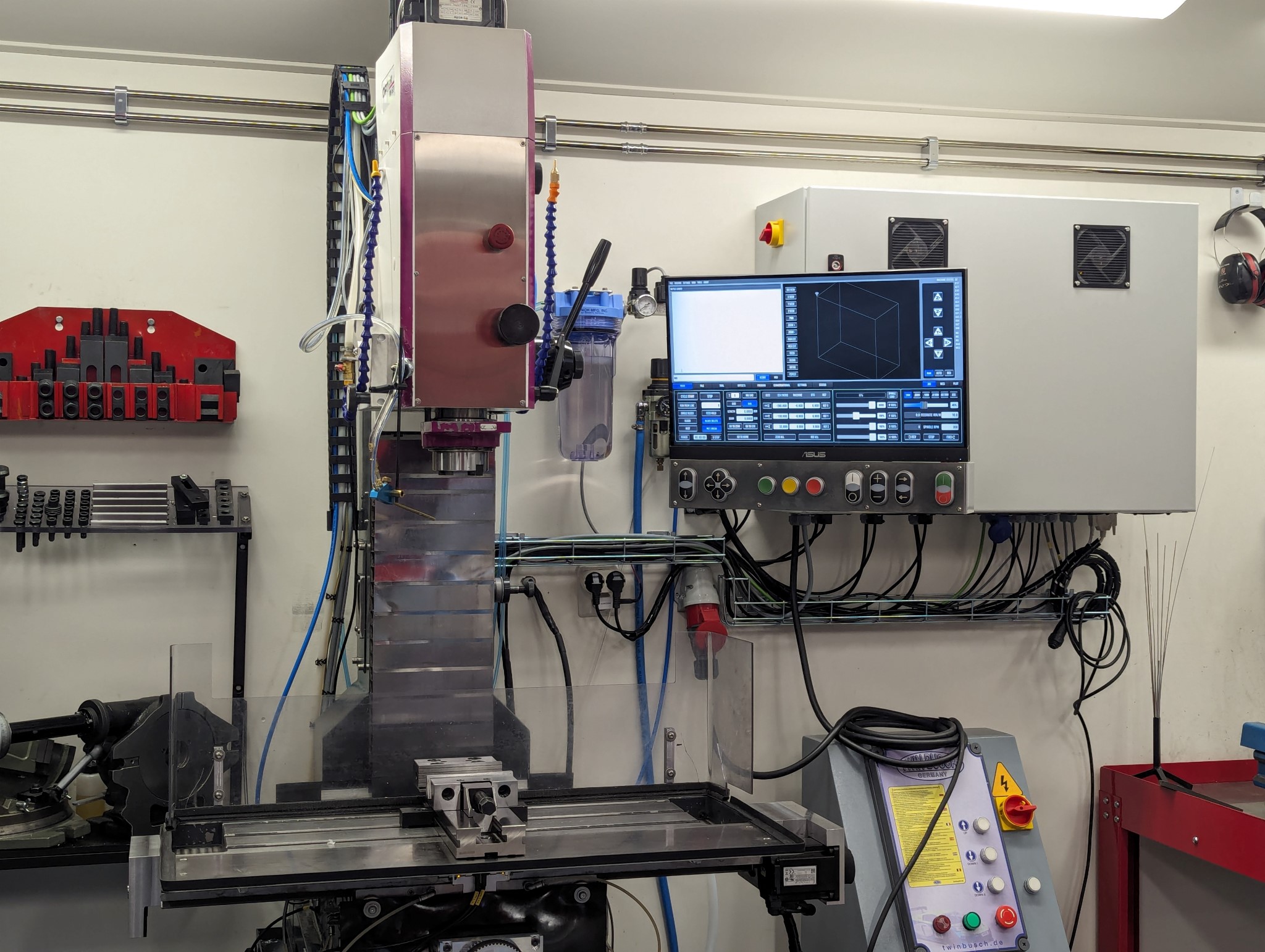

I've finished all the mechanical parts of this conversion now and the electrical cabinet that came with the machine has been removed along with all the stock electronics.
Here is how the control cabinet ended up looking on the inside with everything installed.

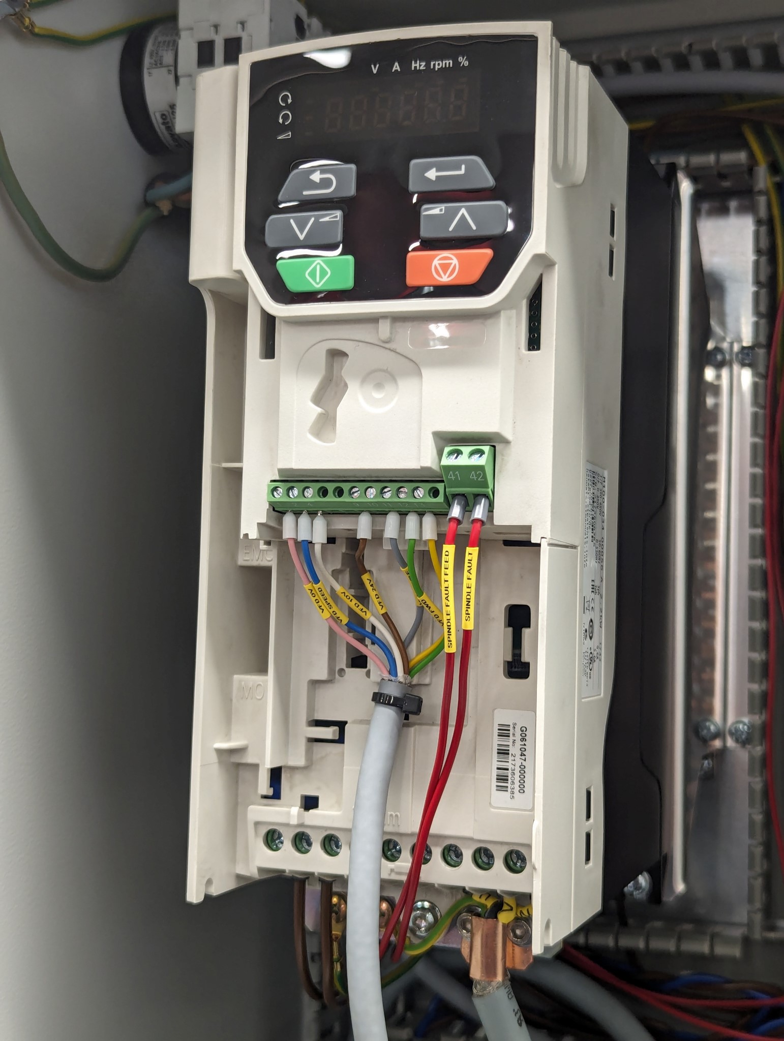

The only thing I reused from the electronics that came with the machine was the VFD and the estop button.

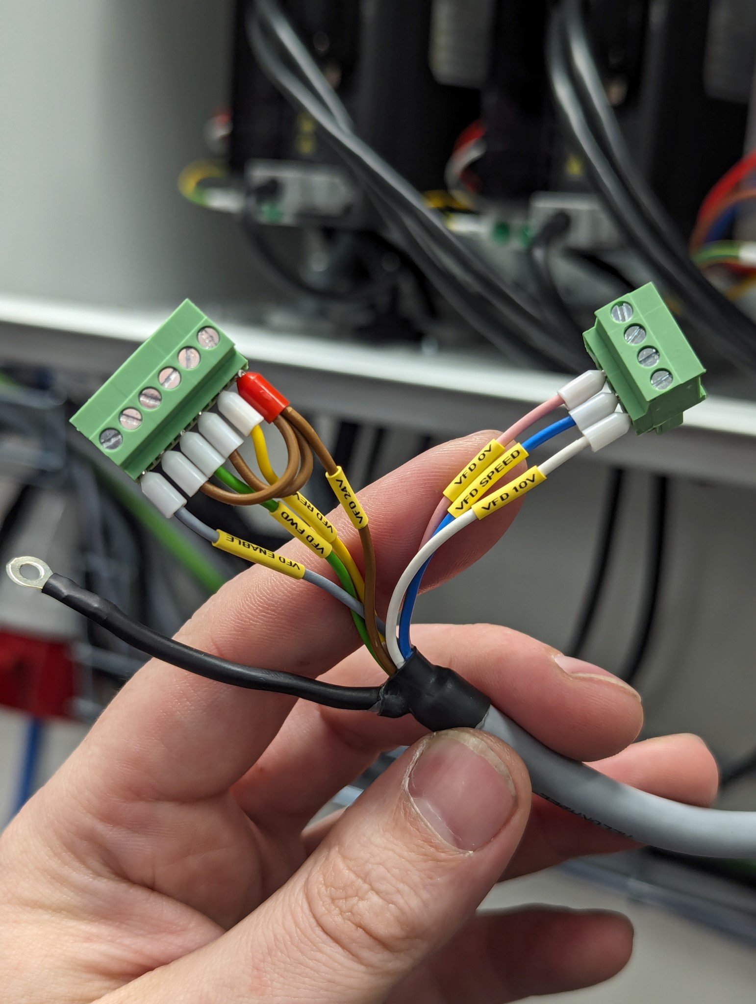

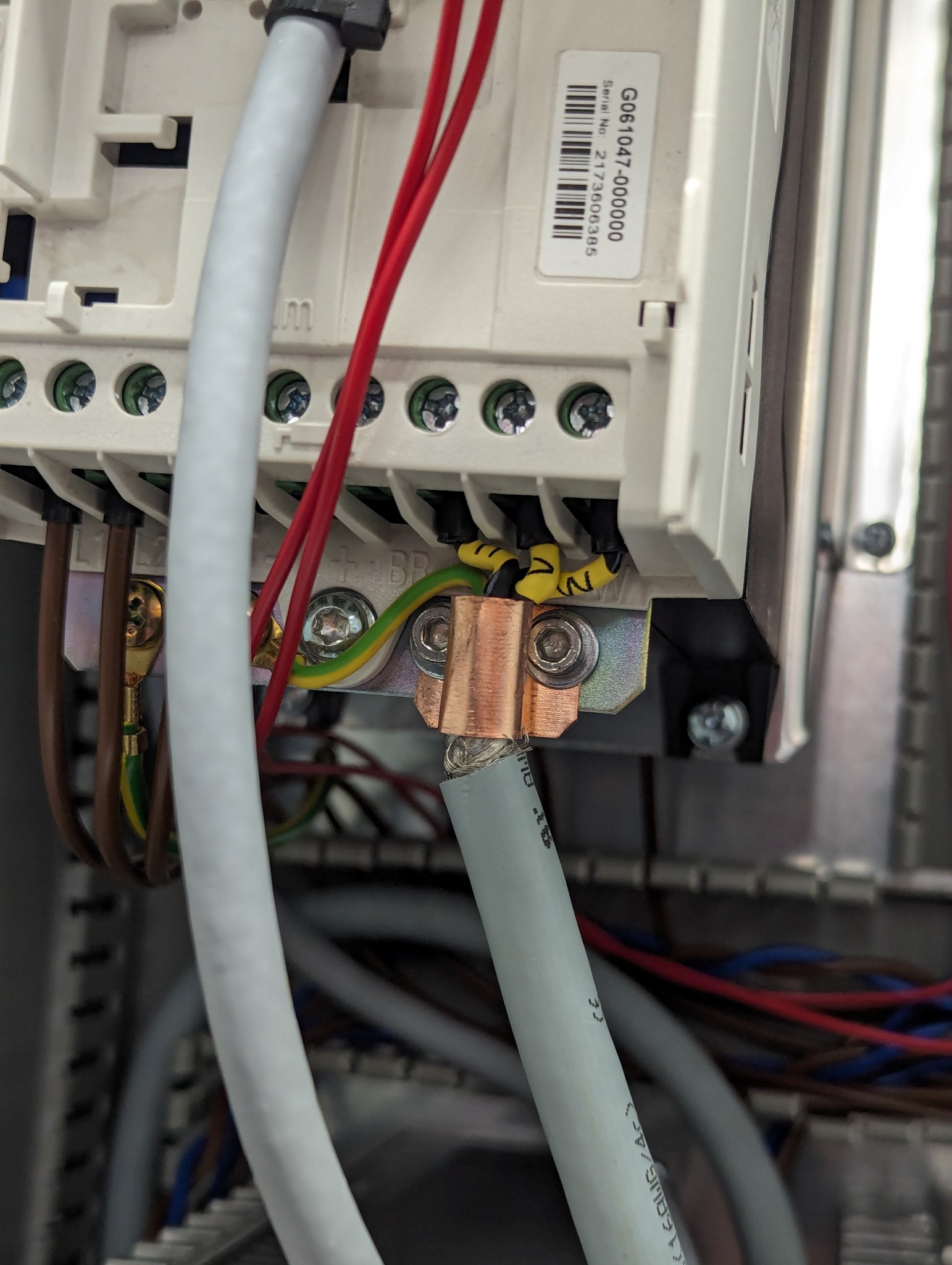

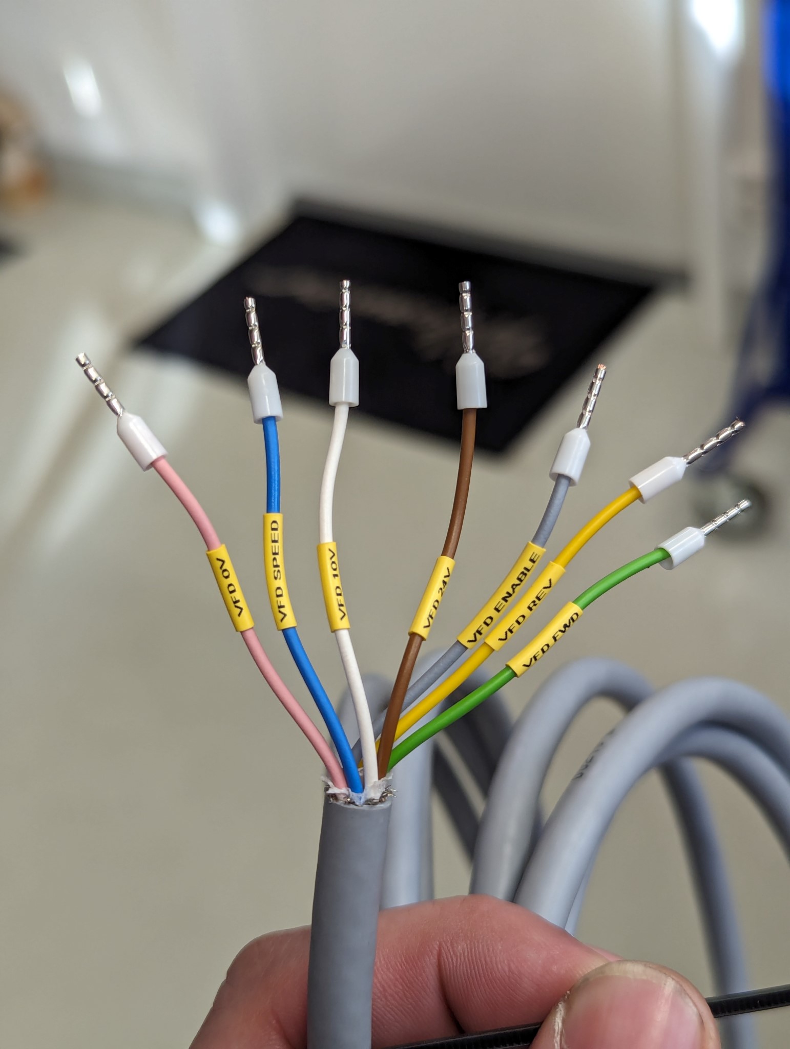

As I know VFD's can generate quite a bit of electrical noise I took no chances and terminated the shielded spindle motor cable right at the VFD using a copper bracket that contacts the shield around the whole circumference of the cable.
I also used a shielded cable for the control cable that goes from the VFD to the Mesa 7i96S board. I wasn't as picky with the termination of the shield here however and used a pigtail. Hopefully this work fine anyway.
I didn't have any shielded two-wire cable so for the fault signal from the VFD I used unshielded cables but these will be replaced shortly. I did this as an interim solution because I wanted to be absolutely sure that the motion stops if there is any fault with the spindle motor.

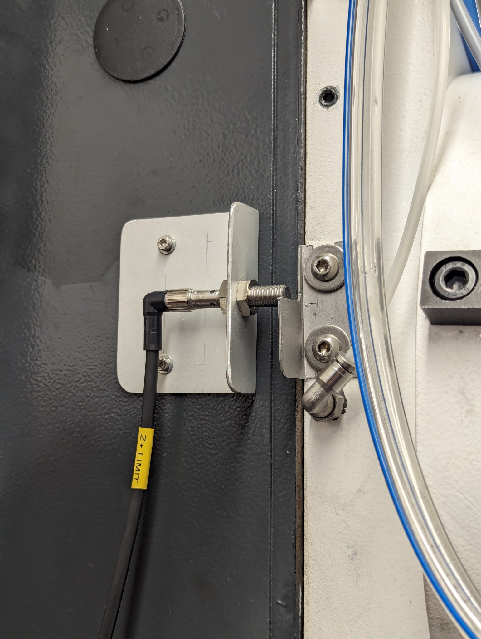

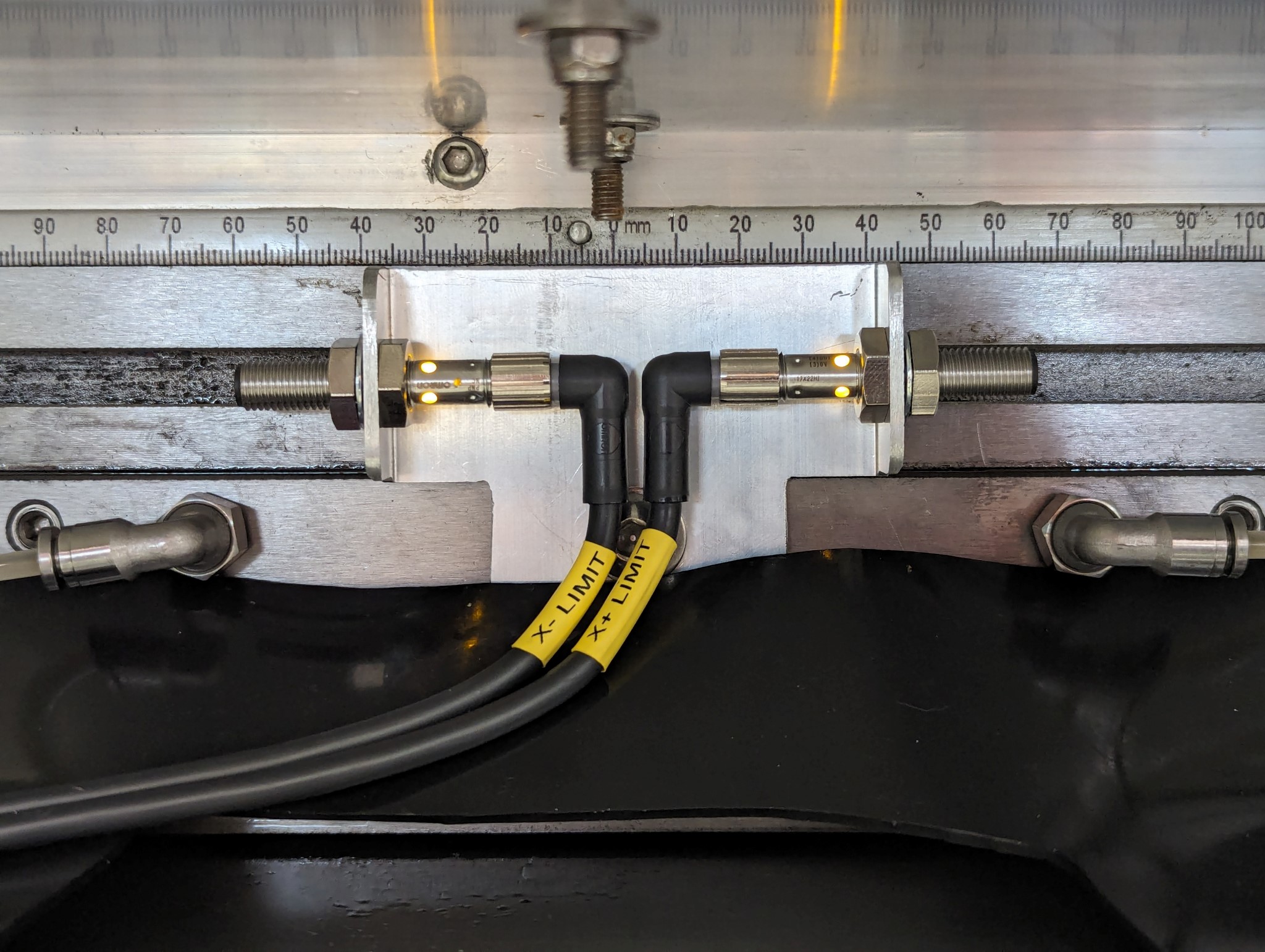

For limit switches I used inductive Omron E2BS08KS02MCB2 sensors. I have one sensor at the end of the travel of each axis apart from the z-axis which only has a sensor at the top.
Here is how the machine looks at the moment.
I need to setup the limit switches in INI/HAL files and properly test them before I can do any serious milling however. I also currently don't have any encoder connected so I don't have closed loop RPM control or the ability to do rigid tapping at the moment.
In preparation for an encoder I installed a shielded 8-wire cable between the mill and the electrical cabinet. I just need to find the right encoder now. Preferably I'd want a 5v encoder that work with the Mesa 7i96S without the need for an optocoupler or voltage level shifter. However finding the right encoder has proven a bit more challenging than I first had anticipated. Any recommendations are very welcome
I've found this Omron model which seems interesting but I'm not sure if it's the right specification and it mentions a maximum cable length of 2m in the specification which seems a bit short (if I'm reading the specification correctly). The shielded 8-wire cable I have already installed is about 5 meters long.
www.ia.omron.com/product/item/2500/

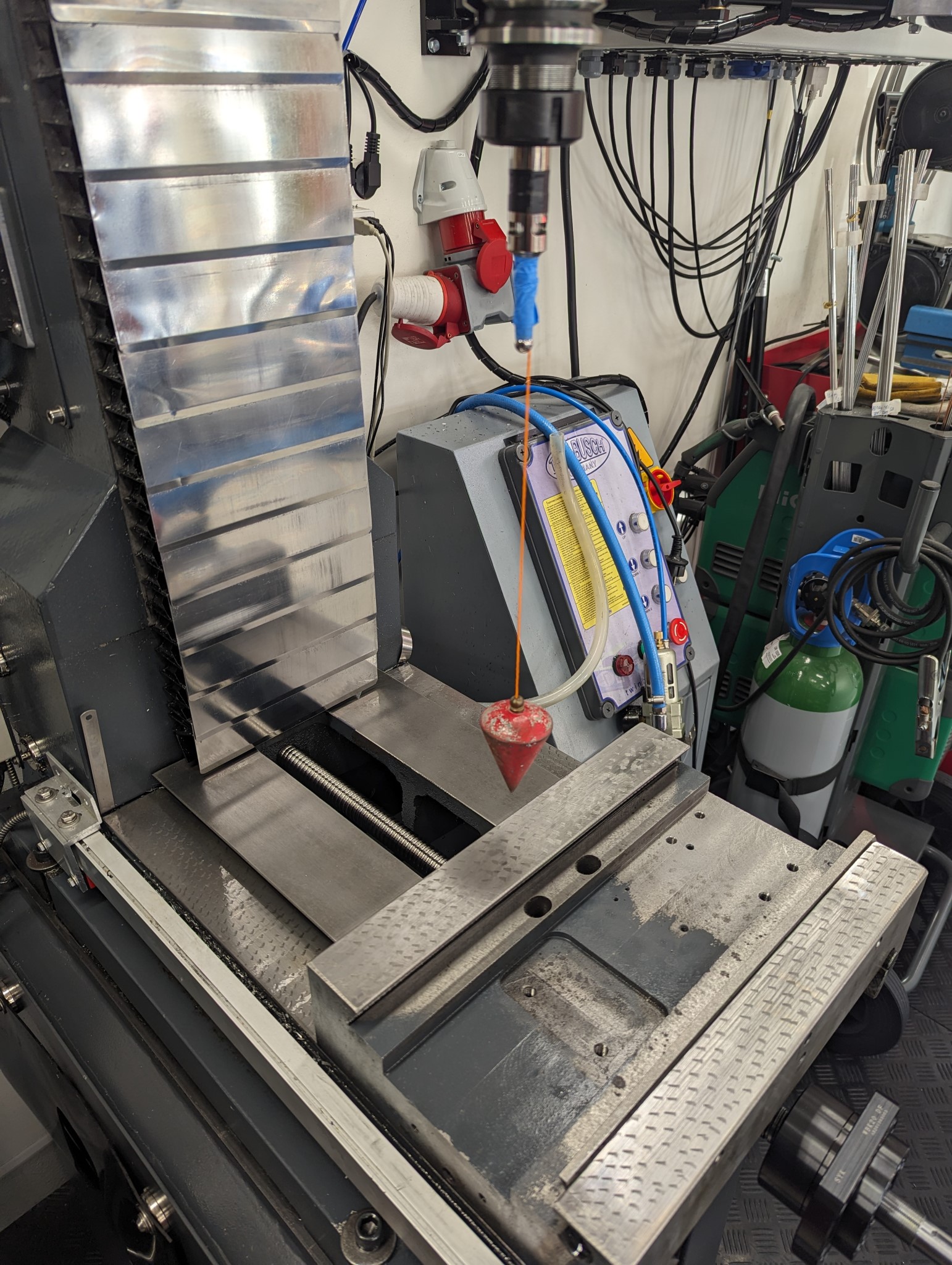

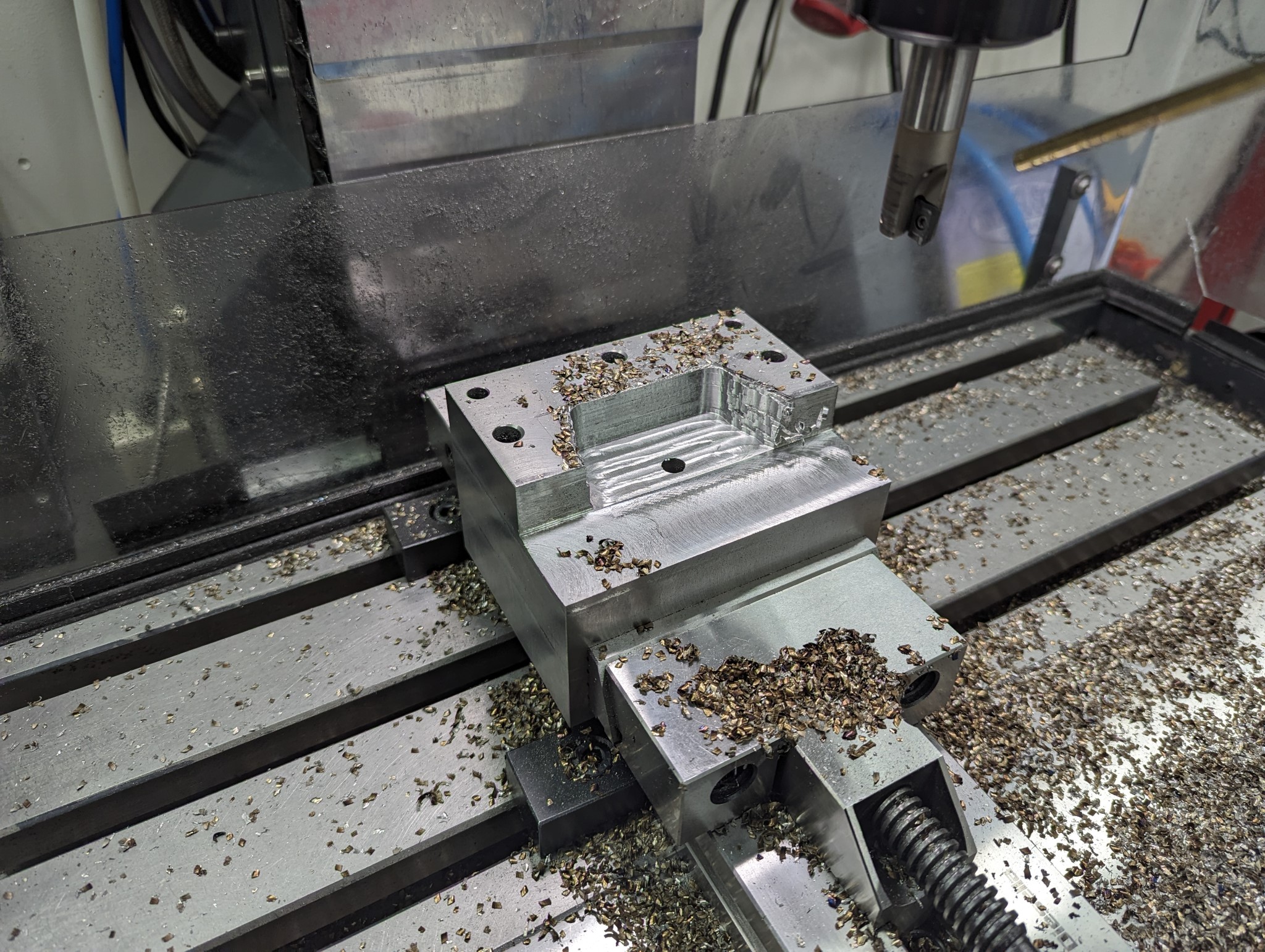

Did my first real test today with everything assembled.
Going to run the calibration software for the Delta B3 servos tomorrow. If everything looks good I'll probably try to mill some aluminium covers for the X and Y axis belts.

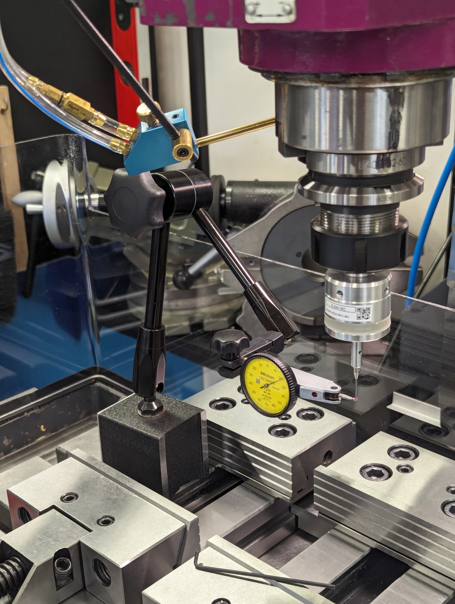

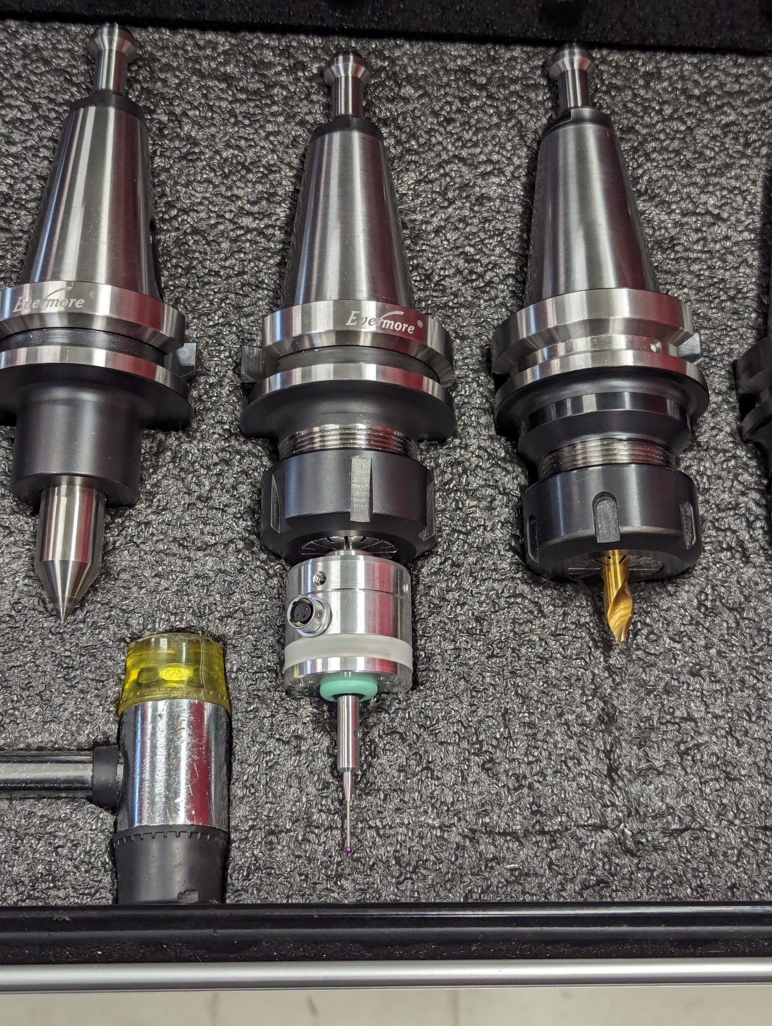

Next up I focused on the Slavetec Probe I bought a while back. It had to be aligned with the spindle which took 2-3 hours of fiddling with the adjustment screws.
After getting close with the hundreds of mm indicator I switched to a 1µm indicator and in the end I got a result that I'm very satisfied with.
Given how long time the alignment took I'm probably never going to remove the probe from that tool holder ever again so it now has a permanent spot in my cart with tool holders.

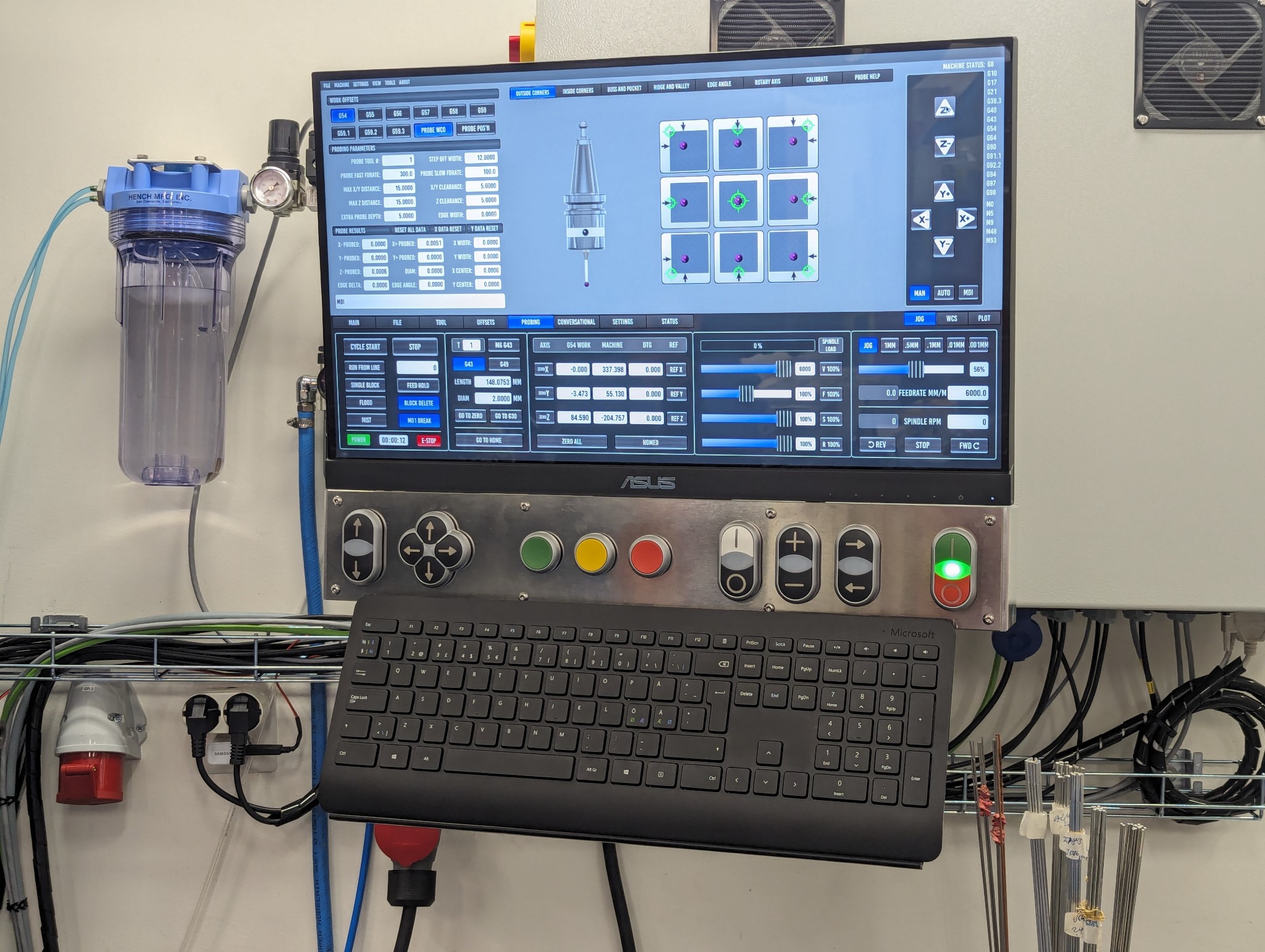

The parameters for the probing interface in Probe Basic seemed a bit daunting at the beginning but I think I'm getting the hang of them now.
