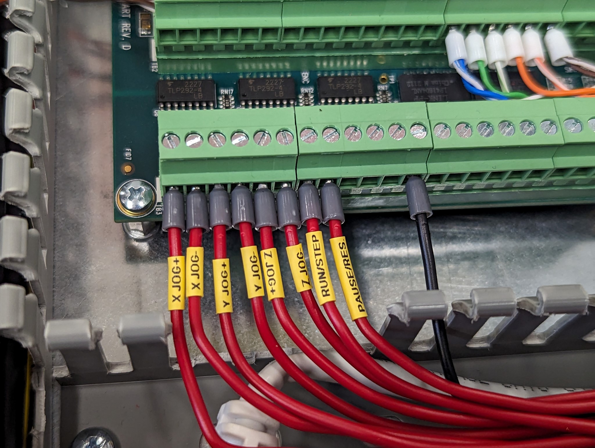

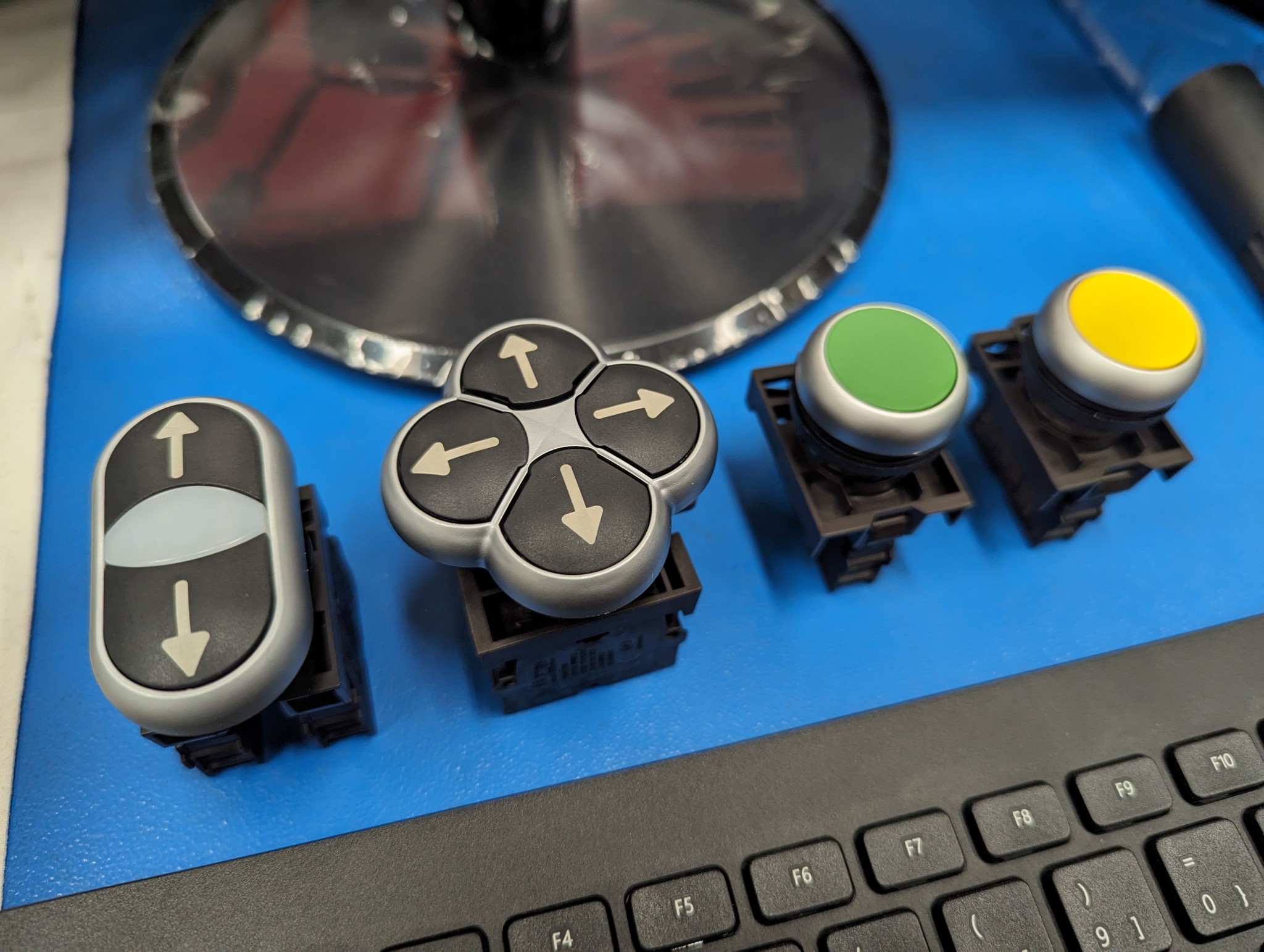

With e-stop, steps and alarms sorted I became a little more confident in starting to push the servos a bit so I hooked up the physical buttons for jogging, run/step, pause/resume.
It was at this time that I found the setting on the Dymo machine for font size allowing me to create much smaller heat shrink labels .
Getting the run/step, pause/resume to work using the HAL code provided by BigJohnT here was a breeze and worked on the first attempt. Big thanks to John for that code as it would have taken me a considerable amount of time to write it from scratch. In order to keep my custom.hal file as readable as possible I opted to put John's code in a separate run_pause.hal file which I then included in my custom.hal file using the below.
source run_pause.hal
The jogging however proved a little bit more tricky. I had the HAL pins set correctly and I could see the inputs and HAL pins being triggered but there was no movement of the servos when I pressed the buttons. I read that the halui.axis.X.plus/halui.axis.X.minus pins only worked after the machine had been homed but homing didn't help either. After a bit more reading and I found out that the jog speed and increment in the GUI is separate from the physical jog buttons (which makes sense for those with physical jog speed select switches) so setting the parameter below was required to get things moving.
setp halui.axis.jog-speed 100
I found a code example here on the forum by Nebur for synchronizing the physical jog speed with the setting in the Axis GUI. My plan is to use Probe Basic so I hope something similar can realized for the GUI too. If anyone has any input here it would be much appreciated

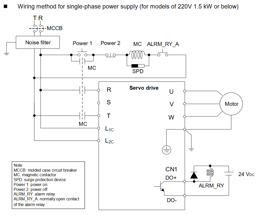

07 Nov 2023 14:22 #284778 by tommylight
Replied by tommylight on topic Optimum Optimill MH50V CNC conversion
Do the drives clear faults when disabled and enabled again?
Most of what i used did, so i never needed to add anything except the fault inputs.
Fault input should disable the machine by disabling drives so all that it required to clear was to press F2/enable and move on.

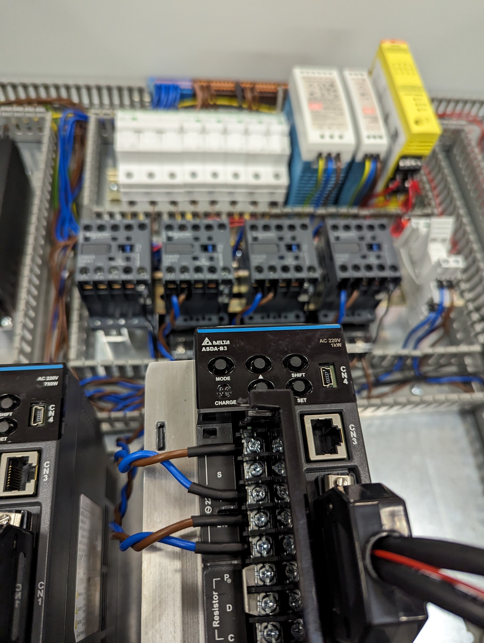

07 Nov 2023 14:51 - 07 Nov 2023 15:02 #284781 by Unlogic
Replied by Unlogic on topic Optimum Optimill MH50V CNC conversion
The drives clear the fault codes when they receive a signal on the digital input pin mapped to alarm reset (ARST) or when they loose all power.
As the servo drives have dual power inputs the fault codes are retained even when e-stop is triggered and reset because the logic section remains powered during an e-stop.
Here is snippet from Delta manual on how they want the drives to be wired up:
So I've wired mine up according to the manual with the both inputs going through curcuit breaker and EMI filter but only the upper input goes through the contactor.
This way the step/position from the encoders is retained in the drives during e-stop which hopefully means that homing won't always be required after an e-stop.

07 Nov 2023 16:02 #284790 by anders
Replied by anders on topic Optimum Optimill MH50V CNC conversion
Excellent build log, following this closely! What do you use to mark your cables? It all looks very neat and clearly labelled.
The following user(s) said Thank You: Unlogic
07 Nov 2023 16:13 #284791 by Unlogic
Thanks you Anders!
I'm using a DYMO Rhino 4200 together with this non genuine heat shrink tube from Amazon ( link ) and a cheap 9V AC/DC adapter also from Amazon ( link ) so that I don't have to deal with batteries.
If you buy one of these units, don't forget to turn down the font size like I did initially
08 Nov 2023 11:38 #284859 by Unlogic
I made short video showing how the drivers retain the current step count when they are wired up like it's described in the manual from Delta.
The following user(s) said Thank You: tommylight, 0x2102
