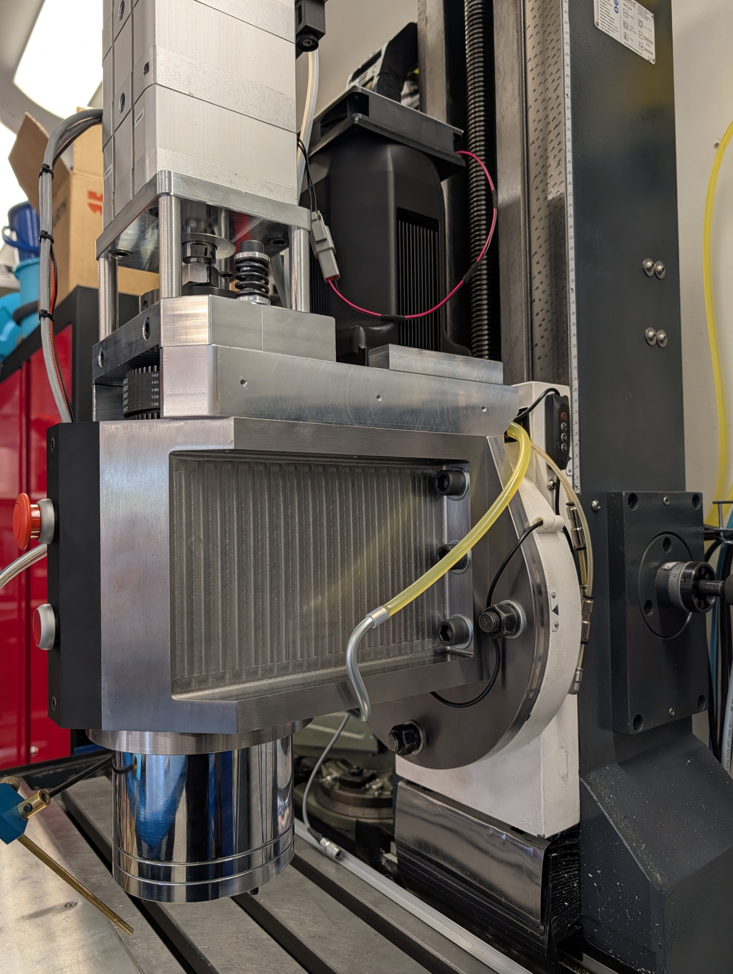

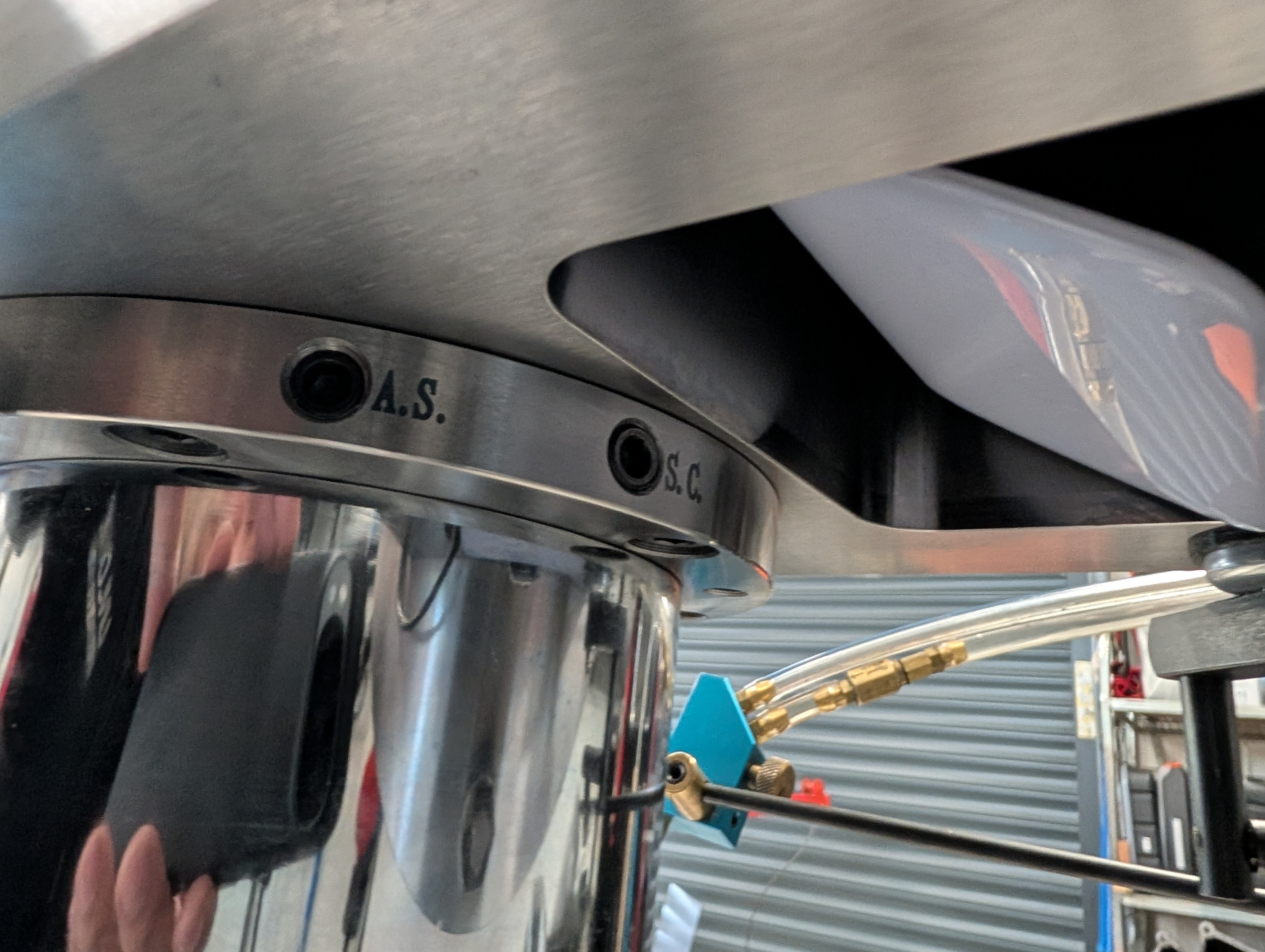

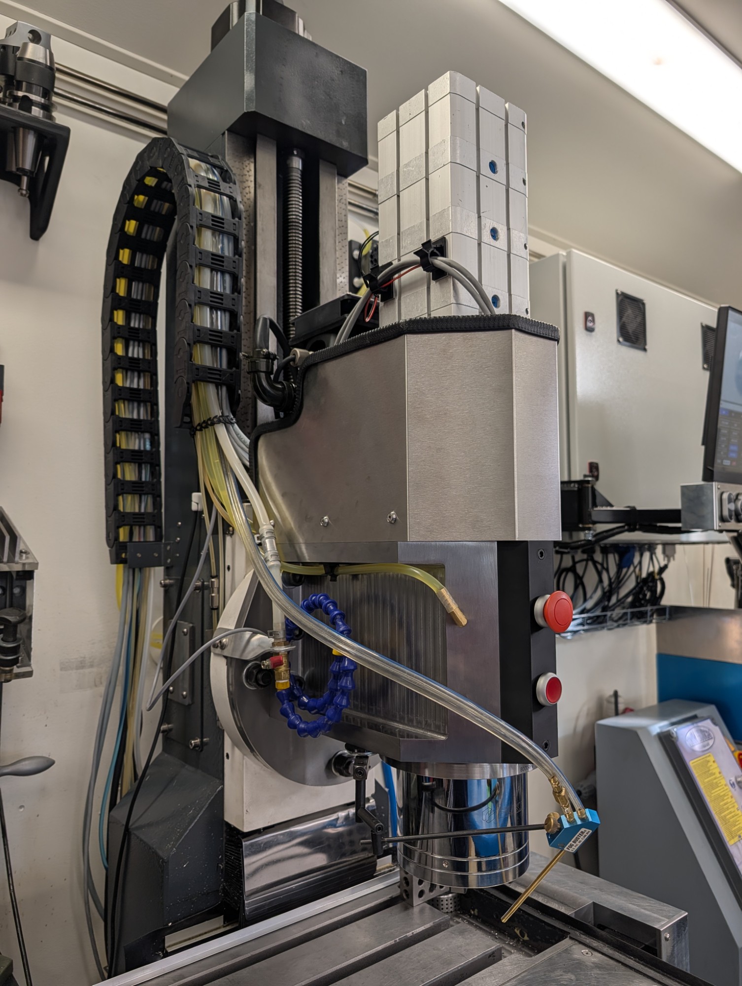

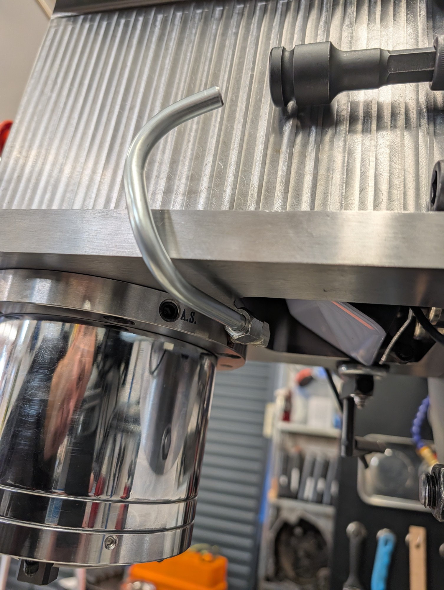

For some reason the final bits always take longer than expected to get sorted. I've managed to get the spindle liquid cooling installed and to somewhat button up the build for now.

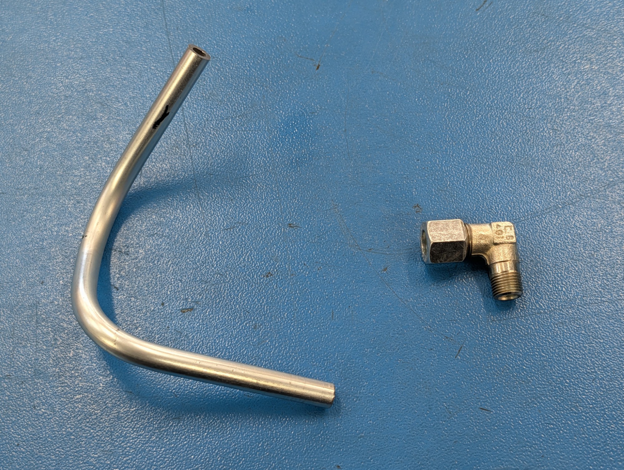

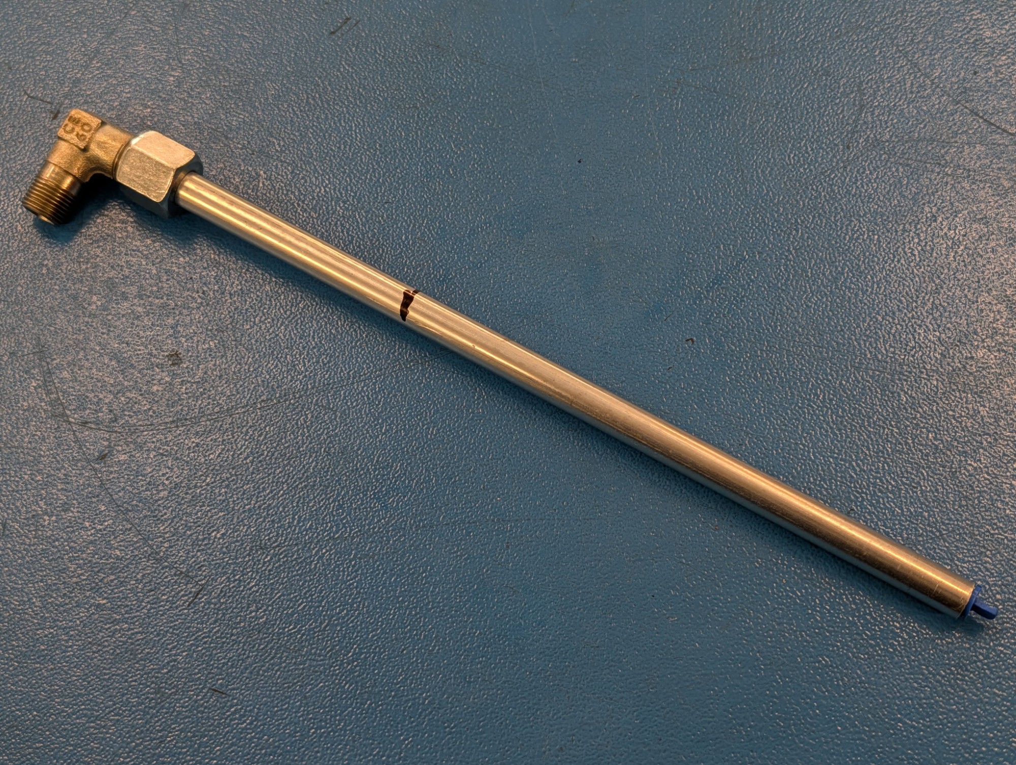

The first challenge with the spindle cooling was the location of the inlet which is located at the back of the spindle flange.
I didn't want any hoses down there as the hot chips when milling steel could easily damage them. So I did a little workaround using an angled fitting and a bit of pipe originally meant for a grease based central lubrication system.

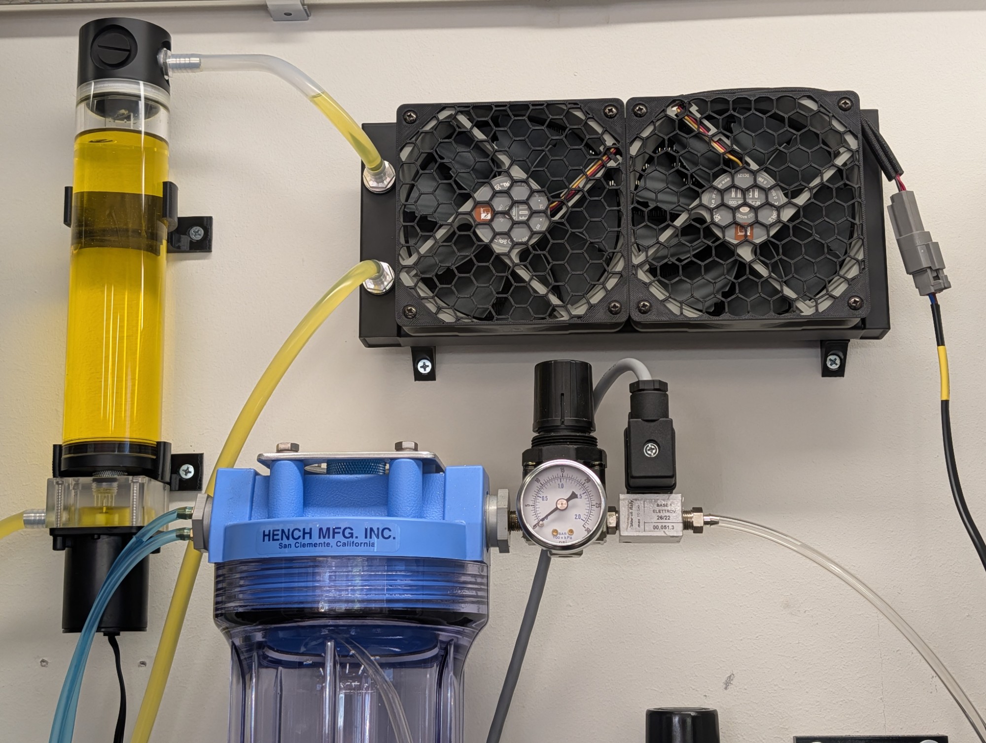

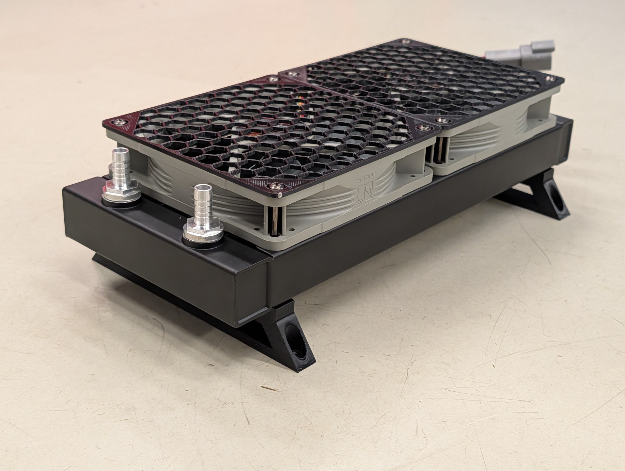

Next up I tackled the the cheap PC water cooling radiator I had purchased of Amazon. I 3D printed some wall mounts for it along with two fan grills for the Noctua fans.
Here it is mounted on the wall together with the pump/reservoir unit which I also purchased of Amazon. The yellow color is from the special type of antifreeze I use together with deionized water.

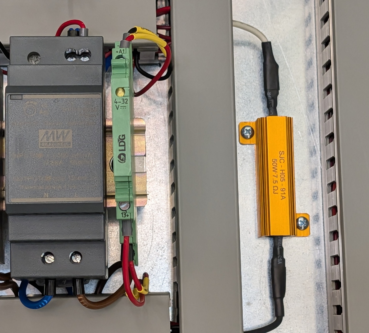

Since the both the pump and fans are meant to be used in PC's they are rated for 12 volts so I added a separate Meanwell 12V/2A power supply for them.
The power supply is constantly powered but I switch the output side using a solid state relay so that the cooling only runs when the spindle is on.
However the pump proved to be a bit noisy and way too powerful give the small diameter hose I'm running. So added a 7.5Ω resistor in series with the pump to bring the voltage down to 8V which made it much quieter and brought the flow down to a more suitable level.

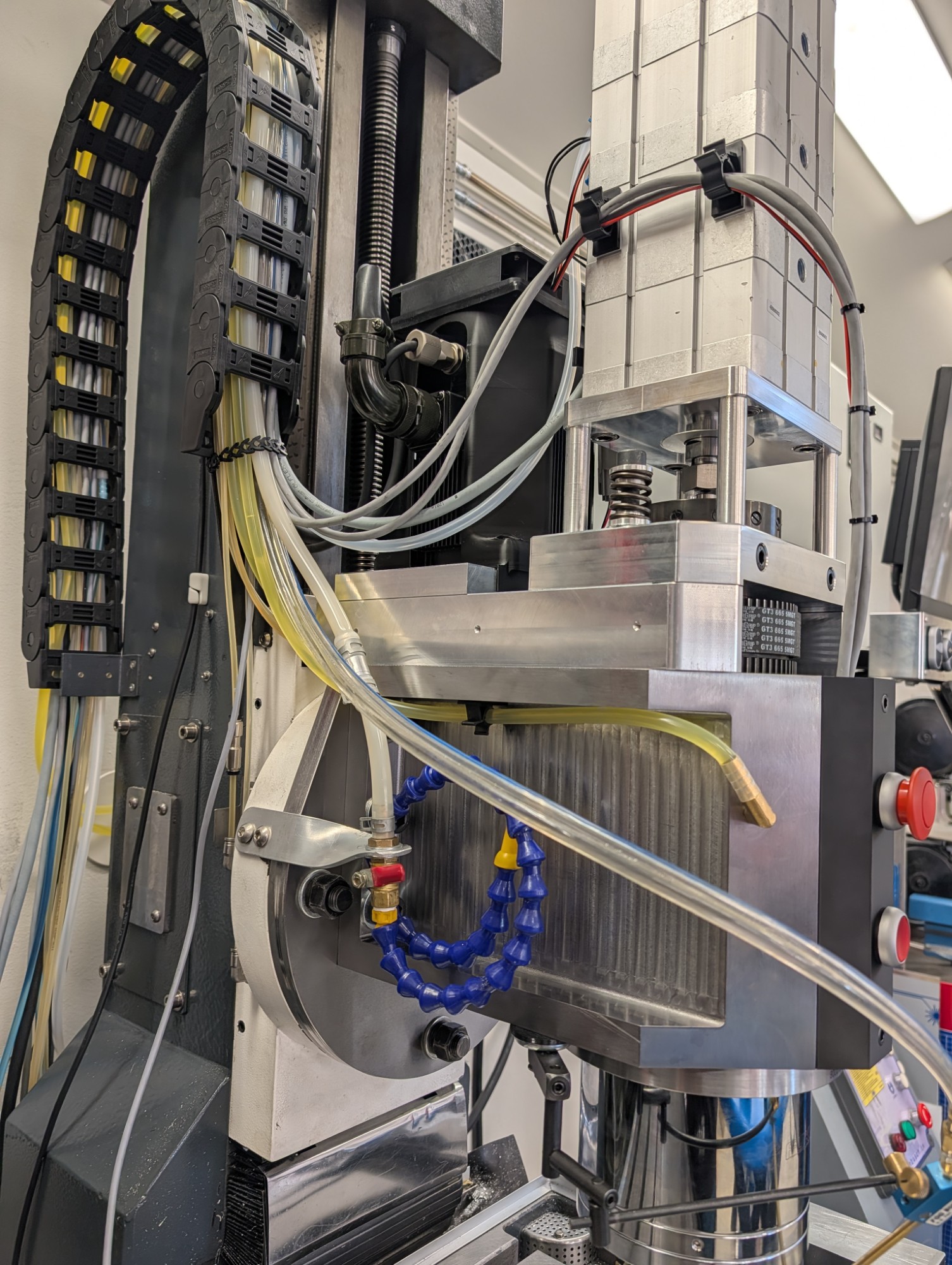

With that done I tackled the cable chain along with all the wires and hoses.

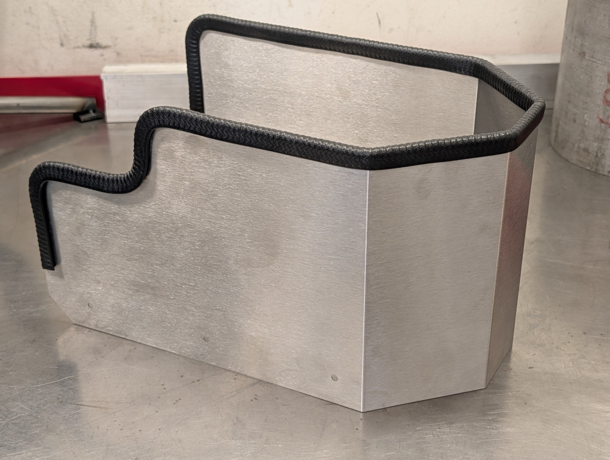

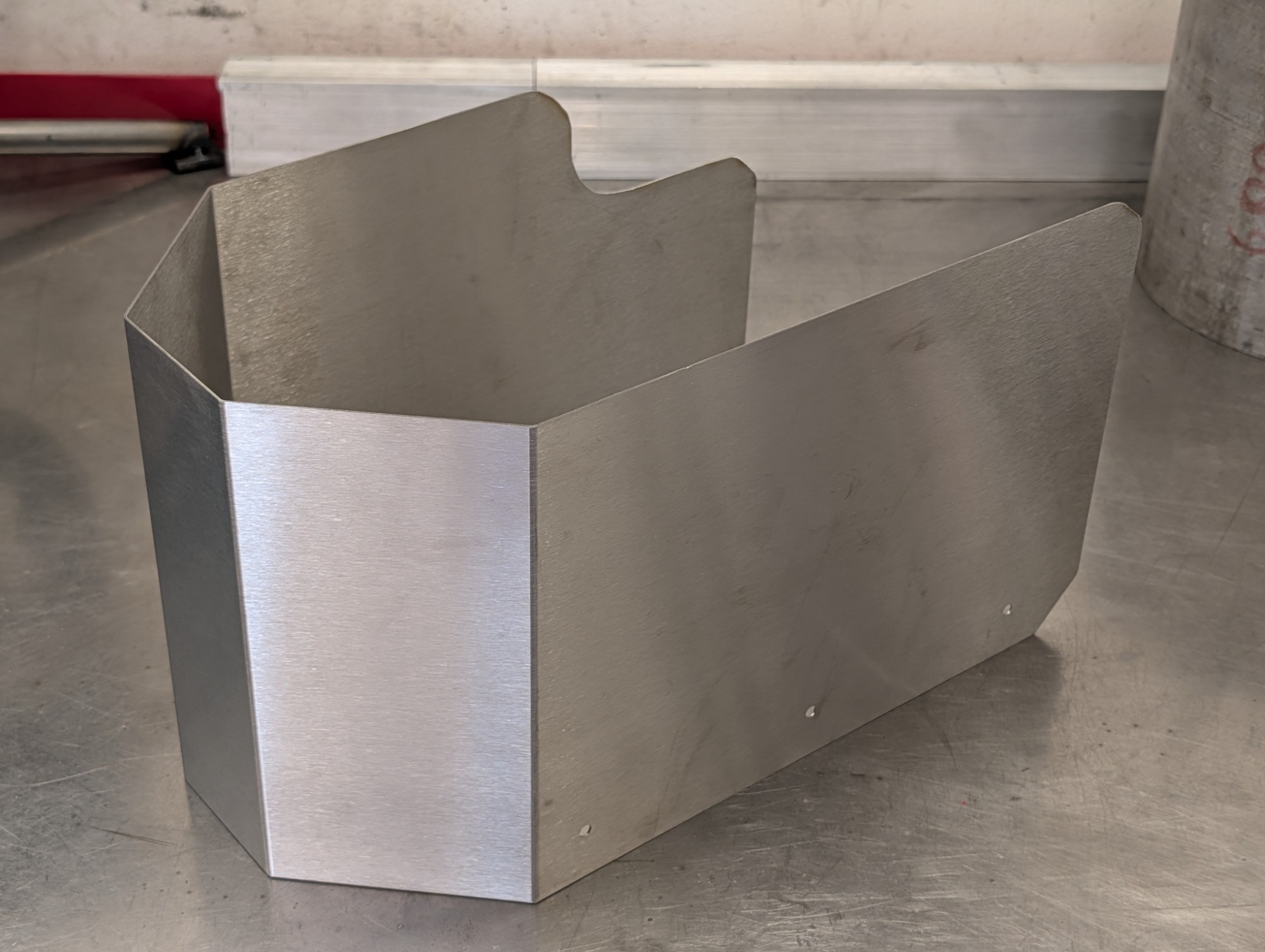

With that in order I turned my attention to the stainless cover I had laser cut and CNC bent a while back. I had to manually make a cut out for the connector of the spindle servo which I had forgotten to take into account. But I think it came out okay anyway.
Fitted it with a rubber strip to cover the sharp edges.

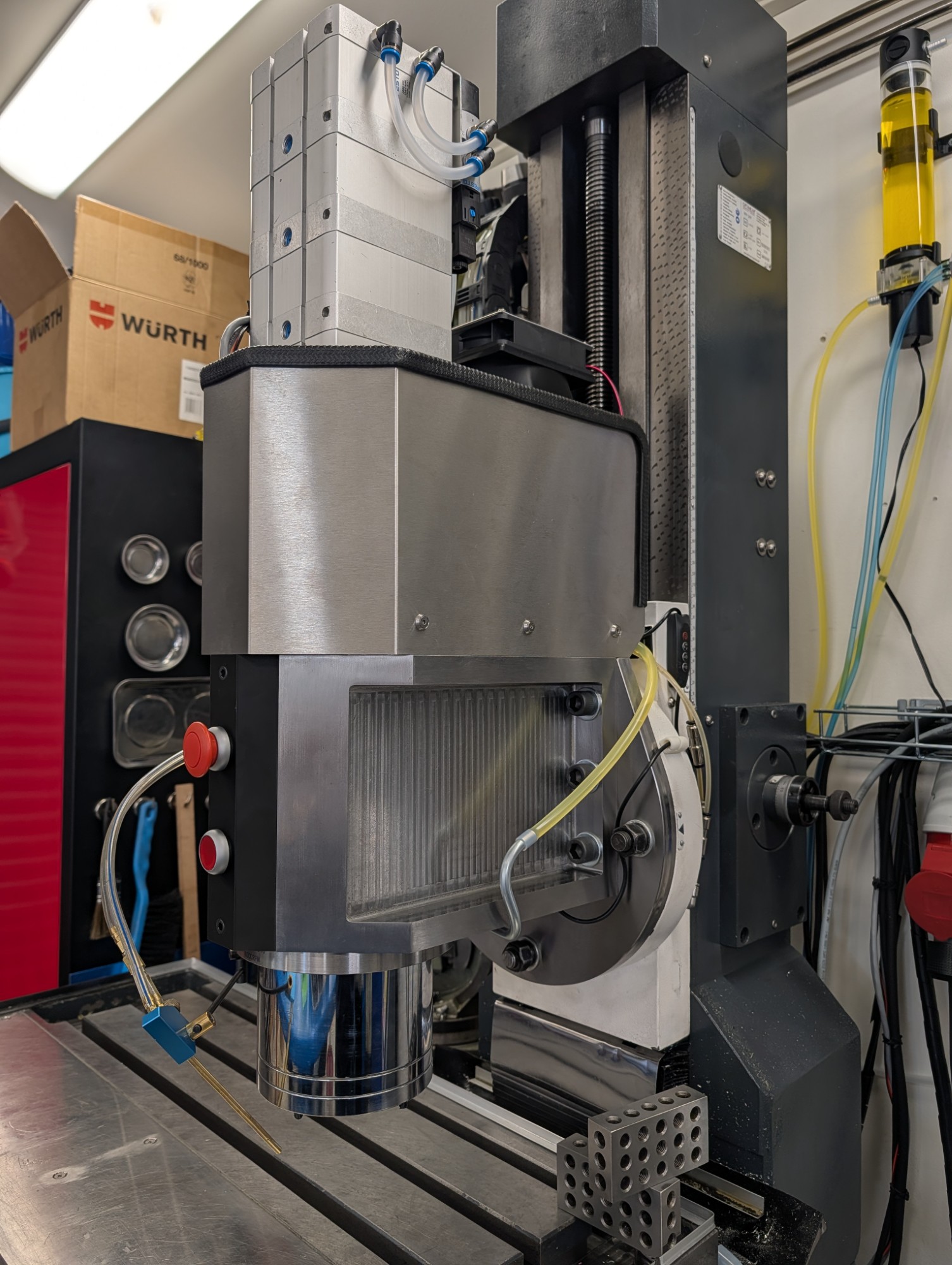

Here is how the machine looks with the cover installed.

25 Sep 2026 05:44 #349856
by Unlogic
Replied by Unlogic on topic Optimum Optimill MH50V CNC conversion

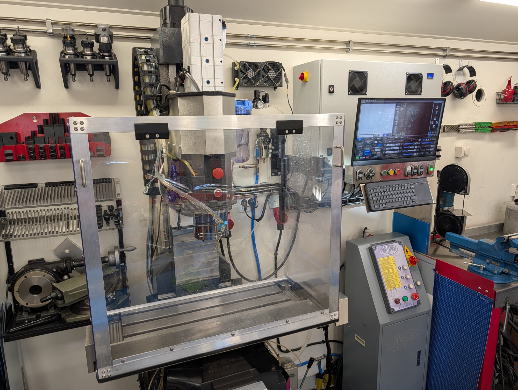

And here is how it looks with the enclosure mounted on the table.

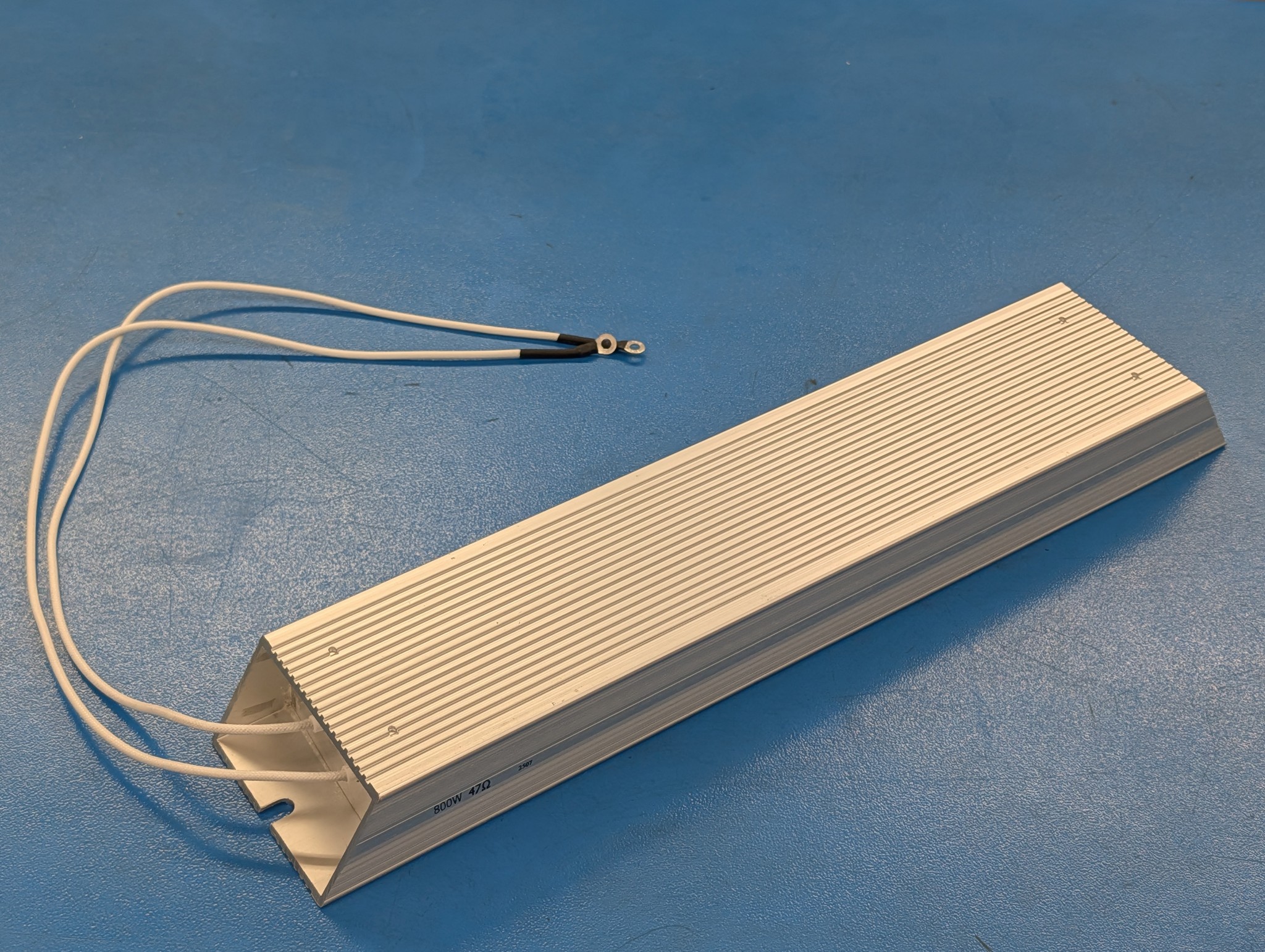

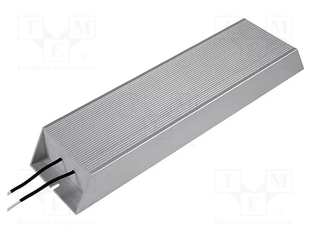

Going from 3500 to 6000 rpm along with the increased the inertia from the larger spindle overwhelmed the built in regenerative braking resistor in the spindle drive when coming to a full stop from 6000 rpm. I managed to get it somewhat working for now by increasing the time for the spindle ramp down by a few seconds.
But if I stop the spindle a few times in successions from full rpm I still get the fault. So I ended up ordering an external 800W braking resistor which should be here early next week.
If I managed to follow the formulas in the Delta B3 manual correctly a 550W resistor should be enough for my setup. So hopefully 800W will give me plenty of headroom.

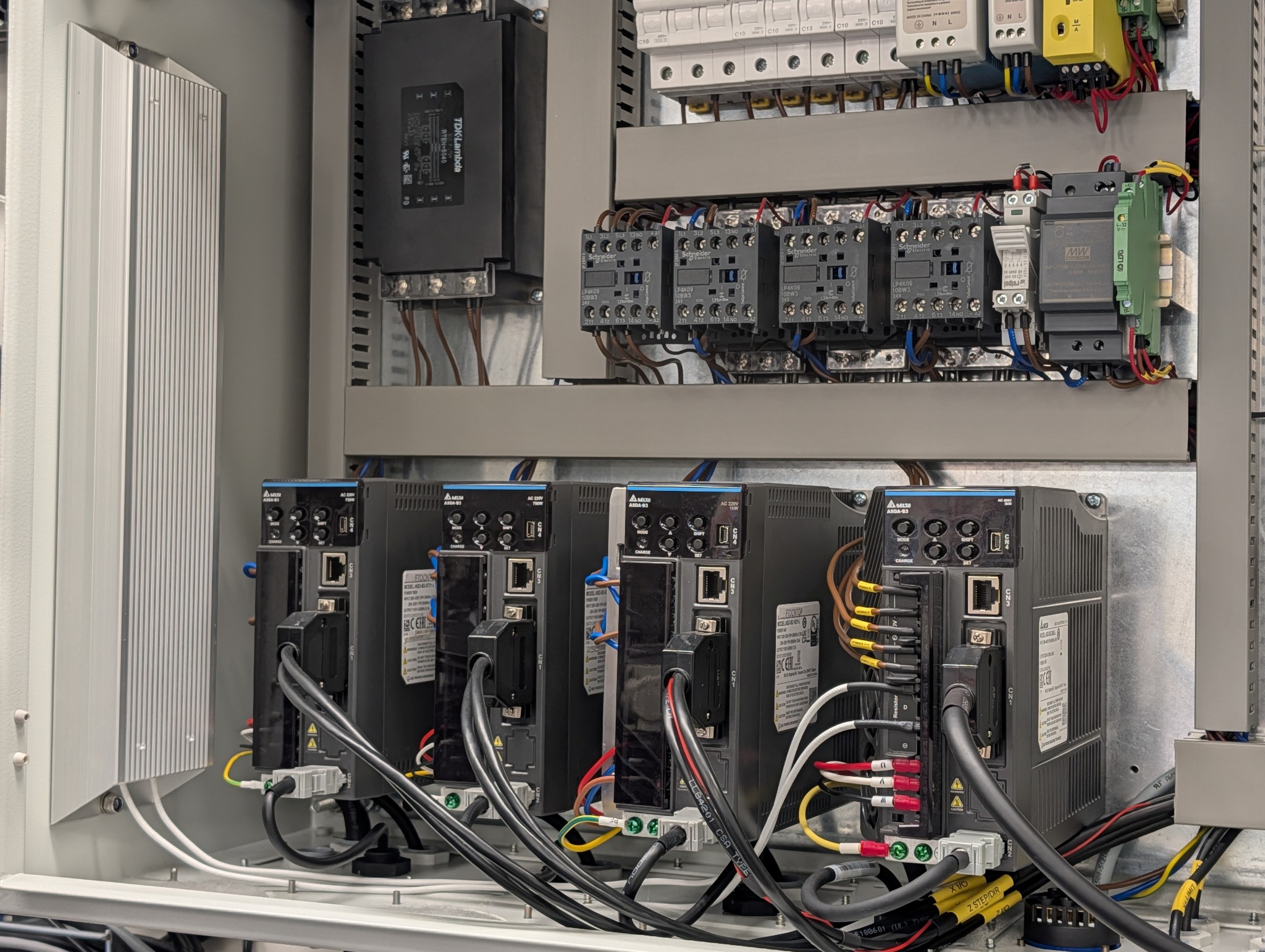

I received the braking resistor yesterday and mounted it on the left side of the cabinet. The cables that came with it were just long enough to reach all the way to the spindle drive.
With the braking resistor installed and the parameters set in the spindle drive the faults when stopping the spindle from high RPM disappeared.

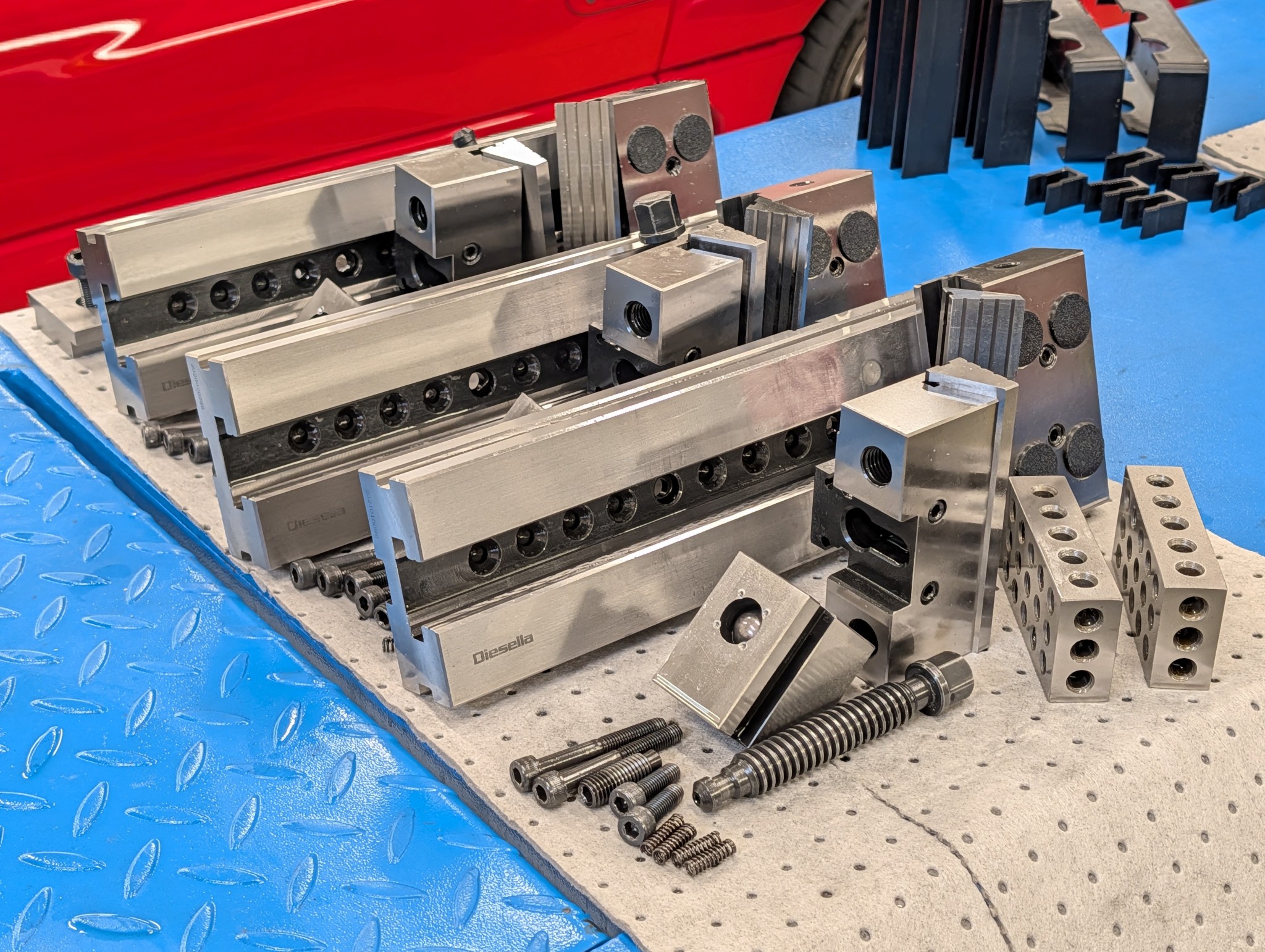

As the machine seemed to be ready for the first test cuts I cleaned the vices in the parts cleaner and installed them.
Getting all three of them trammed in took it's time as usual...

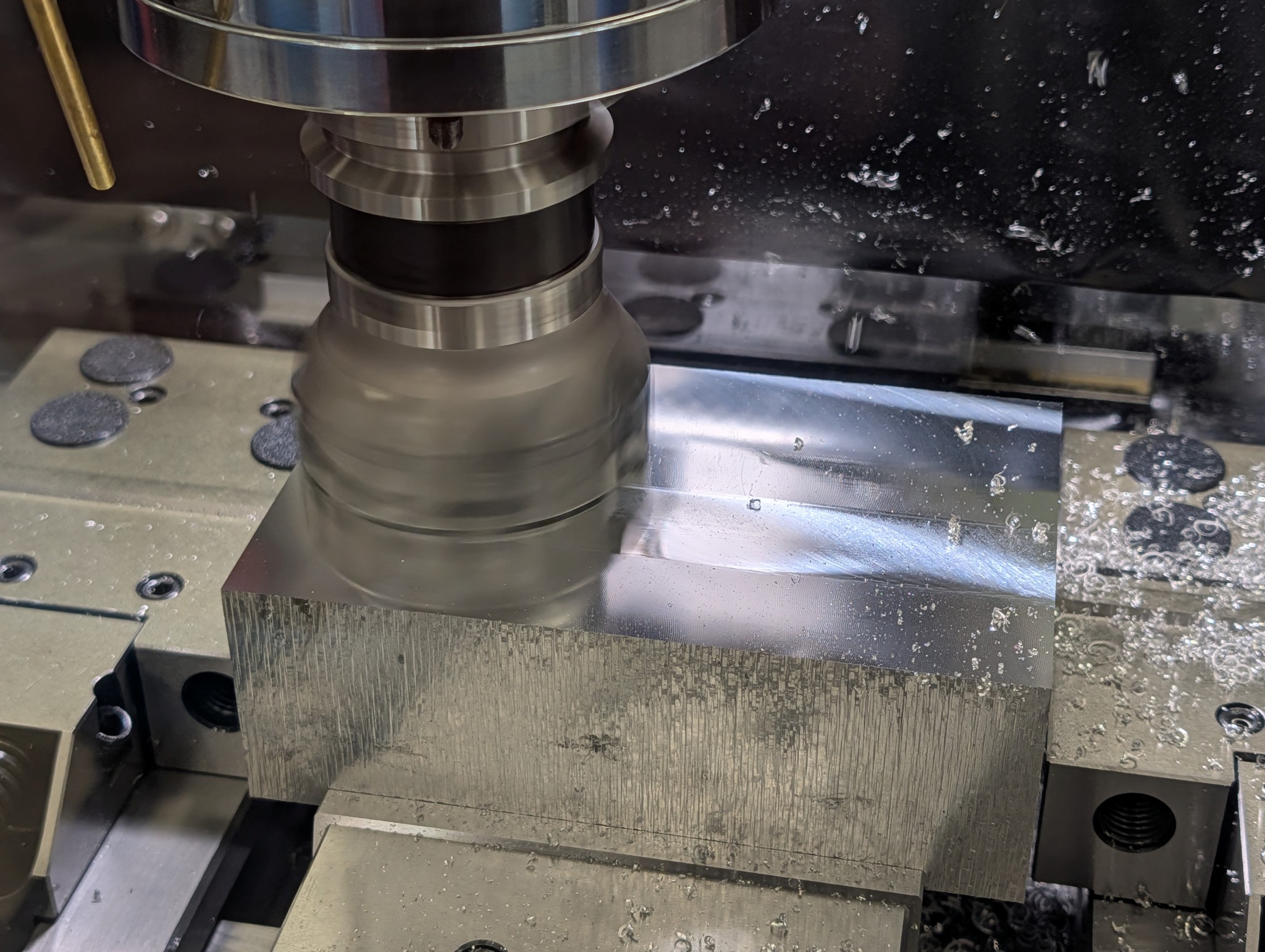

For the first nervous test cuts with the new spindle I used a piece of 7075 aluminum.
I started with an 80 mm face mill and immediately noticed a clear improvement in surface finish which I hadn't expected.
Next I milled the sides with a 16mm DLC coated solid end mill. The resulting finish was something I've never seen on this machine before.
This was just a quick cut with a width of 0,5 mm so this feels very promising. I'll report back when I've milled a few real parts.

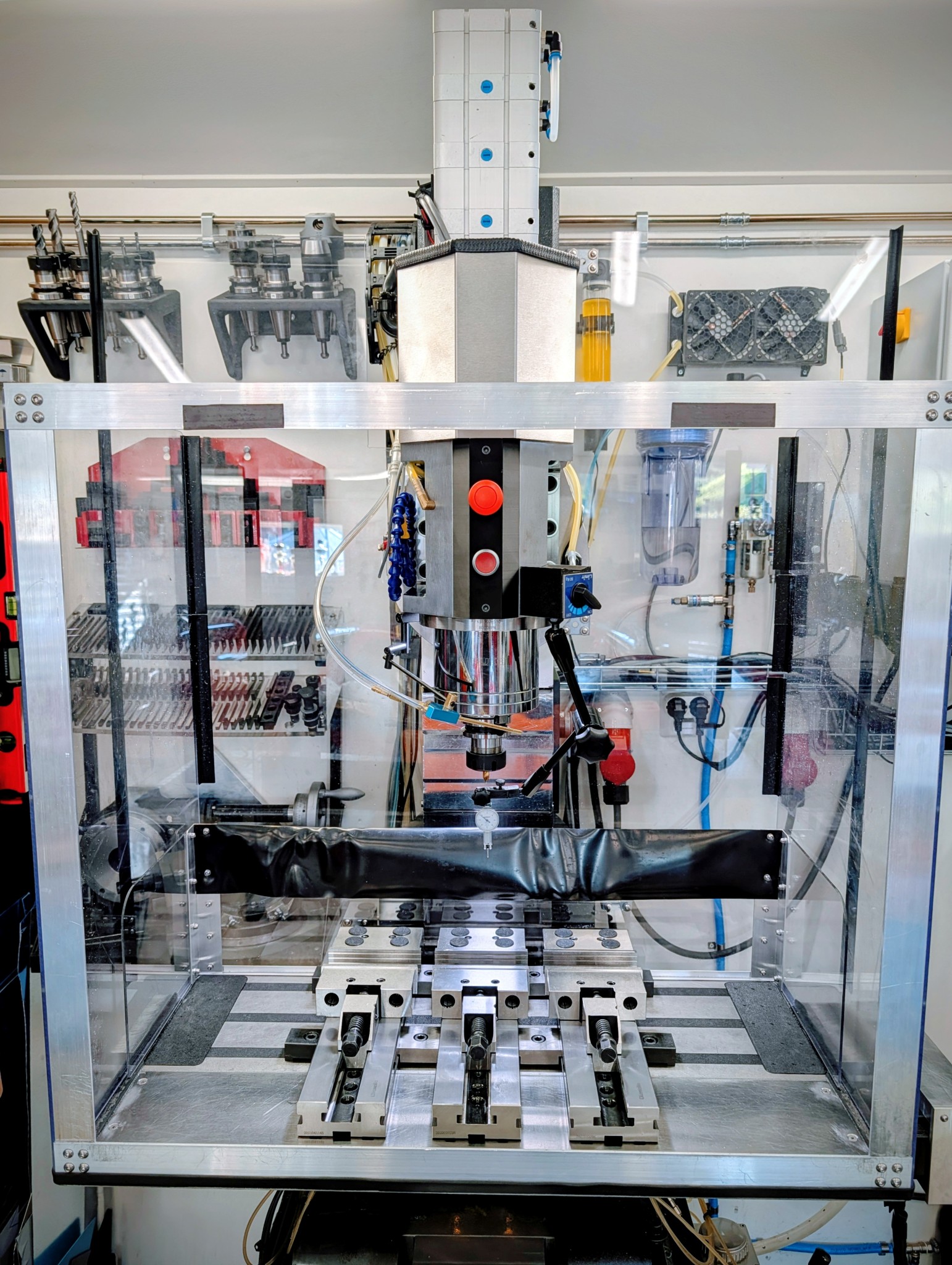

I ran into a new issue however. With higher spindle speeds, higher feed rates and deeper cuts the chips carry much more energy causing them to fly much further. One place they like to fly was into the spindle drive belt so I had to design and order a larger sheet metal cover for the head.
Here it is installed on the machine with a 3D printed extension added to protect the ways.
Also my table based enclosure isn't containing the chips like it used to at slower spindle speeds. Now the chips bounce around inside until they find their way out onto the floor around the machine especially during roughing operations. I probably have to look into building a full enclosure going forward. Preferably one with an integrated box for chip collection in the stand below the machine.
