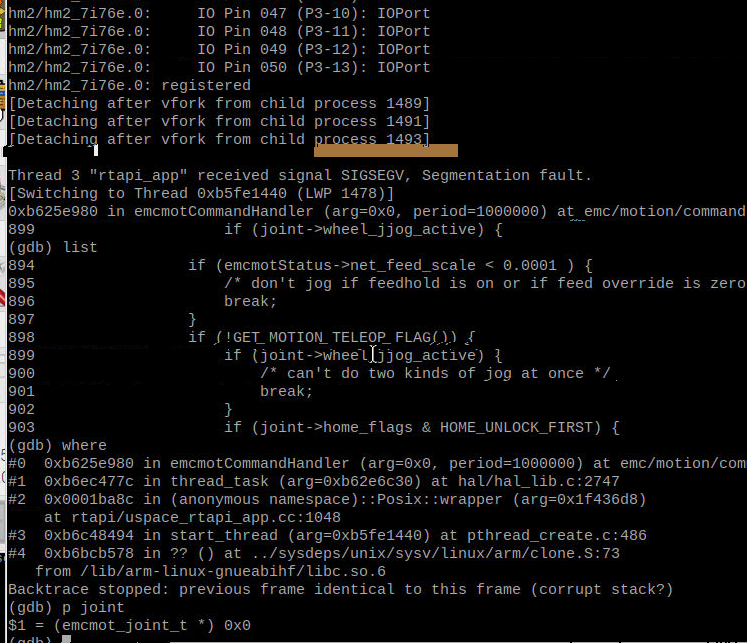

I have come a bit further. I am able to debug rtapi_app, there was a line in the code that told me how to, and it worked. At this point I suspect my ini/hal files. I was using 2.7.something on this lathe. It was all upgraded to 2.9 and I think there is something wrong with the axes and joints. Just my guess based on the error.

Definitely translation 2.7 -> 2.9.
Instead of jogging in Z, I tried to jog in X. Yes, steps are taken! (It works in X!)
Can someone be so kind to check the ini file and the hal file after the translation.
This is a very simple lathe with X and Z axis.
I think the error message I get now is a bit rough. Or it is probably all my fault

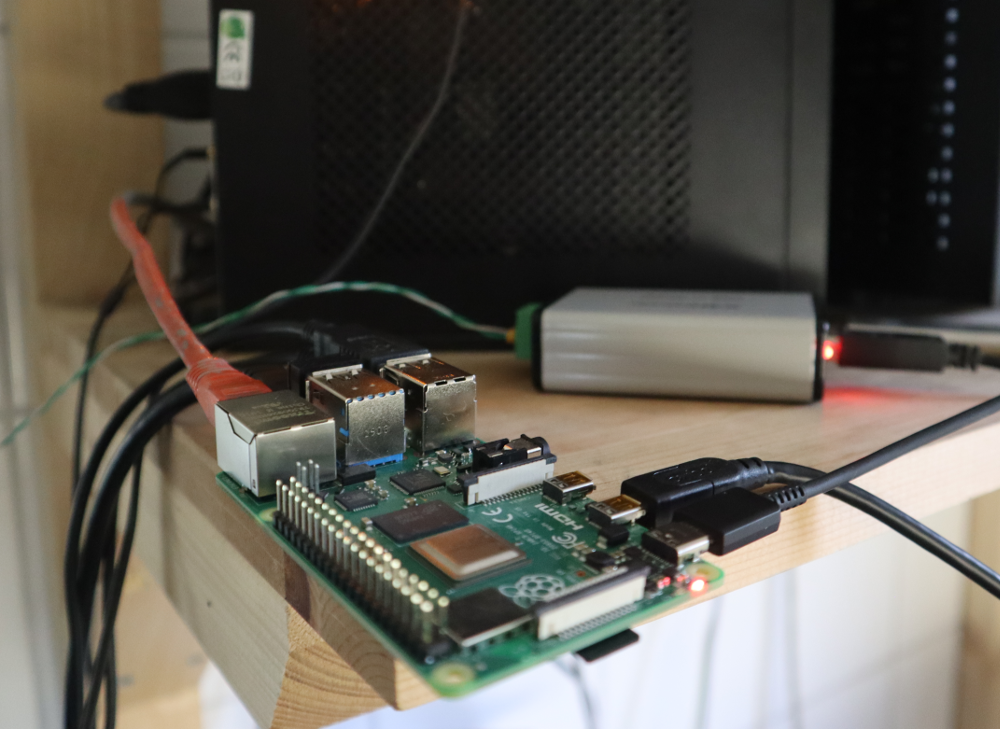

I was going to some real turning with RPi4 and mesa 7i76e. But...
It runs the axis fine, controls the spindle and all that. It does work.
Also feels pretty responsive with the 1920x1080 touch screen. Not bad.
