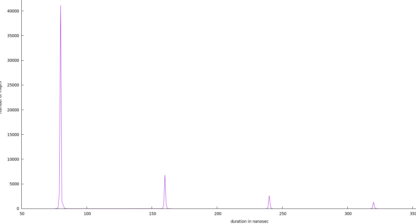

I have done it and now I can do go down to a period of 140.000 in linCNC with
display via vnc.
Inside a "hal-only"-environment, it's possible to drive a stepper with 10kHz
with a step/dir-signal. But I think the timing quallity of the signal will be poor.
lets see
10kHz stepper signal - not as bad as expected. But some deviations in timing....
The above spikes are the durations of the "low" and "high" parts oth the squarewave.
not even so bad.... but if I zoom it:
erste.de/timing-tests.PI4.html

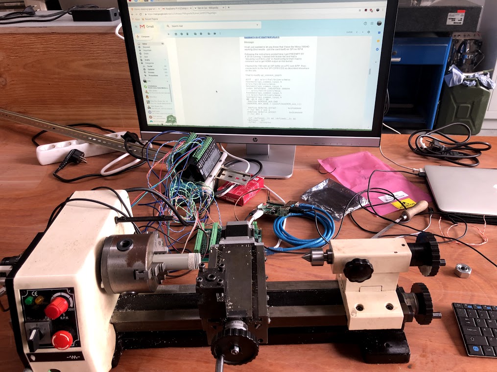

I have been experimenting at the LinuxCNC meetup in Stuttgart with the Pi4.
We converted a C1 lathe to CNC and I have been using the Pi4 Buster / preempt image here:
www.linuxcnc.org/dists/buster/2.8-uspace/
Using a Mesa 7i96 ethernet-connected breakout
I works well, but has some stability issues. This might be due to thermal issues with the Pi, we have no heat-sink or fan.

> does isolcpus=1,2,3 in /boot/config.txt help also for the base tread?
also a nice idea!
now a period of 80.000 ist possible.
analyzing the squarewave is a little bit confusing me:
__--___--____--___
the high-level-timespan is always 80usec (between 78.5 and 81)
thas OK.
but the low-level-timespan differs much more. (beween 160usec an 320usec)
the time-period... thats not nice....
maybe, with a quad-signal instead of step/dir it will be better. but then I need
a quad2stepdir-converter...
an arduino?....
*thinkig*.....

I'm not sure what you are measuring yet. Are you measuring all the duration of all the intervals between pulse edges falling and rising, just rising or just falling or?
