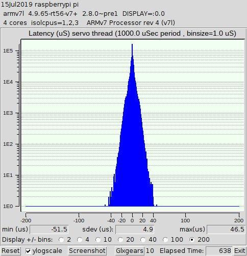

Replied by PCW on topic Raspberry Pi 4
Last edit: 15 Jul 2019 20:54 by PCW.
The following user(s) said Thank You: seuchato, tommylight

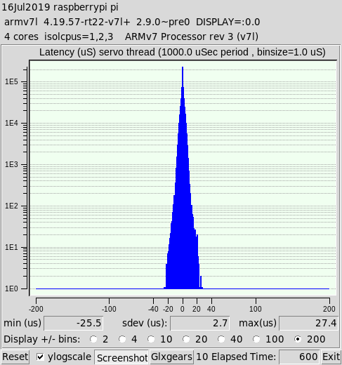

15 Jul 2019 21:22 - 16 Jul 2019 04:13 #139504
by Hakan
Replied by Hakan on topic Raspberry Pi 4
No.
Well now I have. And it made all the difference in the world.
The following is with wlan0 disabled. Leaving wlan0 up and surfing at the same time
has a huge impact on the latency numbers.Surfing brings the max latency numbers
up a factor 5, around +- 100 us.
I can try some more tomorrow, it's getting late here.
Last edit: 16 Jul 2019 04:13 by Hakan. Reason: Better graph and also with/without wlan0
