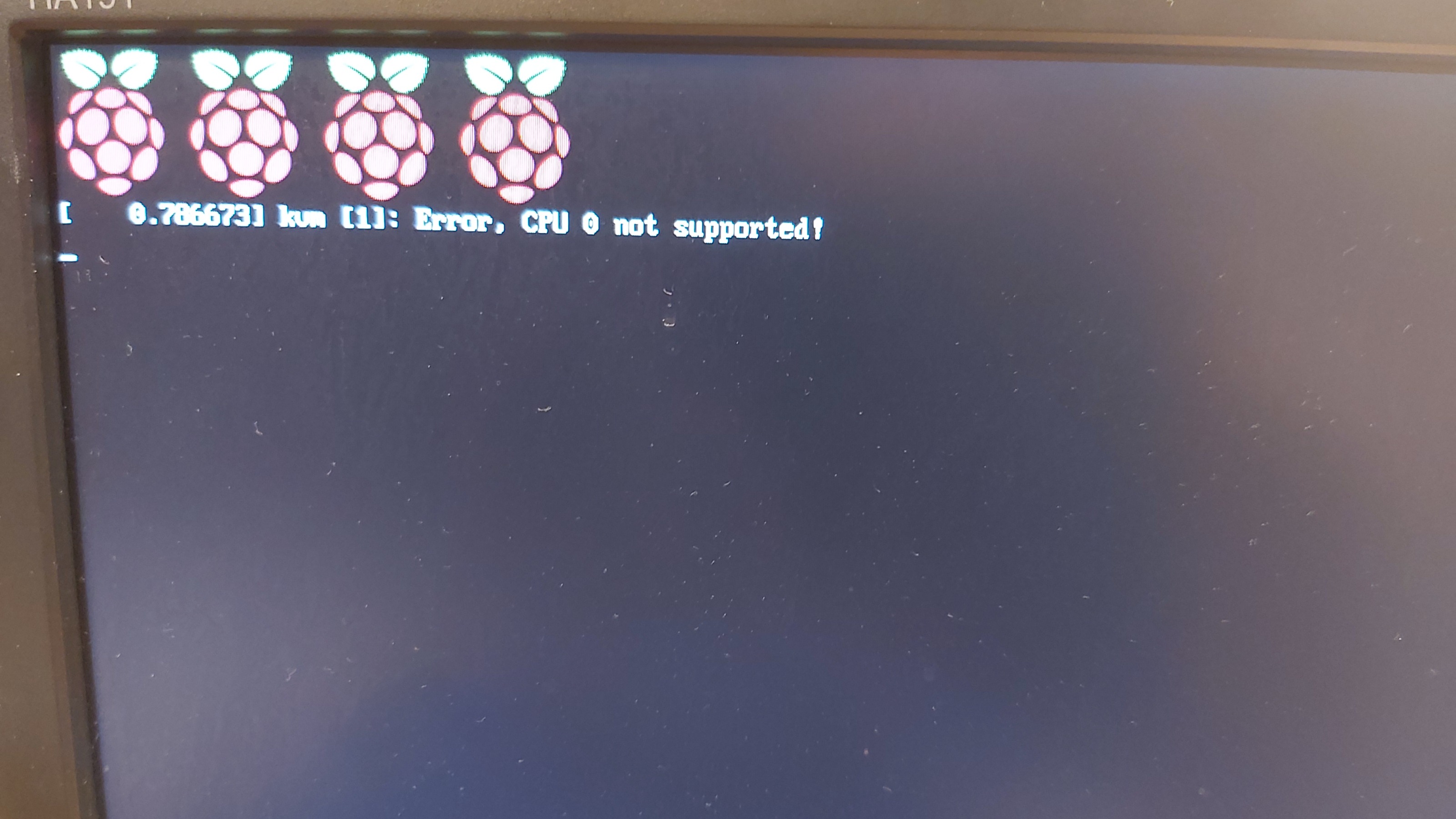

18 Nov 2020 20:25 #189723 by PavelChekov
Replied by PavelChekov on topic Raspberry Pi 4
Hello
I write the image for the RPI4 from the LinuxCNC Homepage to the card.
When I Start the rpi I get this error: => see picture
Then it automatically restart an start normal
What is the problem ?
18 Nov 2020 20:55 #189728 by Bari
Replied by Bari on topic Raspberry Pi 4
it means that your CPU doesn't support hardware virtualization
help.ubuntu.com/community/KVM/Installation
Not a LCNC problem. Ask the Rpi4 Linux devs.
github.com/raspberrypi/linux/issues/2299
18 Nov 2020 22:24 - 18 Nov 2020 22:30 #189737 by PavelChekov
Do they use different CPU for the rpi4 ?
Or does all user with an rpi4 have this problem (with this Image from the LCNC HP) ?

18 Nov 2020 22:55 #189738 by PCW
Replied by PCW on topic Raspberry Pi 4
I think you just need to disable KVM (or use a kernel that has it disabled)
The warning is harmless
