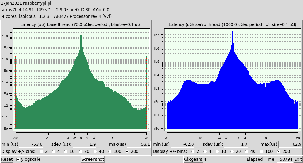

18 Jan 2021 05:25 - 18 Jan 2021 05:35 #195750
by tjtr33
Replied by tjtr33 on topic Raspberry Pi 4
re 2000uS servo thread
I have success with soft stepper 75uS base 1000uS servo
but latency is too bad with servo 2000, so
my best effort is 75uSbase 1000 servo. My 1.5mm screw and 200 setp/rev
motors gets me 50 steps/sec 3meters per min without doublestep.
I am working on hal_pi_gpio to get inverted pins and reset pins.
That woul allow my RPi3 6meters /min software stepping.
Its reliable, I have been running a 3Dchips modified to loop 100 times. Its run many times now over 3 days, no UXRTdelays.
tomp
