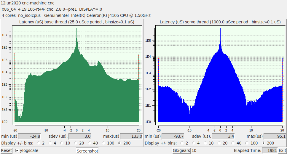

12 Jun 2020 14:01 #171290
by Clive S
Its finally arrived but still waiting for the case. It took 6 days to arrive from China. I came with Win 10 enterprise I had forgot about that.
I stuck a SSD with Mr Beagle's mint on it, change the bios boot and hey presto.
Replied by Clive S on topic Computer to run Linux CNC
Yes I have had to use that for a neighbour and put win 10 on it. It runs well with that.
I have just ordered one of these. www.seeedstudio.com/ODYSSEY-X86J4105864-p-4447.html lets see how it performs !
Damn you beat me to it. I posted about that little beastie the other day. Interested in to see how it goes.
I’ll have to pull out my collect of MB cos I remember getting some good results with some older athalon setups.

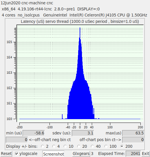

12 Jun 2020 14:32 #171298
Replied by tommylight on topic Computer to run Linux CNC
Use this to test latency as it looks to have gone out of the visible area:
latency-histogram --nobase --sbinsize 1000 --show

12 Jun 2020 17:11 #171330
by Clive S
This any better;-
This any better;-

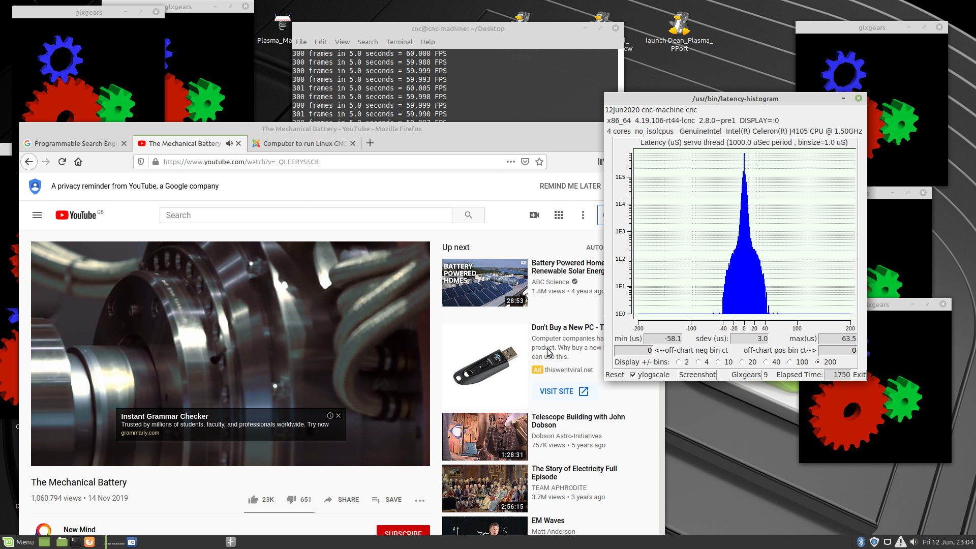

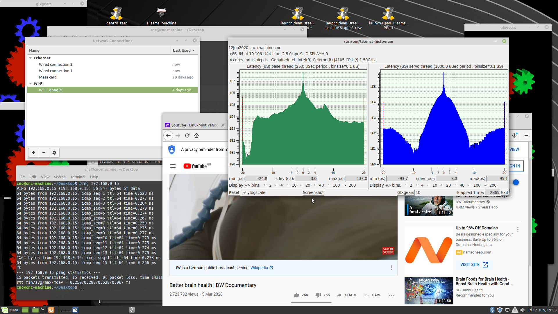

- Online
- Posts: 22049
- Thank you received: 7509
12 Jun 2020 17:22 #171333
That is much, much better.
Plug a 7i96 or 7i76E or 7i92 to it, lets see how that goes.
I leave Linuxcnc running with a big gcode file for two full days on to check if it drops the connection and usually while i am near i have to watch some youtube or read or copy something, just to live on the edge .... of loosing a connection !
