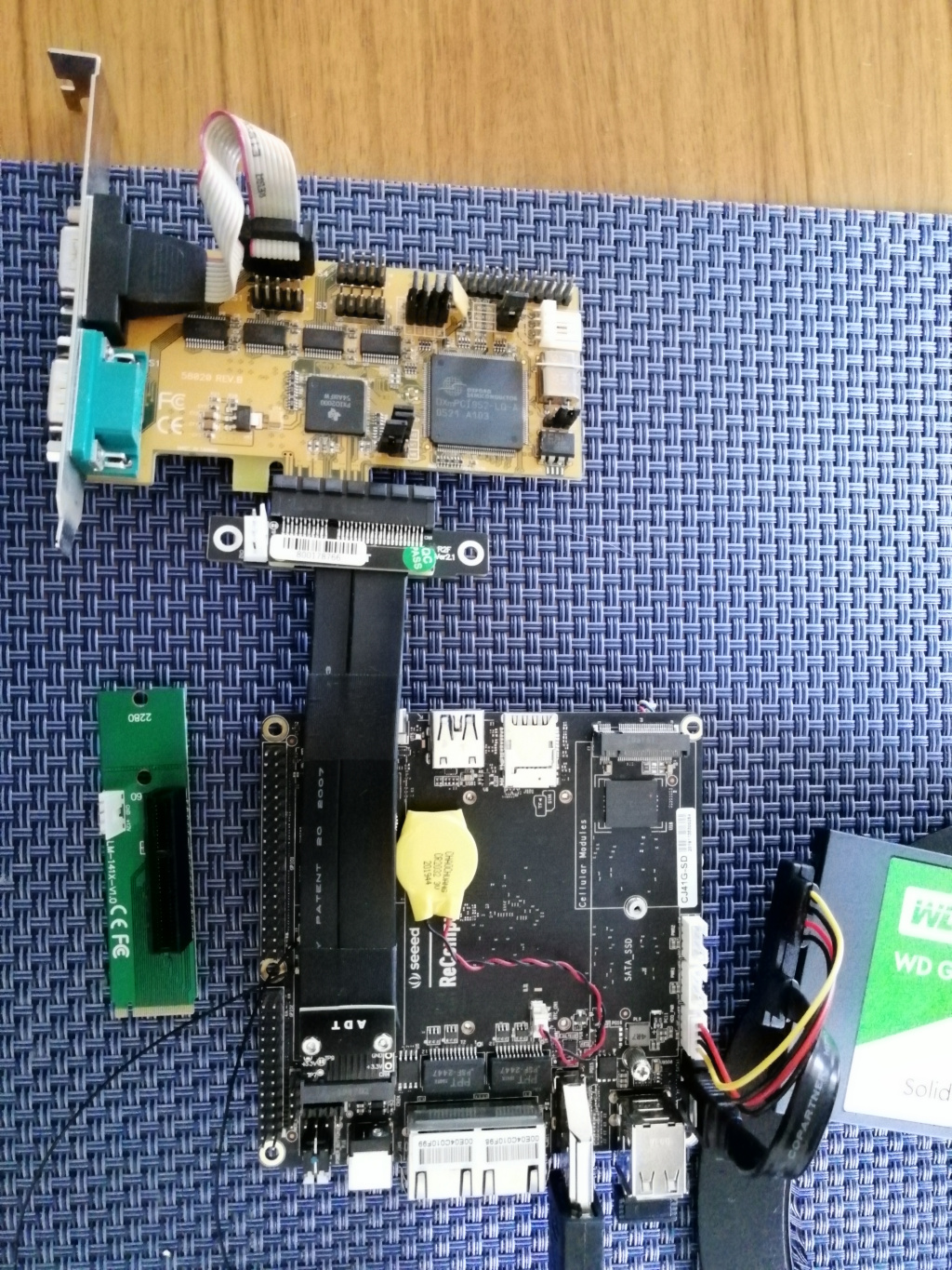

17 Jun 2020 14:40 #171923
by Mike_Eitel
Replied by Mike_Eitel on topic Computer to run Linux CNC
Hi
Just found some time to play with it. And I plugged one of the chepo M2 to PCIe adapters in. Seems to work, as at least the W10 saw something in the device manager. Didn't bother to find the drivers
Now I want to test lcnc. Witch of the momentary iso's for this seeedstudio gadget did you use?
Mike
Mike

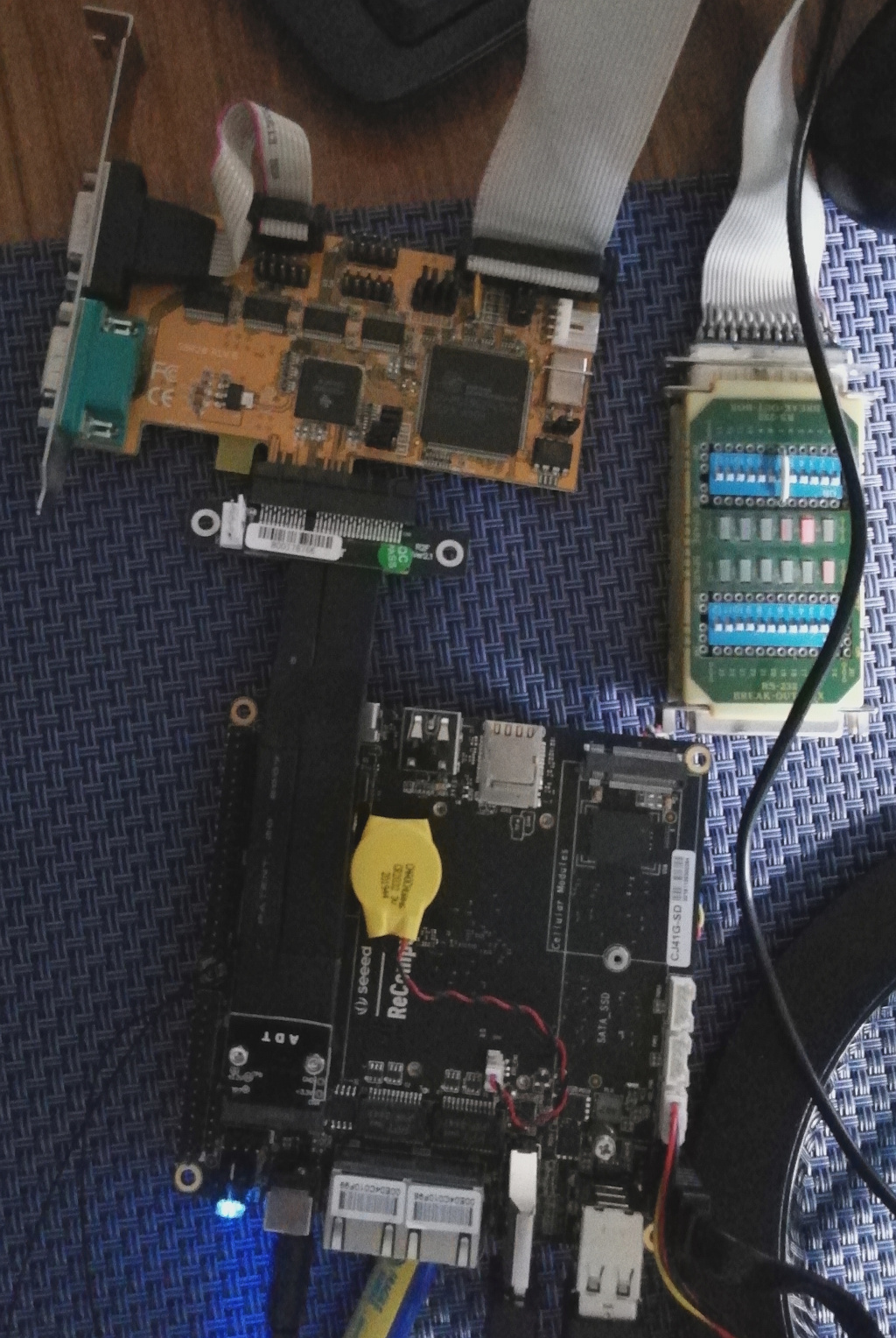

20 Jun 2020 13:58 #172178
by Mike_Eitel
I just testet shortly the combination of that m2 to pcie adapter with an old multiport 1p4s card. It is recognized (cfg=0) and seems to work fine. Now i only have to screw a bit with the parameters to minimize latency. And learn a bit more how to use the buildin arduino for interface..
This little beast seems to be very flexible as brain of any cnc.
And BIG THX to Beaglbrainz. Your iso is very well made.!!!
Mike
Mike

- Mike_Eitel
- Posts: 1051
- Thank you received: 183
20 Jun 2020 15:50 #172187
by Mike_Eitel
As adapter i use
www.aliexpress.com/item/4000805669327.html
Also working but in my eyes mecanicaly not so good
Standing as in every pc www.aliexpress.com/item/32887322087.html
Quite bulky www.aliexpress.com/item/32855385914.html
And the board itself
www.seeedstudio.com/ODYSSEY-X86J4105864-p-4447.html
