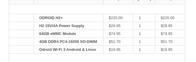

I'm in Australia so in the AUD it looked like
jiffyshop.com.au/SBC/
So now I wait until the next batch arrives....
Replied by rodw on topic Computer to run Linux CNC
You didn't order the extras from Ameridroid did you? You can get NVME's, a power supply and ram cheaper on amazon . Really not much more than the seeed board. My last order looked like this
Ameridroid:
Odroid H2......$111 (price got raised to $134 when it was upgraded)
Amazon:
8gb DDR4.....$34
256gb NVME.....$36
15v power supply...$15
That's $219 now not including shipping. You can't really do better for less as far as new stuff is concerned. You don't actually need a fan, the heatsink is massive but I would suggest replacing the stock thermal compound with some arctic MX4 or other good paste, it makes a big difference
