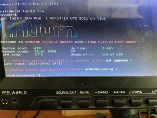

- Cncninja
- Posts: 109
04 Aug 2021 14:21 #216917
by Cncninja
Replied by Cncninja on topic LinuxCNC + Orange Pi (allwincnc)
- Dolence
