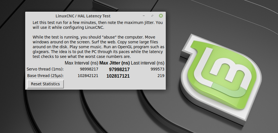

02 Jan 2021 09:38 #193815 by MNJoe
Thanks for the quick reply - I have a PCIe Parallel port coming just trying to get my arms around this before its here. I'll give a shot at just disabling the other cores once to get a perspective then track down how to edit the GRUB file for refinement. I did add the values for the full script run with the Video Card installed as well above.

02 Jan 2021 09:44 #193816 by seuchato
I delete everything of your post that I would not comment:
Dell OptiPlex 9010 i5-3570 CPU 3.40GHz

You play with two different os's: buster and mint. That is OK, however, try to be consistent regarding kernels and desktops if you want a comparison that may lead to a conclusion. (Remark: I think, Mint is also available in version 19.3.) Kernels do play a major role for latency, desktops too. Further play with bios and "GRUB_CMDLINE_LINUX_DEFAULT" (see post above for hints).
What is a good range?
I'd say you got it already, as long as there are no real time delay messages. You might be able to bring these values down, again, see post above.
Even with Buster my numbers seem quite a bit higher relatively speaking than other posts here. I am using the onboard GPU, how much of an impact would that be?
We want low latency, yes. But this is not a race to be won. It is all about finding a reasonable good value to run / control your CNC machine with. Again see my post above.
If you play, play one option, test, note the values, then go to next option.

06 Apr 2021 17:44 #205152 by stefan63
Is this the worst result ever?
Planing to test my Thinkpad T420s with a MESA ethernet card is it worth it?
  • tommylight
  • tommylight's Avatar Topic Author
  • Away
  • Moderator
  • Moderator
06 Apr 2021 18:16 #205162 by tommylight
Pretty much the worst result ! :)
T420S is unusable for machine control, i still have one. It will drop the link to Mesa board in 1 to 30 seconds always on batteries, much longer on AC power, but never reliable.
At any rate the latency is much better than what you posted, but probably using the wrong kernel.
What does
uname -a
in a terminal say?
