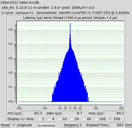

The test below is without isolcpus; adding isolcpus=1 seems to reduce the latency to about 80 µs.

27 Jan 2022 23:47 - 27 Jan 2022 23:48 #233327 by arvidb
The same system with isolcpus=1 (and noirqbalance, but the latter doesn't seem to make a noticeable difference). The "standard" vimeo video was running, as well as a YouTube video.
