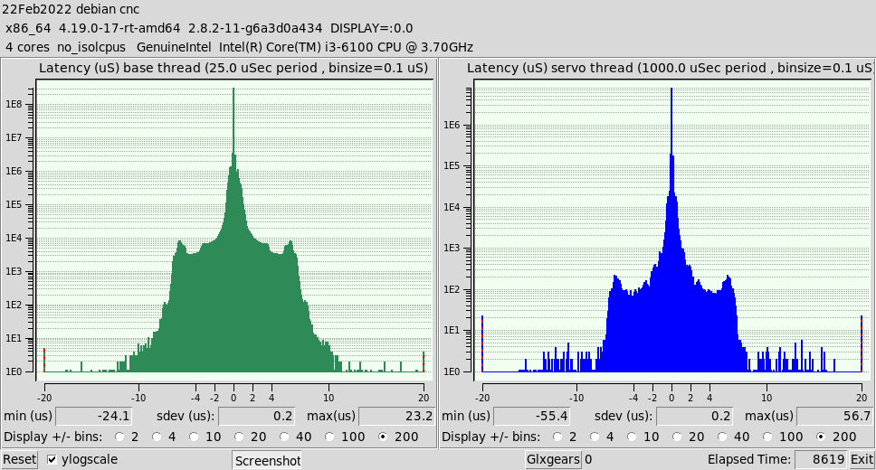

22 Feb 2022 23:19 #235565
by Bagels
Replied by Bagels on topic Results of latency test, list of computers tested for use with LinuxCNC
Gigabyte Z370 chipset, H270M-D3H
Intel i3 Skylake 6100 (no isolcpus)
SATA SSD
8GB RAM DDR4 - 2x4 2133MT/s
GeForce GTX 1060
[img]undefined[/img][img]undefined[/img] imgur.com/V7J2Lif imgur.com/V7J2LifShould note that this mirrors a separate earlier test I did where I was loading it more heavily. Seems pretty consistent.
SATA SSD
GeForce GTX 1060

23 Feb 2022 10:52 #235588
Replied by tommylight on topic Results of latency test, list of computers tested for use with LinuxCNC
Use :The screenshot shows excursions outside the visible area.
latency-histogram --show
The following user(s) said Thank You: seuchato

23 Feb 2022 11:40 - 23 Feb 2022 11:42 #235593
by seuchato
Replied by seuchato on topic Results of latency test, list of computers tested for use with LinuxCNC
Tommy
Agreed, but still Bagels' values are not too far off:
base -24.1/-20 to +23.2/+20
servo -54/-20 to +56/+20
=> values look promising/good to me
greez
chris
remark: It is not clear, how the machine was loaded
greez
chris
