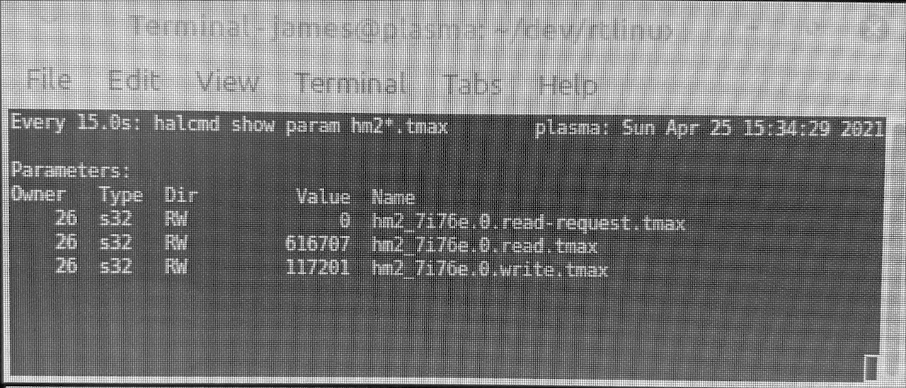

Short cross post on results for HP T610 Thin Client.
Also did a stability/performacne test on the ethernet connection by running a looped version of axis.ngc against a connected 7i76e for 3 hrs. So signals being sent to the mesa card for a solid 3 hrs. No dropped packets and tmax per below. Core speed is 1650MHz :
Refer to this post on setup details for HP T610

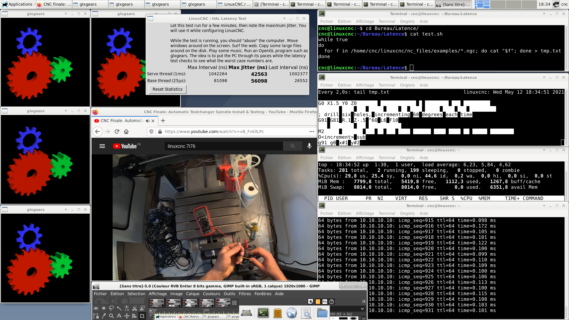

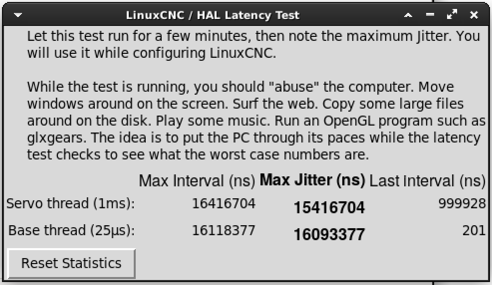

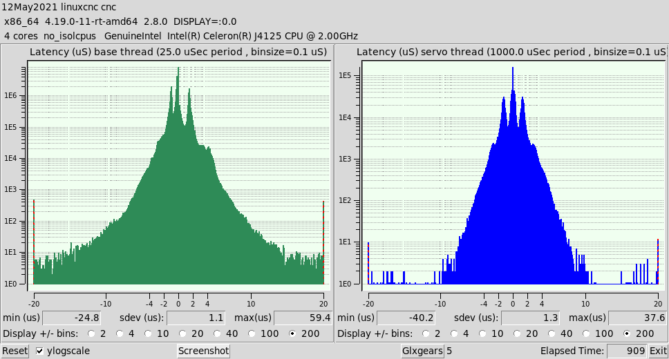

Minis forum GK41(Intel Celeron J4125)
Was looking for a cheap solution: Win10, 8GoRam, dual screen, dual Ethernet.
Bios settings are limited.
Hope this is acceptable, I don't have enough linuxcnc experience
Running the tests for a quarter of an hour:
last latency data is as follows:.
1130 secs servo min: -88.200 uS max: 95.500 uS sdev: 3.100 uS
1131 secs servo min: -88.200 uS max: 95.500 uS sdev: 3.100 uS
Last edit: 12 May 2021 18:19 by Goulven. Reason: Add reference of PC

Definitely OK if using an external step generator. Probably OK for software step generation unless you need very high step rates.

I have a Mesa 7i76e card, I am monitoring the step / dir signals with an oscilloscope(I don't have any drivers yet). It seems correct.

If you have a 7i76 / 7i76E then you can stop worrying about latency, it could be 10x your worst case and still be fine.
