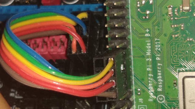

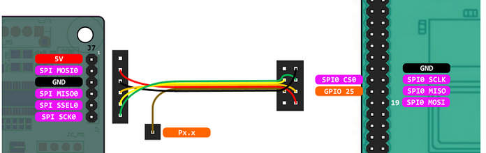

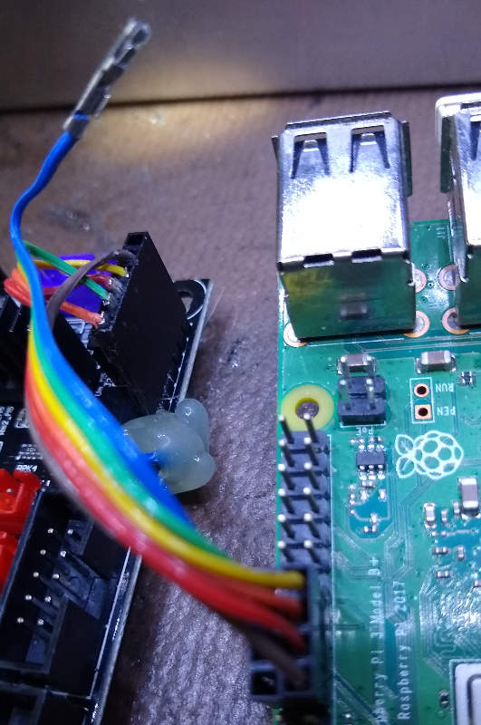

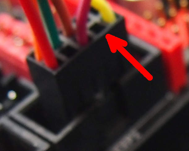

Hello,
Is there a difference between the diagram for skrv1.3 spi cable and your cable foto?
The disgram on readthedocs show a wire from what is labeled "p1.31" ( pin 4 of EXP2)
but your foto shows that socket empty., and instead a wire is connected to 3.25. ( pin 6 of EXP2)
Do I correctly see p1.31 is empty in your foto?
I am not geting the expected results and want to try correctly.
I just tried with what i see in the foto and still get bad spi ffffffff hitting F1 estop repreatedly
I then moved the 'reset' wire to the p1.31 and got same
Then I tried external 12V ps for skrv1.3
using screw terminal '12/14' and GND, moved jumper from 5V to INT.
Result is same ( spi cable is from p1.35 on skr to reset gpio25 on rpi 3B+)
also tried with reset line from p3.25 to rpi gpio25, same ffffffff
it does not work as expected
but i DO need to resolve the diagram vs foto for later
the pin in question really is p1.31 and really is on pin2 of EXP2.
(not on pin 6 ). This is from the SKR V1.3 config.txt.
My skr v1.3 is no longer a candidate for Remora.
I have recieved an MKS v1.3 and will make an SPI cable for that.
thanks,
tomp

Tomp, you only need the 4 SPI connections and ground for SPI to work. If you have any questions about your wiring, Look at how he labeled the SPI signals on the EXP2 connector and then find any rPi pinout and look for the pins with the same SPI name.

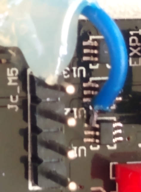

Hello,I have a new MKS v1.3 and want to prepare it for use.
I will solder the jumper as described
but the cable information is difficult for me to follow.
The wiring diagram shows the RESET wire
from RPi GPIO25
to Px.xI
I think this Px.x is used for RESET becasue that is it's purpose for it in SKR v1.3
@Doogie, you have used the MKS v1.3,
so please tell me where Px.x connects.
thanks TomP
