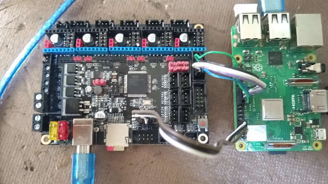

Out of curiosity, how long are your SPI wires?
SPI signals are high speed and they really belong in a transmission line cable and not just loose wires. The ideal SPI cable will have every other wire in a ribbon cable grounded and the signal wires carried in the other wires. So a 10 wire ribbon cable and even that cable needs to be ~200mm long at best and probably 120-140mm better.

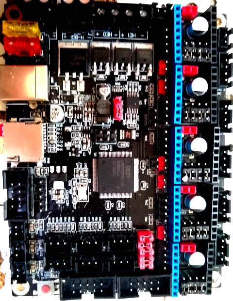

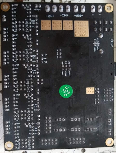

17 Jun 2021 06:09 - 17 Jun 2021 16:56 #212256 by tjtr33
Hi Doogie, Thanks for the suggestions
""" Find the manufacturer of your board and find their board layout """
Since my board has no manufacturer marking, no code numbers, only the stock QC round label,
i cannot get manuals or schematics. Maybe i can trace from the cpu to the port pin
but thats unlikely given the steadiness of my hands. See attached photos.
"""you NEED a drawing of YOUR BOARD"""
that wont happen unles I draw it. The board, purchased in Thailand, from unknown Chinese supplier,
has no papers, it's an undocumented item. The seller does not recall where he got it. See ''inscrutable oriental"
"""Guessing is not good engineering or troubleshooting practice so do as little guessing as possible. """
Sometime a guess is all you got ;-)
I can try to ohm out from LPC1768 to jacks/sockets.
I did not know those pins directly connected to sockets, that sounds like a dangerous design, but I will try.
I have to see the schematics from the githubs to begin the trace at the cpu.
"""What? you have not installed stepper drivers?"""
No, its not a good idea to hook up hardware in this case. And an open loop stepper system should not care.
And not care if 3 axis versus 5.
"""SPI signals are high speed and they really belong in a transmission line cable and not just loose wires. The ideal SPI cable will have every other wire in a ribbon cable grounded and the signal wires carried in the other wires. So a 10 wire ribbon cable and even that cable needs to be ~200mm long at best and probably 120-140mm better.
see photo, about 60mm long, not interleaved with grounds (yet, may do that but pin tracing comes first )
dang i wish i had a setup with pogo pins.
btw: i ordered a BTT SKR V1.4 Turbo 2 days ago, should come soon, seller was here in Thailand.
AFAICT its the real thing. ( see "inscrutable oriental" )
Thats not slander, its just the real uncertainty of answers to what see to be simple questions.
Q "Is this a real Big Tree Tech SKR V1.4 turbo?"
A: " Yes we have very good product"
aaarrrgh!
Thanks tomp
update:
i wrung out all the pins used for SPI. They are correct.
I used the top and bottom pdfs to verify layout of all componenets
then used the schematic and sewing needles to wring out
P1.32 MOSI0 MISO0 SSEL) SCK0 GND
so it is wired like the remora docs.
I used
raw.githubusercontent.com/bigtreetech/BI...are/SKR-V1.3-SCH.pdf
thanks again tomp

19 Jun 2021 05:04 #212386 by Doogie
good stuff @tjtr33, sounds like it is ready to work if you can get the noise off the SPI connection. Since you are not using a ribbon cable but are using discrete wires, try moving them away from each other. ie spread them out bit so there's little chance of cross-talk across wires.
@scotta he posted 3 pics of the board and in the first one it also shows the rPi and the SPI connections.
