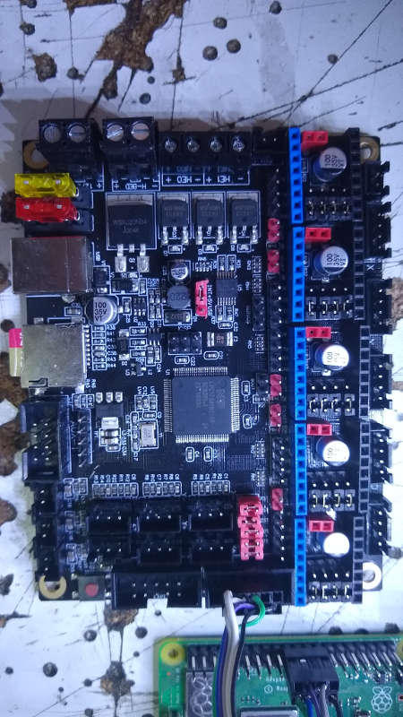

Make sure your Big Tree Tech SKR says BIG TREE on the silk screen next to the 6 3pin header array. I made sure mine was SKR v1,3 with LPC1768 but missed that the ad did not say BTT or Big Tree Tech. And it doesnt work, F1 gets me Bad Payload FFFFFFFF. The cable ohms out and the files are as prescribed.
. arrrgh!
I'll hook up the serial port before burying it.
re: 'cursor type file"
my firmware.bin got renamed FIRMWARE.CUR
that may mean 'current'
is that what you mean?
I tried with no drivers ( pololu style stepper drivers) installed.
And I set the jumper to 5V and USB, and used a cable from RPi3B+
to SKR. The P/S was official white with micro usb connector.
Is that workable to test that the remora comp is working?
tomp
. arrrgh!
tomp

15 Jun 2021 12:43 - 15 Jun 2021 12:44 #212134
by Aaroncnc
Replied by Aaroncnc on topic Remora - Rpi Software Stepping Using External Microcontroller via SPI
I have not tried on a RPI3 only 4.
did you enable SPI?
www.raspberrypi-spy.co.uk/2014/08/enabli...on-the-raspberry-pi/
I would setup serial and double and triple check your wiring.
Also going to try and play with the new PWM stuff and see how it works.
did you enable SPI?
Last edit: 15 Jun 2021 12:44 by Aaroncnc.

15 Jun 2021 14:51 #212140
by Doogie
Replied by Doogie on topic Remora - Rpi Software Stepping Using External Microcontroller via SPI
They should have a pinout layout just like you'll find for the BT SKR v1.4 and then you just need to see that the signal/pin numbers are the same as the official BT SKR v1.4 and if they are it should work. Sames goes for the v1.3 although I'm not sure that's been tested. The MKS Sbase v1.3 is the only "v1.3" I've verified works.
If the pin numbers are different then it's still possible it'd work but you might need to build the firmware from source and adjust pin numbers accordingly.
