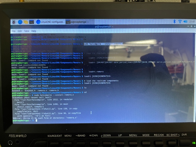

When I get to the
loadrt [KINS]KINEMATICS.... I get a Bash: loadrt: command not found, the hal compile worked just fine.

31 May 2021 23:46 #210849
by scotta
Can you post your hal file. Something in the loadrt line not happy. Is the kins configured in the ini?
Replied by scotta on topic Remora - Rpi Software Stepping Using External Microcontroller via SPI
When I get to the

31 May 2021 23:52 #210851
by scotta
You need hal running to be able to do command line loadrt. If remora is installed you should be able to launch the sample config from linuxcnc.

31 May 2021 23:54 #210852
by Cncninja
Replied by Cncninja on topic Remora - Rpi Software Stepping Using External Microcontroller via SPI
I just followed the document, it did not say anything about configuring a kins in the ini or hal file. do i need to do this?
- scotta
- Posts: 959
- Thank you received: 489
31 May 2021 23:58 #210854
by scotta
This is why it's great to have people try to follow the docs. You are correct. There is no reference of copying the linuxcnc configuration into the config directory.
In the repo there are sample configs.
Remora/LinuxCNC/ConfigSamples/
Copy one of these into the Linuxcnc config directory and then launch it with linuxcnc.

01 Jun 2021 00:01 #210855
by scotta
The remora-xyz is the simplest to get running.

01 Jun 2021 00:14 #210856
by Cncninja
Yep got it loaded, do i still now need to open a terminal with it running and load loadrt [KINS]KINEMATICS and so on?
