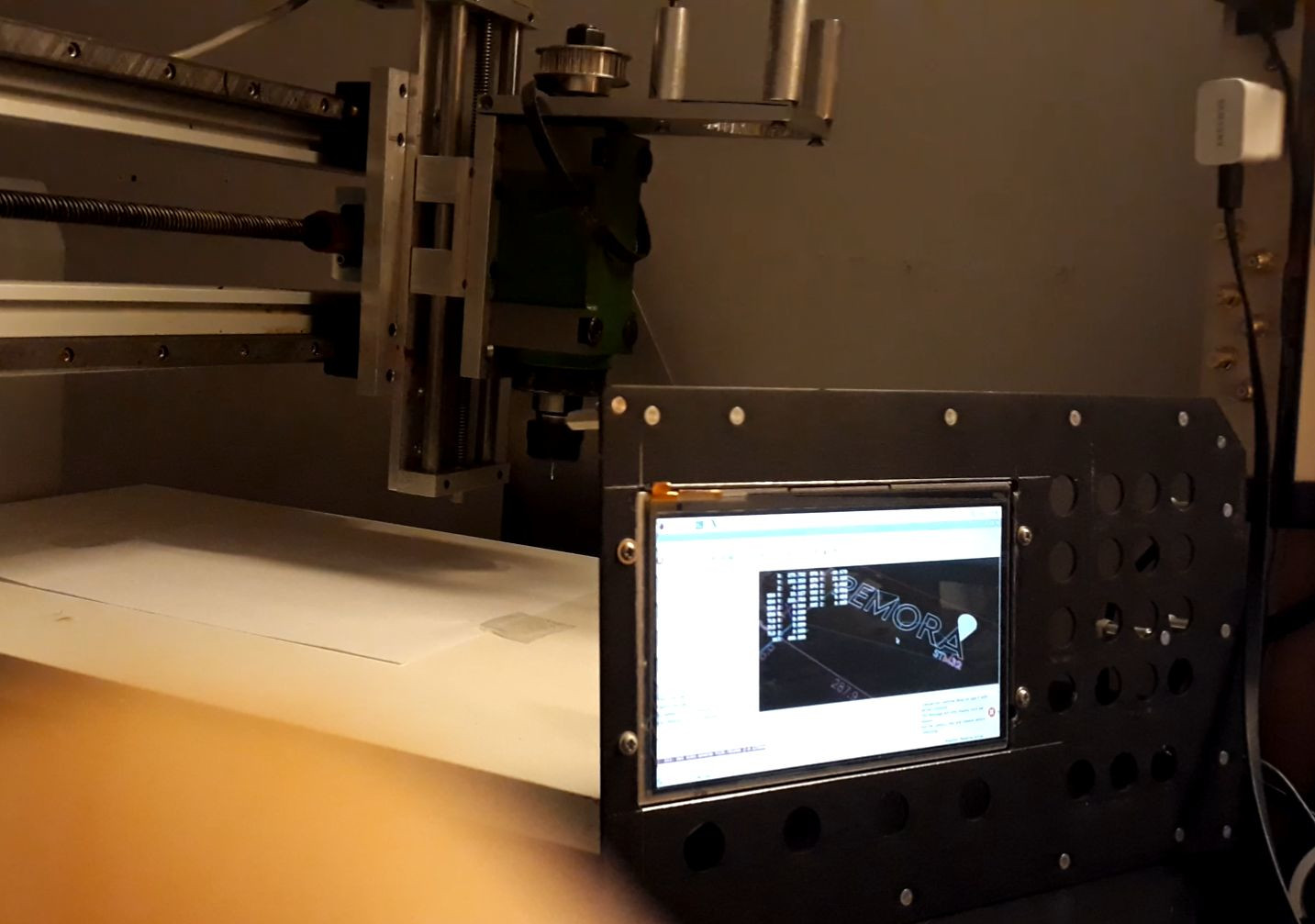

Tomorrow I'll hookup my contraption to my unfinished router without a spindle but atleast I'll have all 3 axis moving.
I'm just hoping Rpi4 3.3v is good enough to drive my TB6600 through an LPT cable.
Replied by mhel on topic Remora - Rpi Software Stepping Using External Microcontroller via SPI
Ah ok. funny, I have cloned so many 3d printing related repos, but I've not looked at the hardwares.These 3D printer controller boards come with a bootloader already flashed. It's a case of knowing the start address that the bootloader will lump to and then have the linker set up accordingly.

What's the possibility of having a 'stepconf' for Remora?The ini file seems like an art-form when it comes to acceleration/velocitysettings. My setup is badly tuned, couple that with bad specs on my self-built machine. But I do have motion on all axis and very responsive.I was hoping I coud post a vid of it plotting, but Inkscape generated gcode has huge values in inches, the only thing changed when switching unit was the G20/G21 the rest of the code still uses values in the hundreds of unit.This is the beginning of my stand alone controller

- mhel
- Posts: 47
- Thank you received: 6
21 Jul 2021 13:11 #215493
by mhel
I hit a few snags.
1. My neighbour doesn't understand my obsession with this
2. I think I killed my X axis driver.
I finally made a crappy vid Aircut ( streamable.com/5yszzq )
Warning it's headache inducing, bandwidth consuming.
I think it's not bad for a bent X axis leadscrew with a .5" pitch, atleast I think I have the scale correct.
In any case it's just a proof that the controller works, pretty stable too.
Oh and this jscut.org/ is a good start for a newbie it imports svg from inkscape .
@Scott I bump the PRU_BASEFREQ to 200kHz just to see what happens, the video is the result.
But after re-run for a couple of times the x axis driver is dead. I just realized that there's no configurable option to
change the step pulse width. The TB6600 I'm using apparently has a minimum pulse of 5 uSec probably more.
