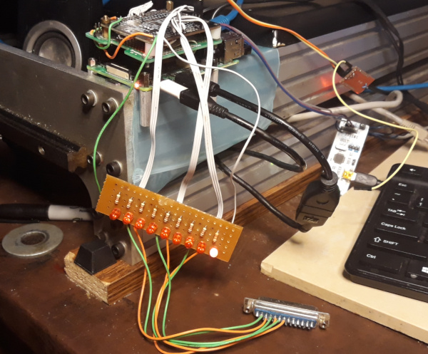

I can't really do much with my setup yet.
Replied by mhel on topic Remora - Rpi Software Stepping Using External Microcontroller via SPI
Do you have the hardware already?well let's do it, what do you have so far and where can i add to it?
