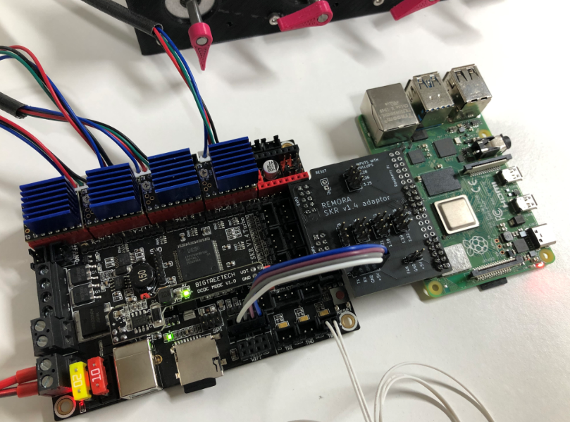

Great to hear that it's working. BTW which config sample did you use? The SKRv1.3 config doesn't have the encoder index pin enabled. Just makes me wonder if there is a bug in the encoder configuration code.

github.com/scottalford75/Remora/blob/mai...es/SKRv13/config.txt
I just removed everything but stepgens for now.

There was an error in the encoder creation code, thanks for helping find it! Pushed the latest code and firmware to the repo.
Replied by scotta on topic Remora - Rpi Software Stepping Using External Microcontroller via SPI

Hi Bari,
When I saw your other post on this I ordered myself a W5500 ethernet module. It's now waiting for some experimentation...

Hi
You mean this is ethernet to spi modul ?

Correct. If there is anyone with experience the W5500 on Mbed LPC1768, development help would be more than welcome.
