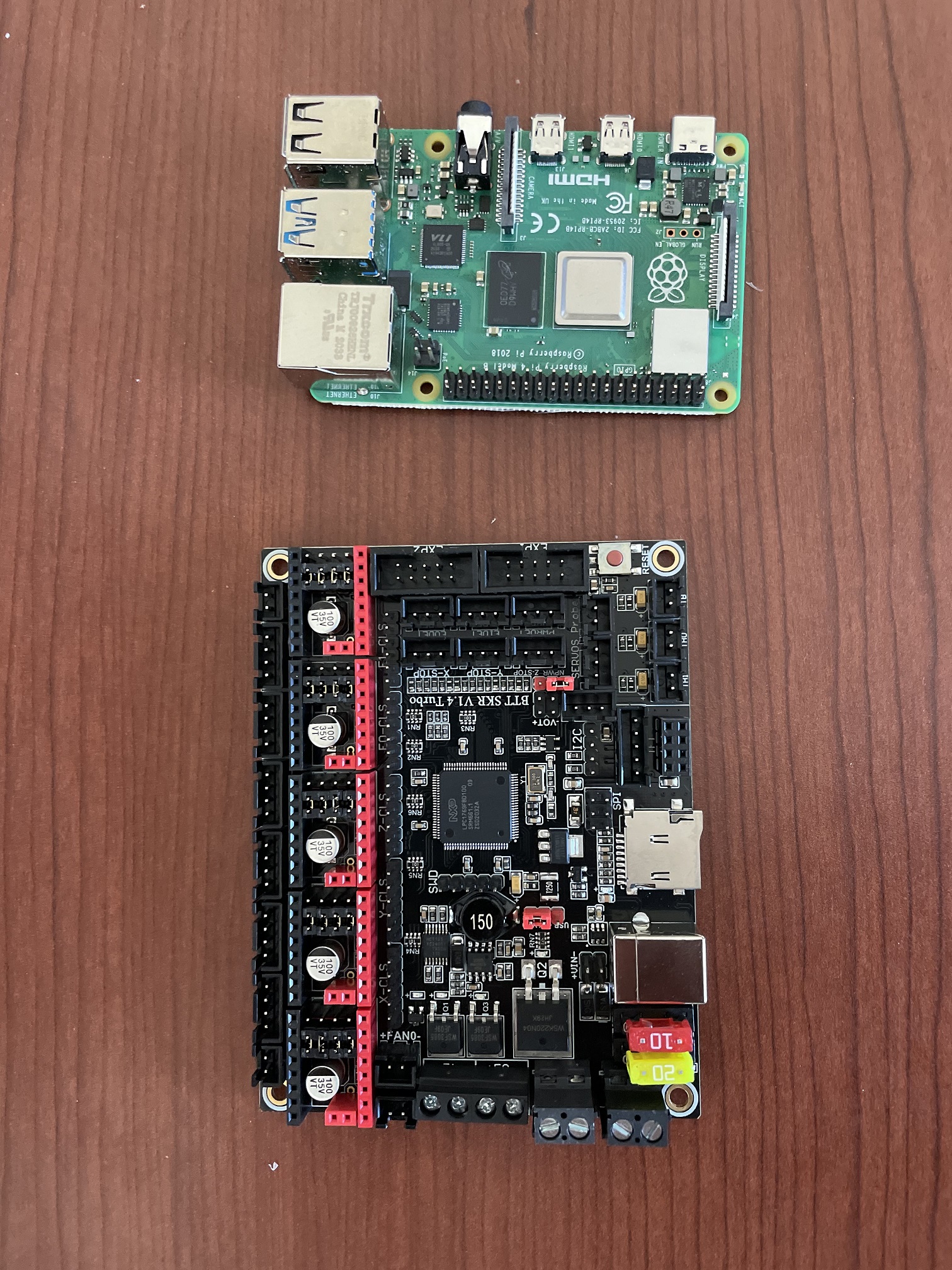

Scotta, i would love to buy one and try, do you know if it works on the turbo board?

Is there a disc img i could get for my rpi4...? please and thank you. I've had no luck with 64bit so far

Yes, working with the turbo version. The picture is with my SKR v1.4 turbo.
Happy to send one of the prototype boards. PM me your details.
BR
Scott
BR
Scott
