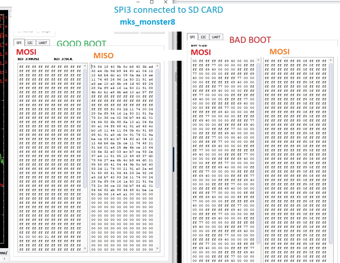

09 Feb 2022 01:37 #234368
by cakeslob
Replied by cakeslob on topic Remora - Rpi Software Stepping Using External Microcontroller via SPI
Heres what I got today, this is what the monster8 is outputting to my dinky ass logic thing
On good boot, SPI3 for sd card doesnt do anything, except whats in the picture.
On bad boot, it keeps flowing
This is what I get from debug on bad boot.
is what it says about it
Here is what I think I understand
The mosi should be doing nothing be instead its shitting out data, which sets the LL_SPI_IsActiveFlag_RXNE flag active, which causes the sdblockdevice to not initialize... and because its every other power cycle, something is...thats as far as i understand
0x080067fa in LL_SPI_IsActiveFlag_RXNE ()Check if Rx buffer is not empty SR RXNE LL_SPI_IsActiveFlag_RXNEis what it says about it

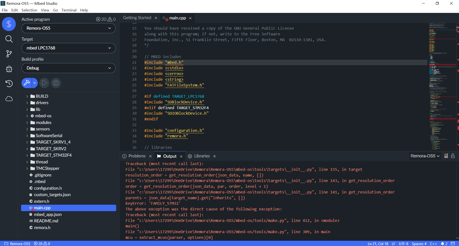

10 Feb 2022 16:35 #234491
by tuzki
Replied by tuzki on topic Remora - Rpi Software Stepping Using External Microcontroller via SPI
- cakeslob
- Posts: 927
- Thank you received: 280
11 Feb 2022 00:32 #234546
by cakeslob
- tuzki
- Posts: 48
11 Feb 2022 03:51 #234550
by tuzki
I found that remora provides binaries, and I don't need to compile it
