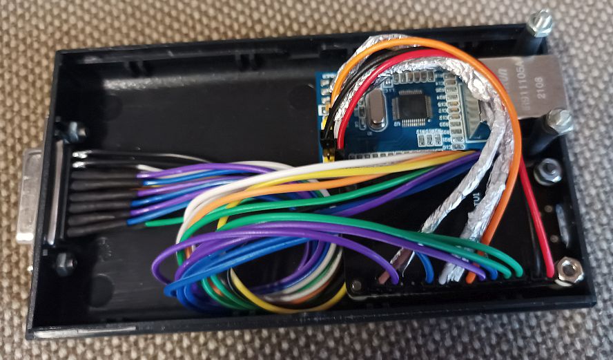

I'm doing the bench tests and so far I haven't had any problems, to tell the truth the only problem was interference in the cables of the w5500 but I put aluminum foil and it solved the problem 100%, I'll soon put it on a real machine and do the tests, I'm using this version. LinuxCNC 2.8.2 Debian 10 Buster PREEMPT-RT ISO

I modified the ethernet library for faster spi transfer. Thus, I was able to exchange UDP data below 500 microseconds. For this, I already needed aluminum foil shielding on the spi wires as suggested by eng. I attach my entire platformio folder.

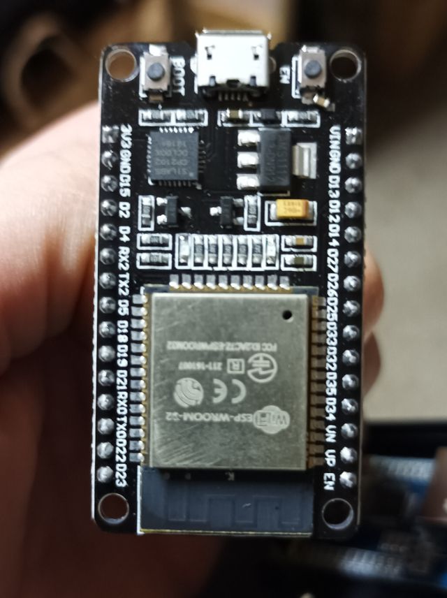

Is there a pinout and what esp32 are you using ? there are so many out there. Thanks
