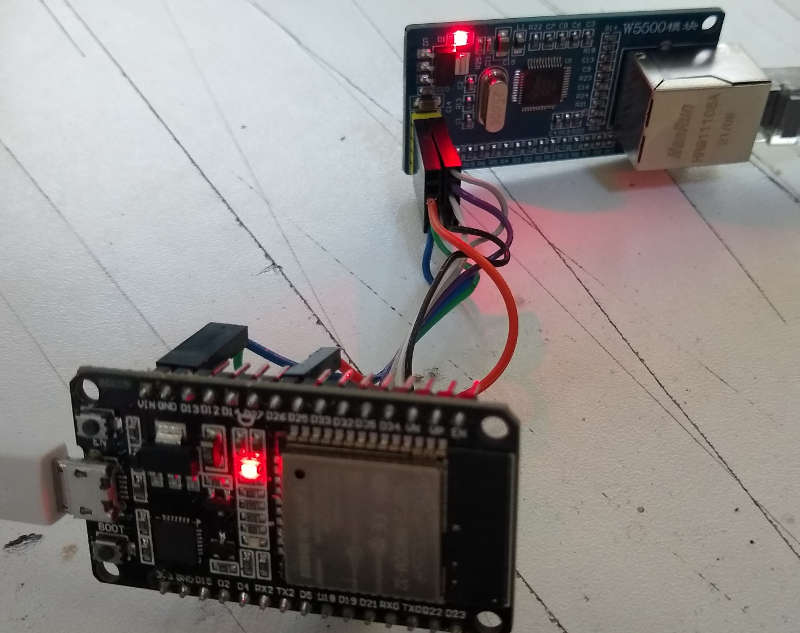

Has anyone compiled the code and hooked up a ESP32 & Ethernet Module ?
Have I both now sitting in the "lets make something box" but I'm having an issue with the ESP32 to Ethernet Module hookup. The SPI signals seems easy enough to find info on, but the RESET & CS seem a bit iffy. I've spent a few hours looking and seem to come up with different pins.
Yeah yeah I know I'm probably missing so simple.

24 May 2021 04:52 #210044
by tjtr33
Replied by tjtr33 on topic linuxcnc-esp32 Software Stepping over Ethernet Using ESP32
Thx, I saw same and its' cleaner, about a dozen gpio left over
and a simpler package.
bit.ly/34eTCfX
or
www.wireless-tag.com/wp-content/uploads/...6%96%87%EF%BC%89.pdf
There are a LOT of 'esp32' boards
I have DOIT ESP32 DEVKIT V1
and i've found 2 versions
so
finding the correct pins can be hell
and NOT having to find them is nice.
( a bonus of a pcb containing 2 major components)

- BeagleBrainz
- Visitor
24 May 2021 11:15 - 24 May 2021 11:42 #210073
by BeagleBrainz
Replied by BeagleBrainz on topic linuxcnc-esp32 Software Stepping over Ethernet Using ESP32
Try this
From here:
github.com/dlhenke/linuxcnc-esp32/blob/m...inuxcncinterface.ino
udp.comp needs some extras, the scale as parameters, the ability to set the IP Address when loading, and updating some of the socket functions (working on that ATM). Tho it does work as expected, the above just make it nicer.
The CS/SS pin needs to be set correct for your particular board.
There still needs to be some work done on the GPIO pin numbering for the DIR pins
#include <stdlib.h>
#include <driver/gpio.h>
#include <Arduino.h>
#include <Ethernet.h>
#include <EthernetUdp.h>
///#include <mcpwm.h>
///#include <ledc.h>
#include <esp_timer.h>
#include <driver/rmt.h>
#include <string.h>
#include <ESP32Encoder.h>From here:
Last edit: 24 May 2021 11:42 by BeagleBrainz.

24 May 2021 11:23 - 24 May 2021 11:52 #210075
by tjtr33
i made some progress
i edited linuxcncinterface,ibo
changetoand xhangeto
and
install ESP32Encoder using library mgr
now it will compile
but i have not tested it
There used to be a processing driver pde
but it is not in the tail of linuxcncinterface.ino
i saw it somewhere in my travels
tomp tjtr33
regards tomp tjtr33
change
#include <gpio.h>#include <driver/gpio.h>#include <rmt.h>#include <driver/rmt.h>and
now it will compile
tomp tjtr33
regards tomp tjtr33
Last edit: 24 May 2021 11:52 by tjtr33. Reason: suggestion

28 May 2021 00:16 #210488
by tjtr33
@scotta @BeagleBrainz
Hello, please addto your list
All original #includes can be removed
IF yours plus this esp_ipc.h are in the file
( no need for FreeRtos etc )
It compiles and loads fine
and the pins can be seen in halbut theres are pins listed that dont exist on my 30 pin devkit1 board
I will go now to study the comp src to see what params may exist
and how a .hal file would be made to use this
There must exist a config(hal and ini ) if we watched the video.
Are they published?
Should the RST pin be set High? (d26 on esp32 , RST on w5500 )
Also I am still looking for the .pde that tests the .ino
I have it someplace but have misslaid it.
Thx TomP
Hello, please add
#include esp_ipc.hAll original #includes can be removed
halrun
loadrt upc
showI will go now to study the comp src to see what params may exist
Are they published?
Thx TomP
