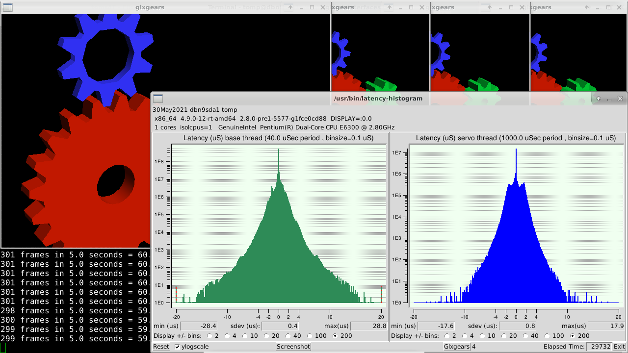

No.
Does your machine pass the latency test ?

yes
latency-histogram tests were done --base 40000 --servo 1000000
with 4 glxgears
booted on dual core pentium with isolcpus=1 idle=poll
ran overnight
i'd have to dig up the screen shots
or just wait till next morning here
i'll run another now
i can run other configs ( parport and mesa 5i10 w/o errs )
thx tomp

Last edit: 31 May 2021 01:15 by tjtr33. Reason: added screenshot
