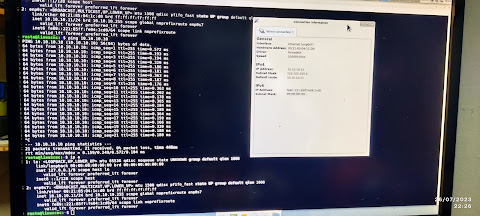

Same result
I am suspecting LAN on card is not responding not sure if LED should blink after plugging same as when connected to PC.

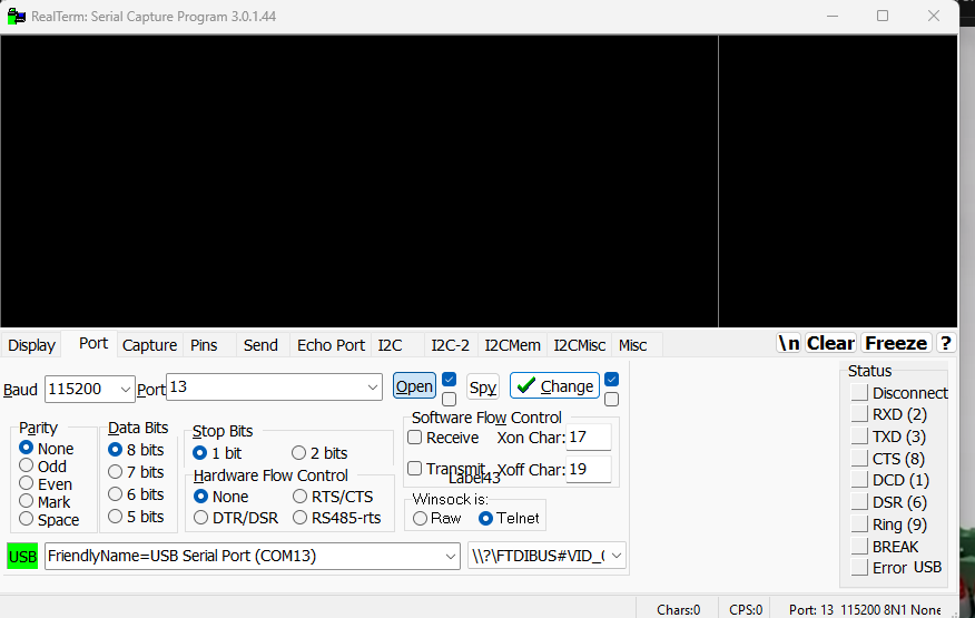

Same with rs232 there is nothing in terminal. In video he is showing that after flash and run there is response from rs232 which I didn't found. That made me concerned if I flashed correctly but when uploaded there was no error.(see my previous posts)
Maybe should return and reflash bin file and restart from there?

Ok, maybe work through this one step at a time.
1. First ensure that your RS232 adaptor is working correctly. Loop TX to RX and confirm you get a reply when you send something from Realterm or which ever terminal you are using. Setting is 8N1 115200 baud
2. Connect your RS232 adaptor. TX -> RX and RX -> TX
3. Flash the board and confirm debug serial output
4. Move on to Ethernet connection, no special cable needed for direct connection to the PC

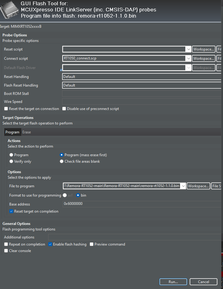

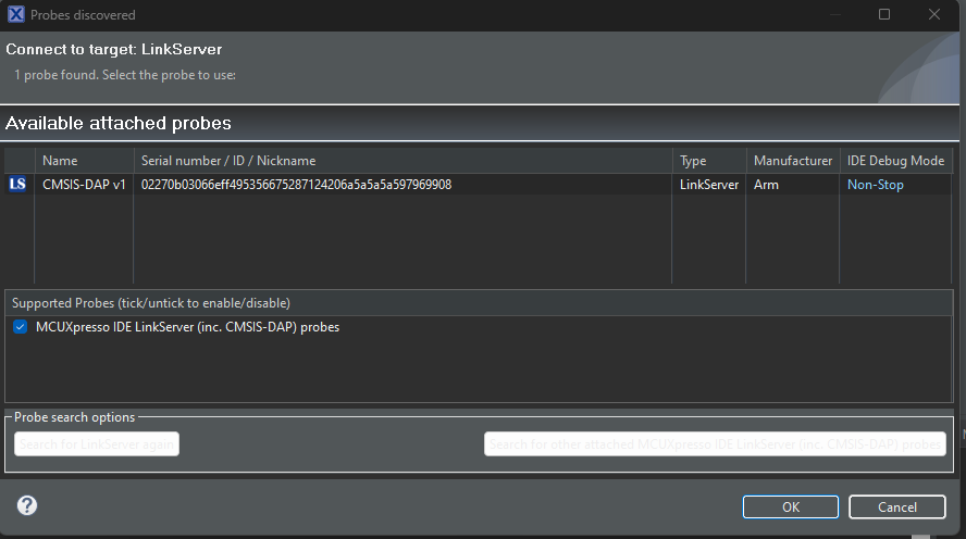

So there it is... I have checked rs232 adaptor connection and working on other device
Board flashed successfully from bin file log attached
stmlink v2 showing maintanace not rt1052
# DAPLink Firmware - see daplink.io
Build ID: v0257-15-gd2db0d5b (gcc, local mods)

log from flash:
Executing flash operation 'Program' (Program file into flash: remora-rt1052-1.1.0.bin) - Mon Jul 24 17:43:08 BST 2023
Checking MCU info...
Scanning for targets...
Executing flash action...
MCUXpresso IDE RedlinkMulti Driver v11.7 (Mar 22 2023 09:52:55 - crt_emu_cm_redlink.exe build 13)
( 0) Reading remote configuration
Wc(03). No cache support.
Found chip XML file in C:/Users/rasta/Documents/MCUXpressoIDE_11.7.1_9221/workspace/remora-rt1052/Debug\MIMXRT1052xxxxB.xml
( 5) Remote configuration complete
Reconnected to existing LinkServer process.
============= SCRIPT: RT1050_connect.scp =============
RT1050 Connect Script
DpID = 0BD11477
APID = 0x04770041
Disabling MPU
Configure FlexRAM for 256KB OC RAM, 128KB I-TCM, 128KB D-TCM
Finished
============= END SCRIPT =============================
Probe Firmware: CMSIS-DAP v1 (Arm)
Serial Number: 02270b03066eff495356675287124206a5a5a5a597969908
VID:PID: 0D28:0204
USB Path: \\?\hid#vid_0d28&pid_0204&mi_03#a&383eca04&0&0000#{4d1e55b2-f16f-11cf-88cb-001111000030}
Using memory from core 0 after searching for a good core
( 30) Emulator Connected
( 40) Debug Halt
( 50) CPU ID
debug interface type = CoreSight DP (DAP DP ID 0BD11477) over SWD TAP 0
processor type = Cortex-M7 (CPU ID 00000C27) on DAP AP 0
number of h/w breakpoints = 8
number of flash patches = 0
number of h/w watchpoints = 4
Probe(0): Connected&Reset. DpID: 0BD11477. CpuID: 00000C27. Info: <None>
Debug protocol: SWD. RTCK: Disabled. Vector catch: Disabled.
Content of CoreSight Debug ROM(s):
RBASE E00FD000: CID B105100D PID 000008E88C ROM (type 0x1)
ROM 1 E00FE000: CID B105100D PID 04000BB4C8 ROM (type 0x1)
ROM 2 E00FF000: CID B105100D PID 04000BB4C7 ROM (type 0x1)
ROM 3 E000E000: CID B105E00D PID 04000BB00C Gen SCS (type 0x0)
ROM 3 E0001000: CID B105E00D PID 04000BB002 Gen DWT (type 0x0)
ROM 3 E0002000: CID B105E00D PID 04000BB00E Gen (type 0x0)
ROM 3 E0000000: CID B105E00D PID 04000BB001 Gen ITM (type 0x0)
ROM 2 E0041000: CID B105900D PID 04001BB975 CSt ARM ETMv4.0 type 0x13 Trace Source - Core
ROM 2 E0042000: CID B105900D PID 04004BB906 CSt type 0x14 Debug Control - Trigger, e.g. ECT
ROM 1 E0040000: CID B105900D PID 04000BB9A9 CSt type 0x11 Trace Sink - TPIU
ROM 1 E0043000: CID B105F00D PID 04001BB101 Sys (type 0x0)
NXP: MIMXRT1052xxxxB
DAP stride is 1024 bytes (256 words)
Inspected v.2 External Flash Device on SPI using SFDP JEDEC ID MIMXRT1050_SFDP_QSPI.cfx
Image 'iMXRT1050_SFDP_QSPI Mar 21 2023 13:24:31'
Opening flash driver MIMXRT1050_SFDP_QSPI.cfx
Sending VECTRESET to run flash driver
Flash variant 'JEDEC_SFDP_Device' detected (4MB = 64*64K at 0x60000000)
Closing flash driver MIMXRT1050_SFDP_QSPI.cfx
( 65) Chip Setup Complete
Connected: was_reset=false. was_stopped=true
( 70) License Check Complete
Loading 'remora-rt1052-1.1.0.bin' Binary 0x60000000 len 0x30F2B
Opening flash driver MIMXRT1050_SFDP_QSPI.cfx (already resident)
Writing 200492 bytes to address 0x60000000 in Flash
( 0) Mass erasing Flash
Mass erased flash in 10513msec
1 of 1 ( 0) Writing sectors 0-3 at 0x60000000 with 200492 bytes
( 0) at 60000000: 0 bytes - 0/200492
( 8) at 60000000: 16384 bytes - 16384/200492
( 16) at 60004000: 16384 bytes - 32768/200492
( 24) at 60008000: 16384 bytes - 49152/200492
( 32) at 6000C000: 16384 bytes - 65536/200492
( 40) at 60010000: 16384 bytes - 81920/200492
( 49) at 60014000: 16384 bytes - 98304/200492
( 57) at 60018000: 16384 bytes - 114688/200492
( 65) at 6001C000: 16384 bytes - 131072/200492
( 73) at 60020000: 16384 bytes - 147456/200492
( 81) at 60024000: 16384 bytes - 163840/200492
( 89) at 60028000: 16384 bytes - 180224/200492
( 98) at 6002C000: 16384 bytes - 196608/200492
(100) at 60030000: 16384 bytes - 212992/200492
Sectors written: 4, unchanged: 0, total: 4
Wrote sector 0-3 with 200492 bytes in 8497msec
(100) Finished writing Flash successfully.
Flash Write Done
Loaded 0x30F2B bytes in 19294ms (about 10kB/s)
Reset target (system)
Starting execution using system reset
I had no response from serial tho
Flash Write Done
Last edit: 24 Jul 2023 17:39 by raf1110. Reason: pictures adding

It still looks like your are using the DAPlink firmware. Please change to the CMSIS-DAP firmware on your ST-Link.
github.com/scottalford75/Remora-RT1052/b...SIS-DAP-STLINK21.hex
The following user(s) said Thank You: raf1110

That did work something and I have responses from rs232 terminal , flashing light in ETH socket and below is LinuxCNC config IP a and ping.
