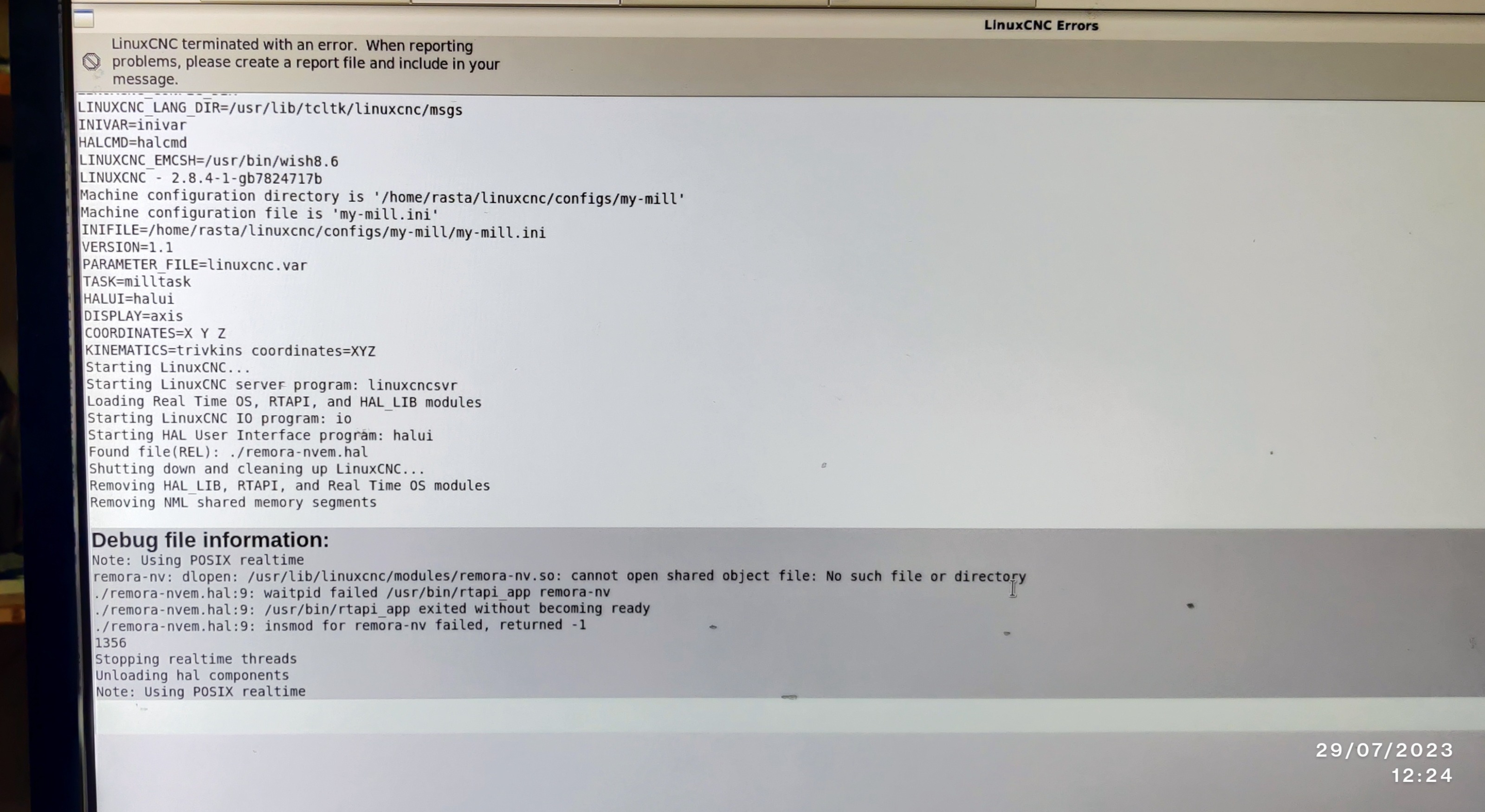

29 Jul 2023 18:08 #276533
by cakeslob
Replied by cakeslob on topic Remora - ethernet NVEM / EC300 / EC500 cnc board
i think you probably need to install the linuxcnc component
github.com/scottalford75/Remora-NVEM/tre...Components/Remora-nv
remora-docs.readthedocs.io/en/latest/sof...mp-installation.html
sudo halcompile --install remora-nv.cremora-docs.readthedocs.io/en/latest/sof...mp-installation.html

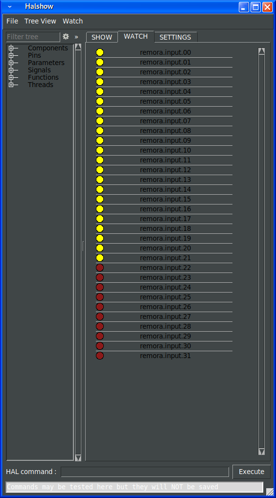

30 Jul 2023 04:20 - 30 Jul 2023 04:50 #276547
by frayja2002
Replied by frayja2002 on topic Remora - ethernet NVEM / EC300 / EC500 cnc board
Hi Scott.
I have managed to upload the config file to the newly flashed EC500 board & am starting to play with it.
Looking at the hal show all (most) of the inputs seem to be inverted. Assuming this may just be a quirk I have gone into th econfig file & tried to invert some of the pins & this seem to have no effect.
"Thread": "Servo",
"Type": "Digital Pin",
"Comment": "IN01",
"Pin": "P3_25",
"Mode": "Input",
"Data Bit": 4,
"Invert": "true"
I believe the upload is working as I get no errors....
(2:01:52pm)> python3 upload_config.py ec500-rt1052.txt
Valid JSON config file, uploading to board
Config file length (words) = 1716
Config file length (bytes) = 6861
Remainder = 1
Padding added = [0, 0, 0]
Config file length with padding (bytes) = 6864
CRC-32 = 0xbf67a0b8
And if I go through & toggle the inputs the red light on the board comes on & the yellow light in hal show turns red (deactivates)
Two questions
Should they be high by default.
Why does changing false to true in the config file have no effect.
"Thread": "Servo",
"Comment": "IN01",
"Pin": "P3_25",
"Mode": "Input",
"Data Bit": 4,
"Invert": "true"
Remainder = 1
CRC-32 = 0xbf67a0b8
Two questions
