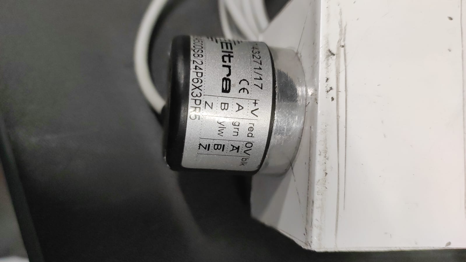

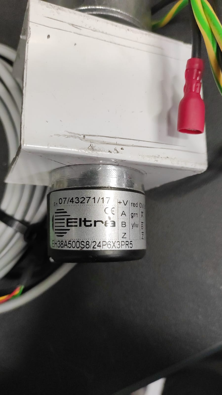

17 Jul 2023 06:48 #275626
by rbobey1989
hello Scott, I imagined for that moment that pressing the button that the EC300 has could solve the problem, but at least not for me, if you have some special sequence or some specific moment to press the button and you can guide me, I would be very happy to revive my EC300.
I attach a photo of the encoder that I have, regards
Replied by rbobey1989 on topic Remora - ethernet NVEM / EC300 / EC500 cnc board

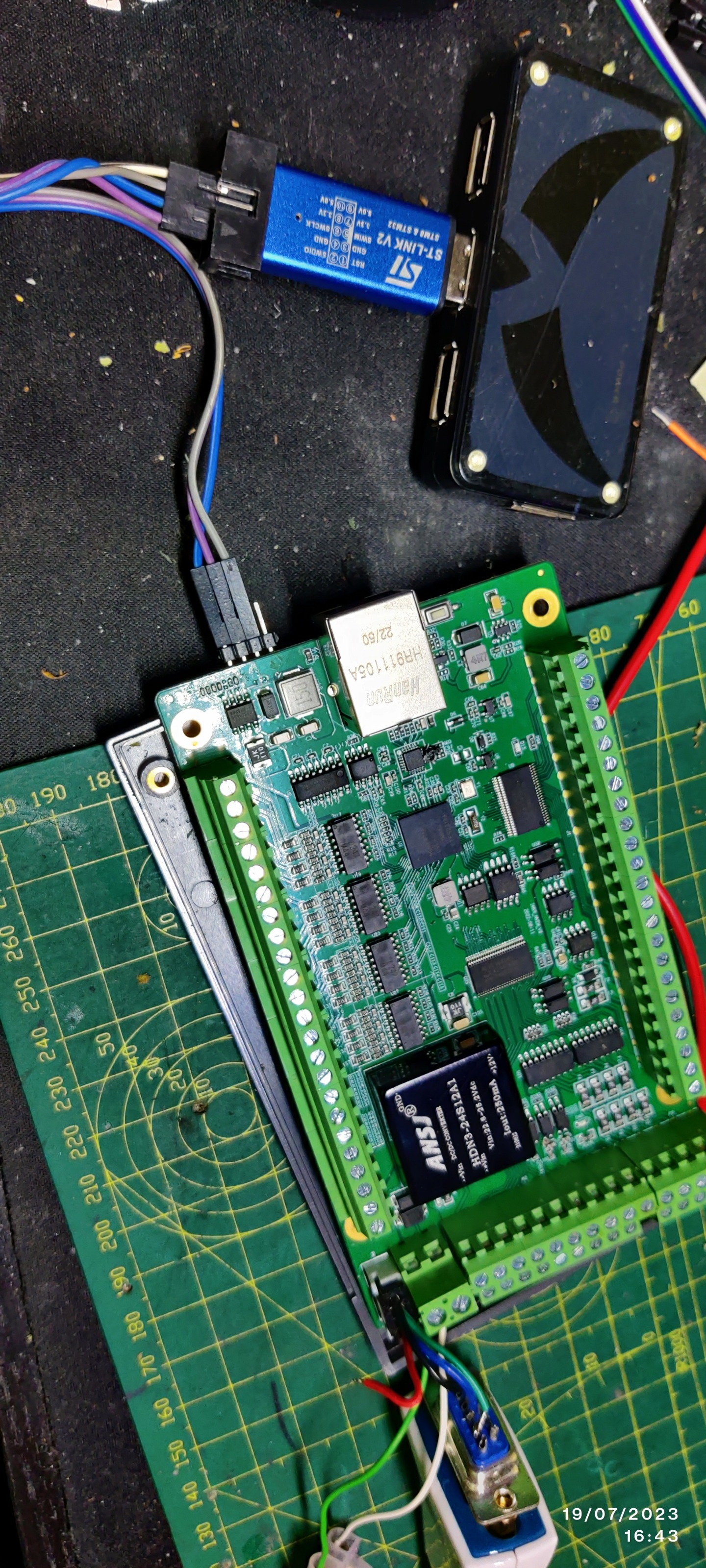

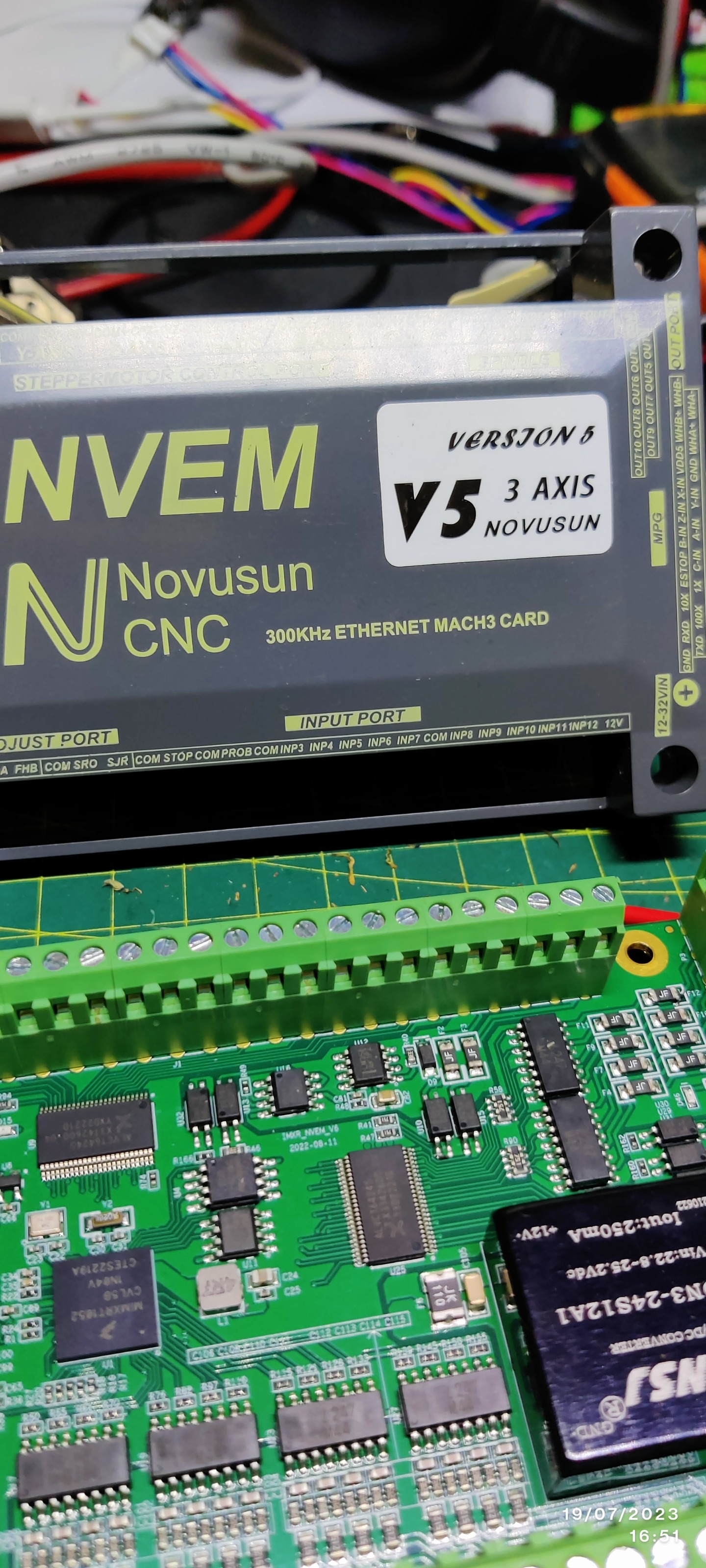

19 Jul 2023 16:01 - 19 Jul 2023 20:33 #275825
by raf1110
Hi in above configuration I have problem with connecting to device via DAPlink or rs232 usb adaptor to see if there is data connection to board.
Following steps I got to point where I should compile firmware but software that you using have broken download page I have little knowledge on ARM.
Is there easy way with DAP link to flash bin file for cnc linuxcnc machine. I have studied this topic and now got stuck. I can provide more info if necessary.
It is amazing what you do and if anyone could guide me a little how to flash correct firmware on NVEM v5

20 Jul 2023 00:56 #275842
by scotta
Hi, it's best to use the CMSIS-DAP firmware for the ST-Link. The DAPlink has not been reliable for people.
github.com/scottalford75/Remora-RT1052/b...SIS-DAP-STLINK21.hex
Use pyOCD to flash the firmware.
pyocd remora-rt1052-1.1.0.bin --target mimxrt1050_quadspi
Latest firmware:
github.com/scottalford75/Remora-RT1052-c...ora-rt1052-1.1.0.bin
Latest firmware:

20 Jul 2023 21:13 #275915
by scotta
Hi, just looking at your photos again. Is this the actual setup used when trying to flash the firmware? You also need to power the board during the flashing process. In the photo you have no power supply connected...
