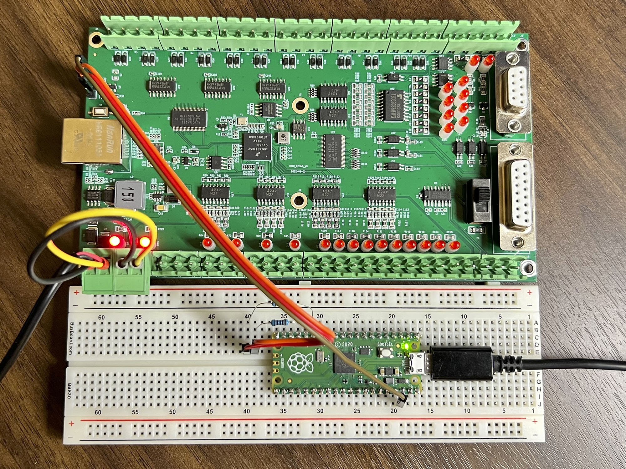

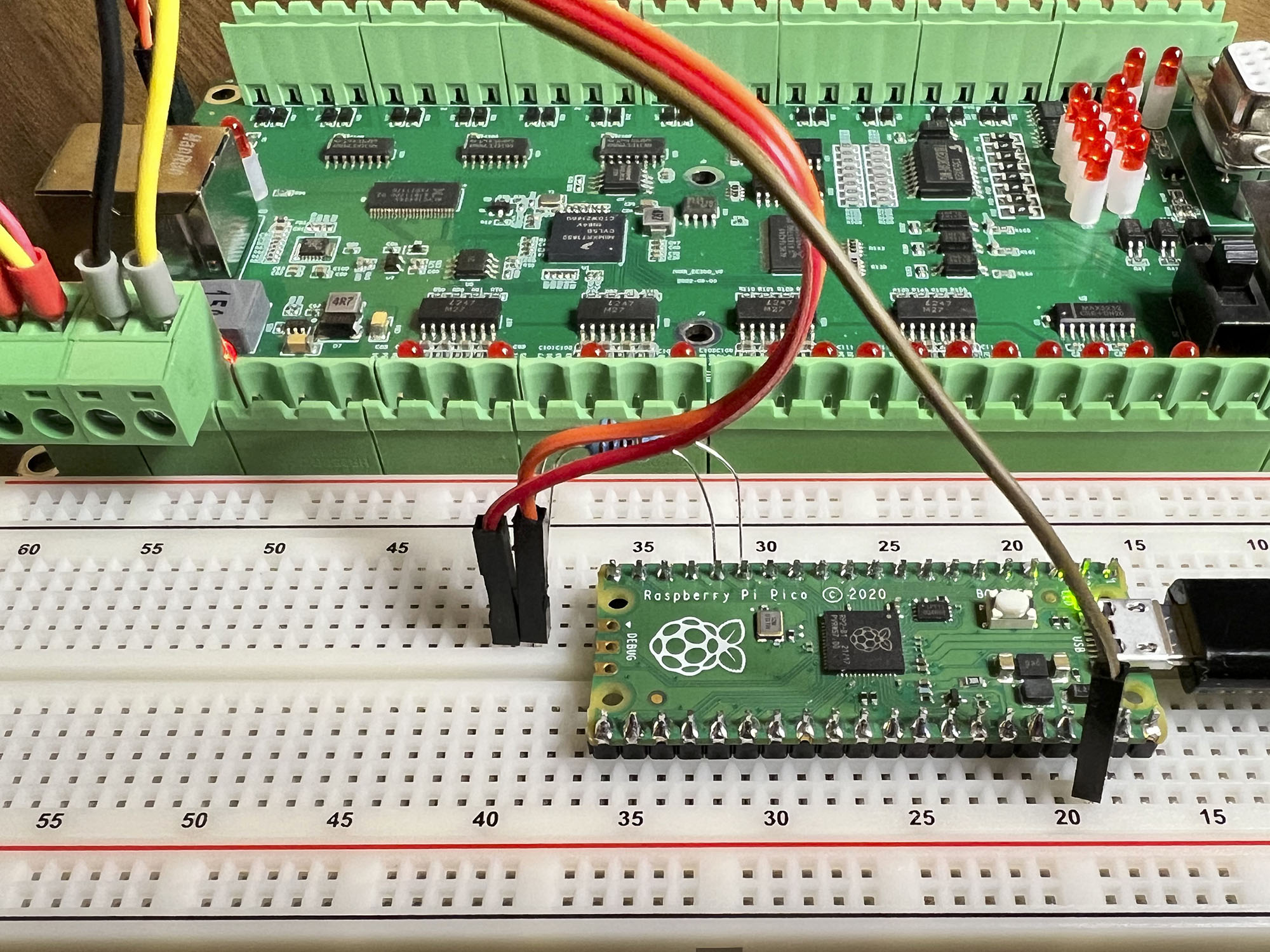

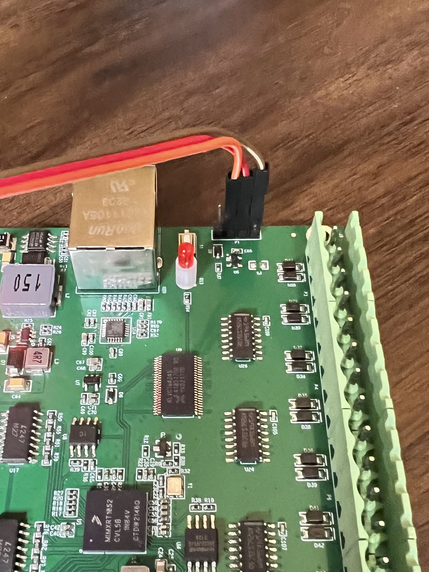

Brand new to LinuxCNC. Couldn't find any Mesa controller in stock and bumped into Scott's YouTube videos. Ordered an EC300, which arrived today. I didn't have any ST-Link but had a few RPI Pico boards so I gave it a try. Worked first time. Now I have a long and steep learning curve ahead on how to configure it allI really think I should take down the stuff relating to the DAPlink. It's causing more issues then it solved.
CMSIS-DAP has been the most successful but converting an ST-Link is a pain.
There is a solution, a PicoProbe! Just tested and works out of the box with pyOCD.
pyocd remora-rt1052-1.0.0.bin --target mimxrt1050_quadspi
~/Downloads ❯ pyocd flash ./remora-rt1052-1.1.0.bin --target mimxrt1050_quadspi 0000751 I Loading /xxx/xxx/Downloads/remora-rt1052-1.1.0.bin [load_cmd] 100% 0008795 I Erased 0 bytes (0 sectors), programmed 0 bytes (0 pages), skipped 321536 bytes (1256 pages) at 39.07 kB/s [loader]Attachments:

Are you asking me? If so, yes. I did use a Raspberry PI Pico. I found this thread last week and I've been following it. I didn't have any ST-Link but I had a few RPI Pico boards. I found this Instructable showing how to set it up as a DAPLink and then using pyocd to flash it.Have you managed to flash firmware with Pi?
