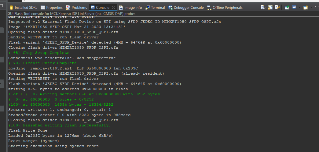

I did have power on when attempted flashing. I am having trouble with pyOCD.
Do I need serial port together with stlink connected?

21 Jul 2023 22:54 - 21 Jul 2023 22:56 #275983
by raf1110
Replied by raf1110 on topic Remora - ethernet NVEM / EC300 / EC500 cnc board
Last edit: 21 Jul 2023 22:56 by raf1110.
- scotta
- Posts: 959
- Thank you received: 489
21 Jul 2023 23:01 #275984
by scotta
Ok, so you've flashed with MCUXpresso. Great news. Looking forward to you testing a ping response from the board.
Board has a static IP of 10.10.10.10 so you will need to have your LinuxCNC computer in the 10.10.10.x range.

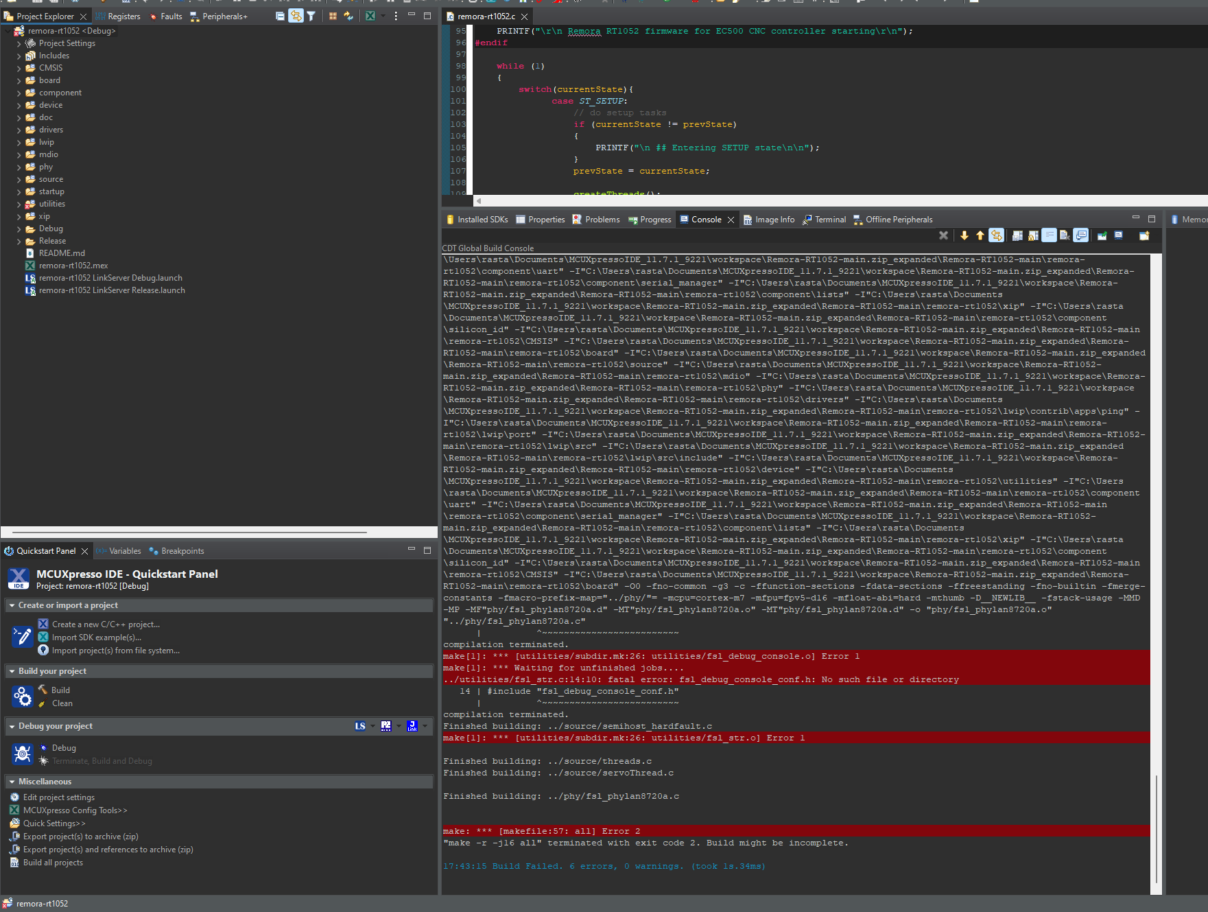

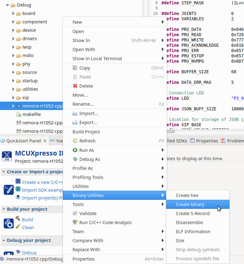

22 Jul 2023 17:16 #276006
by tuxcnc
Upload precompiled firmware and configure your computer so that it can see the controller.
Only then compile your own versions of firmware.
I used github.com/scottalford75/Remora-RT1052-cpp
I suggest raw.githubusercontent.com/scottalford75/...ora-rt1052-1.1.0.bin , it does work, I tested.
Replied by tuxcnc on topic Remora - ethernet NVEM / EC300 / EC500 cnc board
Do not create equations with many unknowns.Problem is I don't know how to check if board is working
