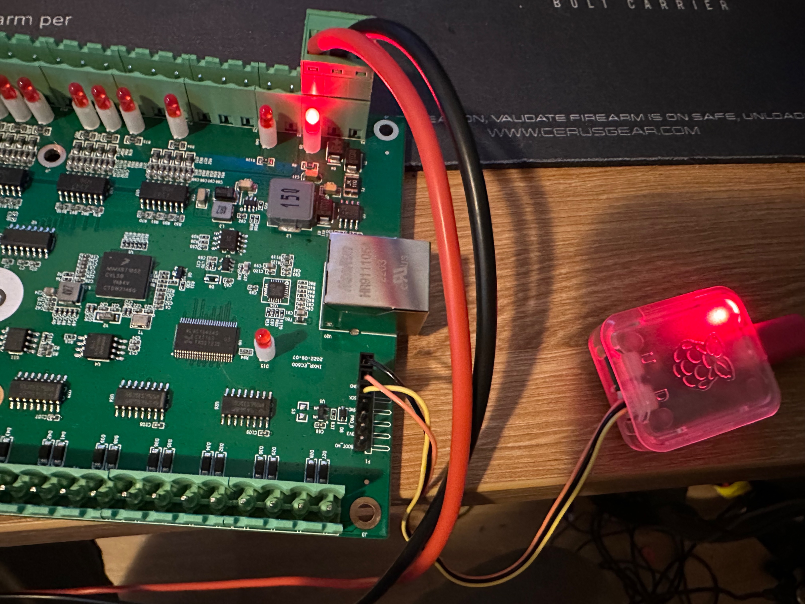

Hello, I am a total newbie to Linux and linuxcnc and I know little about electronics and programming, even so, and I tried to read practically all of this topic, see the queries and answers, but it is quite extensive and I have questions. I hope the language is not a limit for me. Is this project fully finished yet? Is the connection of the stlink v2 to the board only made once to introduce the firmware or do you have to do it every time you want to change the configuration? Where should I start studying to at least be able to do the most basic?
- scotta
- Posts: 959
- Thank you received: 489
25 Aug 2023 21:05 #278955
by scotta
Remora is an active project, with support / development ongoing for many different controller boards including the latest RT1052 Ethernet boards. So can't really call it a fully finished project, they never are....
The use of a CMSIS-DAP probe is only need when changing / updating the boards firmware. Configuration is performed by uploading via Ethernet.
What would you like to study, LinuxCNC or Remora setup?
Hi, welcome to LinuxCNC. There is a learning curve, which I'm sure the community here will be happy to help you.Hello, I am a total newbie to Linux and linuxcnc and I know little about electronics and programming, even so, and I tried to read practically all of this topic, see the queries and answers, but it is quite extensive and I have questions. I hope the language is not a limit for me. Is this project fully finished yet? Is the connection of the stlink v2 to the board only made once to introduce the firmware or do you have to do it every time you want to change the configuration? Where should I start studying to at least be able to do the most basic?
