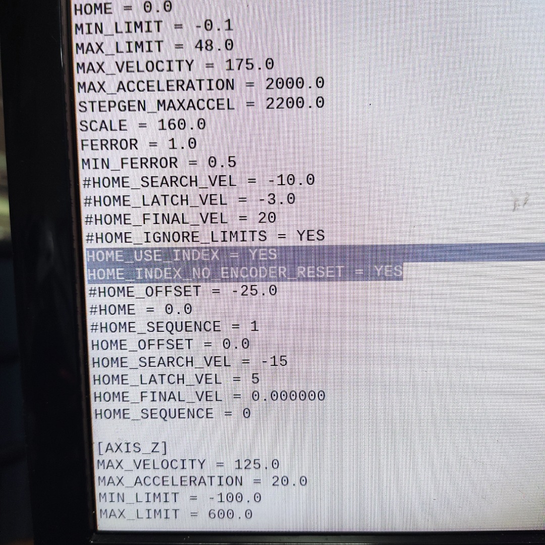

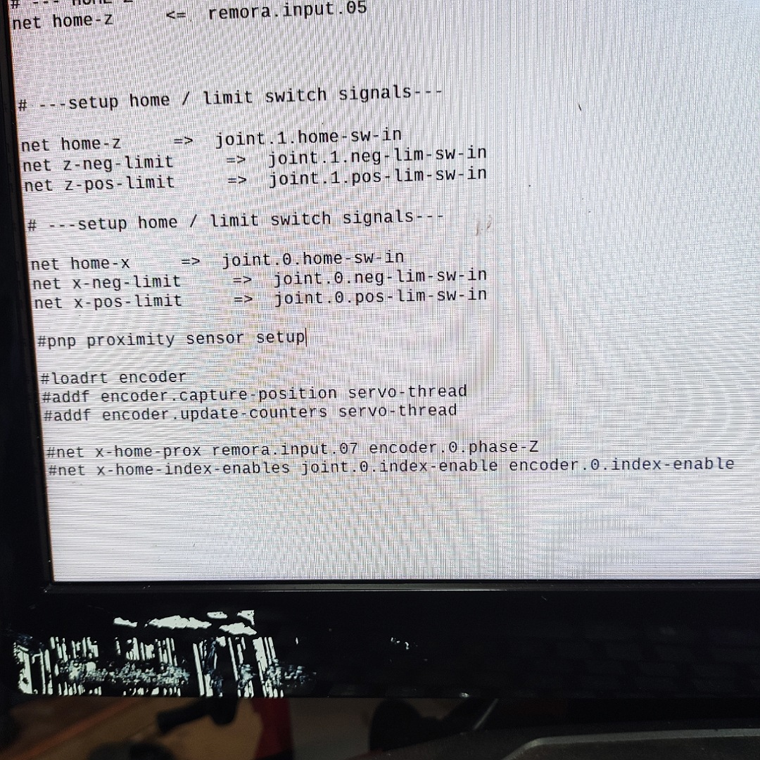

Iv gotten my homing switches as limit switches and works ok. But the lathe also has a prox sensor which would be much more accurate. I have added the following lines to the ini and Hal. It finds the limit switch and then goes looking for the prox. The prox triggers and it also triggers in hal but it dosnt trigger as home and keeps searching till it bottoms out. Any ideas? I'm on Linux 2.10
The prox by the way is a pulse from the encoder, triggers every full turn of the stepper. Pulse is on input.07

29 Aug 2023 05:51 #279256
by scotta
Not sure, but this thread might help.
forum.linuxcnc.org/10-advanced-configura...coder-reset-ini-flag
The following user(s) said Thank You: Murphy

29 Aug 2023 17:38 #279303
by Murphy
Replied by Murphy on topic Remora - ethernet NVEM / EC300 / EC500 cnc board
Thanks for the link Scott,got it working. Thats the homing/limits, axis and spindle working. On to the tool turret now. also is there an encoder in remora fast enough for a spindle ?

29 Aug 2023 21:19 #279320
by scotta
Great to hear! On the RT1052 boards the software encoder module is the only one available at the moment. Hardware encoder counting is on the to do list.
